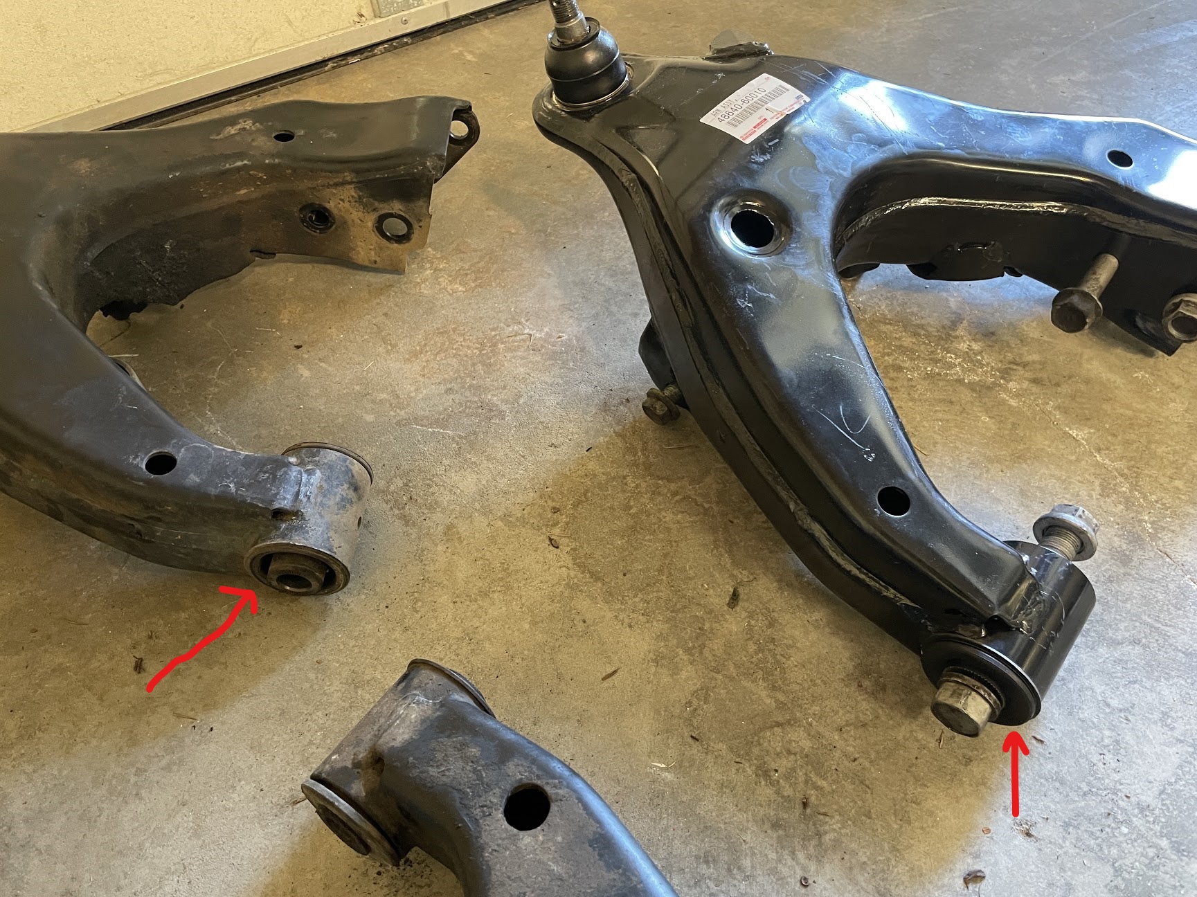

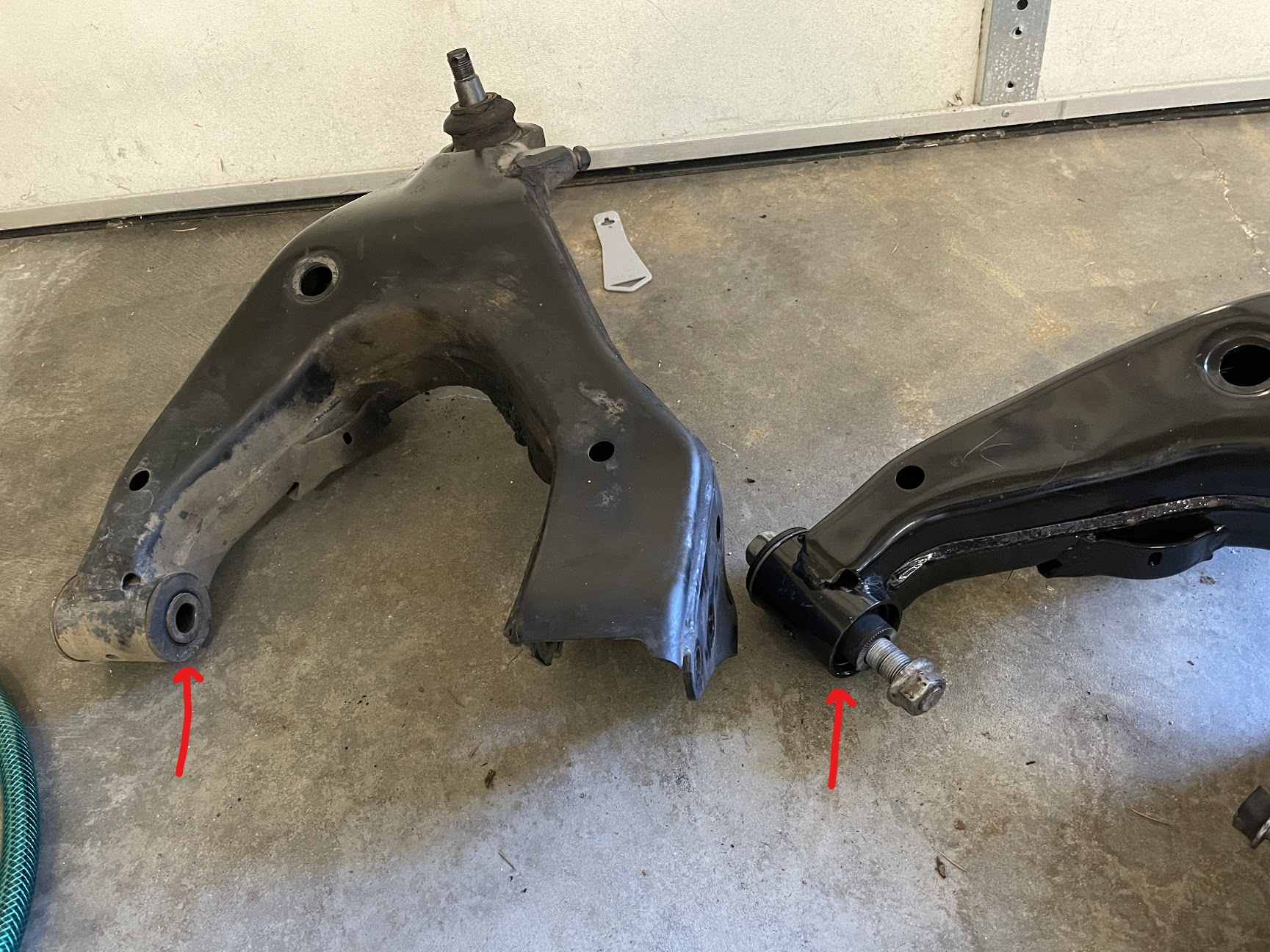

Update: Using some heat and a pickle fork I was able to get that cap off and the control arm is out. Also, got the new frame bushing pressed in and I was just about to install the new control arm when I noticed something weird....
The old control arms had this rubber washer thing attached to them, but it was on the inside of the control arm. Both new control arms have this piece on the outside. At first I thought I had done something wrong, or missed a piece or something, but the my control arms look like the pictures from PartSouq and so I am going to assume it's fine? Both original control arms had this piece on the inside and both new ones had it on the outside? I am going to proceed as if it is because other pictures I have seen online show the same thing installed on other rigs.
View attachment 2675103View attachment 2675104
I think your old ones had the plastic ring on the wrong side. My originals had the ring on the outside. The new bushings come with that “ring” formed on the bushing.

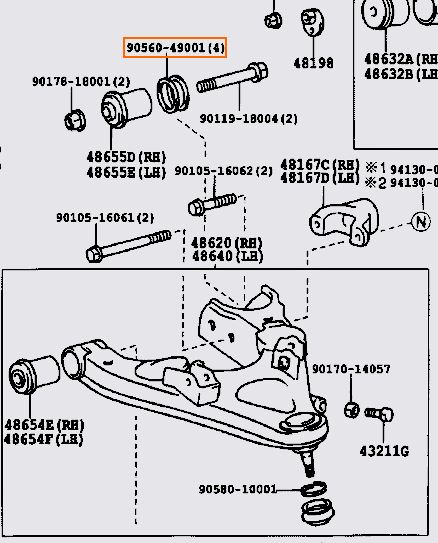

If you were able to get it in without too much trouble, it is probably fine, but there are multiple sizes of shims available for the LCA frame-installed bushing. These different sized shims effectively allow you to change the spacing of the frame mounting points so that they line up with the LCA.
Shims? You mean the washers that slide over the bushing? I have heard some people say the bushing they pressed out didn't have that washer/spacer. Both the bushings I removed had the washer so I put it back on both of them.
I only had the washer (on the passenger side) from the factory. I imagine if you had them both, Mr T intended it that way!
Sorry, I remembered incorrectly. It isn't that there are multiple sizes available, but that the parts manual shows multiple ones can be installed at each location. FWIW there is no mention in my '98 shop manual of any being installed at that location, but my truck had one installed at each bushing.
No worry. That is what I have seen as well.
Multiples (of the same size) can be installed and from what I read here some bushings will have them, others not.
I expect they are needed to 'align' certain parts with others. I wasn't even aware there was such a thing until I took my bushings out...because as you point out, they are not mentioned or illustrated in the FSM (or at least not mine).
Just one per side. I had to clean it up and reuse it.
