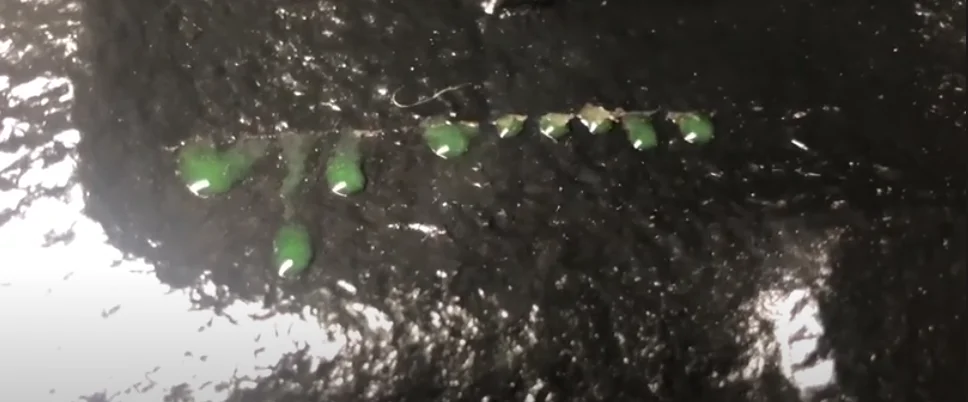

something about Toyota red
it crystalises/oxidizes where it should be leaking

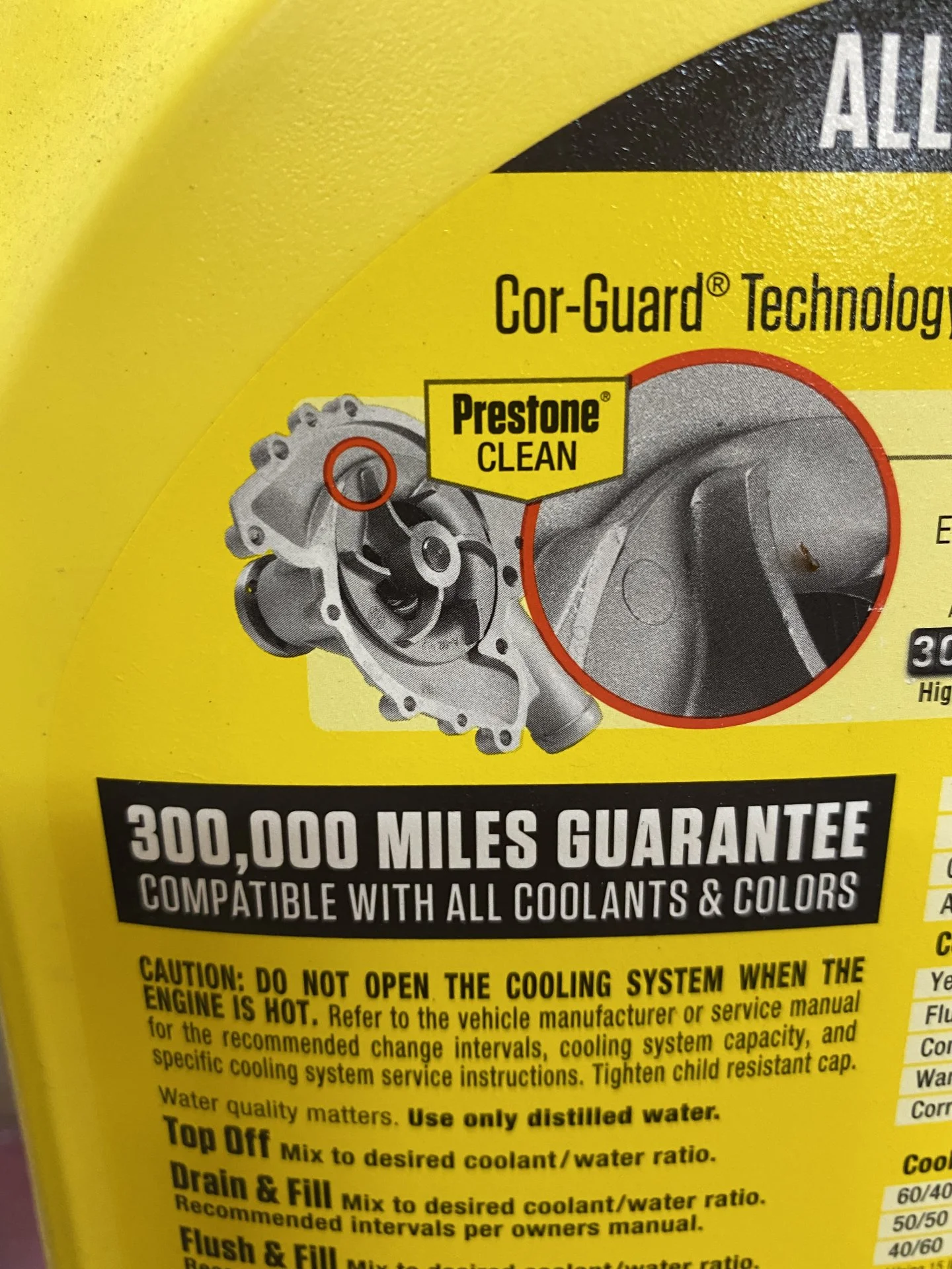

In case you needed more info, :rofl: Prestone offers, Red, Blue, Green, Teal, Pink, Violet, Orange, Dex-Cool, and another coolant labeled for “All Vehicles” (color not stated)
EDIT: I've since heard the "All Vehicles" color referred to as yellow. Look yellow/green to me.
“PRESTONE”

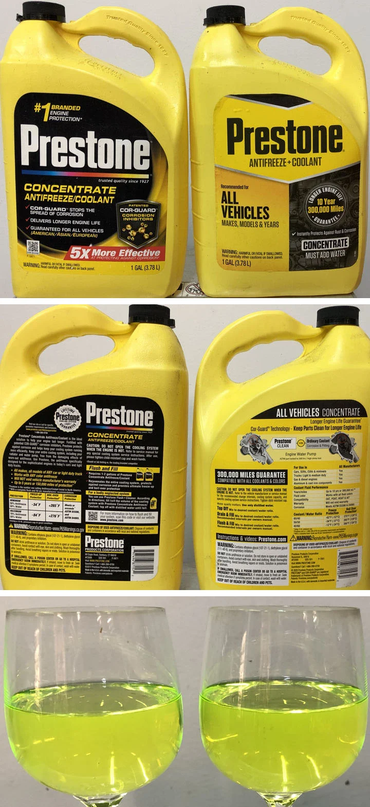

I remember when Prestone made just one coolant. It was green and I still use it now. Or at least I thought so. The labeling has changed over the years and maybe the formula, but it still looks the same. I just had a look at my stock and see I have two that I thought were the same but are not. The one on the left is maybe a year older but apparently no longer made. Its label says 5 years or 150K miles. The newer one on the right says 10 years or 300K miles. The contents on the labels are brief but identical so I don’t what changed to double the longevity.
Now there’s another green one that’s for certain Asian vehicles but not all. Maybe it’s a different shade of green because they’re running out of colors. Crazy!
