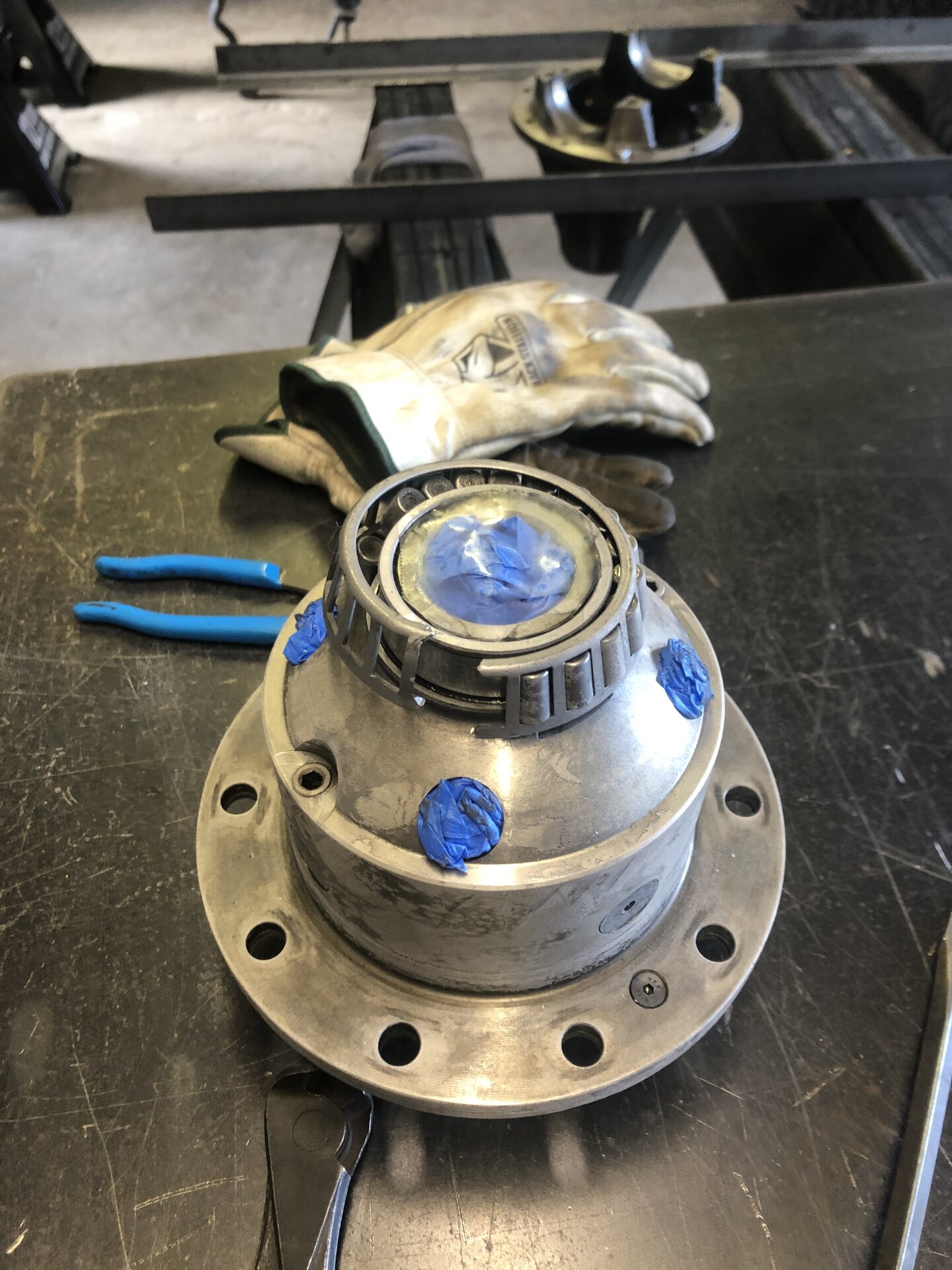

We enjoyed some very nice weather over my last set of days off from work so the axle housing is now painted and I’ve began the tedious task of setting pinion bearing preload using a solid spacer rather than the supplied crush sleeve. I had the pinion in and out no less than 15 times trying different combinations of shims. This morning before work I revisited this endeavor with a fresh outlook and I think I’ve found the correct shim combo. The FSM basically calls for 9-15inlbs of torque to turn the pinion shaft once the nut is torqued; I’ve chosen a final torque of 175ftlbs on the nut. With lightly lubed bearings the current pinion preload fluctuates, on the beam type wrench needle pointer, from 5 to 12inlbs. What I’m contemplating is keeping the current shim stack and removing a tiny bit of metal from the end of the spacer using sandpaper flat on the plate steel workbench. I think I want to bring the preload up just a smidgen.

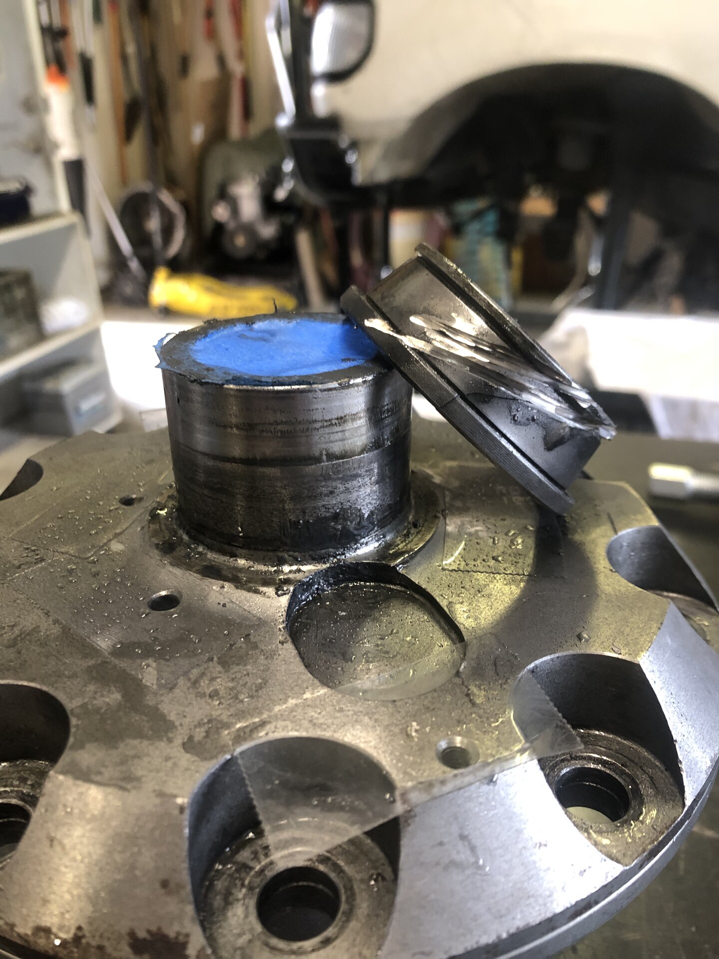

I was able to use the little HF 12t press to remove the old pinion bearing so as to retrieve the the shims underneath it but not so much for the carrier bearings so I cut them off the carrier with an angle grinder and cut off wheel cutting most of the way through and then popping it with a hammer and chisel to crack the remaining wall of the race. Install was as simple as freezing the carrier and pinion and baking the bearings at 400. The bearings slid on all positions by hand no problem.
View attachment 3245882View attachment 3245883View attachment 3245884View attachment 3245885

Yes it is but I’m enjoying it. I built one other diff in the past but it was not Toyota so I’m learning here too. Shops want huge hourly rates so I’m also saving some money. I’ve had to be inventive as far as some tooling js concerned as well. Fun stuff.
