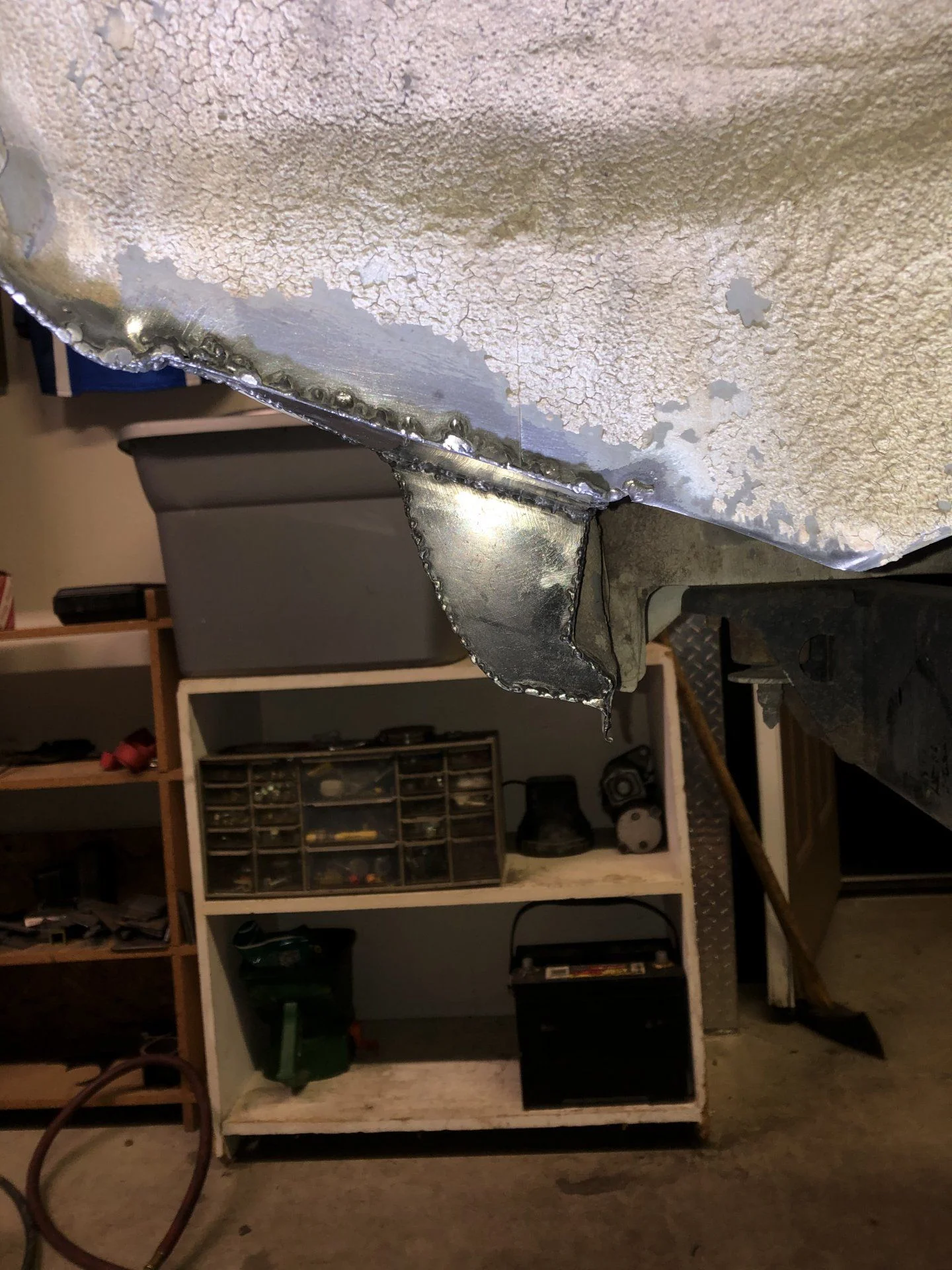

Thanks for the examples. Part of this project will be to replace the small side wing tube that came with the Labs bumper kit with 1 3/4” tubing and then run support to that tube directly. I figured bracing the wing as high up as I could would be the strongest. That’s why I cut the rear quarter up to the height that I did.
Then I’ll have someplace pretty solid to weld on some more tubing for higher up tail light and rear quarter panel armor. I haven’t yet decide just how crazy I’ll go with that but at the rate I’m going I’ll miss snow wheeling this year. Haha

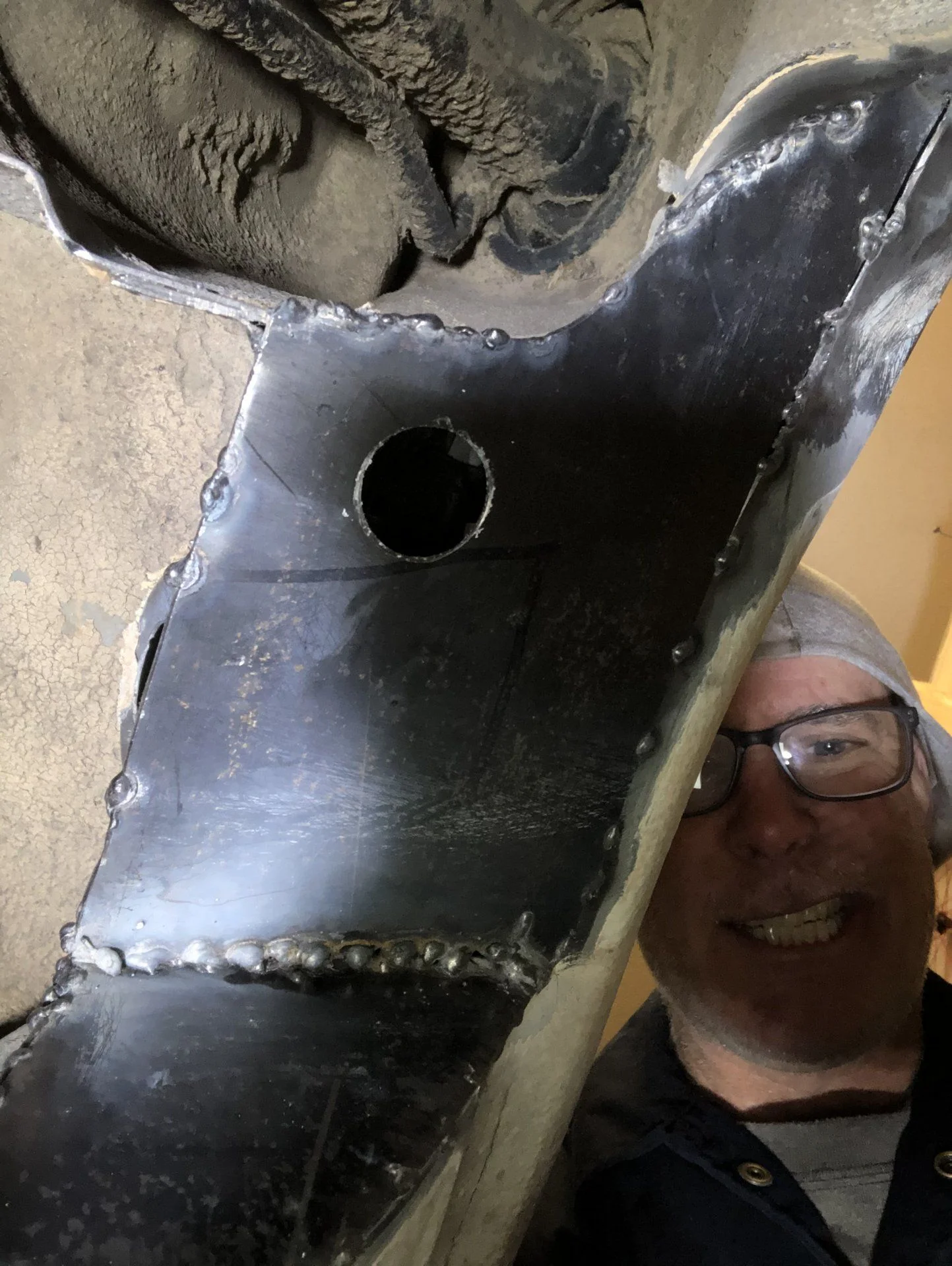

So here’s where we’re at so far. Cutting out the drivers side is tomorrow’s adventure.

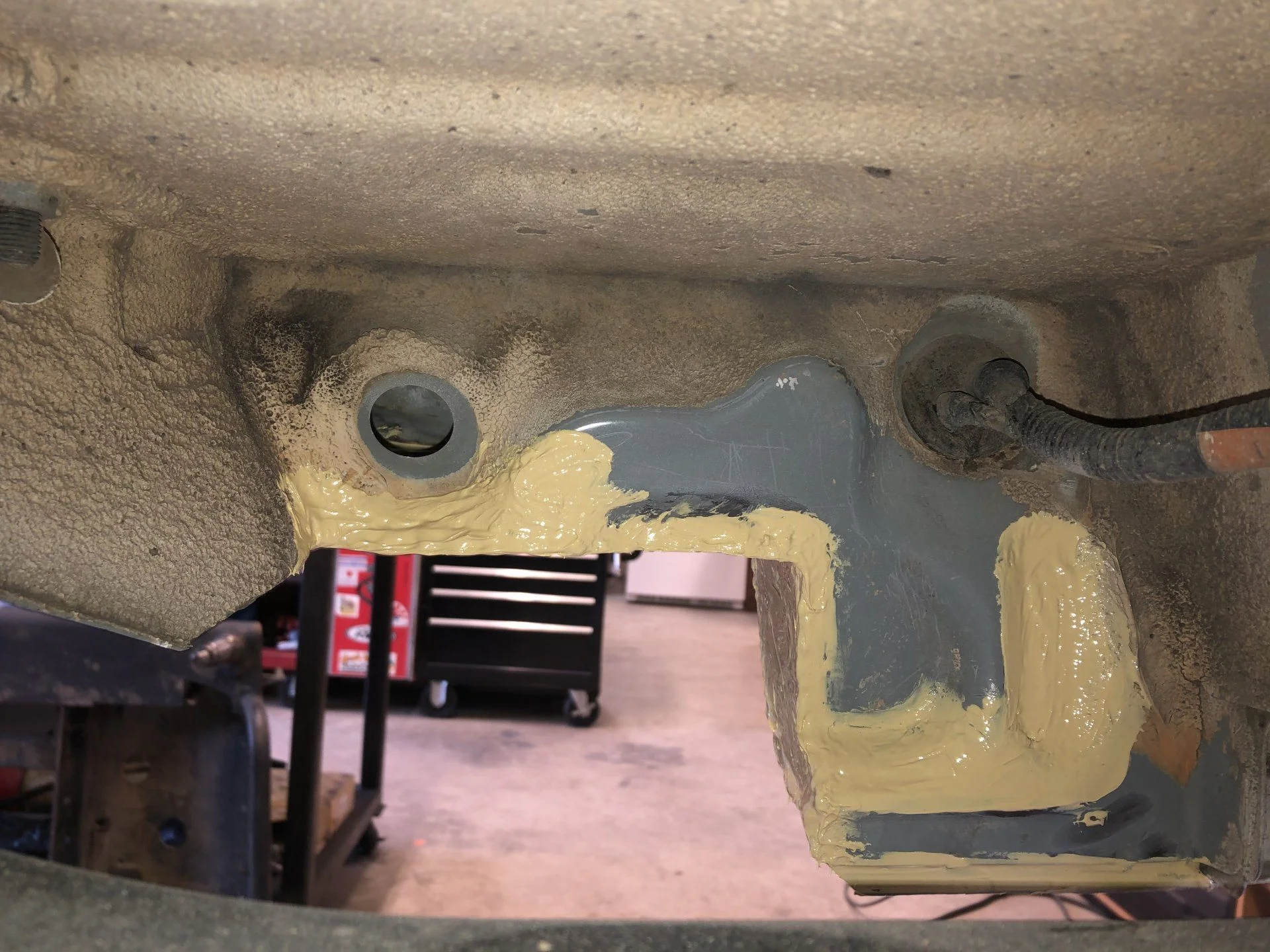

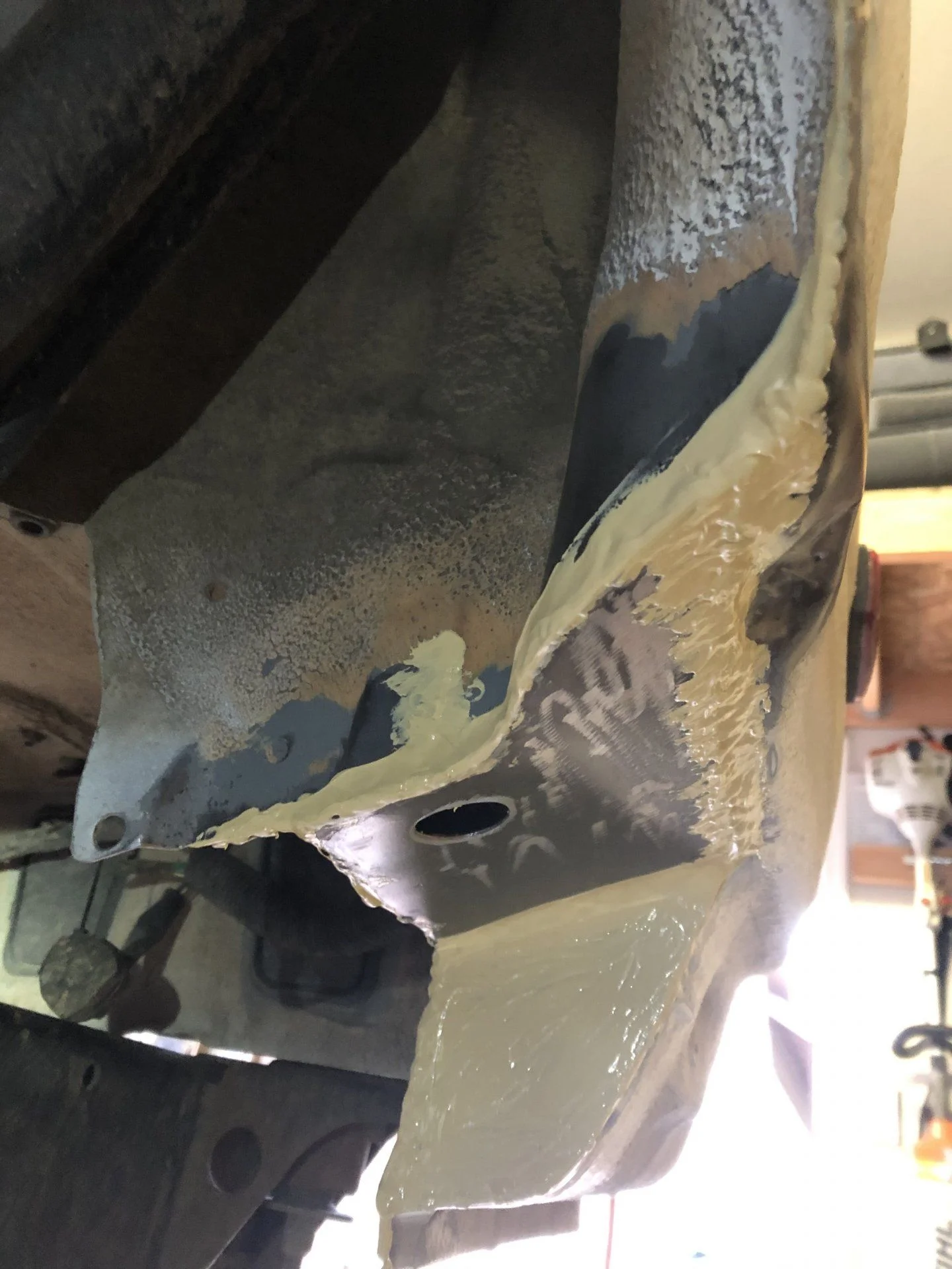

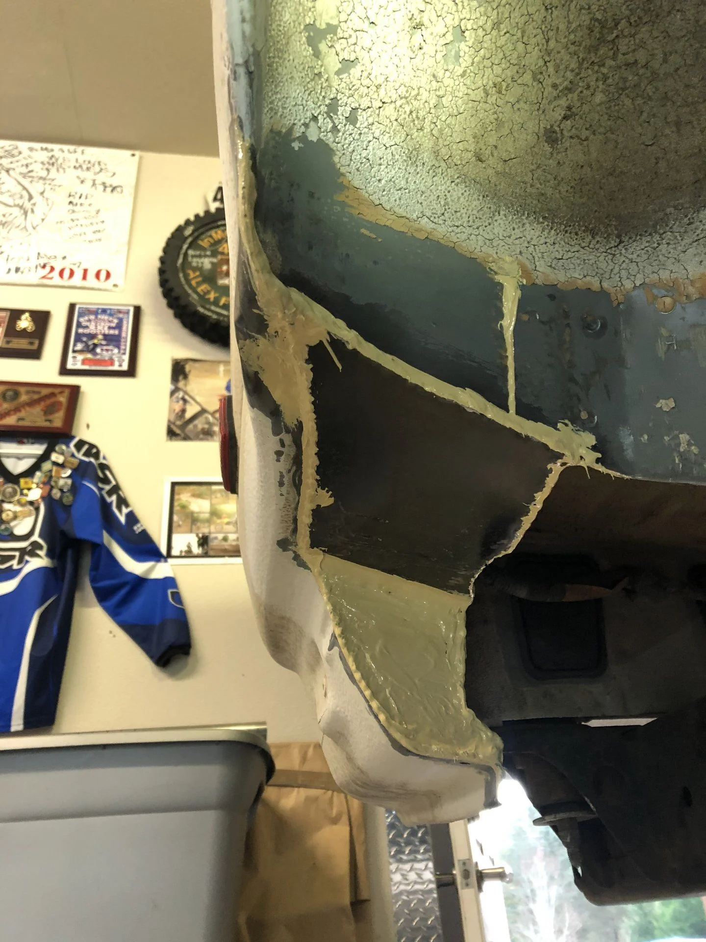

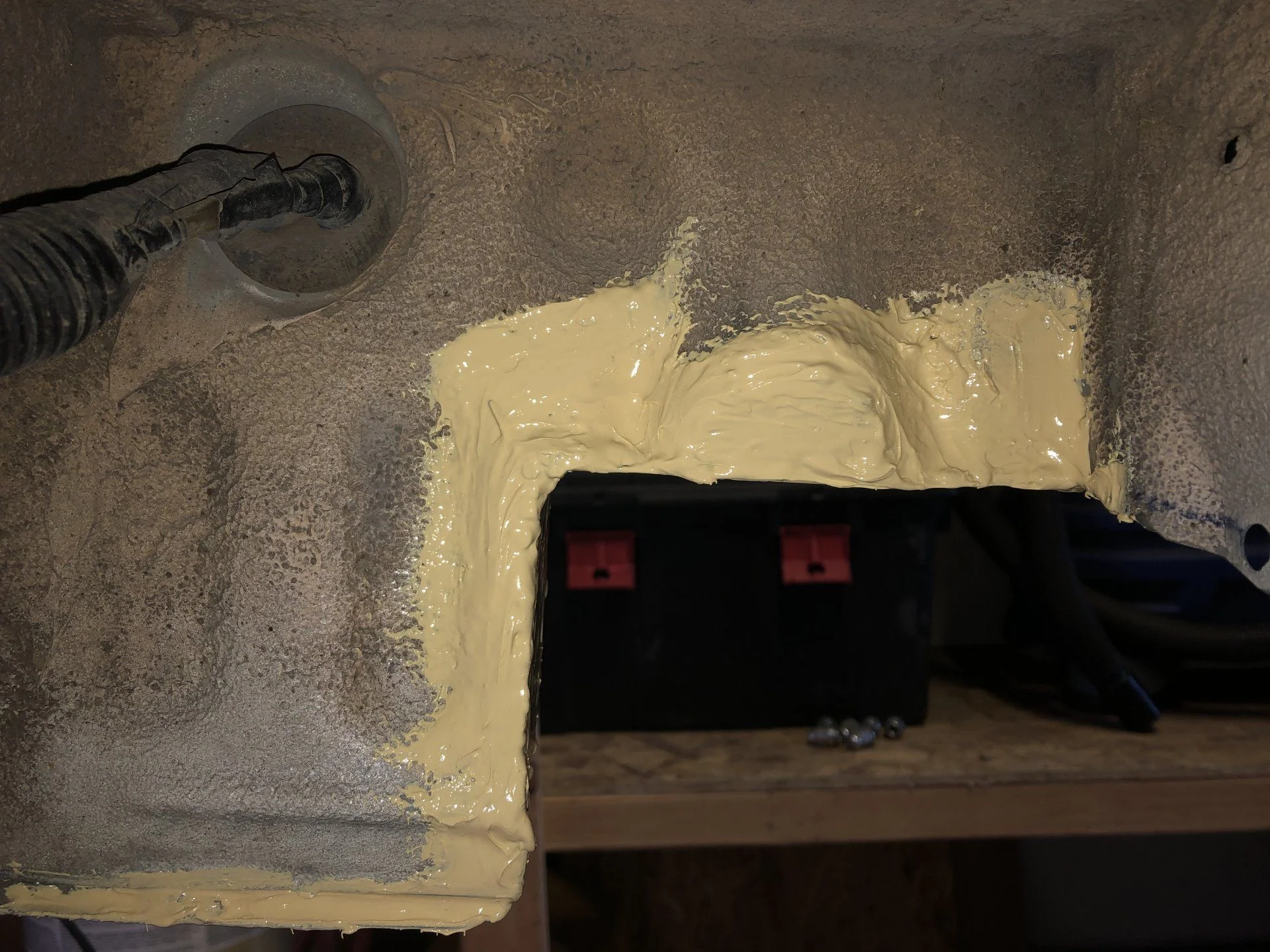

Both sides welded plates are in and seam sealer applied. The quart of Monstaliner should arrive tomorrow for top coat.

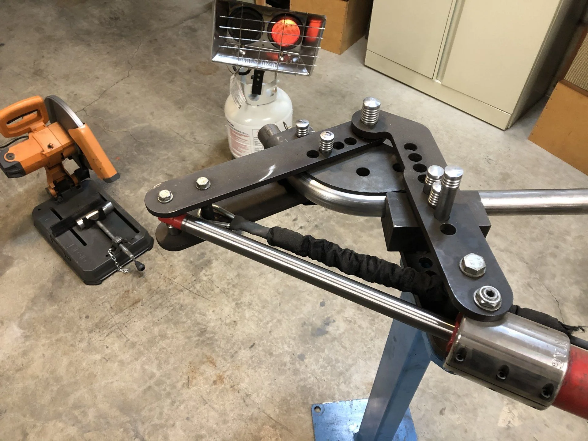

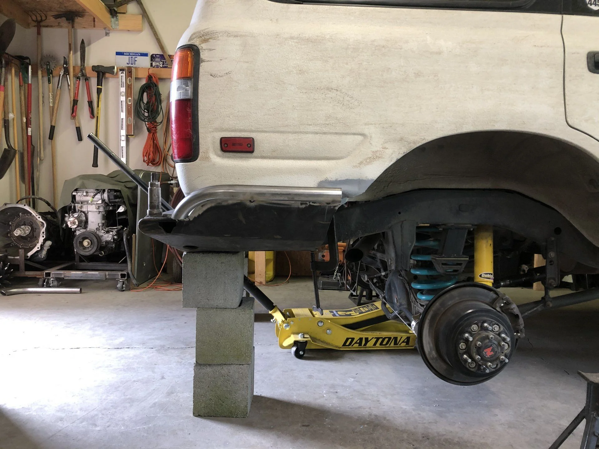

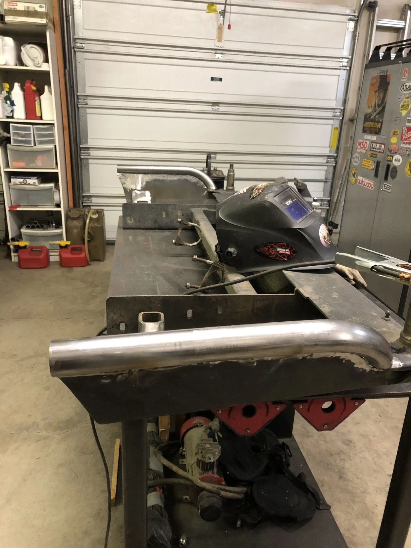

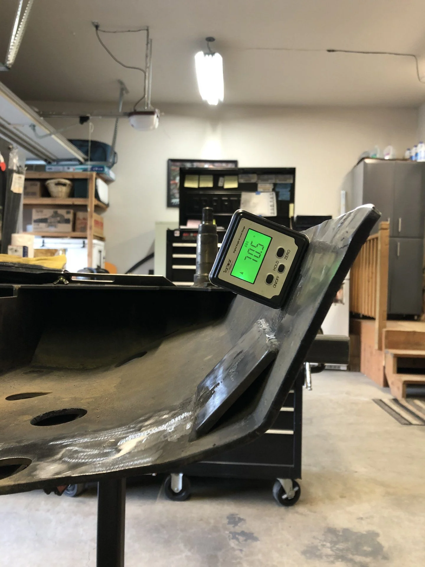

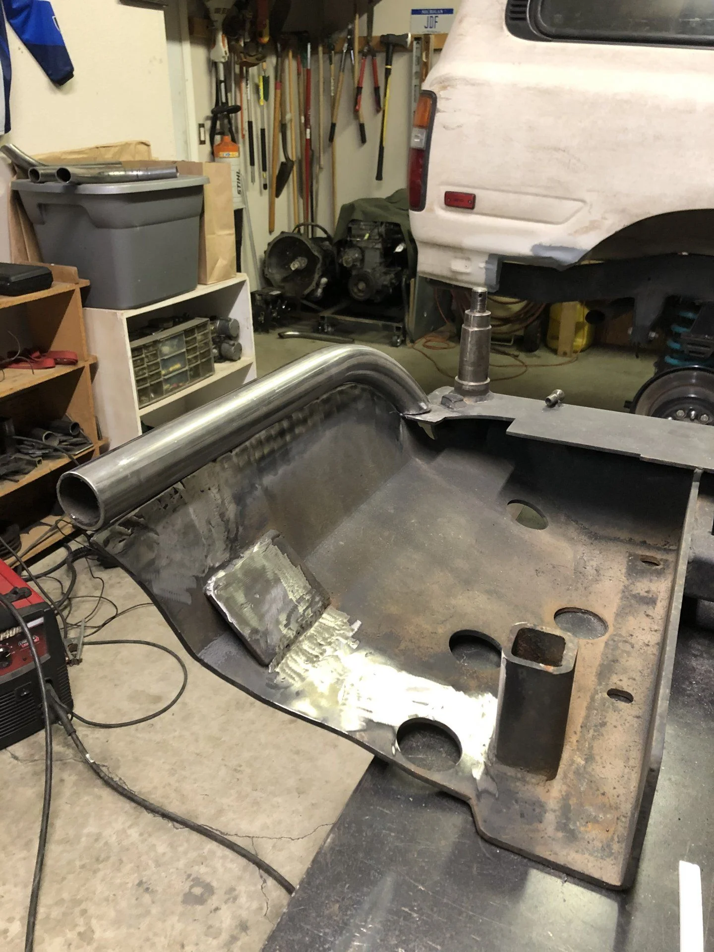

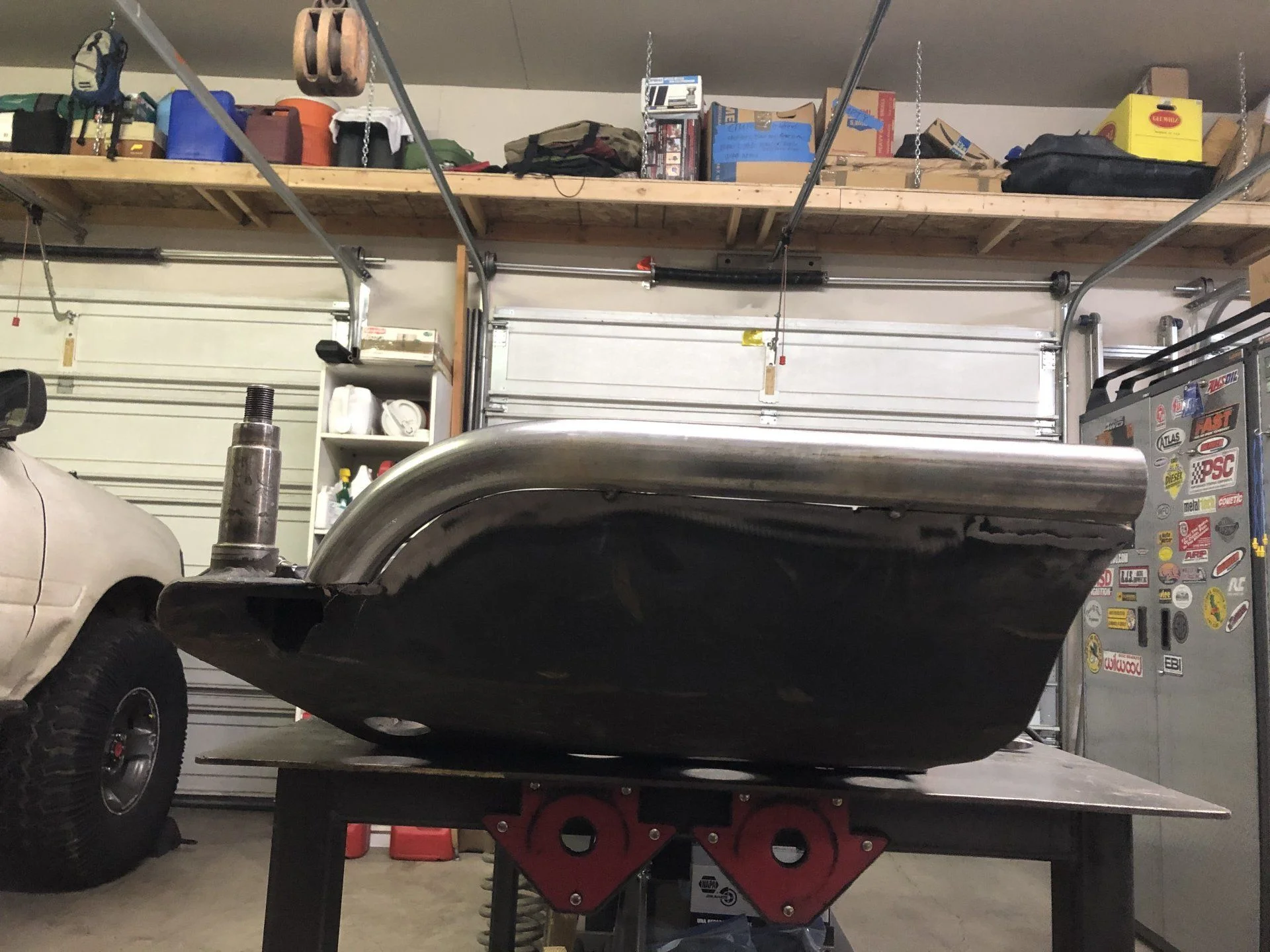

I managed to make some progress today. First thing was to finish grinding out the old web. Then we bent a couple tubes and tacked them in. After breakfast tomorrow I’ll bolt the bumper in and figure for wing support.
Who makes that bender? Ive been eyeing the Swag one.
The bender is a Woodward fab that I bought used several years ago. The collar is from Swag and the ram I picked up on eBay.

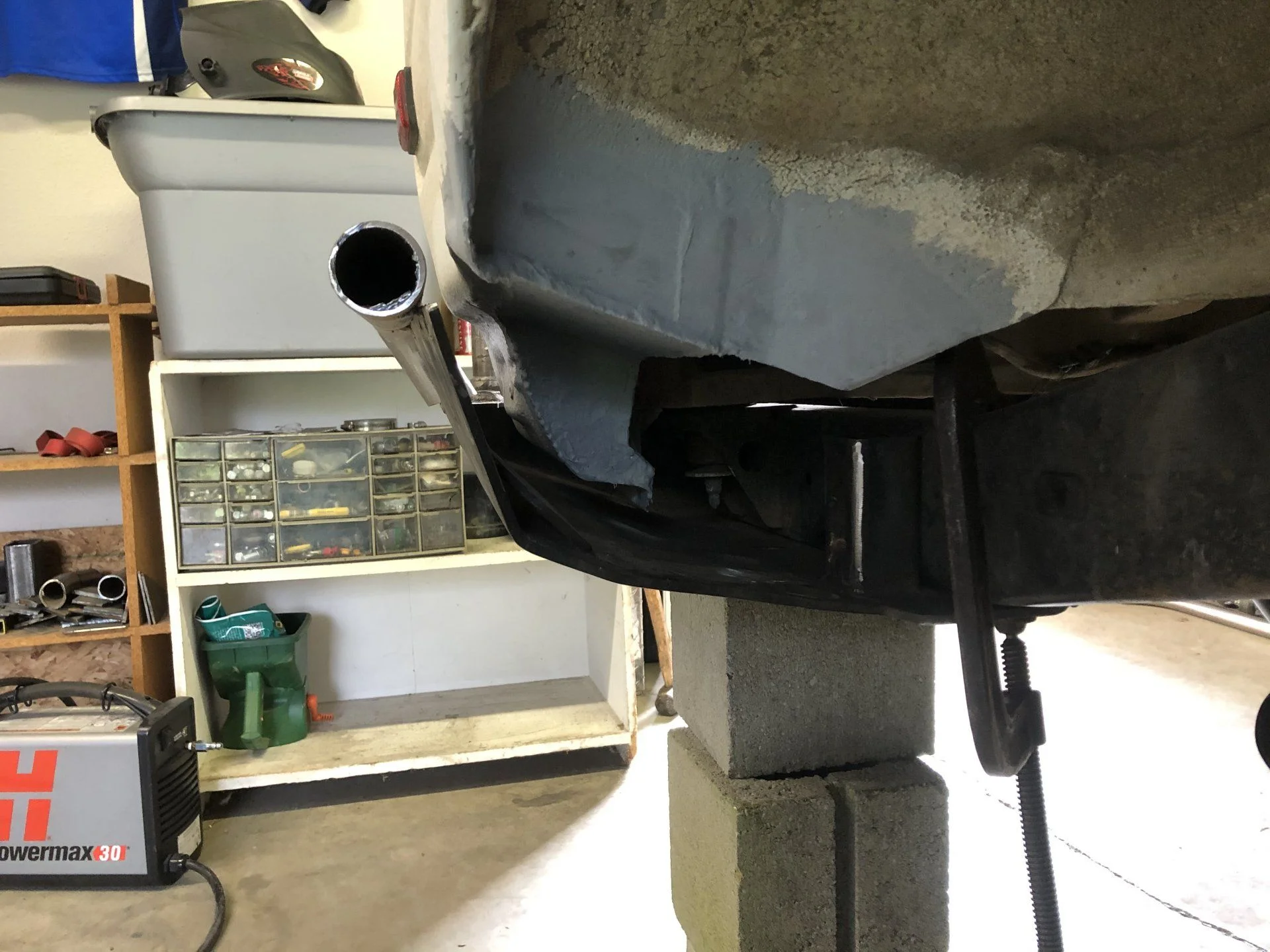

I had to back up two steps and relocate the tubes on the bumper due to clearance issues with the body. I’m still thinking that time would have been better spent building an entirely new bumper. Moving forward.

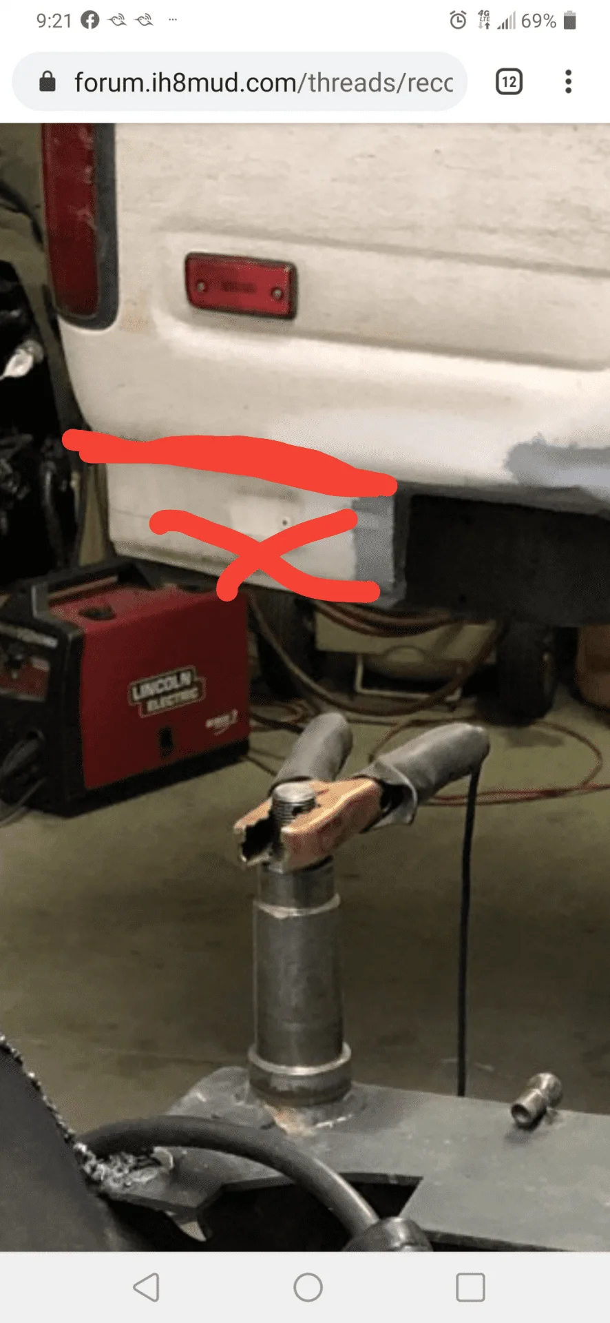

Building a new one will take a long time. But if your at that point. Cut all that off in the rear body and really get the departure angle way up. Then build a new bumper with your new found 4-5 inch of body removed. Thats a big job tho and will net you the most clearance
Cut that red line all the way around sides and back. Reweld and seam seam then build a bumper.
Red X’s! LOL! I had some sexy tube work going on when I left a pin in the wrong Hole, bent that pin and may have shut the bender down until I can get another pin of that length. We’ll see in the morning if that pin was absolutely necessary to the process. If nothing else, I’ll have time to sweep the floor.

We are talking about forces in the tons of magnitude. The pin was 3/4” thick. This just gives me more time to think.
Although a bumper with better departure angle could be built, If you look at the first picture in post 370 you can see that the frame is just a little lower the the body so cutting that area off really doesn't gain any departure angle. I still hit my rear bumper even though it's higher & and closer to the rear but I rarely get hung up on it, it just bangs and drags along.
The real gains are in moving the sliders up and chopping the rockers, That where the Fat lady gets hung up and high centered.

So yesterday after a cup of coffee I went out to assess the damage to the bender. She’s nothing more than a boat anchor now. Both upper steel plates are twisted and three of four pins are also bent. I was so intently focused on the tube and degree wheel a lot of damage took place before the ram speed began to slow down enough for me to notice.
New bender on order as of yesterday. I called Woodward fab directly. The lady was knowledgeable, friendly, and helpful but also the bearer of bad news, OUT OF STOCK for a week or two.

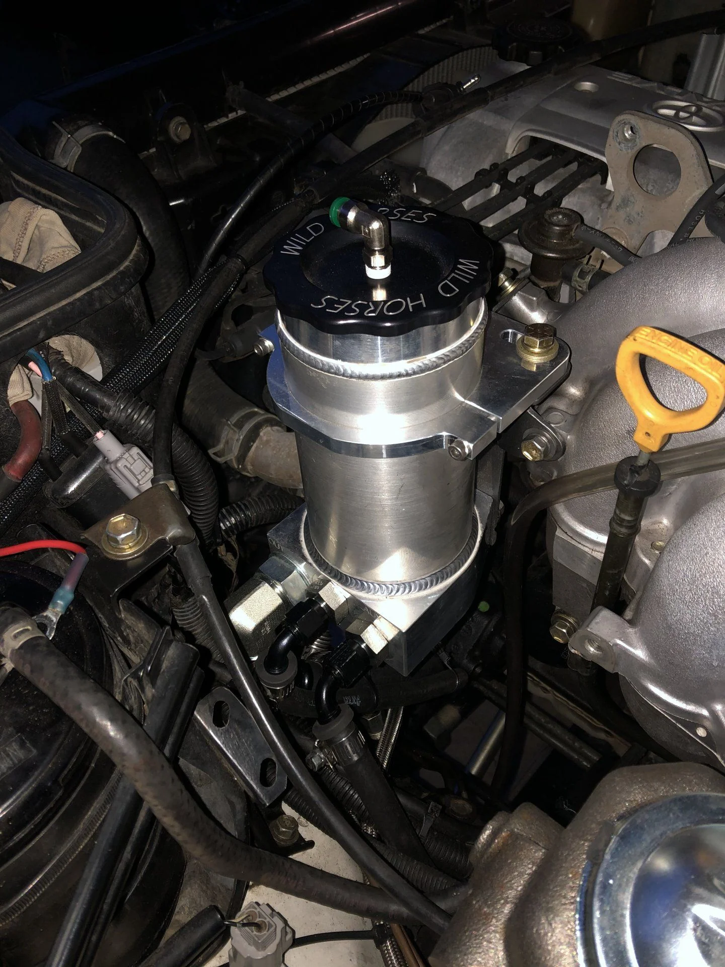

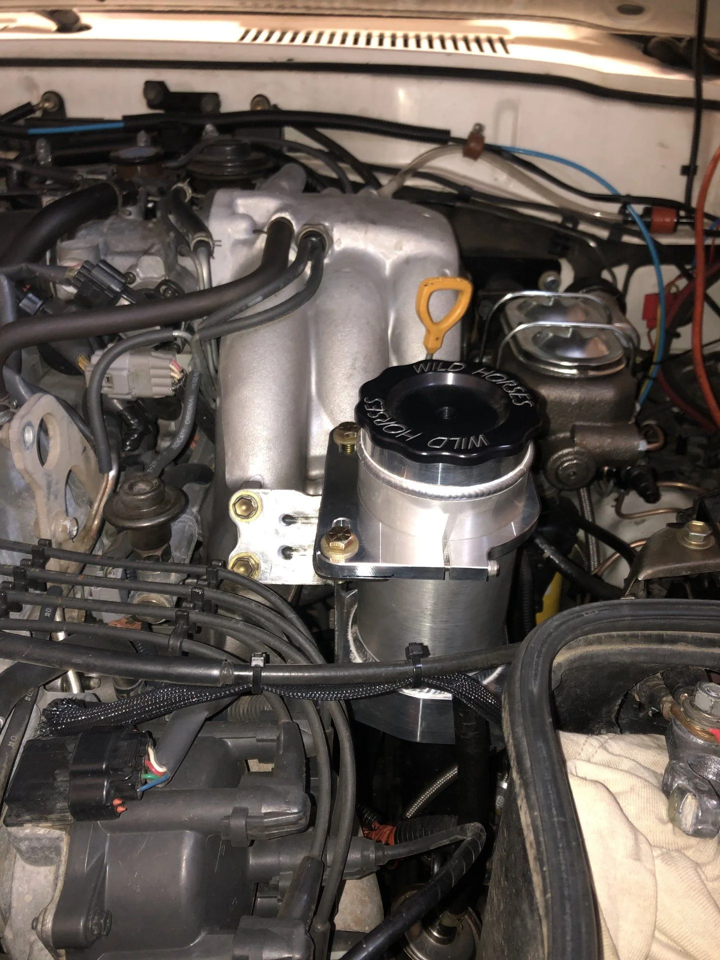

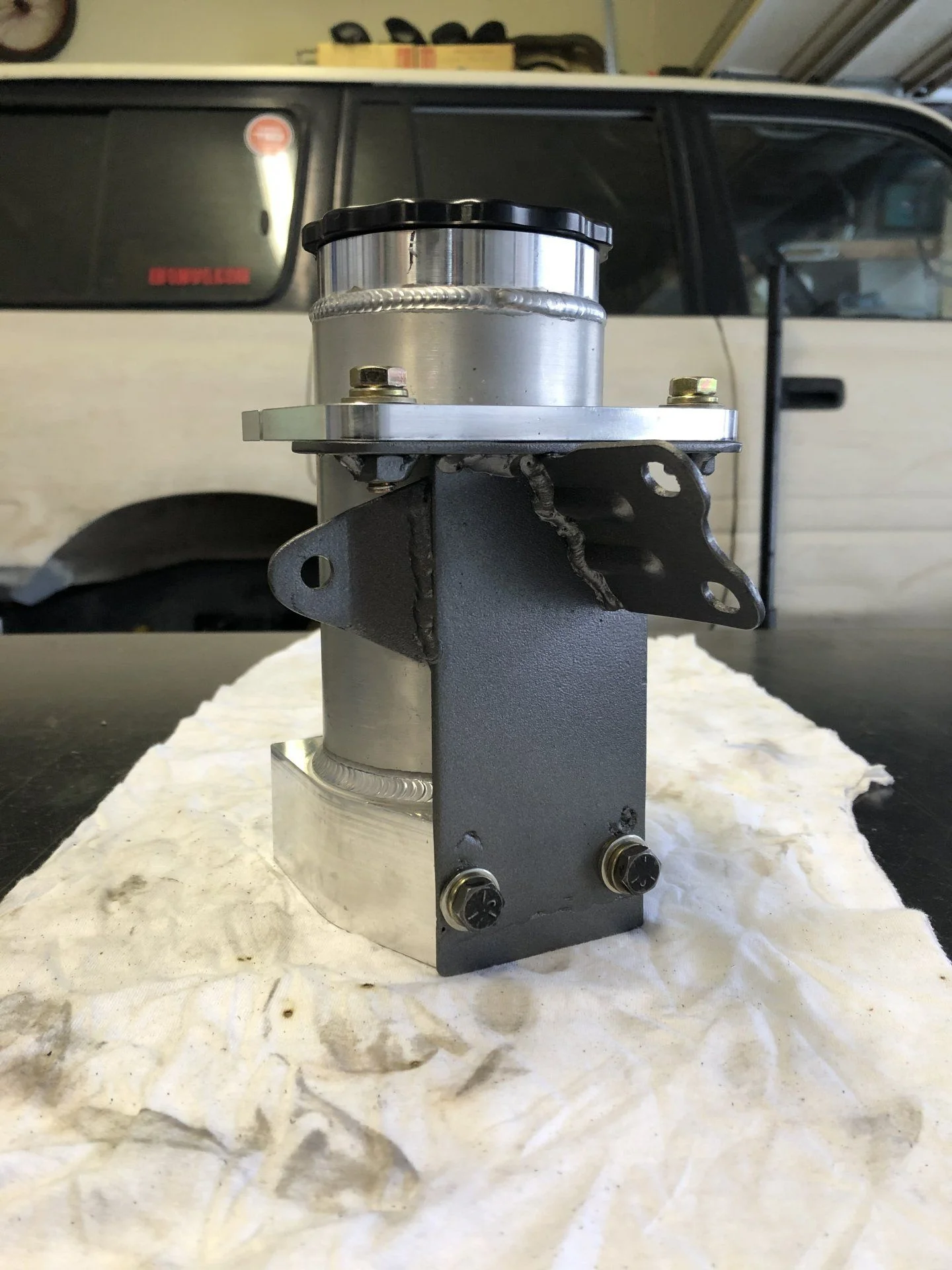

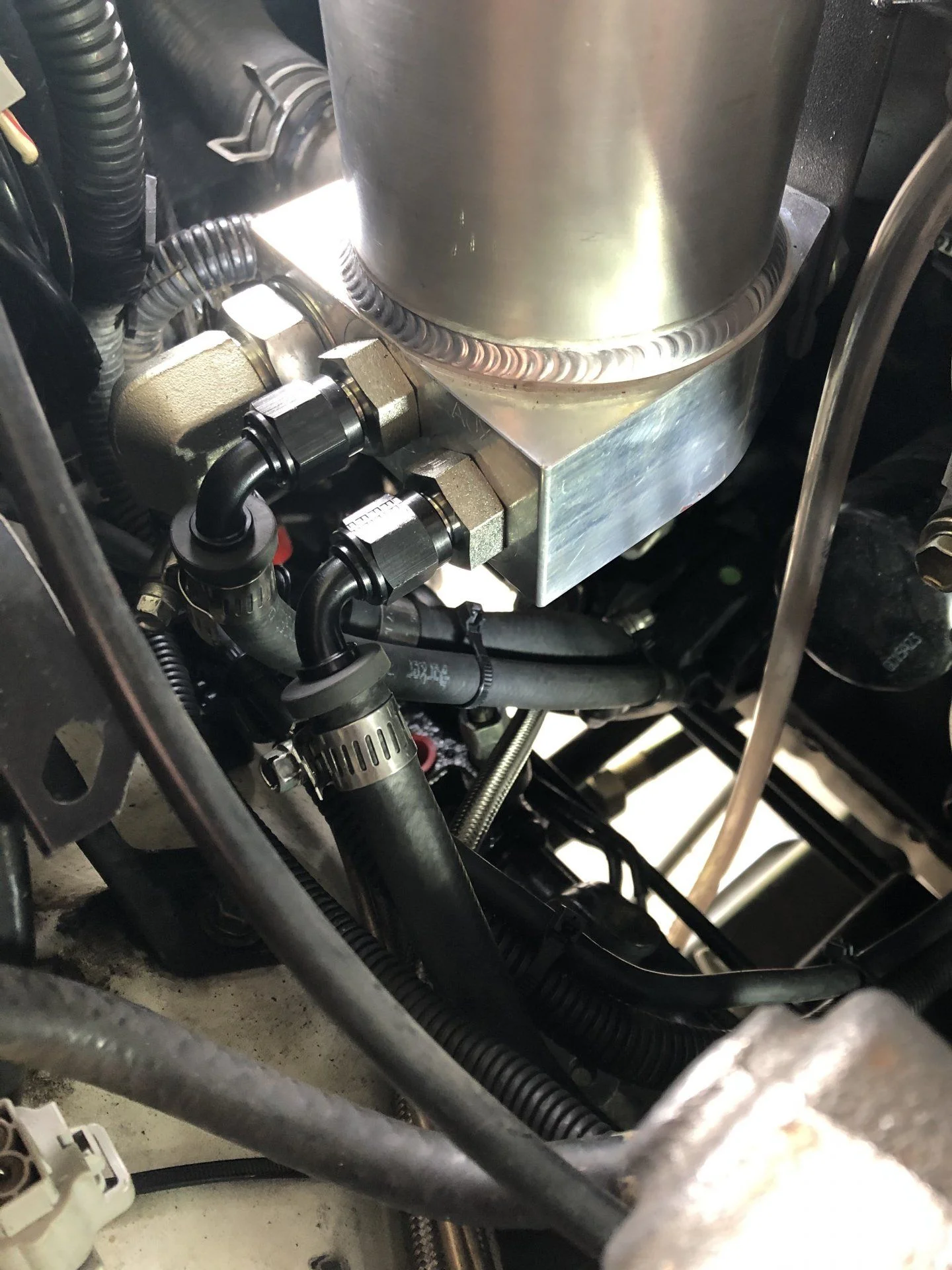

If you’ve read my disorganized mess of a thread you know that I swapped out the brake vacuum booster with a GM hydro booster almost two years ago. So, since I’m considering (will) installing a hydro assist ram I felt it a fine idea to replace the factory PS reservoir
with something larger that also incorporates a second return port that would be dedicated to the brake hydro booster. The reservoir is actually a PSC unit that was made for a Bronco specialty shop in Lodi, CA called Wild Horses, hence the logo etched into the lid. It has a Napa brand filter on the inside.
This involved making a bracket for the new reservoir. I began by removing the bracket from my extra factory reservoir. In the end I only use the portion of it that has the two bolts facing forward where it mounts to the intake plenum. The rest was made with, basically, 1/8” thick steel.
The hose is Parker Jiffy hose in 5/8” for the pump feeder and 3/8” for the returns. The fittings are -10AN push lock for the feeder and -6AN push for the returns. Supposedly clamps are not necessary with this hose and fitting combination but I clamped them anyway.
