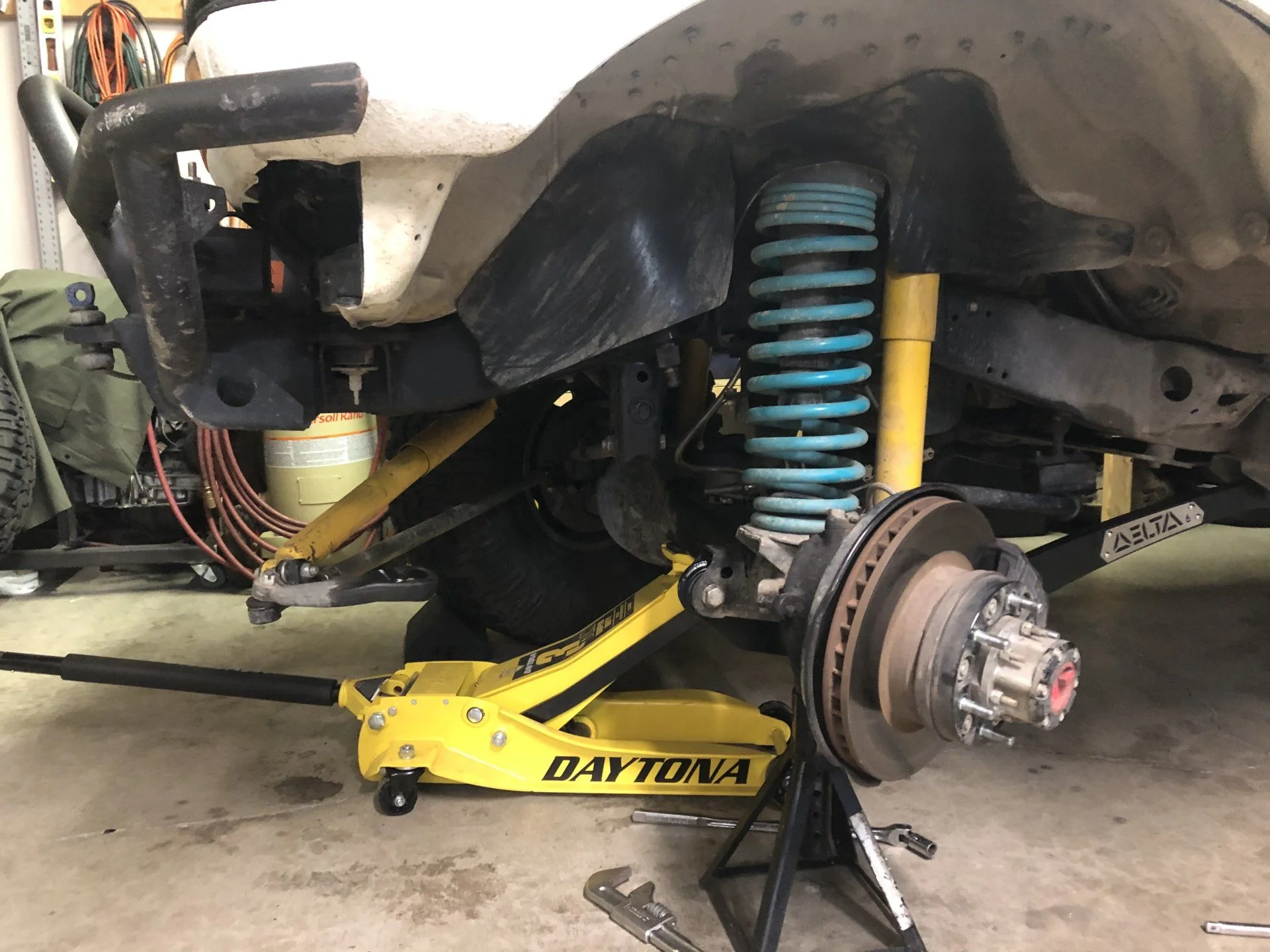

The newly designed Delta Radius arm with more tie rod clearance and an additional 1 degree of castor correction. These are the 6” version. I have yet to flex out the front end so I can’t speak to there functionality. Just like Delta Vehicle System’s originally designed arm, which these replaced, beefiness, quality, fit, and finish is top notch.
The set I had been running lives on under @shocktower 80. He actually did both swaps at my house recently and reports a much better handling rig. Thanks Thomas....
The set I had been running lives on under @shocktower 80. He actually did both swaps at my house recently and reports a much better handling rig. Thanks Thomas....View attachment 2112770View attachment 2112771View attachment 2112772View attachment 2112773View attachment 2112774g ri
I do not do well standing around, I love doing stuff like that thank you for the other @Delta VS arms I am now a safer driver
