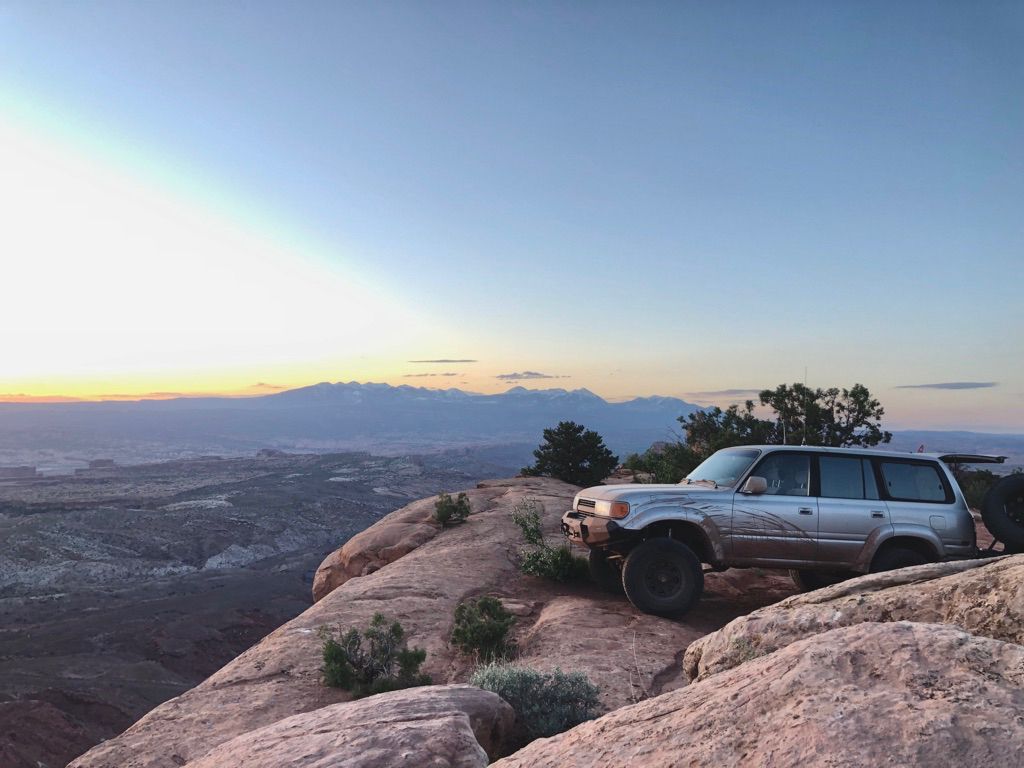

Rig did quite well at Cruise Moab! First time I've ever been to Moab for anything and I had a great time. Will definitely be going back there.
Side note, I won the first raffle of my entire life. Got a full rear axle re-gear/rebuild set from Nitro. Chrome-moly axles, 4.88 r/p, and bearing kit. Pretty excited about that. Since I JUST finished installing the t-case gears in the 94, I'll just have to use the 4.88 to put in the 92. Axles are definitely getting upgraded on this one though!

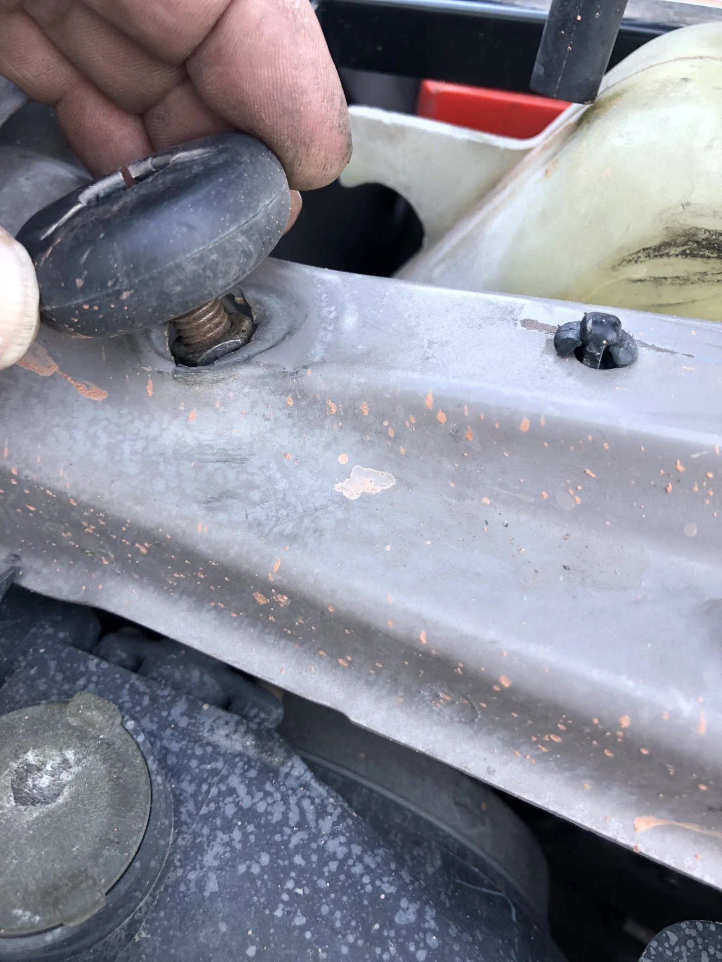

Any body seen a better way to fix this than just welding it up (hood stop or whatever you call it)?
Weld it or sandwich a flat washer above and below with the nuts.
Weld sounds like the better of those two options to me. Thanks for the “trailfix” idea in the future though. I guess I was just wondering if somebody (one of the members/vendors) had come up with some genius little doohickey for fixing.
