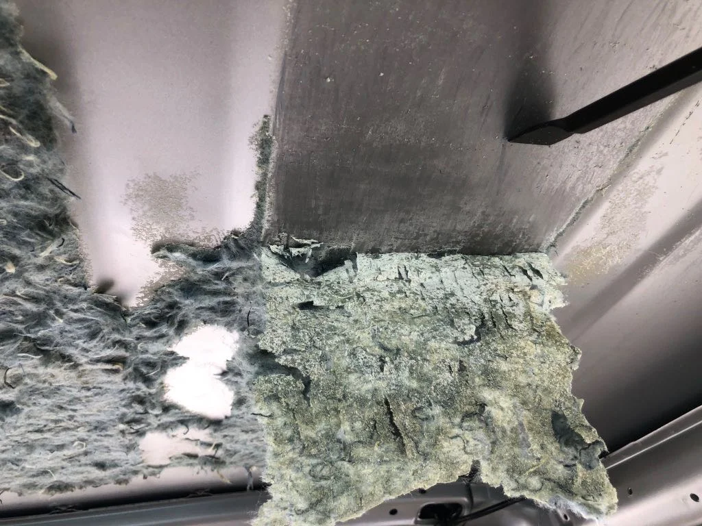

Anybody had any GOOD experiences removin this stuff? If so, any tips?
Or hard plastic brush
I said “good” experiences!! :)
I tried that and I don’t think I had a good enough hrs plastic scraper. Ended up with metal one that scratched the “ceiling”. Will have to spray some clear up there or something before covering in hushmat.
Some guys use a wire wheel on a drill.. that would remove the paint I think. Without using a chemical of some sort, like a paint remover, using a scraper is about it.
Just spray some primer on it and let it dry real good, then slap on yer hush matt.
welp, THAT was a garbage job! I tried all kinds of different things, ended up with a sharp metal scraper to get it off. Took ALL of my patience to not just go nuts and get it done as quickly as possible. Even taking my time there is plenty of missing paint now. I hit it all with a good coat of clear enamel almost immediately, so hopefully that will inhibit rust well enough for the next few decades. Hushmat should be here today, that won't take long to put up, then I can get the new (to me) late model headliner up and figure out what to do with the sunroof hole (in the headliner, not the roof).

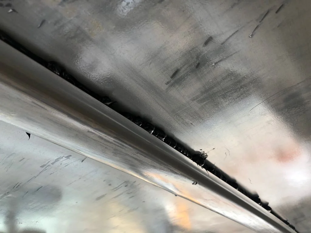

used an entire tube of 3M windshield goop to reconnect all of the cross members to the roof/ceiling as well. It has become completely separated, so the roof was one gigantic steel drum. Could get some pretty sweet Caribbean sounds out of it. I will also be "bridging" for lack of a better term the hush mat from the roof piece to the cross members in an effort to add some support as well.
Hushmat stuck up there. Drove around for a while with a few pieces up to see how it reacted to serious heat, no issues apparent so I went ahead and covered the whole thing. A LOT less noise and very nice.

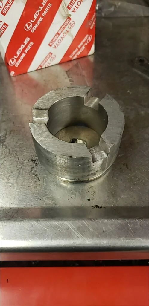

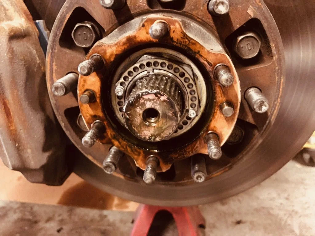

Swapped the rear hub too, since when I put the Nitro axles in I stretched the threads out of one hole a bit, and it’s been leaking since. That took a lot longer than expected because I had to make a socket to get proper torque on the 3-pronged dealy.

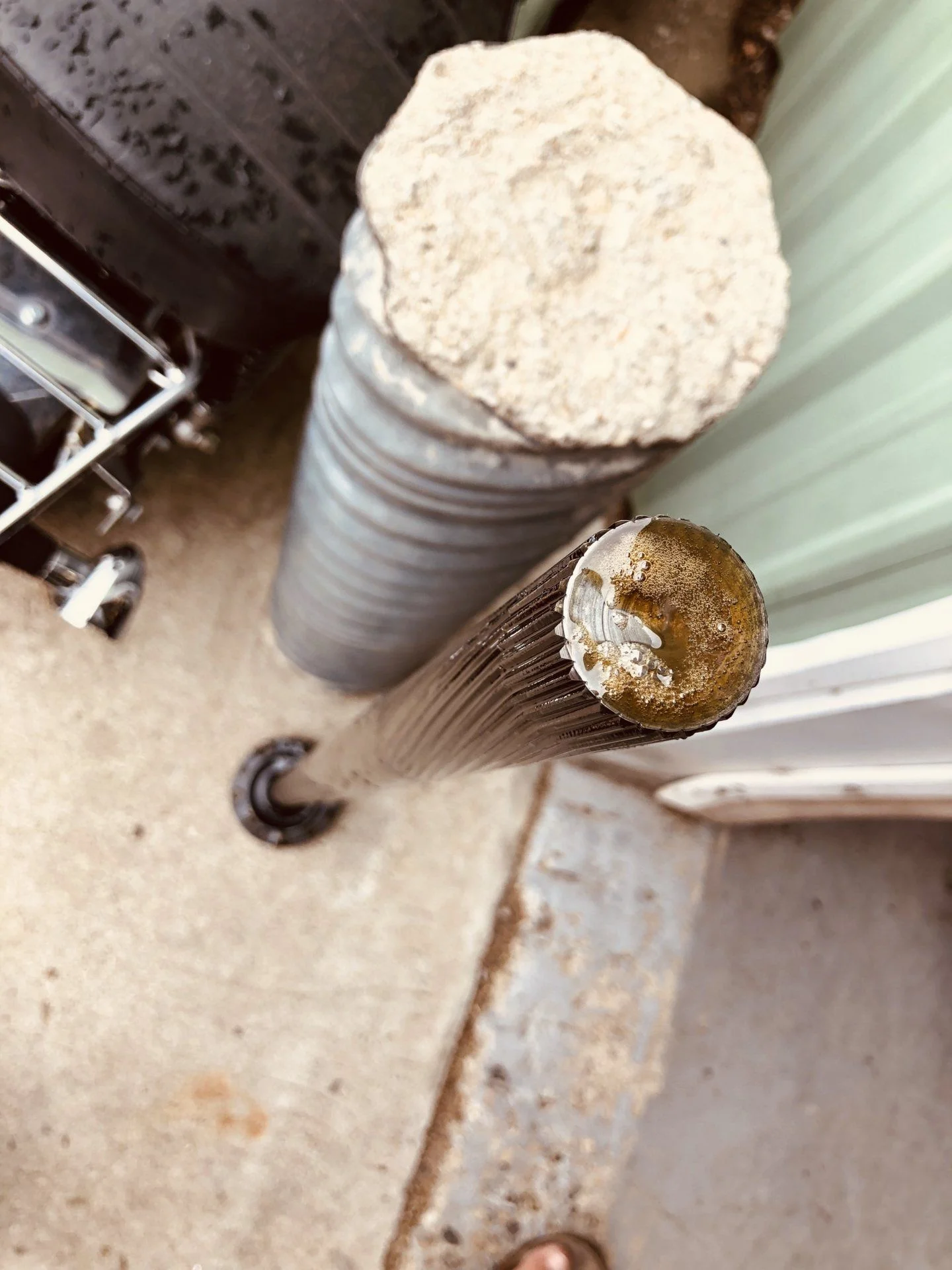

And this has me SUPER concerned about the passenger side... :(
Word directly from Nitro, twisted axle is a NON issue. "Put it back in and expect years of use moving forward"
I really am worried about the other side though :(
Member @RFB posted pics of twisted Nitro’s recently too. I run Nitro’s and broke one at Moab a couple years ago. Your post tells me I need to check mine for twist.
RCV just came out with an axle set for the rear of an 80. Each axle consisted of two pieces; the shaft and flange are separate. If I’m not mistaken, the flange end is 32 spline.
I don’t dig the idea of running a known twisted shaft either.
I had a tough time swallowing that as well. the Nitro rep texted me "our axles are amde for what you do" I dont do pritchett canyon or #sendit none of that I do wheel it most defintely. and I switched to 300M and am making all needed changes in rest of driveline to deal with the axles no longer being the "weakest link" so to speak. OEM axles never twisted, but I did go throught birfields pretty regular.
