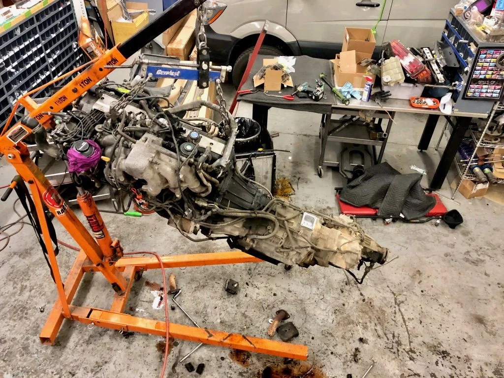

Donor rig is a little emptier now
1900549
Nice find, I had a blown hg and thought about engine swap but I eventually decided to stick with the most reliable option.

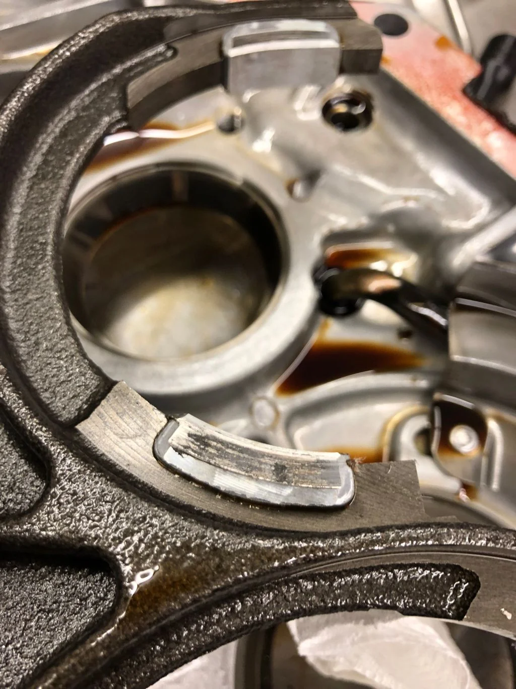

One of the shift forks is pretty messed up. Have any of you who have actually been inside one of these things seen anything similar?

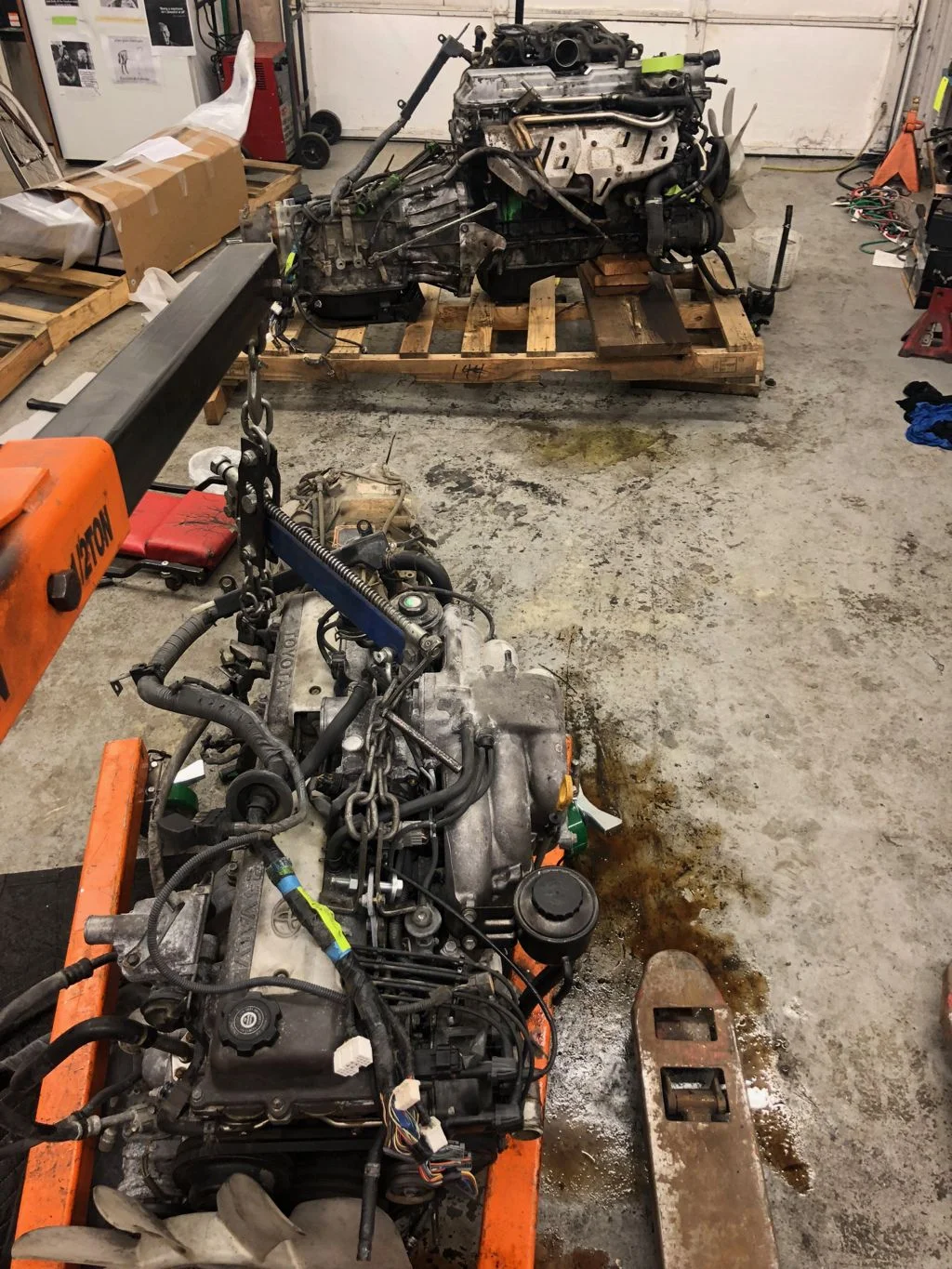

these engines are multiplying. hopefully I will be able to combine and get one decent one to tide me over until the 4bt is finished.

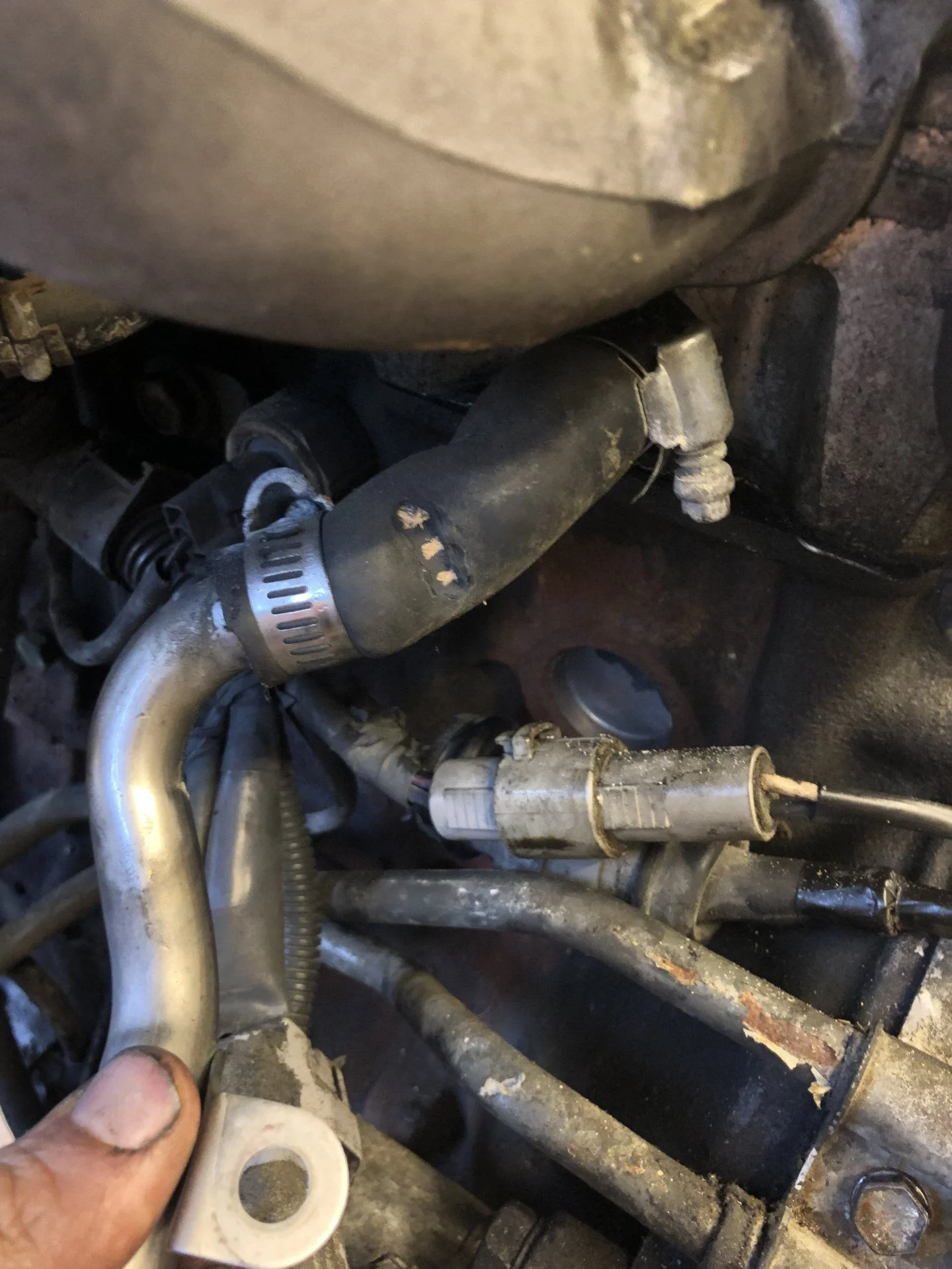

Replaced this and the little one next to it while the engine was out (PHH FHH), peace of mind while waiting for diesel and time. Couldn’t see this wear until I undid the bolts and completely bent the tube out of the way. Glad I was able to change.
Also had to repair the EGR tube while everything was out:

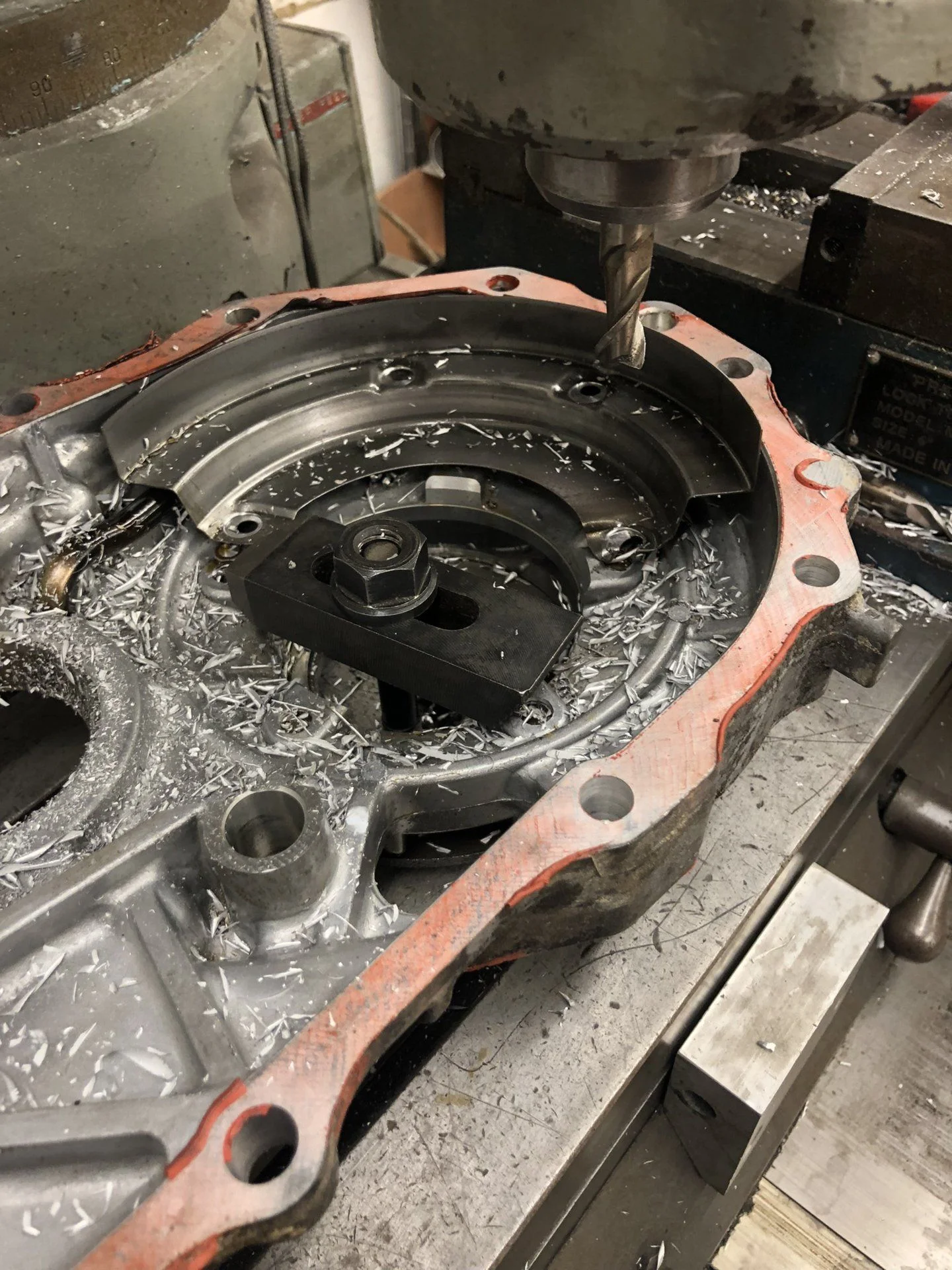

Decided I’d rather have a bunch of metal CHUNKS inside my case than metal DUST, instructions for the low low t-case gears called for grinding the oil slinger rivets out but I just put in mill to cut them. Much more fun. Clearance the fork shaft hole with end mill while I was in there as well.

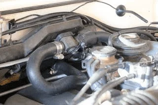

So with engine swap comes new engine issues. Both engines seemed to idle fine before the swap even though the otiginal was dumping coolant in the oil.
Now the swapped engine is not idling nice. Between nothing and 900 or so. Did some searching, mostly says vacuum, will be reinspecting all that (looked closely and inspected before putting engine in).
One thing I kept coming across is "there is no idle adjustment for 1FZ". I see screws that seem to be for that kind of thing, does that only apply to OBD2 rigs?
Any input appreciated.

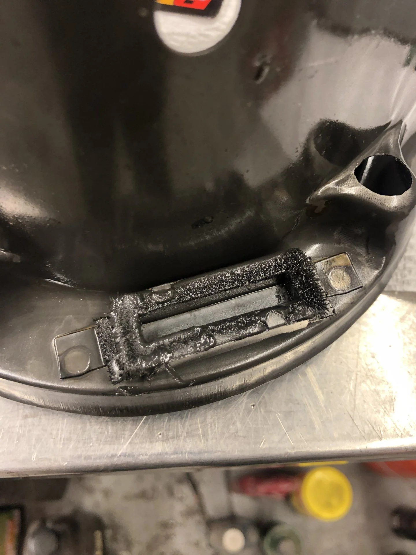

Not super stoked about having to remove this obviously useful magnet from the t-case system when installing the low low gears, but I guess that’s the price I pay for wanting to go slow.
I’m sure it’s been posted before, but here is a comparison of the idler shaft low range gears, stock on the left, 3:1 on the right. I was pretty impressed with how close the big gear got to the side of the case without touching, but forgot to take a pic :(
Newer cases dont have a magnet:frown:
Yes a tight fit in the case
