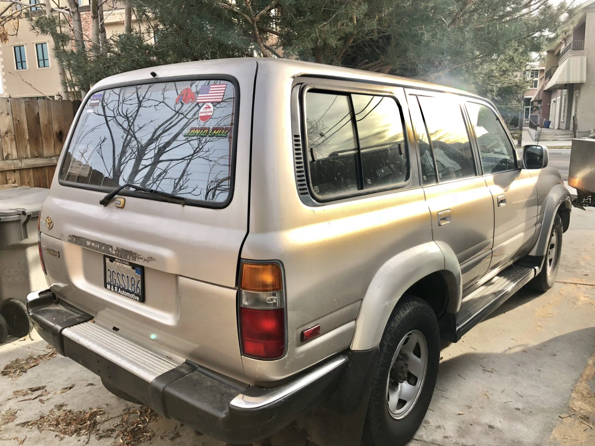

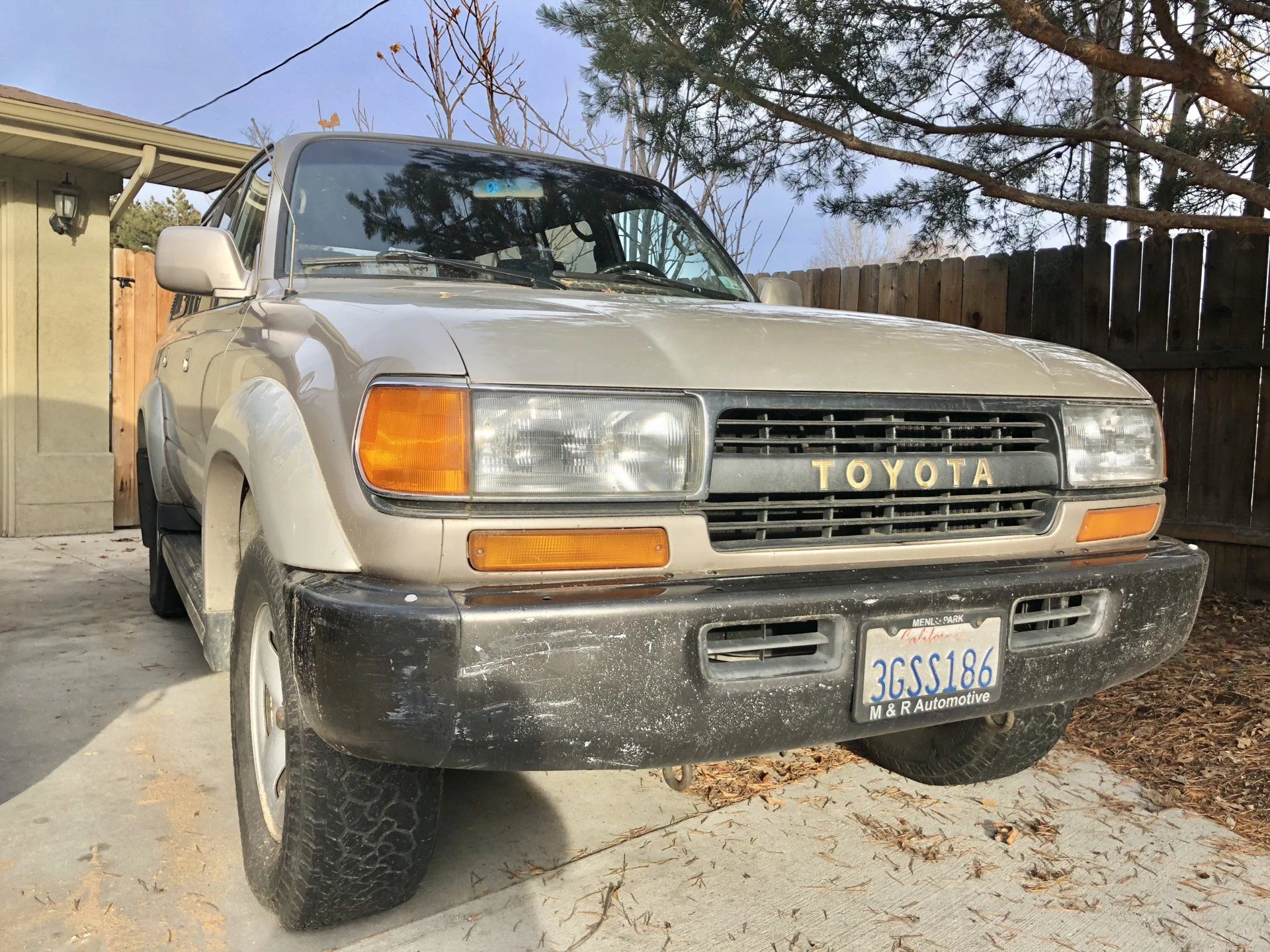

Got a 94 with seriously blown head gasket not too long ago. Going to swap engines with a locally sourced 1FZ until my 4bt is finalized and ready to go in.
Pretty sure it belonged to somebody here at one point, according to the guy I bought it from who ended up not being able to get it into Canada.
It’s a little rough around the edges, but I’m ok with that because I usually am too. This will be a daily driver and a camping/off-road rig, and eventually diesel (going to change up plans for my 92 to a v8 swap with some long travel goodies).
I’m seriously digging the factory rock sliders...

Those aren't rock sliders, not by any stretch of the imagination.
That comment was 100% tongue in cheek, don’t worry I won’t be “testing” them out :)

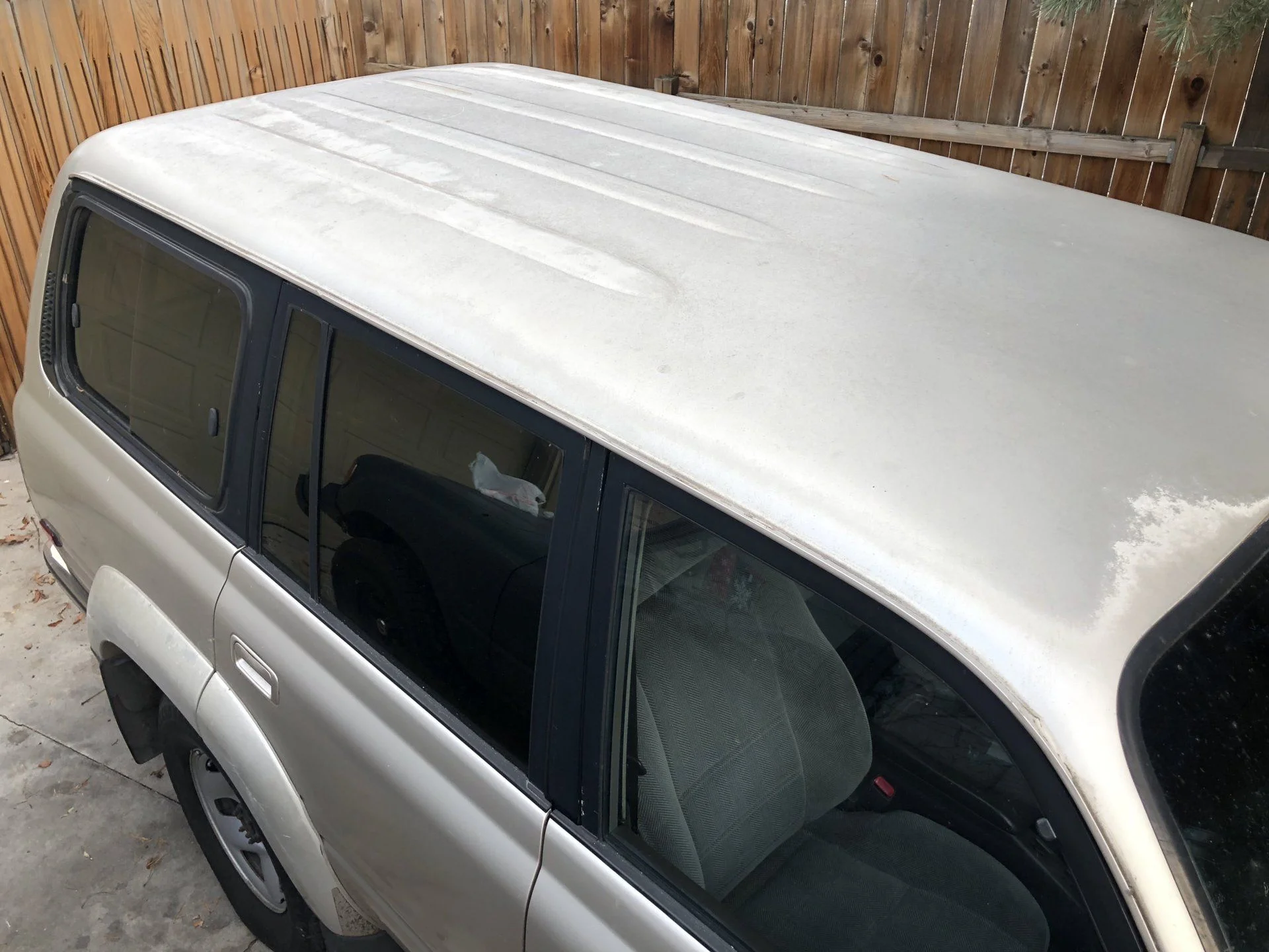

Also, I JUST noticed this thing doesn’t have a sunroof! Super stoked on that. Can’t believe I hadn’t noticed that before.

Also, it does seem to be the “poverty package” you speak of (although I thought usually included non-sliding rear windows?), and on closer look, since (I’m guessing) there is no sunroof, there is also no map light where the controls for sunroof usually go. Am I missing something there (it doesn’t look like it)?
Damn! Looks like you got yourself a unicorn there. No sunroof would be the preference of many of us. Cool rig.

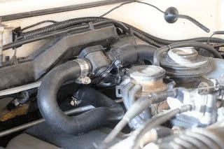

Finally getting around to pulling engine from the donor rig. Looking for some advice on things to do while swapping an engine. I will be cleaning the crap out of everything for certain, also thinking about getting one of those rear heater bypass hoses from @LandCruiserPhil and deleting that whole system.

I also noticed this engine has some pretty prominent egr. Worth it to pull head and clean, and replace HG while out? I’m assuming this rig had HG replaced by now, but can’t be sure. Keeping in mind this engine IS a stopgap until Cummins is ready.

@LandCruiserPhil just checked your site, can't find the heater bypass tube, is it still on there and I'm just missing it?
