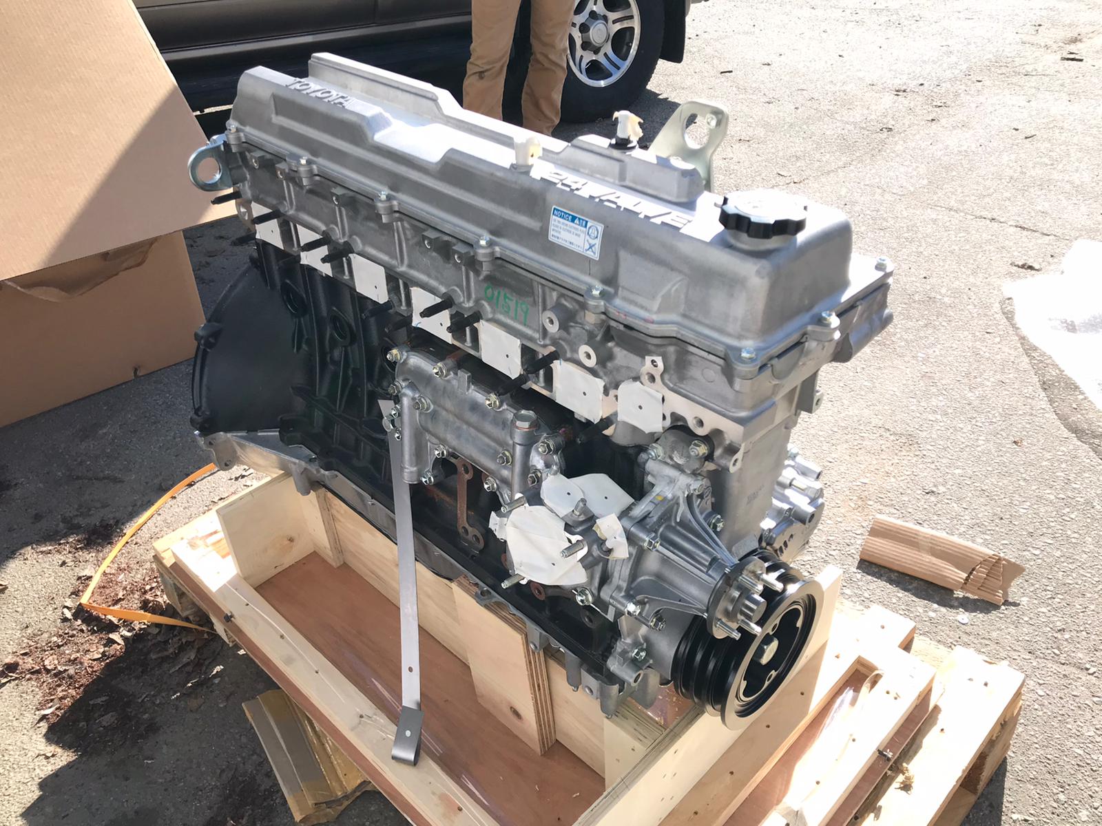

it's like Christmas in the summer.... This showed up, finally.
JARCO sends their engines on one side as opposed to being in a cradle? 🤯🤯

Yes, it was strapped down to a tire on its side which was strapped down to a pallet.
So JARCO uses oem parts and you have to order through the dealer? What's the cost of one of these if you don't mind answering?
I would rather not share pricing. They sell to dealers so you really have to go through a dealer to get one. I felt very fortunate to have the ability to get one without the dealer so I would not want to quote pricing.

That's how we received one to the shop as well. I was just as surprised.
Would shipping the long block on it's side save on shipping charges ie: lower profile so less volume and/or for less stress on the oil pans??
personally I think the way it was packaged and strapped down to a pallet/tire, I'm not concerned.
The intake was packed separately and wrapped in bubble wrap, strapped to the top of the wrapped motor. I do not think there was any way damage could occur.
