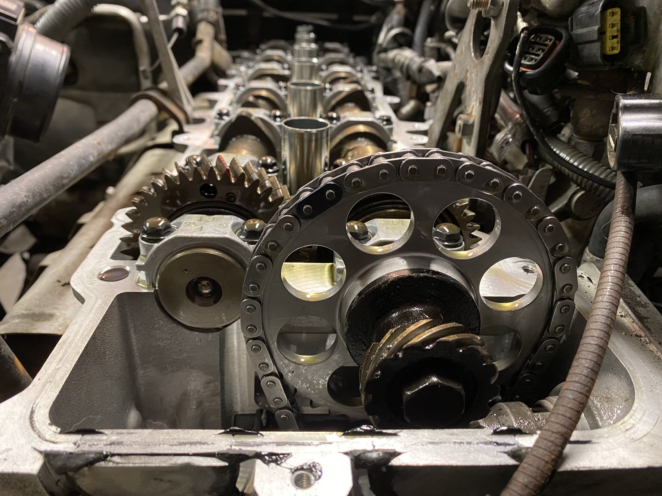

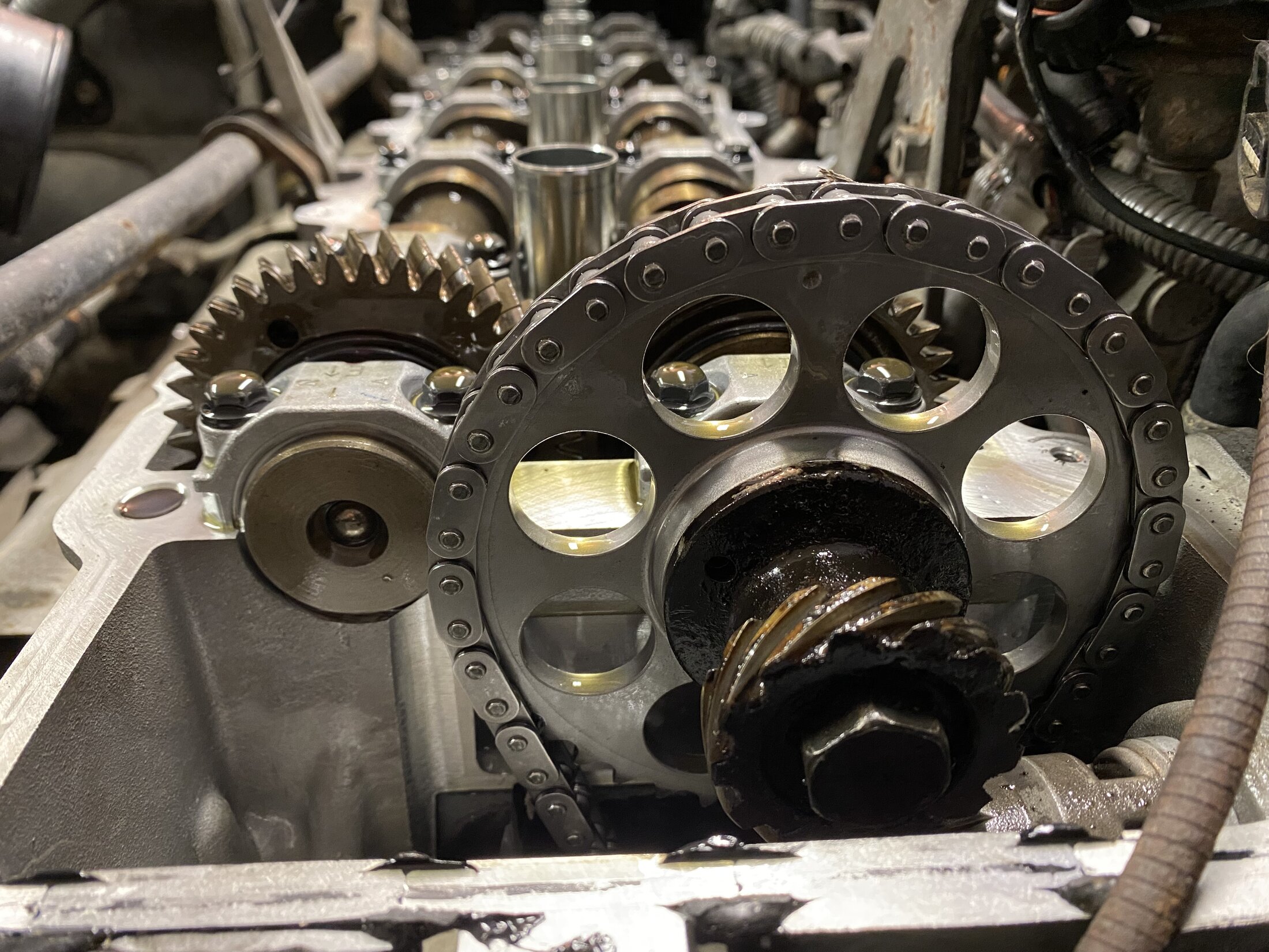

Next problem , i pulled the dist cap off this morning and i think it was off by a tooth cause the point was just past the connecter . so re did that and cleaned the connections on the oil pressure unit . showing i have oil pressure but crazy surging when starting
so i pulled valve cover off and my marks on the cams line up and my distributer seems to be in right spot
something i did notice was that when i line up the cams the dark link of the timing chain is not up top . did i somehow screw that up ?

is the cam gear spring under tension? did you remove the "service bolt"?
