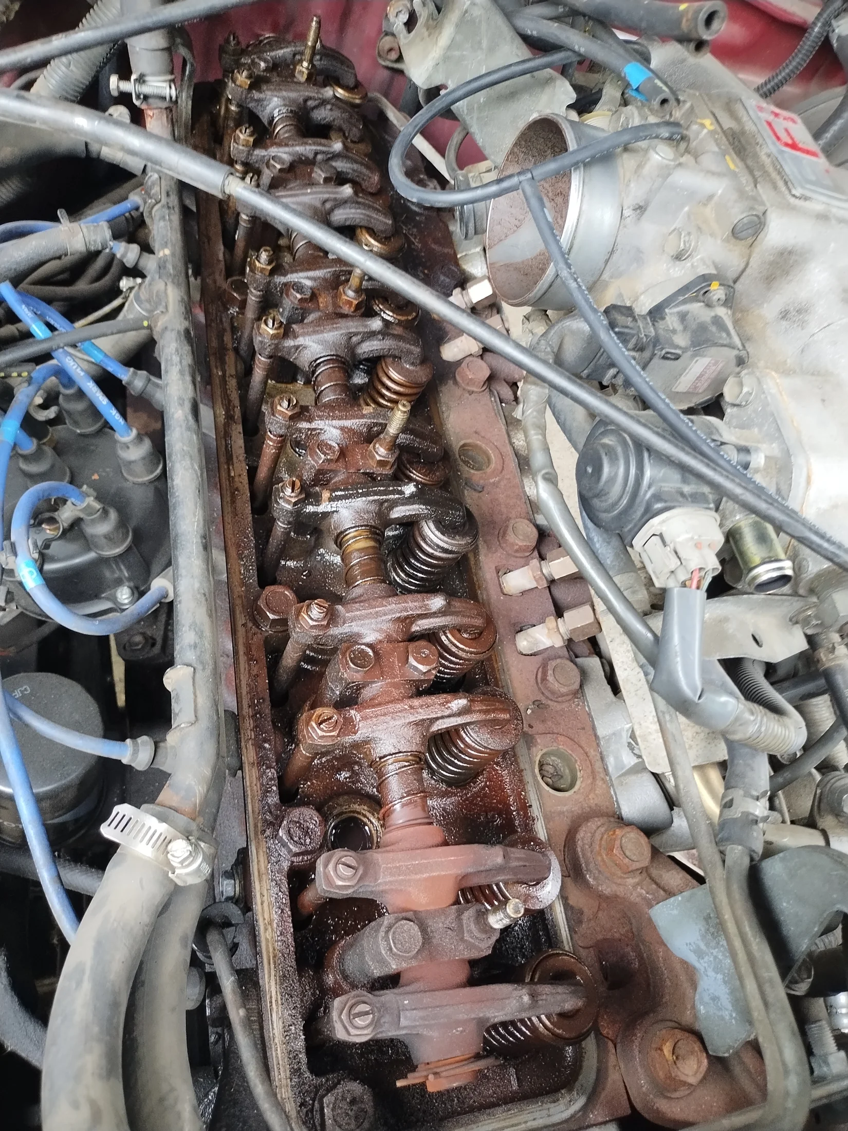

I finally had some time today to take the valve cover off and see what's going on. There is sludge all over the air induction hose and throttle body (you can see where I ran my finger over it). Under the cover, you can see that #1 rocker arms are bone dry. The bearing surfaces for those are toast. It's very sparkly around that area:
With motor at TDC, I checked valve clearances, and oh did they clear. #4-5-6 clearances were actually ok. #1-2-3 each have one valve that should have been closed in that configuration but they are open. So I've been running on 3 cylinders. Explains the loss of power and backfiring, duh!

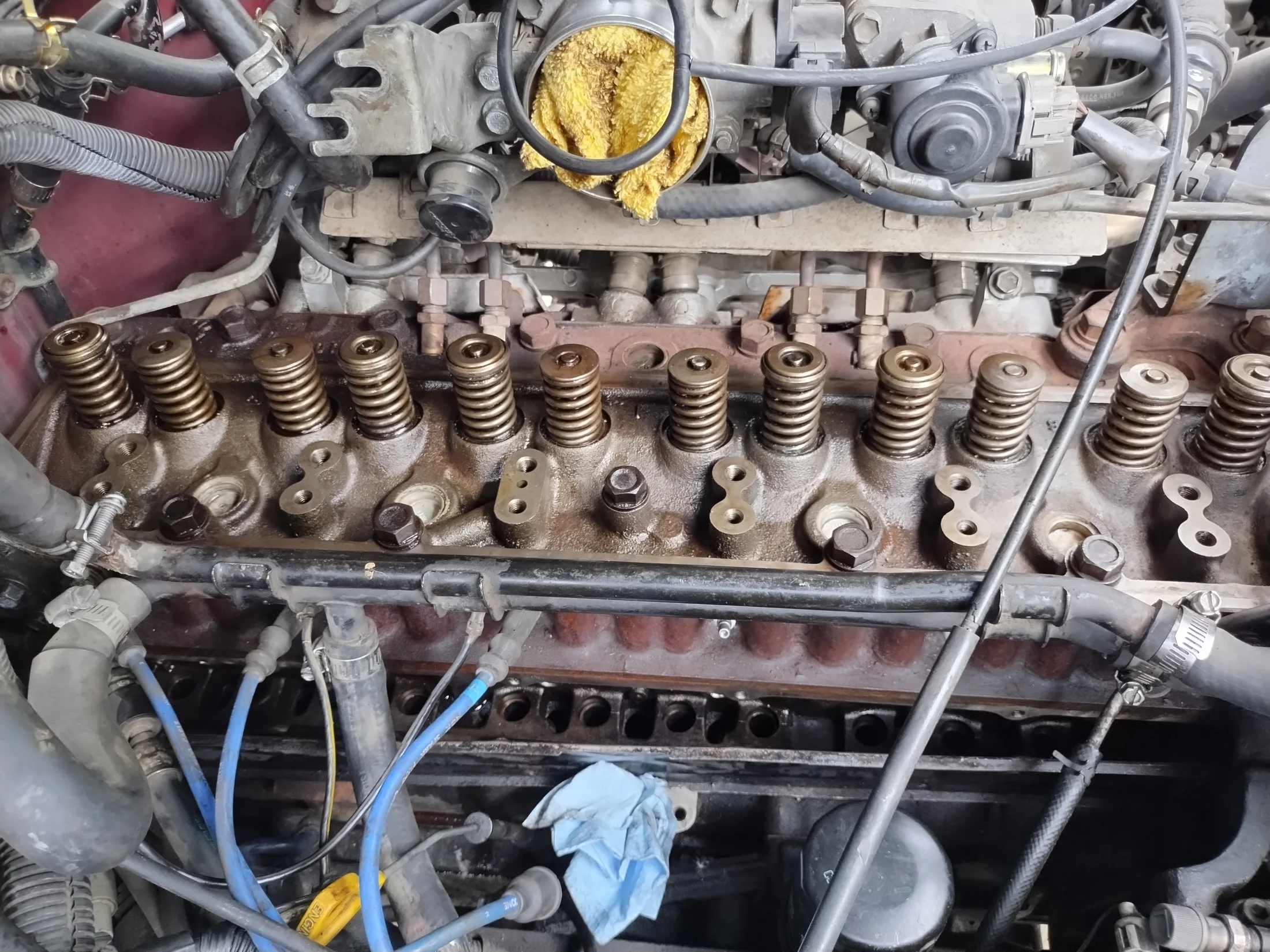

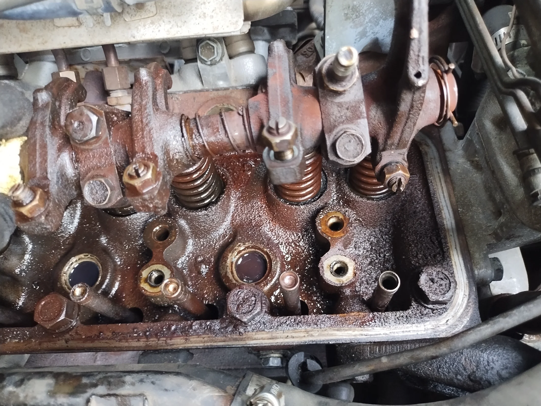

I took the rocker arm assembly out to get a better look at everything. The #1 and #3 exhaust valves punched a hole in the top surface of the push rods where the rocker screw makes contact:
My borescope fits into the pushrod bores, all I can tell is that there is a lot of sparkly bits in there. I realized that if I check all of them, I should see which lifters are up or down, which will give me some idea about the crankshaft, but with the metal down there it's pretty much settled that this motor is gonna have to come apart.
