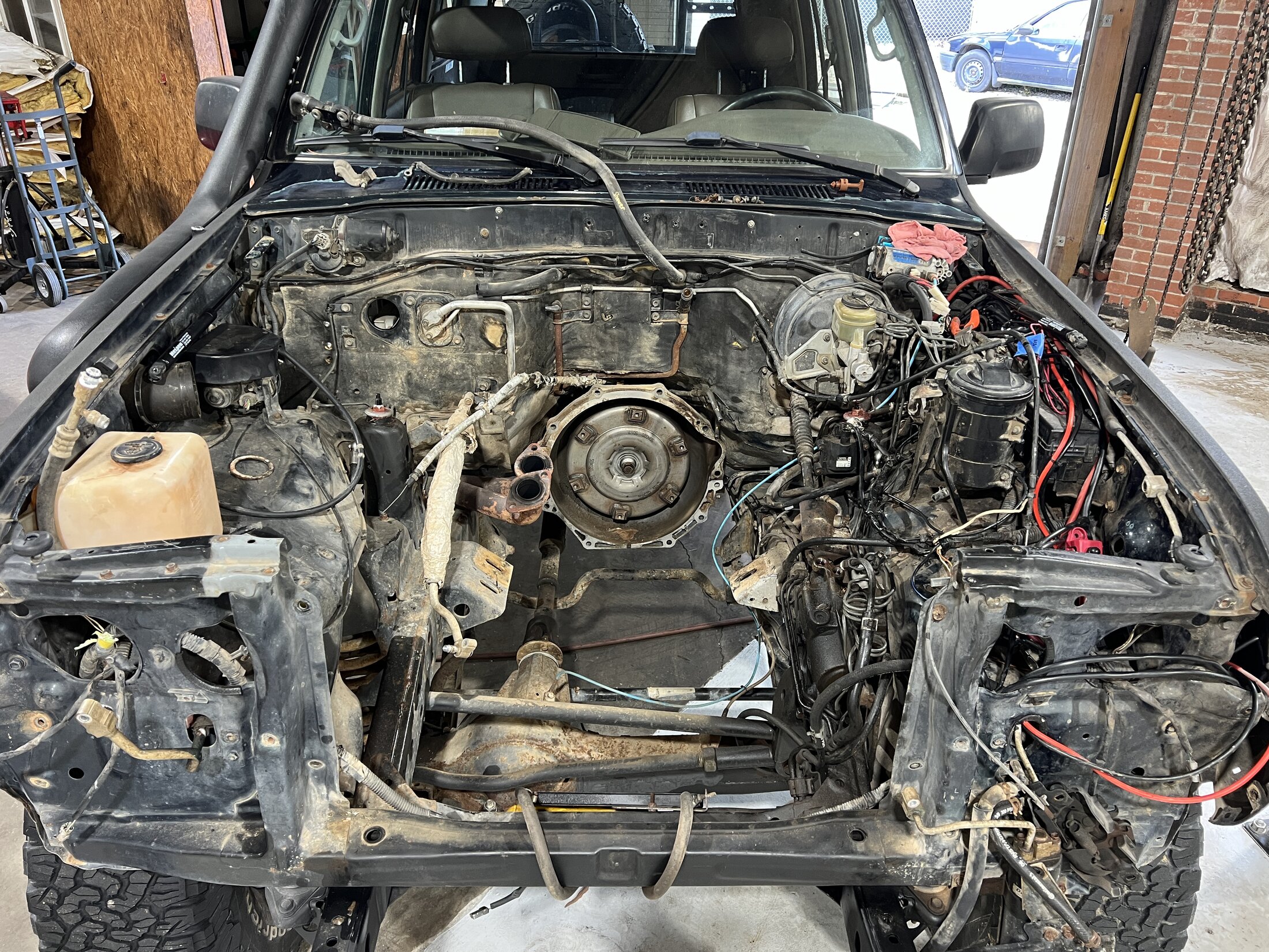

out with the old. Don't kid yourself if you think you can just swap out a motor. Once you pull things out of the way, you realize that sensors are from 1995, plastic pieces are from 1995..... hoses, belts, fasteners, ect...

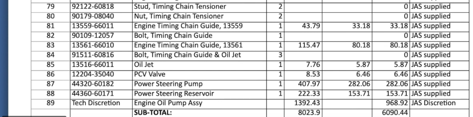

@decoy: Couldn't help but notice in your video above (3:35) shows a parts list, there was a price (no part number) for an Engine Oil Pump Assembly with a list price of $1392. Which part/assy were they referring to?
I'm guessing timing chain cover plus pump and bronze bushing
Typo on the price?
Oil pump is available assembled in a new timing case with oil pump and cover in place.
I purchased an Aisin one ( had the "Toyota" casting milled off) fairly recently for about $150, Toyota one was about $300 via Partsouq
The Aisin one was slightly different to my original Toyota one.
My original had grooves in the FIPG seal surface ( two gives in places) The Aisin one only has groove in critical spots, like beside part of the oil pump.
Not sure if that's a cost saving by Aisin, or a change by Toyota
Typo on the price?
The new Toyota covers also do not have the grove any more in the timing cover. They must have changed the design.
Holy late reply! Yes sorry about that particular data point. Apologies to OP if I pulled the thread off course as well. The price sheet I had accumulated at that time was still unresolved thus compelling me to disclose "omissions" and less than 100% accuracy in the beginning of the video. I wonder if it would be useful to post that list somewhere on Mud where others can double check, refine and update the list? I was honestly fighting to keep up record keeping through that build.

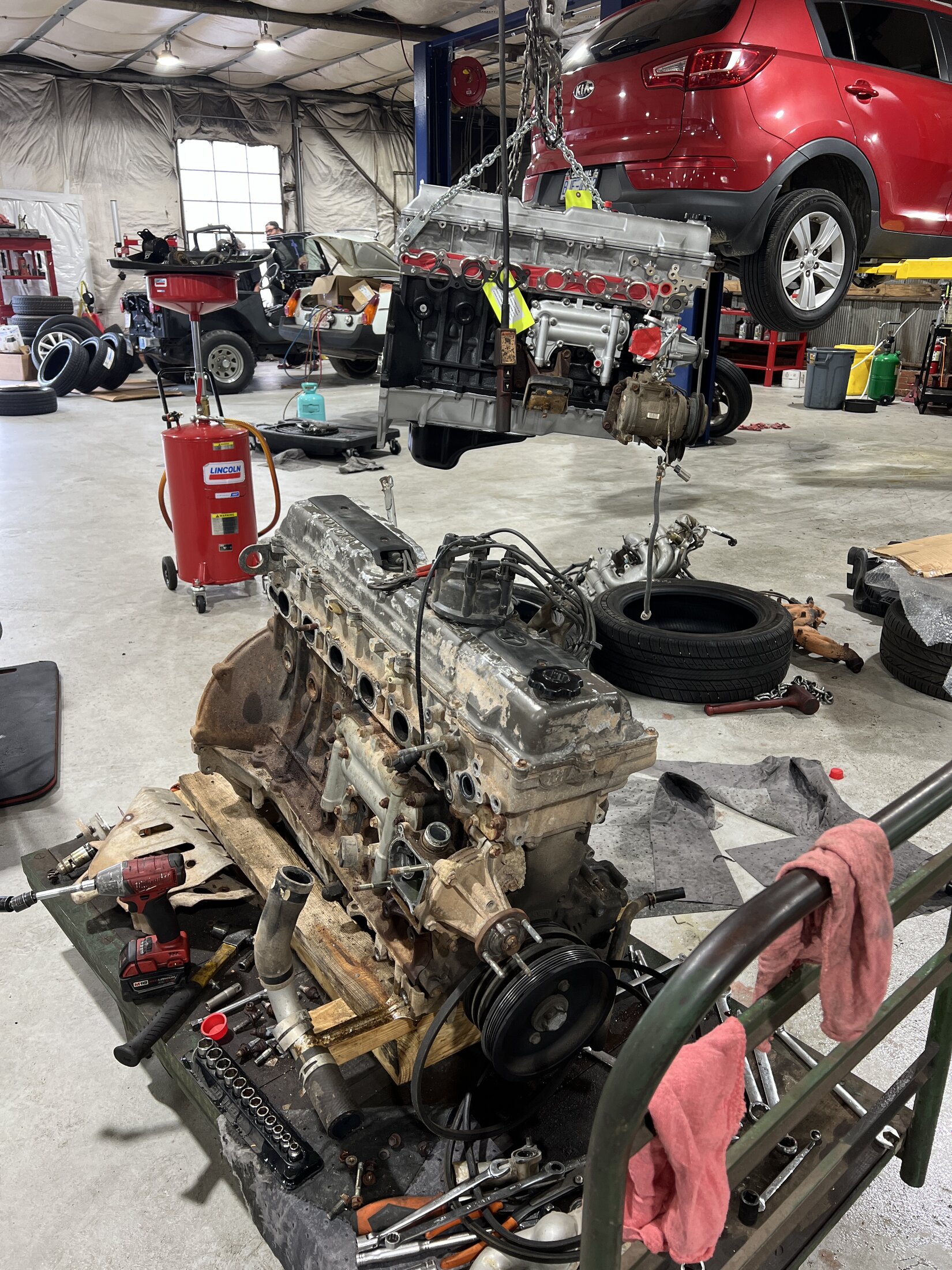

update from the weekend. It's amazing how many other items need attention at this stage in the game. And no the motor is not sitting on the tire, it is hanging from a crane.
Waiting on a new PS gear box, but while waiting the motor is going in.
Should never leave AC compressor ports open like that, the oil in there has absorbed tremendous amount of moisture and some debris from moving it around. At this point I would use a new compressor!
