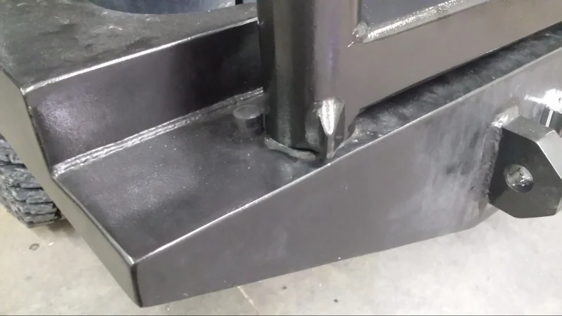

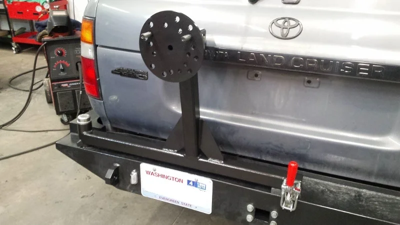

Herre's what I did. Used the spindle mount from Ruffstuff.
More details in the thread linked in my signature or here Custom Rear Plate Bumper - https://forum.ih8mud.com/threads/custom-rear-plate-bumper.873429/

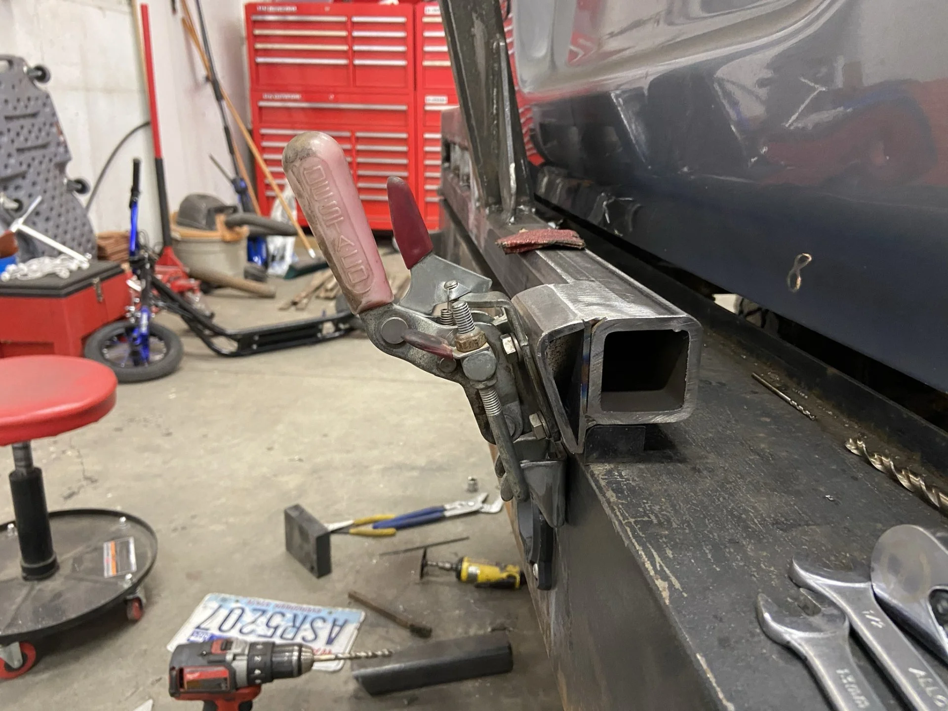

I built it one way the first time and rebuilt it a little later when I decided to center the tire. Either way worked fine and does not move at all. The best thing I did to it was to angle the clamp that holds it closed (last picture). It makes latching and unlatching effortless while still holding the bumper tight.

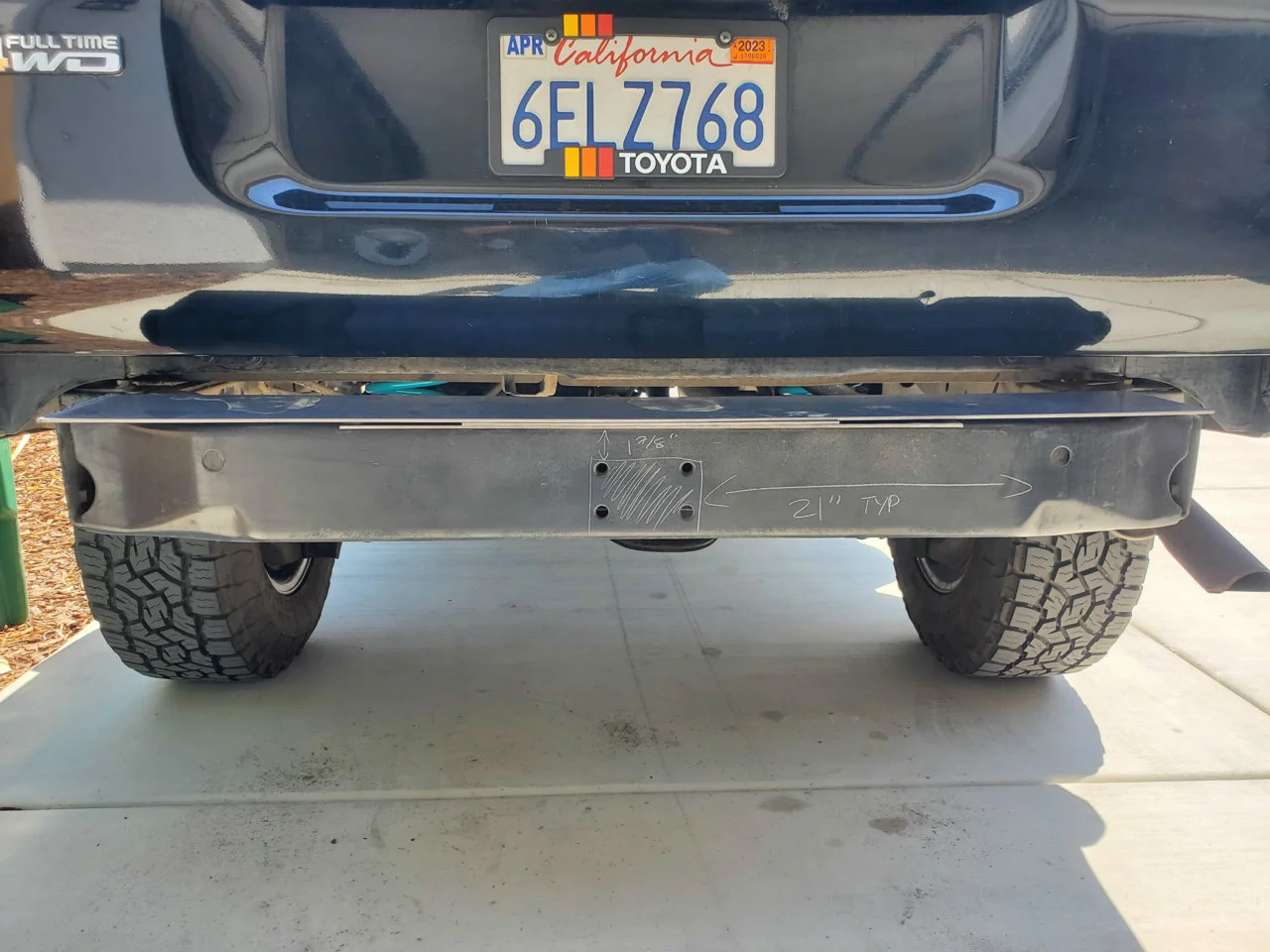

Been super busy with a lot of things so my Land Cruiser bumper has been the least of my concerns.
I did however, cut some steel to size.

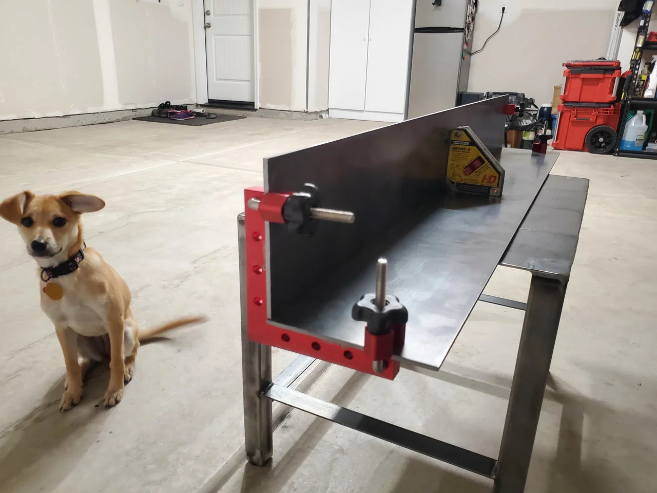

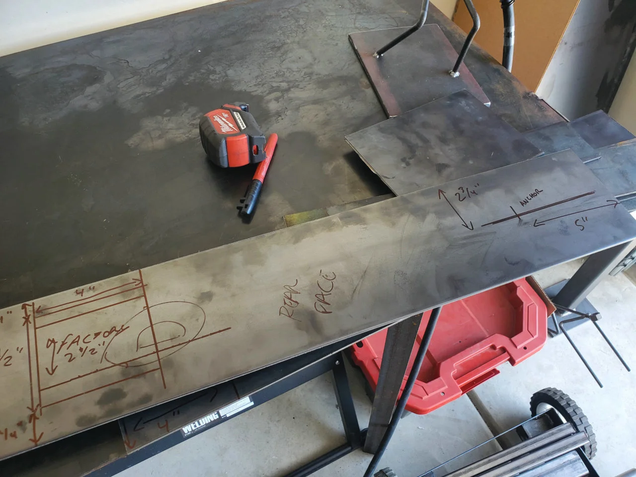

Top and rear face pieces being 45 15/16" wide by 3/16" thick.
Cut side pieces as well at 5 1/2" tall (the height of the face) and 6" deep (the depth of the top plate) by 3/16" thick.
Also got an idea of where the "bolt holes" area is on the factory crossmember as I plan to cut that out with my plasma cutter. Got those same dimensions carried over to the rear face as I want to cut that area out, and have the rear hitch sit a tad deeper vs flush with the rear bumper. This is strictly an aesthetic choice.
With the spare tire carrier (and that stupid bar) out of the way, I'll have plenty of room to run a "V" style reinforcement to the rear hitch between the frame rails.

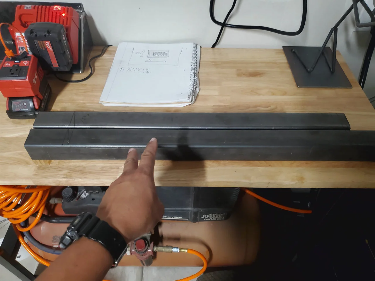

Figuring I'll use the extra 2" square tubing I've got to reinforce the tow hitch.
Need to cut these ends at 15 degrees so they mate with the tow hitch as well as the frame rails.

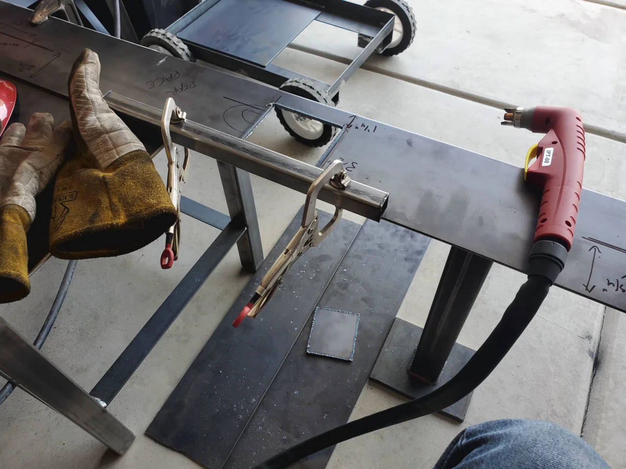

Also before I got busy, after coming back from the steel yard I thought I'd start cutting into the rear face so I can cut out the smaller pieces tomorrow.
Don't have a saw yet, so I've been cutting my square tubing and big plates with a bandsaw at my work.
Small cut outs or odd shapes I'll handle at home with the plasma cutter.

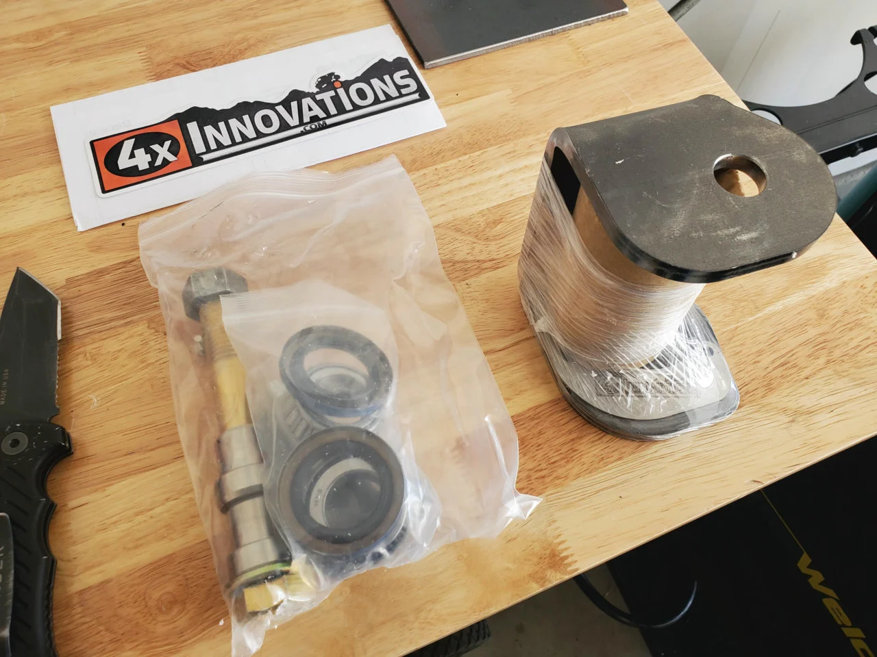

Spindle arrived, just in time!

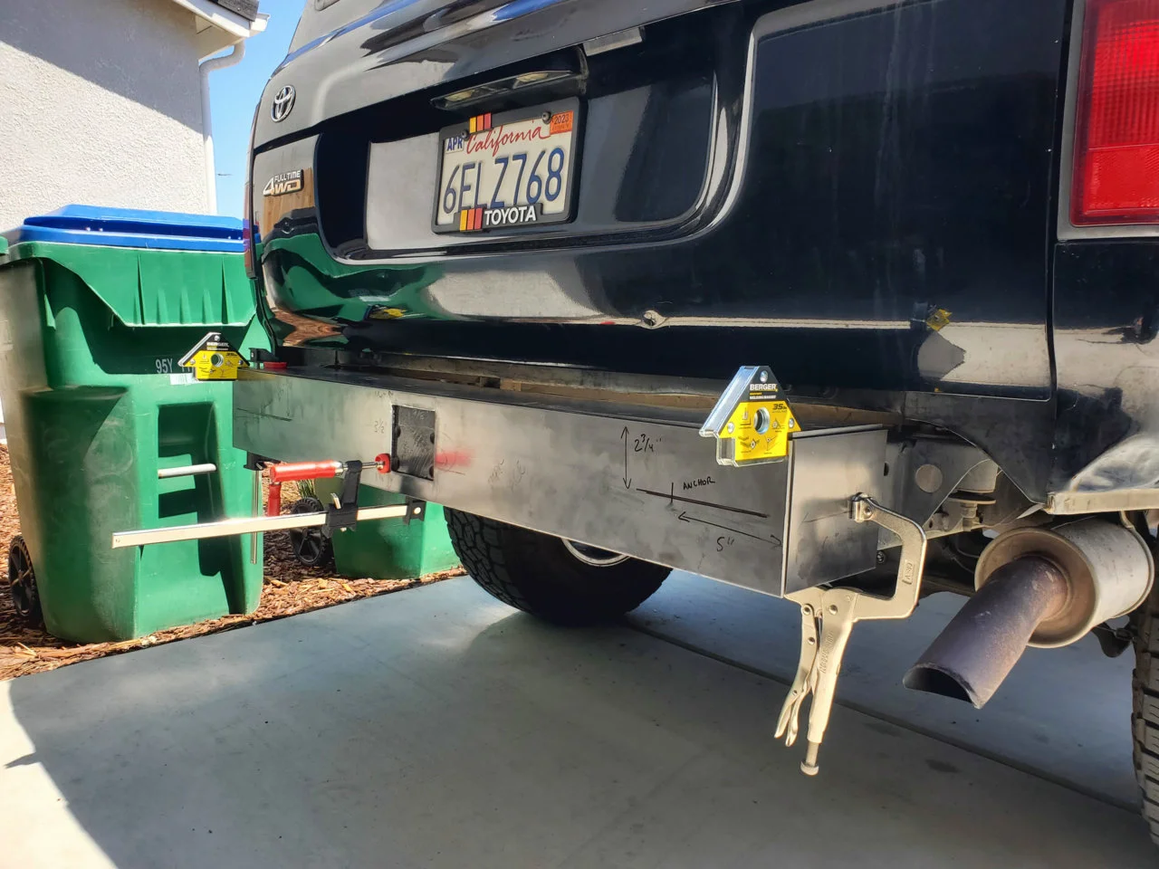

With large pieces cut, I clamped them on for test fitting.
So far so good, just need to find time to notch out the rear crossmember as that's where the hitch will go through.

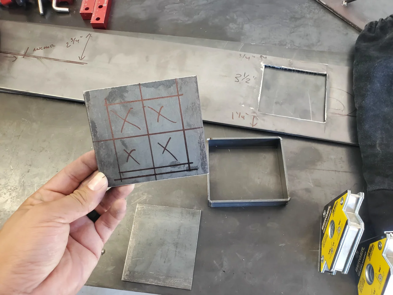

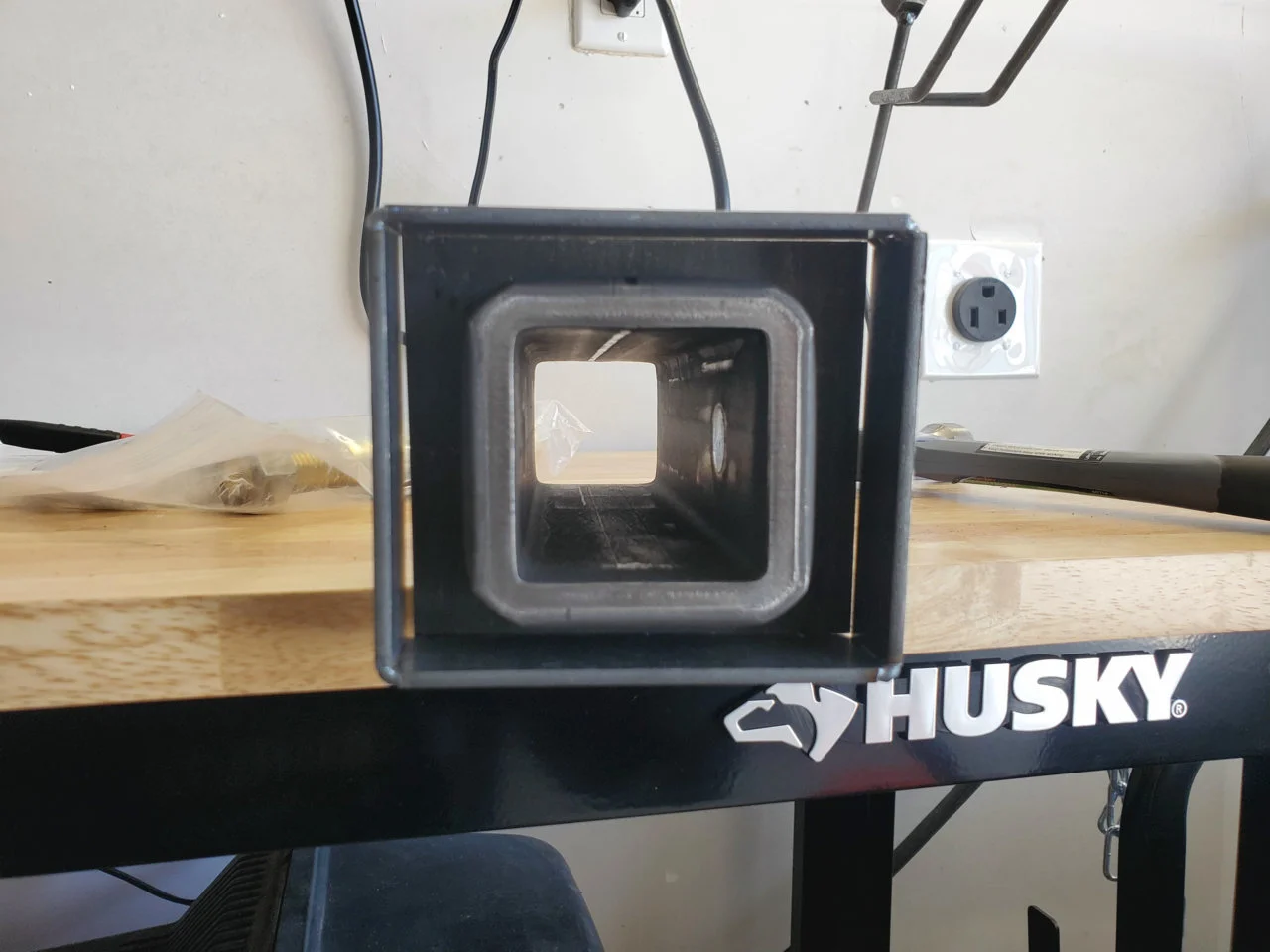

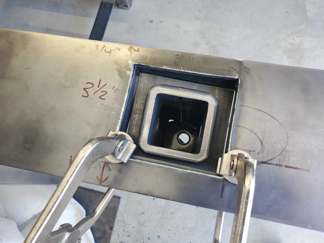

Also figured I'd get to work on the rear hitch-face thing.
This really is just taking way too much time because I'm trying to be precise, with tools that don't allow that.

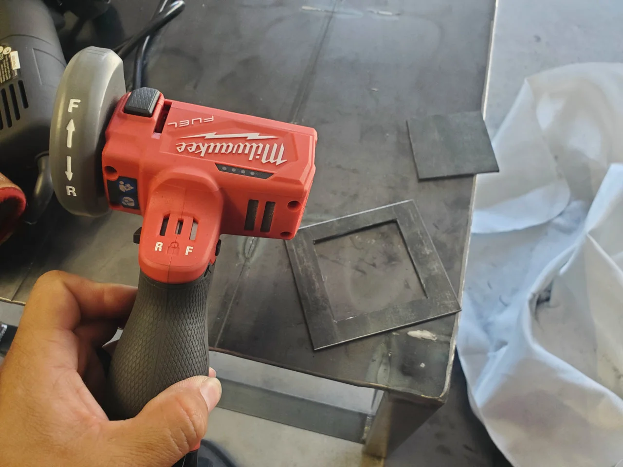

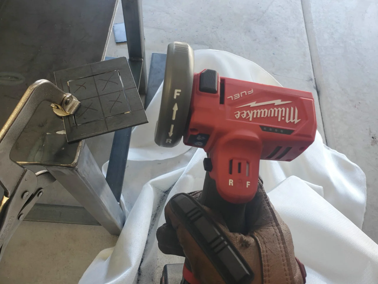

4" x 3 1/2" square plate that'll act as a filler. Just need to cut out a 2 1/2" square out of it.
Milwaukee mini cut-off tool because I assume I'd mess up with my plasma cutter.
So far so good!

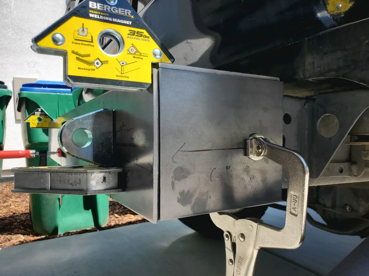

Test fit.
And the 'look' I wanted to accomplish. I really hate a big flat face so I wanted to break it up with a hitch that sat inward a bit.
Once I tack that hitch into place, and get the crossmember notched, I can start measuring out for some square tubing for tying in the hitch with the frame rails.

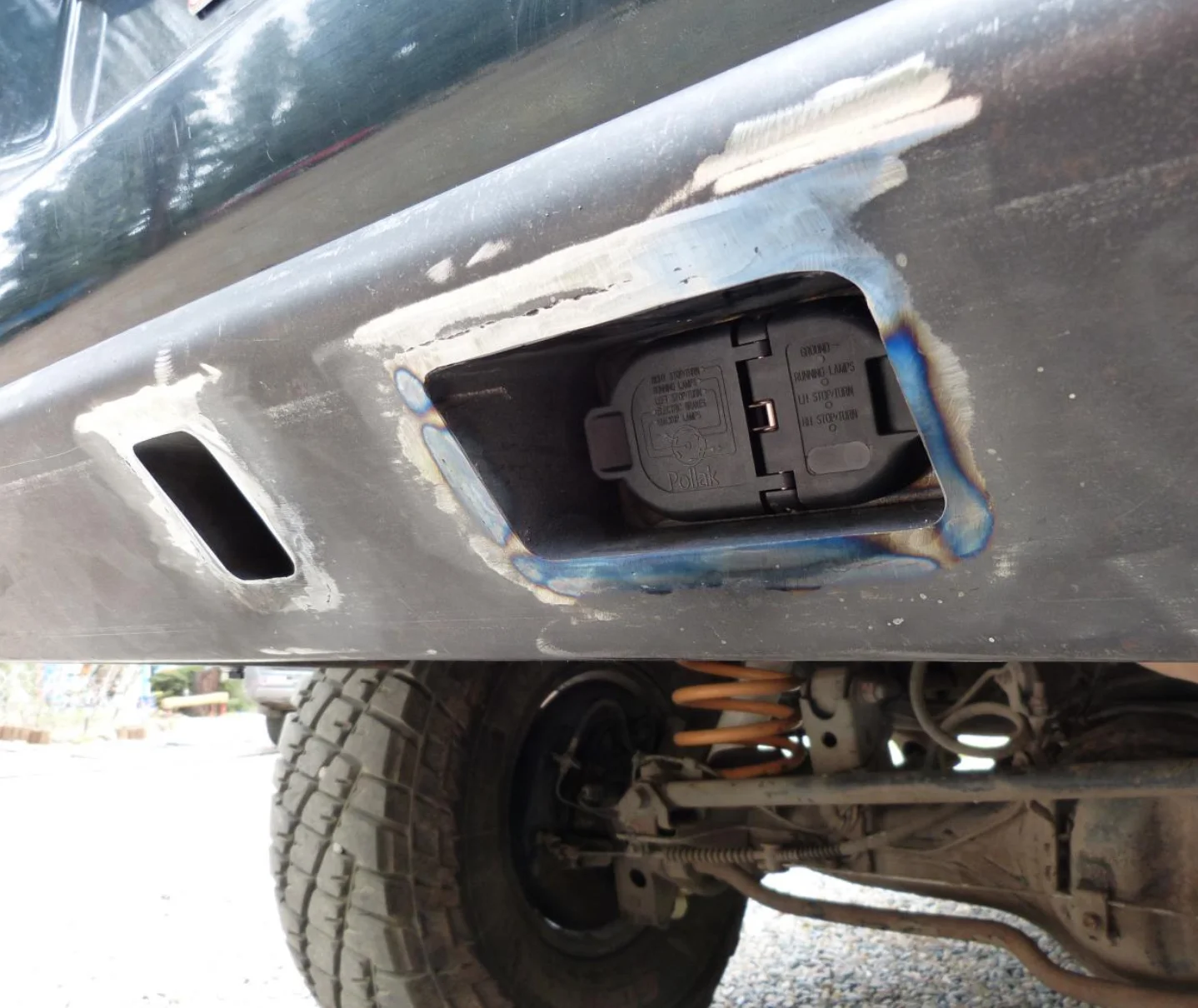

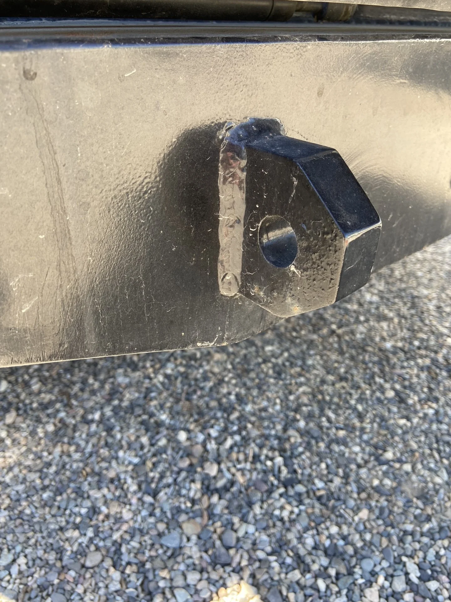

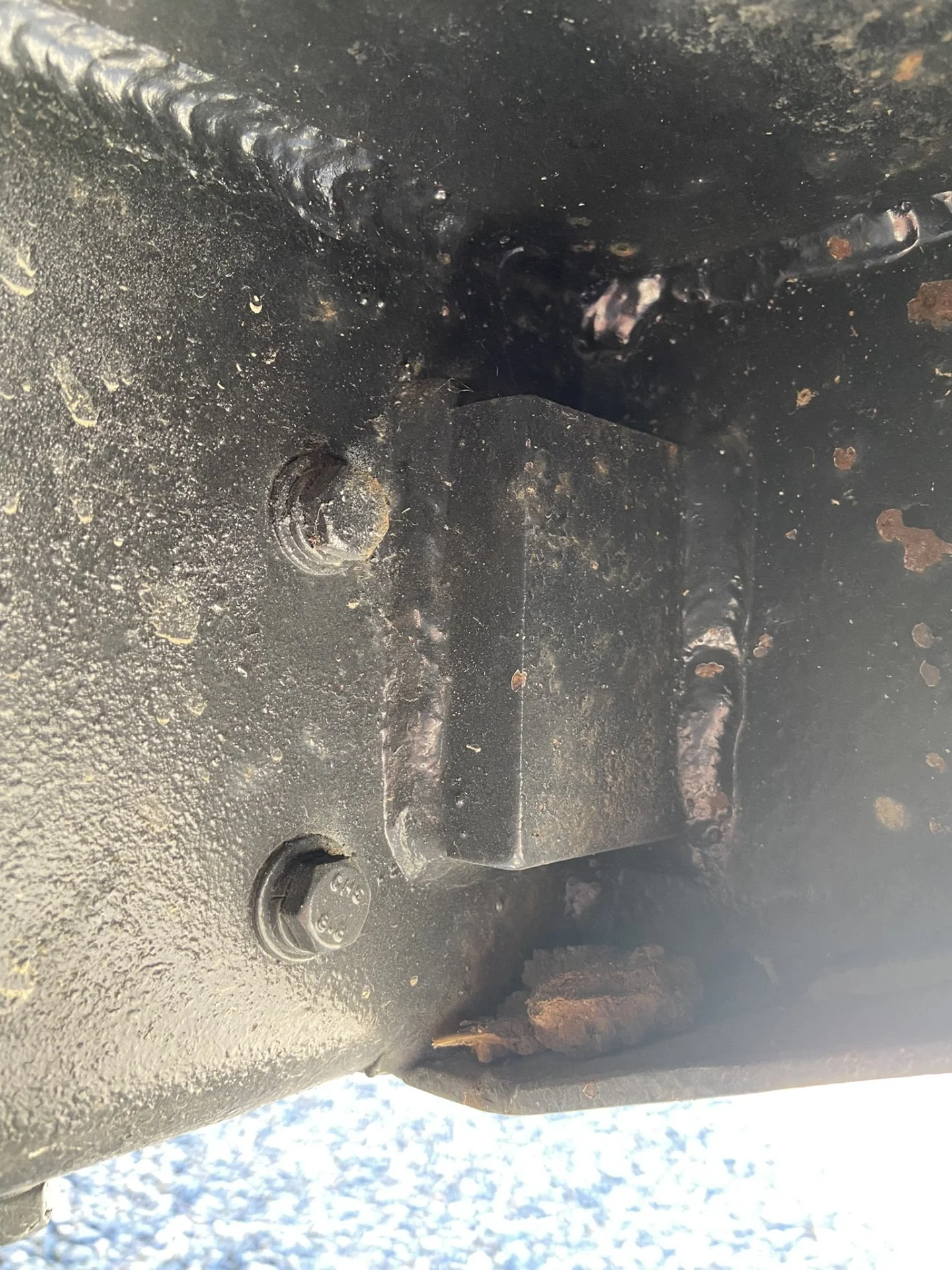

On your d-ring mounts consider cutting through the bumper face and recessing them so you can weld front and back. Much stronger than just welded to the surface. I've seen videos of d-ring mounts that were just surface welded pulling off and becoming a missel. On mine I passed them through the face about 2 inches and welded them to the bracket that bolts to the frame.
Still looking good.
Yeah I already regretted buying these once I got them.
I'm leaving the area marked as shown, but want to get longer ones so I can cut both through the crossmember but also the rear face and weld them on both sides.
Thanks for reminding me!
