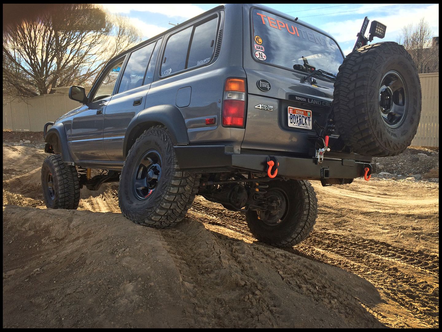

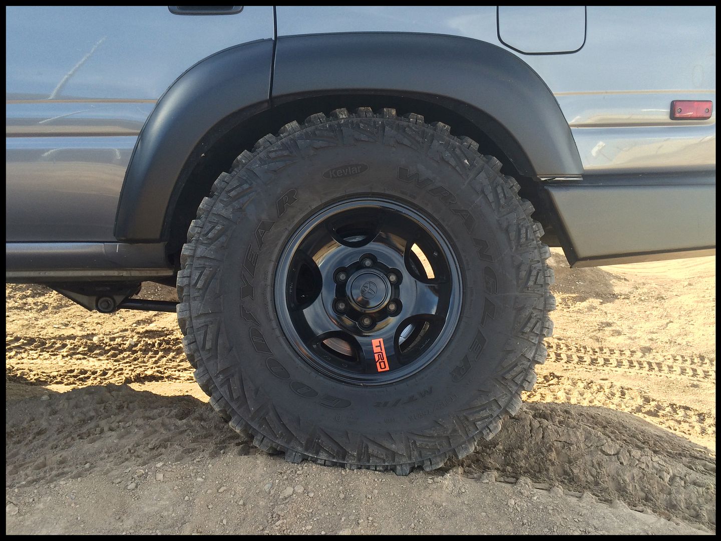

That first pic of Adams it isnt even close to full stuff and will hit the flare at the 2:00 spot if stuffed further. adam is that hitting your bumpstops in pic 1? I cant seem to find a good stuff pic.....but With flares gone- i can tuck the 12:00 top of my outer wheel inside of the body upper wheelwell at full flex "on" the bumpstops............and can barely slip a pinky in almost the entire wheelwell front to back.

No, neither of those pics are anywhere close to full stuff. When/if I move to 37's I'll address the flares if needed. I already have 2" bumpstop extensions. My new wheels were delivered today with 4" of BS which is slightly more "poke" than the stock wheels so I should miss the inside of the wheel wells. Like I said, I don't have a problem with trimming etc if it ends up be necessary with 37's but that won't happen anyway until these tires are worn out.
