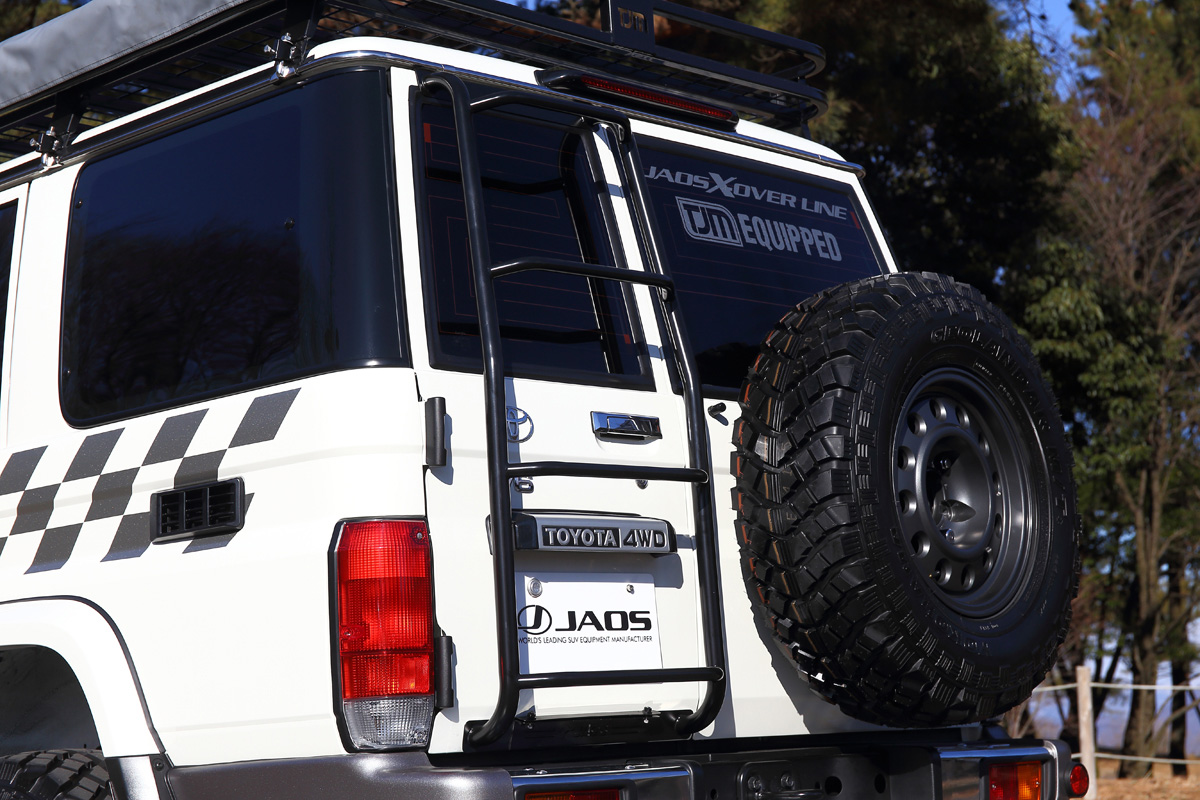

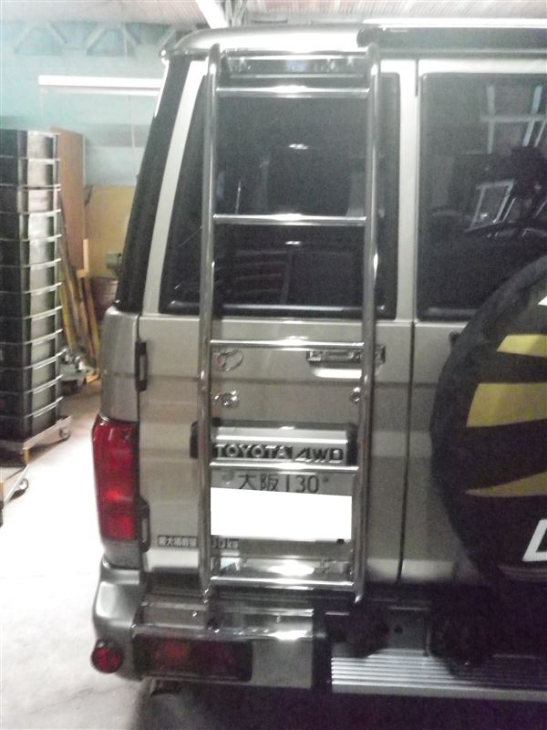

While the end result (ability to access the roofrack) is the same, there are some significant differences in the designs.
On the OEM version (I'm assuming the ladder is actually a Toyota product) the bottom rung of the ladder is much lower
(good for old folks like me), the ladder and associated brackets actually squeezes the top and bottom of the door and doesn't require any drilling into the exterior of the door.

On the 77 Series the ladder is barely visible, if at all, in the rear view mirror.
I think the rear wheel carrier would take quite a load. Its got a reinforced plate on the inside plus the door skin and then the tyre carrier bracket itself with 3 bolts. The door has two hefty hinge pins and is locked with a good size catch.
