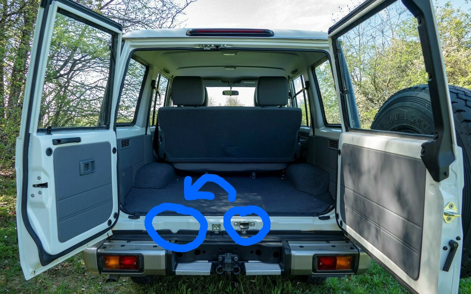

B) Mount the new front runner ladder - bolted version - with the new design:
And here comes my question:
Does anyone have any experience with the new bolted version of the Front Runner ladder for the 76 (71/73) and 78 series?
Is it really an improvement over the older version? There must be good reasons for a complete overhaul of the product and a discontinuation of the old.
FR completely changed the design and the way it is built, but still base it on the same idea to mount it like a bracket between the top of the door and the license plate mounts.
Here is what I think is missing:
1. A reinforcement is needed inside the small door, so it can not be bent anymore by just using the ladder as intended. It's just the door's outer metal sheet holding all the horizontal forces.
2. rust free material all the way!
3. Adding the bracket to the frame behind the bottom of the small door. This comes only on cruisers that are fitted with the fuel tank carrier. So it's meant to hold the extra weight. It's the identical bracket like all the cruiser have on the right side, holding the weight of the spare wheel.
Altogether I am pretty much disappointed by the poor quality of engineering that went into this ladder, resulting in damages to the small back door.
One thing, which I thought would happen, but didn't: The top part of the frame of the small door is not bent. So I don't really need to replace all the door because of the FR ladder... Just fix the dents and bents.
