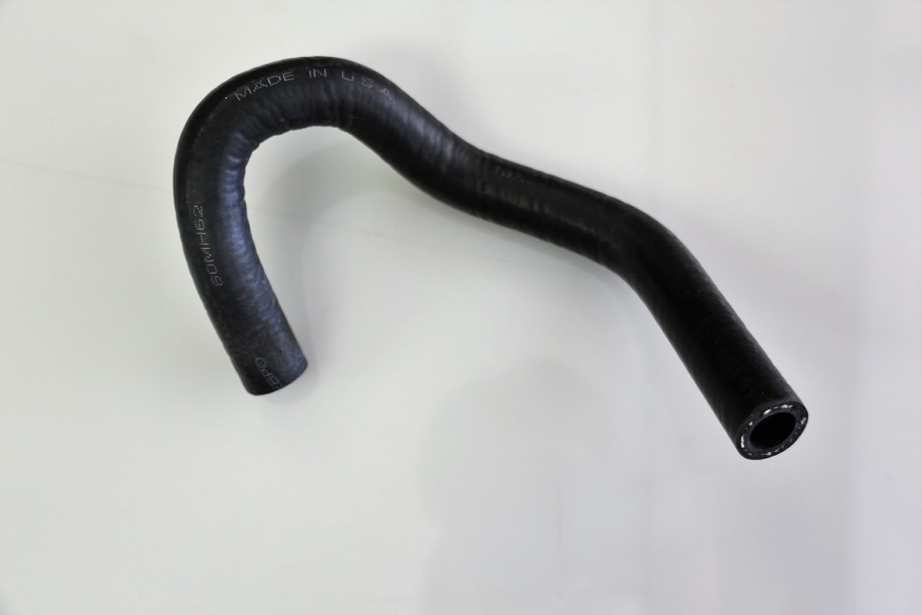

The cleanest set up is using the LCP Bypass hose or Pre cut kit
Note: We now use Gates premium Green Stripe hose not the silver stripe shown in the picture.
