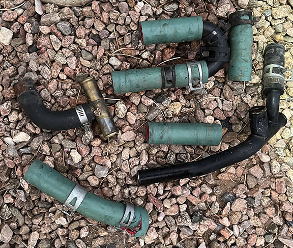

You can see the open tubes for the rear heater underneath the return hose and inside the curve of the fitted hose. This is the stuff I took out:
The T fitting on the left is from the return channel and the metal tube with two exits on the right is from the main coolant feed. I cut out the last couple of feet of the metal tubing underneath the truck leading up to the rear heater as they were corroded and also in the way of a heat shielding project I am working on. If anyone wanted to reinstall the heater in my truck they'd just have to run some new lines.
