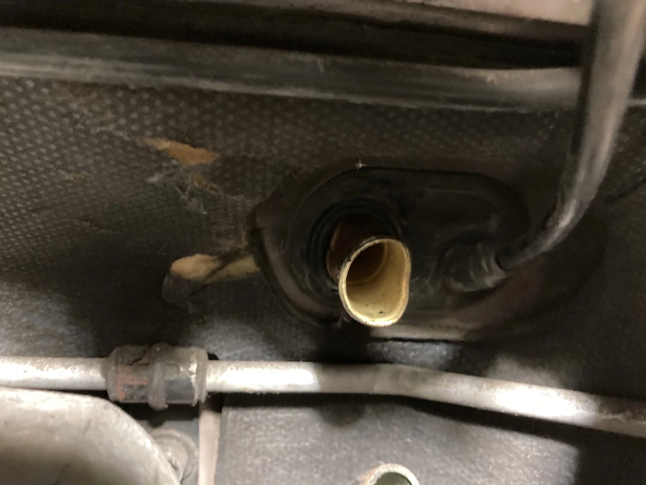

Fought for hours as gently as I could to get these 36yr old hose clamps off but eventually did the thing I really really didn’t want to do. Totally mashed the last one. No way this seals, right? So what do I do next? I guess for now, I’ll just bypass the front heater too. But I don’t like that long term. Anyone replace this hardline? Where’s the other end and how do I get to it and how painful is it? Appreciate any tips from anyone who has been down this road.
The level of deformation does not even warrant talking about. Take 30 seconds to reshape it and drive on.
