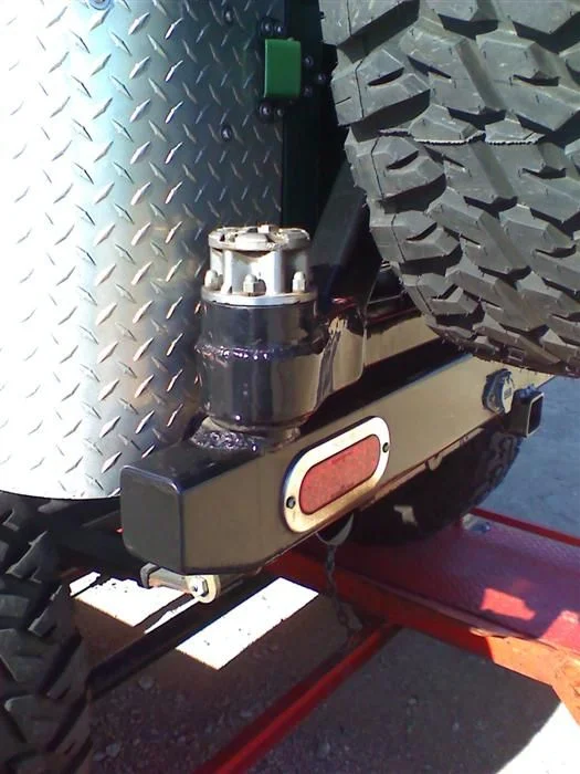

A Dude swung by to today and had this one somebody made from a front hub and spindle..........:eek:
Kind of bulky but really cool idea:cool:, especially with the locking Aisin hub....

That is SOOOOO rad!
I like that idea too with the locking hub.... ever have one go out on the trail? Hey, you have an extra one back there.
COOL.

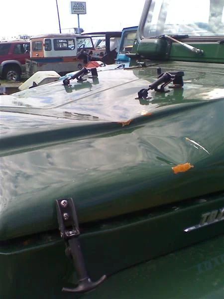

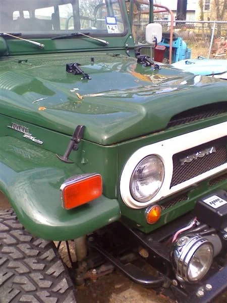

But whats not is on the other end of the truck....
No hood safety catch and the Dude forgot to latch it down.....:crybaby:
