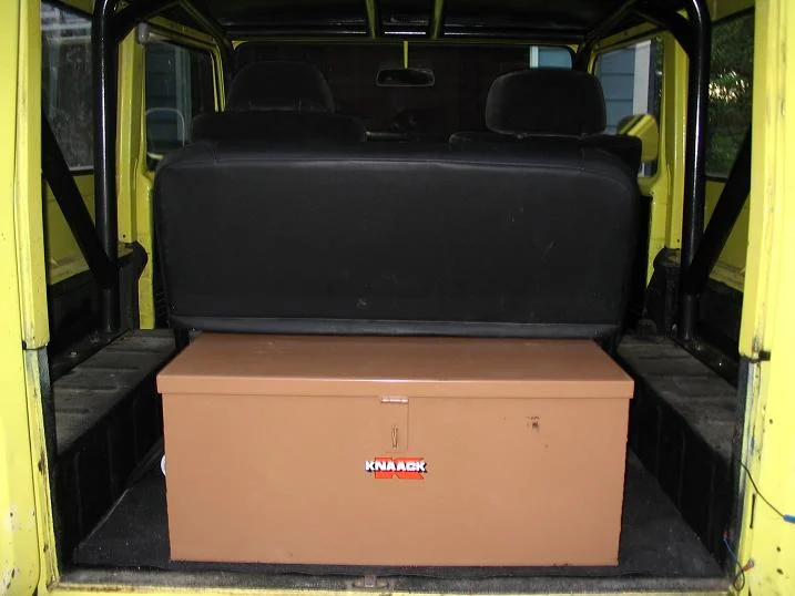

    i used a rear seat for a heep, i got it from www.acmejeepparts.com its the standard rear seat ($159.95) comes with mounting hardware and it tilts forward. you drill 2 holes to mount it. the rear of the seat just sits on the floor. i didnt like that so i made a cage for it to sit on and mounted 2 amps and a pair of bose speakers in it and used expanded metal to stop theft. and put a sub under the drivers seat looks great and the speakers sound great. PM me with e-mail address and i will send pics if you want. i also have a caravan rear seat that i would give away if some one close is interested mint condition.

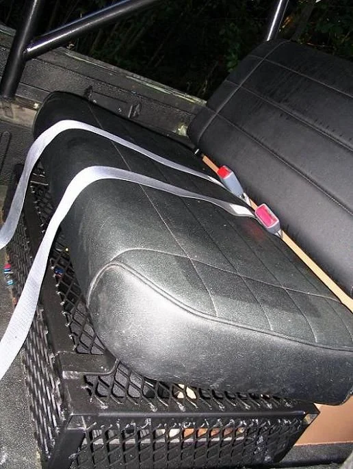

    quoting KnightHawk..."Seen any good home brewed ones? Got pics?"
    no and yes.
    good home brewed ones? ... no.
    got pics? ... yes.
    these were ripped out of the '77 when i bought it. they even had seat belt attachments but, they looked more like something made to try and fool the CHP than something actually designed to save a life. i ripped them out so i would never be tempted to actually carry passengers in the back.
    PO said he put them in so he could take his grandkids on hunting trips into the mountains. after one look at the belts, i thought to myself " you mean, 'so you could kill your grandkids in a rollover in the mountains' ".
    anyways, heres a pic of what i ripped from the back of the '77-40.

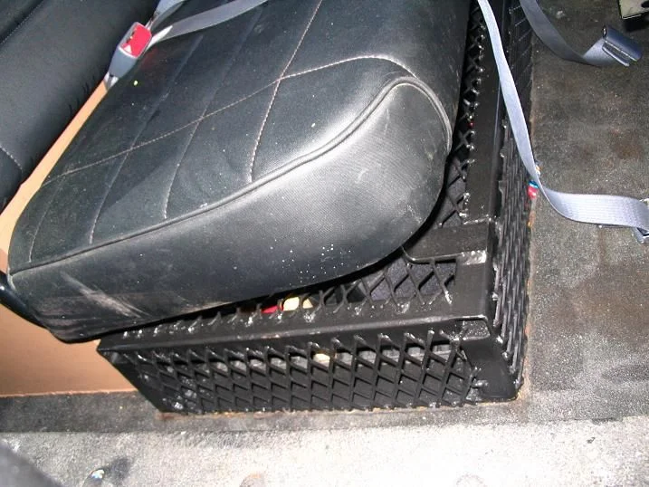

    another...

    Wow, MikeD. Those are... um... well something else. I guess if the belts were secured to the truck and not the seat themselves they might save a life. But yeah, thanks for sharing. :eek:
    That got me thinking. We should make a collection of pics like this of what not to do in an attempt to help keep some of the bone heads outta trouble, perhaps even save a life or two. I've seen some pretty scary steering weld jobs and all kinds of stuff on these forums.
    A centralized location of what wrong looks like would be kind of cool in the tech section. And the safety nazi's that might be a part of the club or just visiting would be sure to give the site a stamp of approval for our efforts. Oh heck just a full on safety section with all kinds of tips and stuff. I'm sure we could all contribute a little here and there, I know I've done some questionable things in the past.
    I think I'm gonna keep the jump seats in and not do the bench thing anyways. Thanks everyone.
