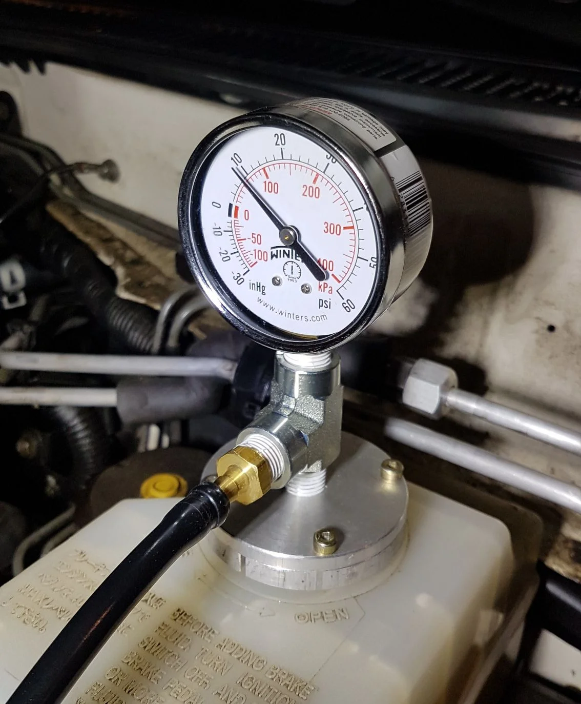

DIY Pressure bleeder (I'm using an unused -dry- plant sprayer to pressurize the reservoir):

You could also use a piece of hose over that fitting with a hose clamp. The pressures are very low. If you are planning to hook it up to a compressor, be very careful not to blow up your reservoir. It would be nice to have a safety low pressure release in case your compressors' regulator diaphragm fails at the wrong time. That is why I use a $7 plant sprayer pump.
