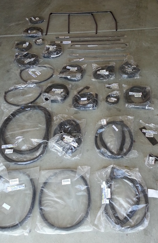

It's not fun buying all the weatherstripping you'll need. Fortunately for us though, Toyota still makes most of it (all the important stuff anyway). Here's my stash... I haven't added up what I spent, but I think it's around $2k, and that's at the discounted price :frown:
