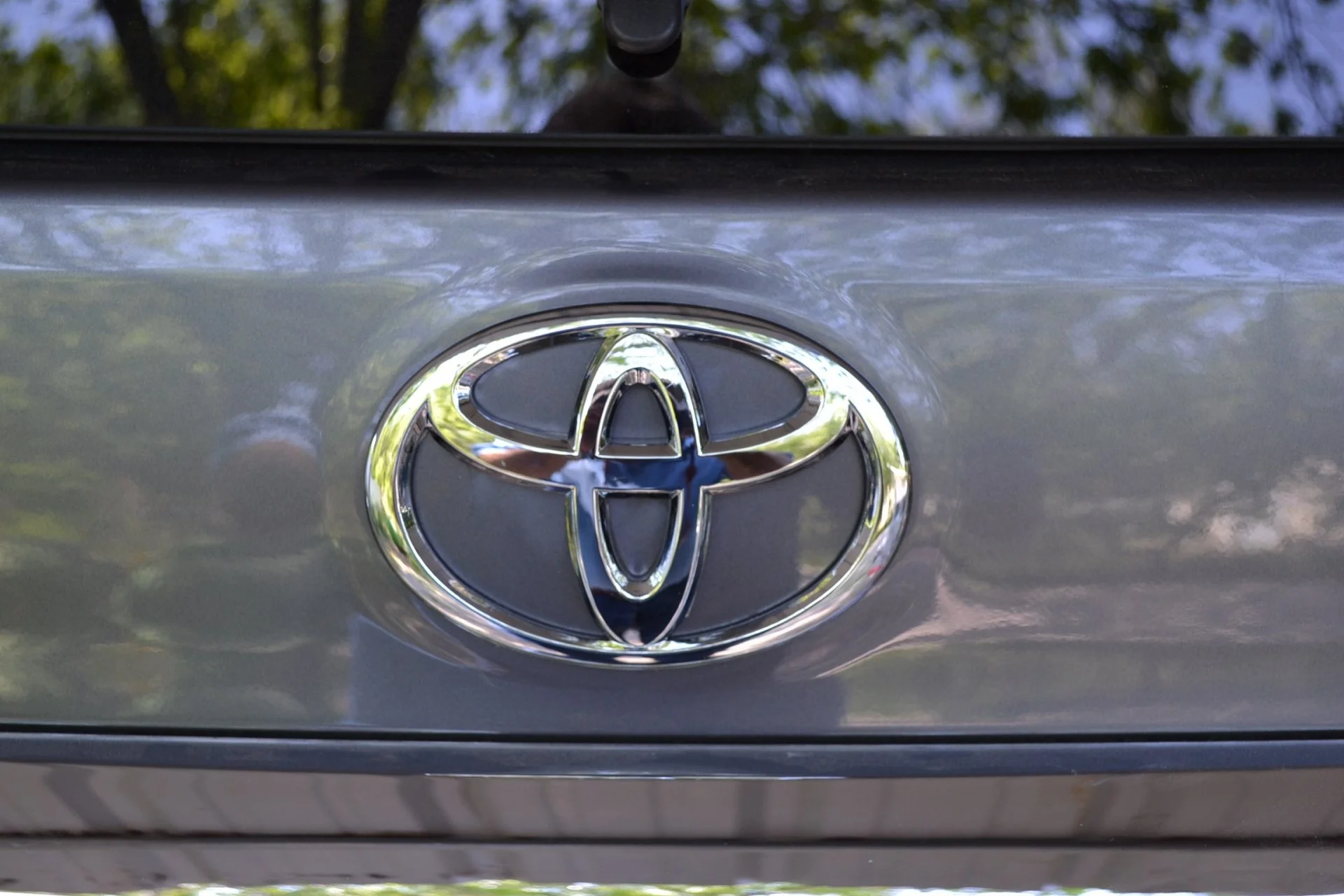

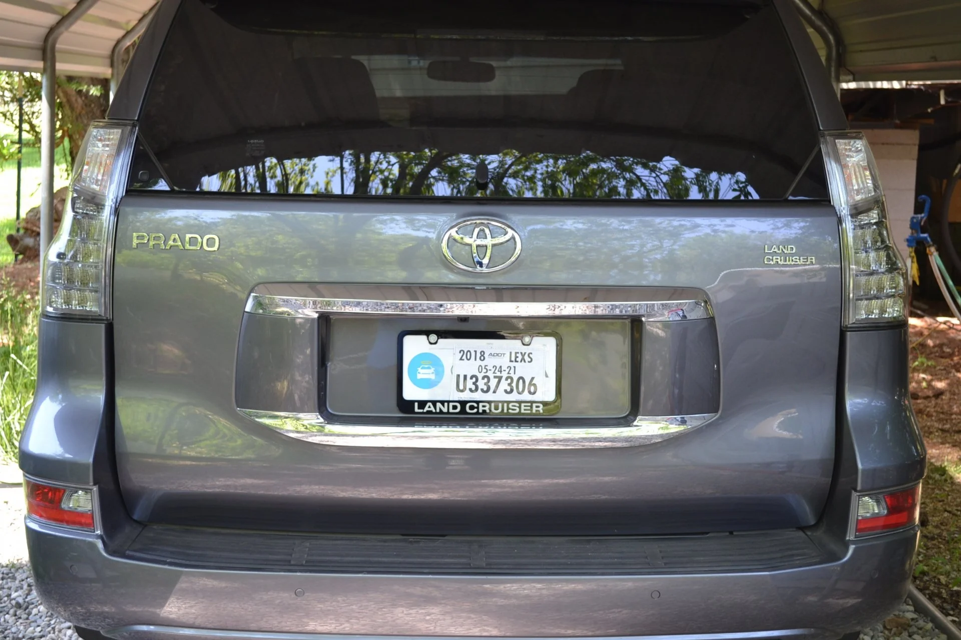

My measurements below:
The rear measures 6" by 4 1/8
The front 6 5/8 by 4 3/4
They are held on by a flexable adhesive, if you are gentle you will be able to put your old emblems back on when you sell, new moulding tape is recommended.
The Prado and Land Cruiser emblems are just held on by flexible adhesive, they don't have any pins. The pins are just locating pins, they are not attached to the car so you can remove them if you need to . I was very pleased the rear lined up with the pin holes on the car.

Front Badge 2005-2011 Land Cruiser 90975-02076. You have. to remove one of the pins. Badge is about $20 on eBay
Rear Badge 2007-2009 Camry Grill Emblem. 75311-06060. Remove black plastic mount from emblem, pins line up perfectly. About $20 on ebay

Just use dental floss or fishing line to get behind the adhesive tape. Your old emblem should be able to be re used without any damage.
The pins are just locating pins, no clips. The residue from the old tape comes off really easily.
Great project - I'm a believer. Thanks for the part numbers. I put a Land Cruiser 200 rear Toyota badge on and it's a bit too small - so I like your Camry solution.
