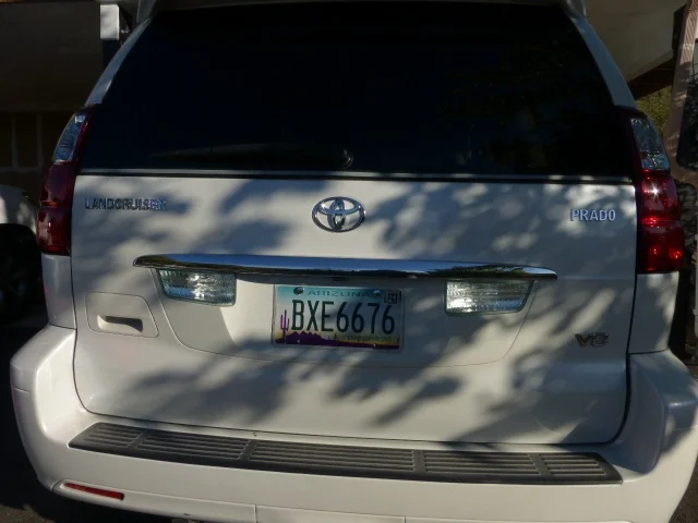

Today , I received my letters for the rear door of my 2008 GX 470
It's gonna read " LANDCRUISER PRADO"
Gonna have a local body shop install them cuzz you only get one chance to do it right

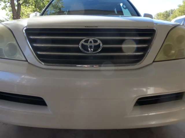

If you zoom in on the picture from @sedonut, you can barely see the black "L". Which is fine by me. So looks like he left the base there and just removed the crome "L". I'll do the same.
@sedonut its not super clear to me how to remove the front Lexus badge. Just a heat gun and patience?
There are a couple of screws that hold the Lexus front badge black mount that you can see still there behind the Toyota badge. As this was my first try I removed the whole assembly.
You don't need to remove it. Thre are no clips that hold the pins on the Lexus emblem, the pins are just locating pins. Take some dental floss or fishing line and work behind the stock emblem. It will come right off, no heat gun needed. On Toyota emblem mentioned above you will need to clip off one of the locating pins before installing it. As you can see I did not cut out the black "L" on the mount. You could if you wanted but most people won't notice it and you may want to re install the " L" badge.

FWIW , my 2008 GX 470 has new Toyota badges .
Front uses the badge from a 2006 4runner . ( other years too , I am sure )
Rear , 2021 Highlander , have not received this one yet , measured it , though , same dimensions , will have it Wednesday.
Already replaced the Lexus and Gx470 with Landcruiser and Prado

You'll have to remove the clips on the back on the 2006 4Runner emblem so it fits flush .
I used bathroom adhesive to mount it from H Depot

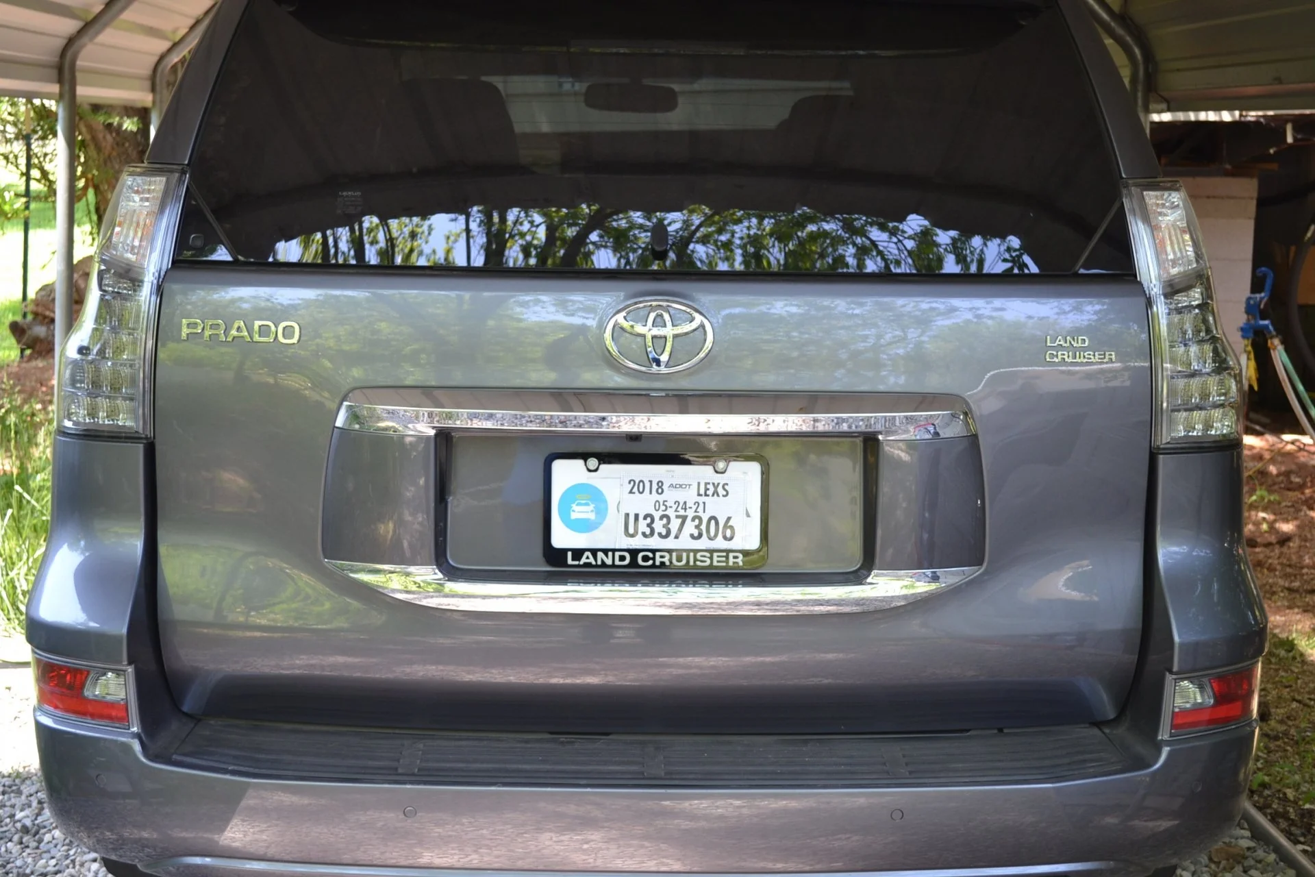

Front Badge 2005-2011 Land Cruiser 90975-02076. You have. to remove one of the pins. Badge is about $20 on eBay
Rear Badge 2007-2009 Camry Grill Emblem. 75311-06060. Remove black plastic mount from emblem, pins line up perfectly. About $20 on ebayView attachment 2666218

And it fits ! , The rear emblem from a 2021 Highlander fits my 2008 GX 470 , minus one lineup pin that has to be removed .
The other pin lines up perfectly with one of the holes .
