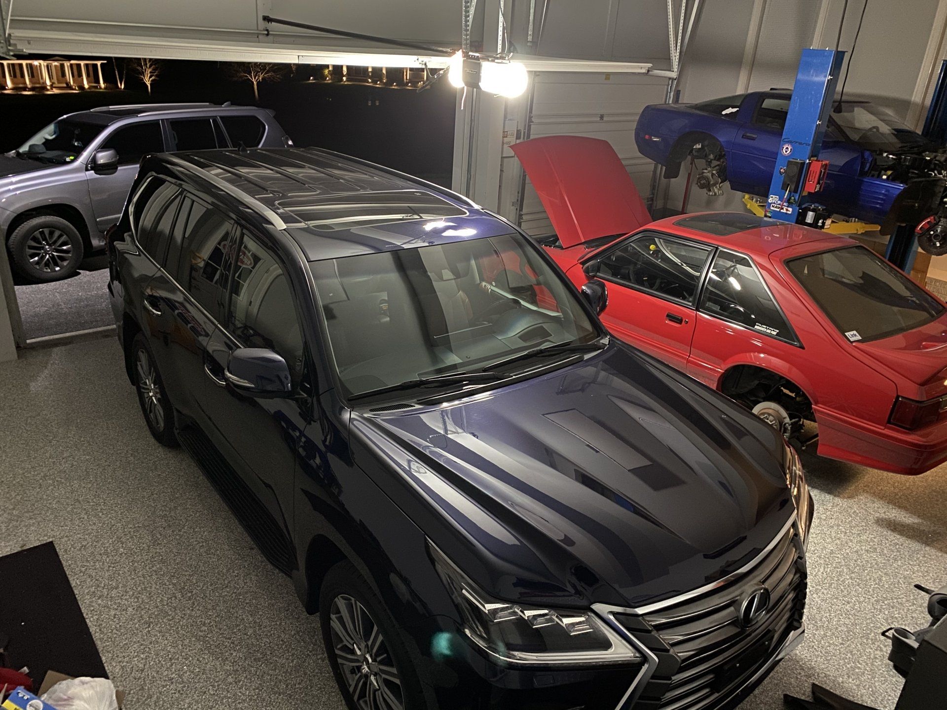

Here is the Garage as it currently sits. Fifty has been pushed outside since I cant stack the other cars while Im working on the Z

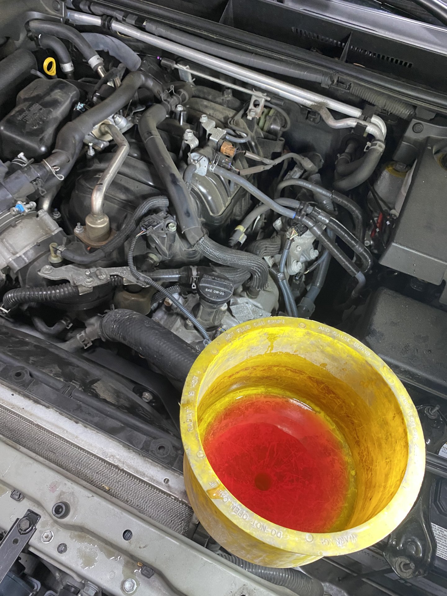

Last week I had my oil changed at my local dealer since my lift has been tied up and they noticed my water pump seeping. Ordered a pump, idler pulley, belt tensioner, thermostat, fan bracket and belt and got it all installed two days ago. Relatively easy job, plenty of space once fan shroud and fan are out of the way.

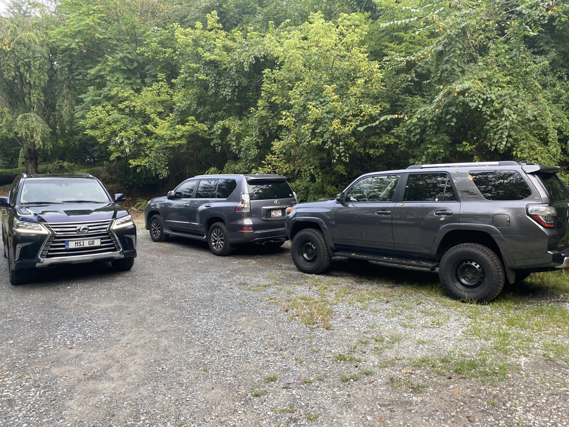

Stopped by Backwoods Overland today to drop off some parts I forgot to leave with the truck. Install going down tomorrow!!!
Had to snap a shot of the GX stock next to the LX (and a random customer’s lifted 4Runner)
