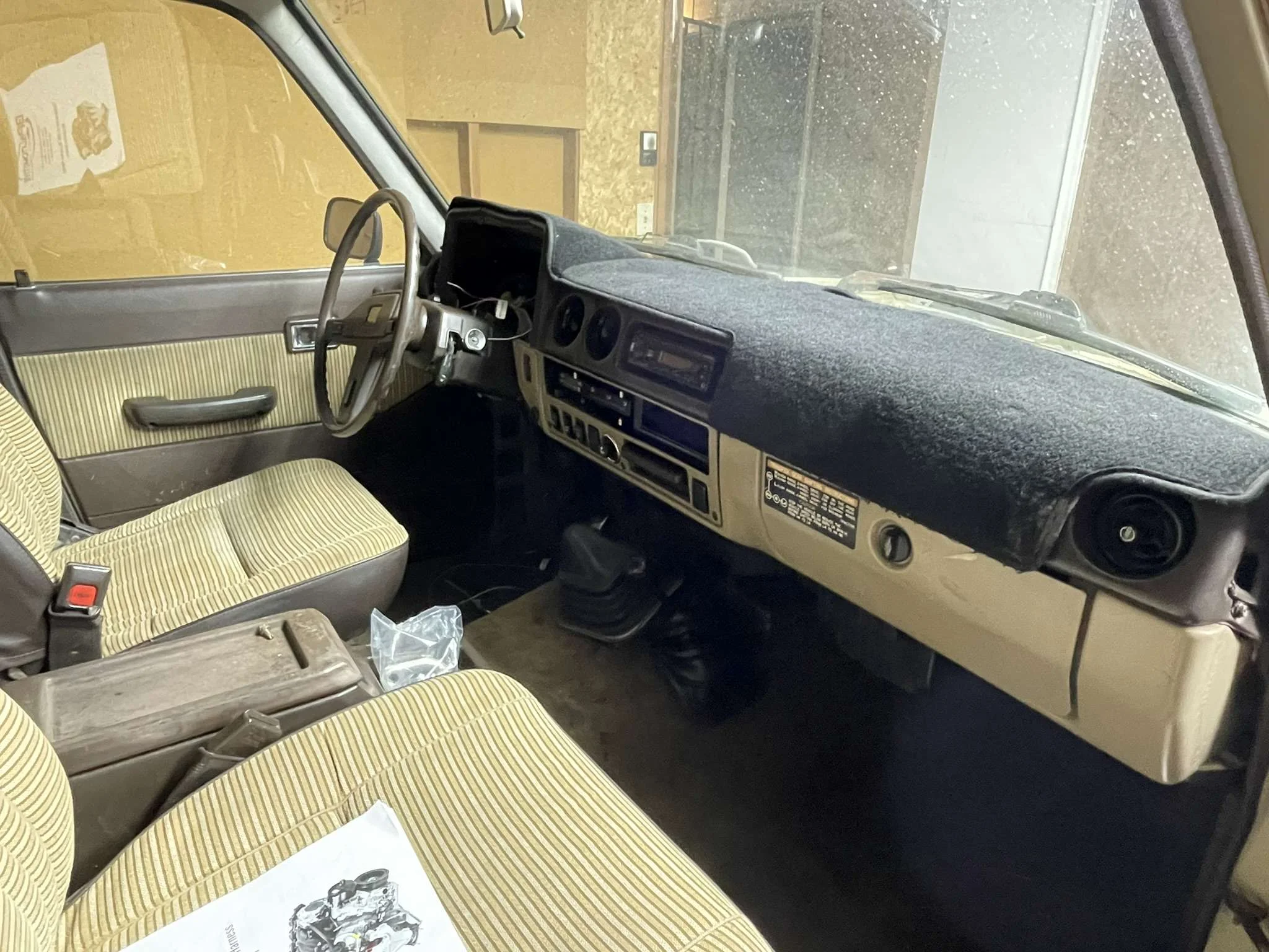

When I first installed the Torfab bracket I installed a Alpine UTE-73BT that I've had for years, and it was fantastic with the Torfab bracket. Here's a not so great picture where you can kind of see it.
It ended up dying on a 5 hour road trip over the 4th of July weekend, so I replaced it with a Kenwood I got at a local Autozone. It's been a pretty good system too, although I would've just installed another Alpine had I been able to find one. My ultimate goal is to get the original old school Alpine that came in my rig recapped with Bluetooth added, although I haven't gotten around to that yet.

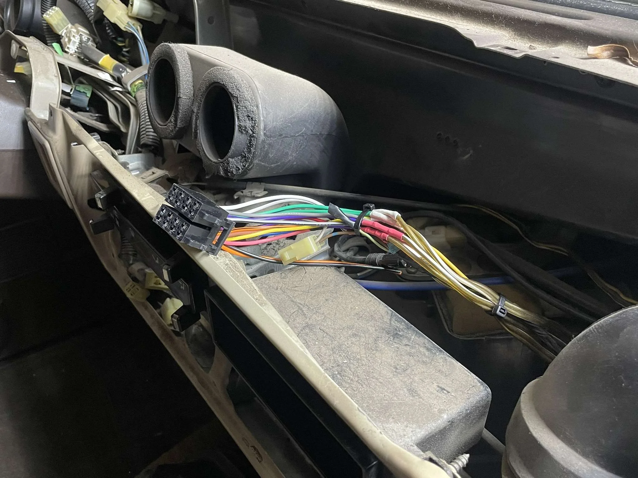

Whichever one you do install, I highly recommend buying this connector and crimping the stock wires to it. That way you have a clean and easy way to disconnect the stereo without continually hacking up the factory wiring.
Here's mine installed as well:
