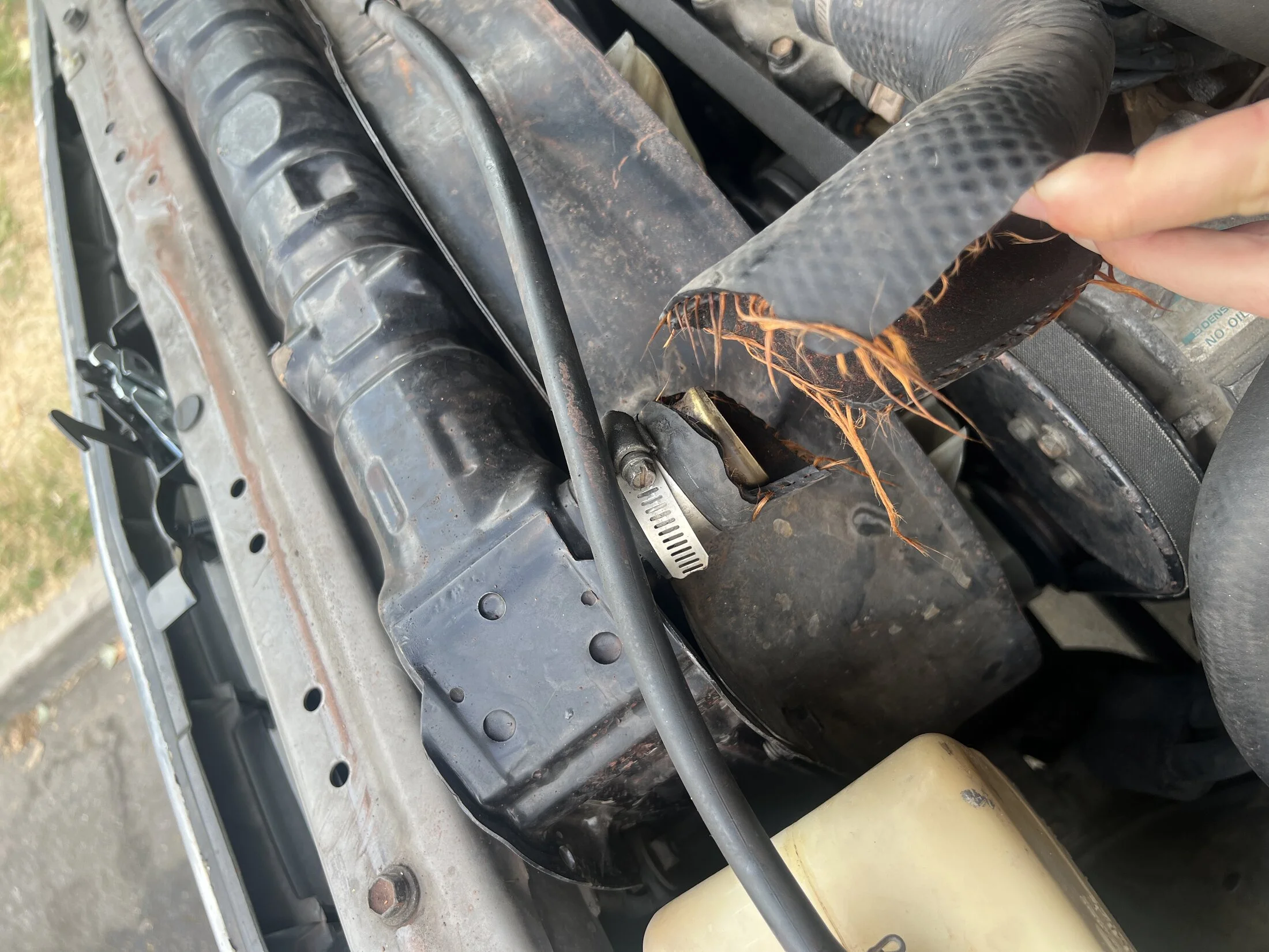

At the end of a road trip in pretty mild temperatures (around 60F) the radiator hose connected to the engine exploded sending coolant everywhere. Completely shocked because I checked the coolant levels before we left and I have a 4 year old radiator with additional cooling block attached.
Anyone experience this?
Would replacing the hose solve this? Or is this a larger issue?
Any guidance greatly appreciated.
in your first picture - that radiator cap looks bent. Was it damaged? It might not be regulating pressure like it should. Regardless, if I were you I'd be thinking about replacing all the hoses. Don't forget the one under the AC compressor. Toyota or Gates, don't cheap out.
Probably a combination of a Thermostat not opening and a faulty radiator cap.
The only time I've seen that on a 60 it was overheating and the cap failed to get rid of the excess pressure into the overflow bottle, so pressure kept building. I think the guy had completely removed his thermostat as well, in an effort to alleviate a constant high-temp issue. It was the lower radiator hose and it exploded just like that. That was somebody else's truck on a trail and fortunately one of us had a spare hose to get the guy rolling again pretty quick.
Time for a cooling system refresh. Replace all hoses (Toyota or Gates, there's a thread on here with a list of part numbers), get a new cap, use only the Toyota clamps (available new), and maybe replace the thermostat and o-ring if you don't know when they were last changed. May as well flush the system from the radiator and engine block while you're at it.
