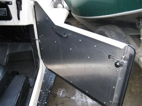

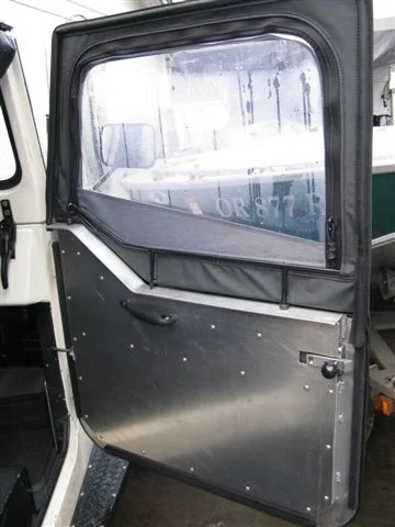

I would be looking at diamond tread aluminum or plain metal covered with diamond tread rubber.
Bedliner would be pretty rough on bare legs.
Heavy gauge 1/16 plastic cut to shape. Look at CCOT for the idea. Pretty awesome. Those doors look great. Or go with aluminum ala Chandler. That's very tight, my man.
