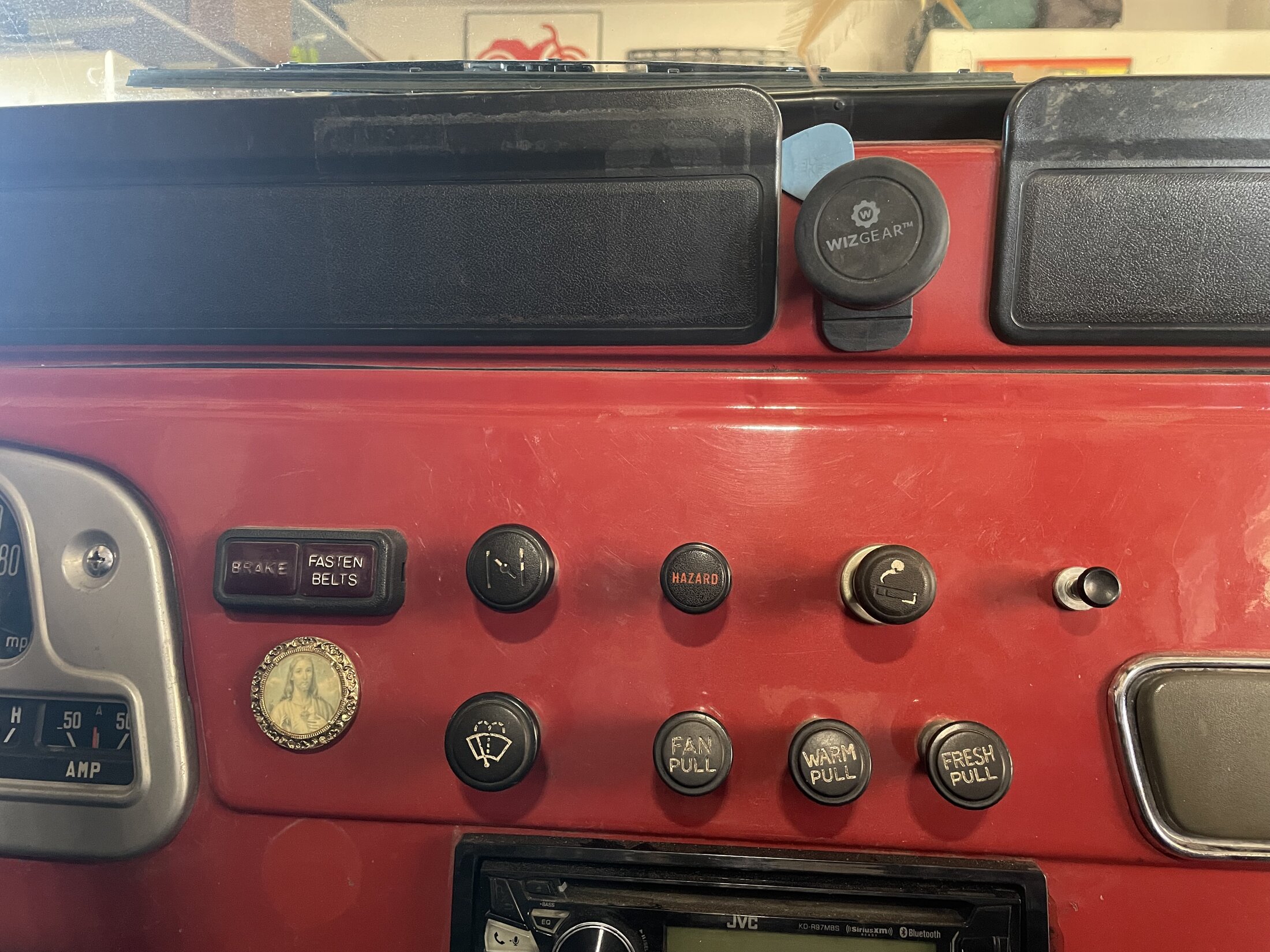

My Colombian spec 43 did not have a heater but did have the defroster vents. It also had all of the knock outs in the dash for the OEM heater controls and wiring in the harness. I salvaged a complete NA heater system from a junk 40 installed it and have been warm for many winters.
Did you have to cut holes in the firewall to run coolant lines through or were they pre-existing?

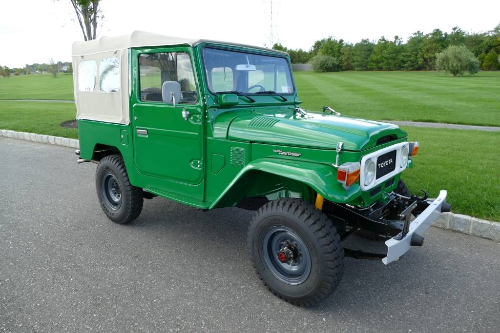

South American rigs have a bad rep. There are surely craftsman down there that do good work but it seems a lot/most are not.
That looks like a later model (late 79+). Would need WAAAAAAAAAAAAAAAAAAAAAAY more pics to give any kind of informed decision but; heater would be the least of my concerns.
What are they asking. Who did the work and what parts did they use? Yea heater is way low on the list of my concerns. Spray painted exterior engine, tranny and transfer is not the same as rebuilt/remanufactured units with quality parts, proper machine shop work and careful assembly.
It does look nice. Personally cosmetics on a real working 4 WD is a waste of money. Actual 4WD in mud, snow on goat trails plays hell with rigs no matter how careful you drive.

All very good points, here’s the link to the listing only 5 min from my house
proceed with caution on a south american rig purchase
lots of things are different on them versus US spec rigs
as stated above it could very well be a polished turd

Well, just got back from looking at it. The truck was about 100 pounds heavier because of the Bondo, paint, bubbling, cracking, and runs all over it. Rear main seal transfer case and oil pan all leaking.

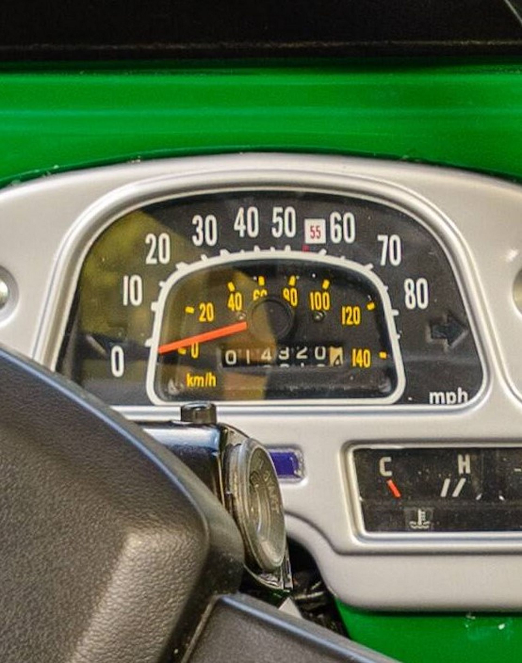

Man - good eye. The speedo is in MPH but the odometer is KMH. Was this a standard non-US spec cluster?
The odometer is correct. Face of the speedometer with the highlighted 55 looks like US market. Also with the speedometer that shows both kilometers and miles would probably be US market. Replacements are in kilometer only.

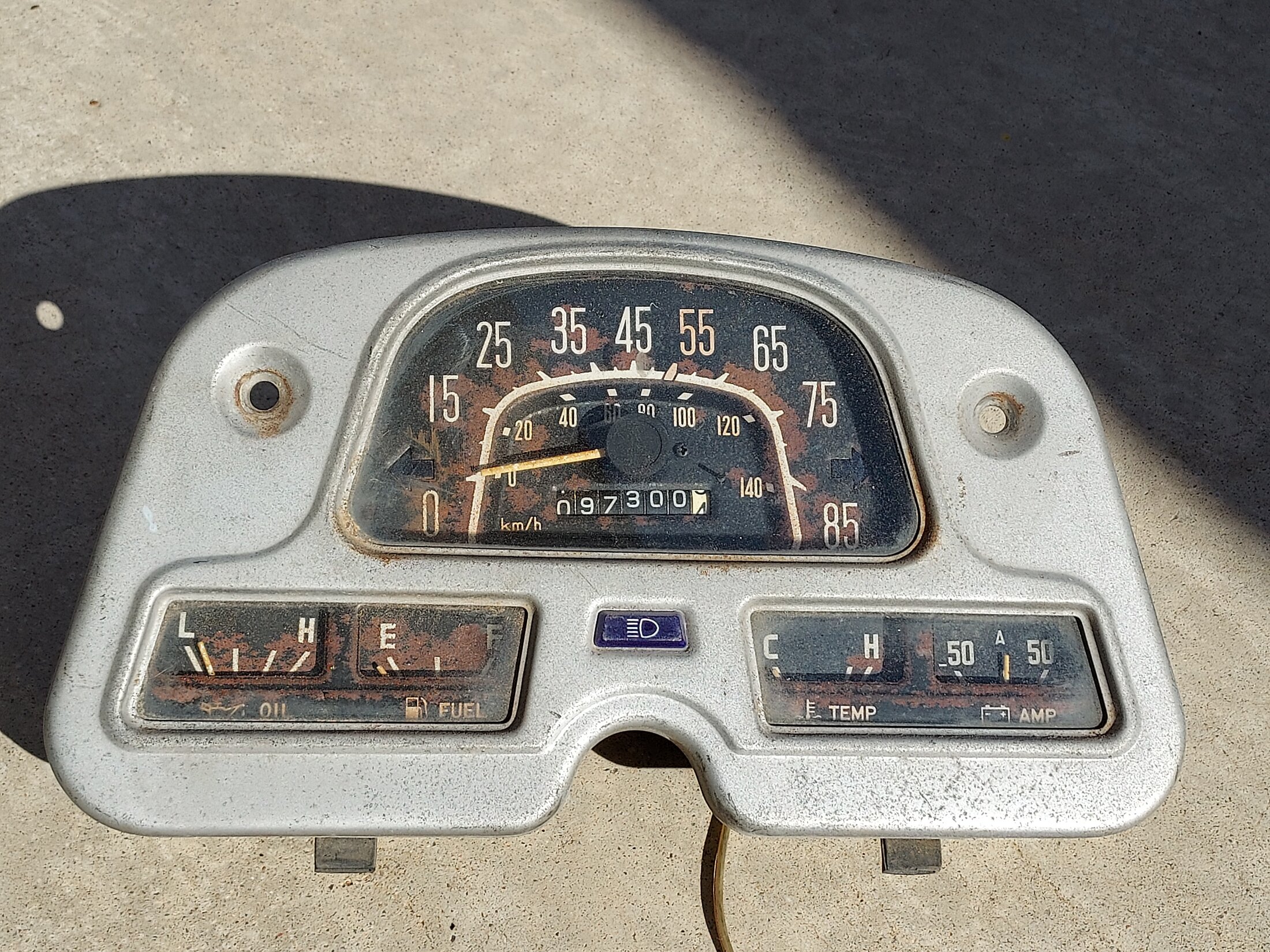

This is a 3/82 US market I have for close to fifteen years.
Not sure the years for the highlighted 55. 1980 model had it but not 1979.
