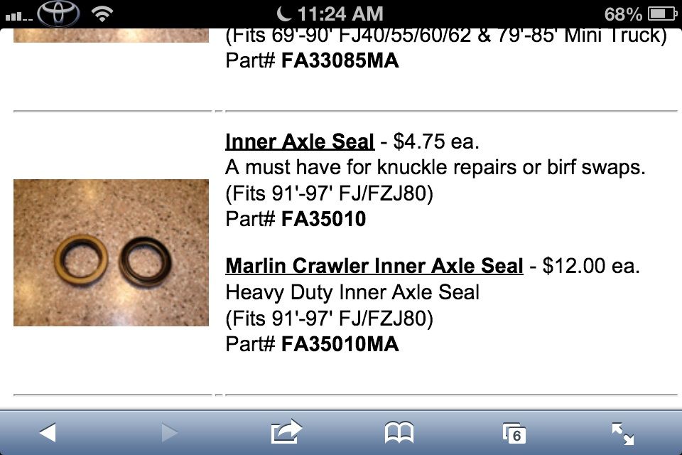

The ones I used werent Marlin I know the difference, it wasnt Marlin or Toyota but it was an OEM style seal that seemed to be of good quality but I'll take a pic once I pull it. Heres a pic off CruiserOutfitters site of the ones I ordered #FA35010 It's hard to tell if they have Toyota in that pic or the ones I received - My breathers are already ran to the bay so dont think thats a problem although I'll check theyre clear of any obstructions. I have 3 Toyota OEM left which I purchased from the dealership so I will use one of them and go from there.
