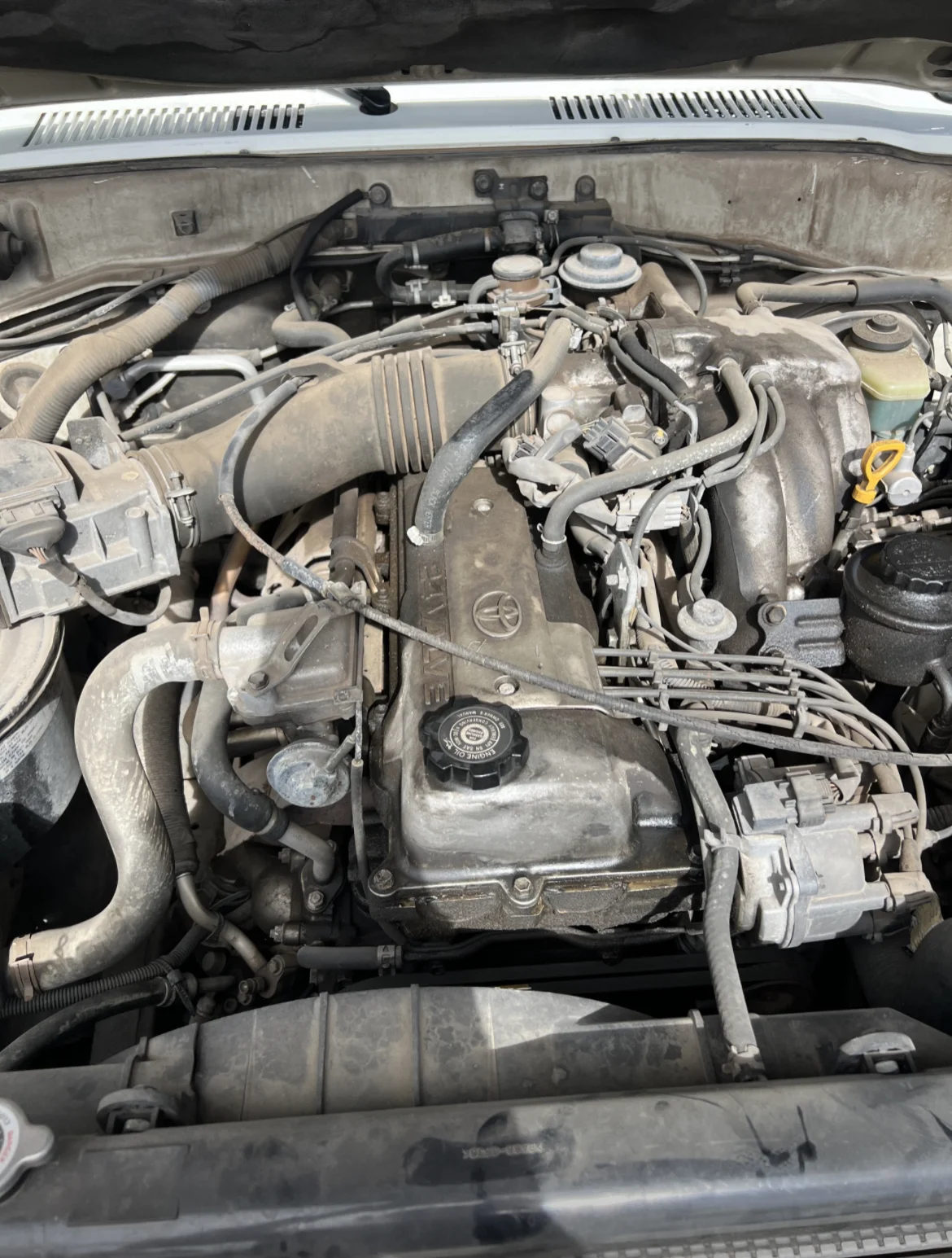

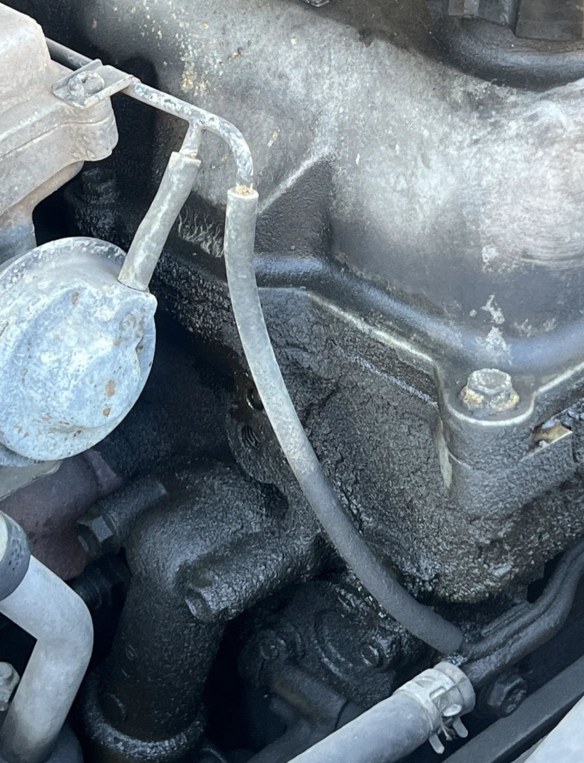

The engine bay has tons of oil

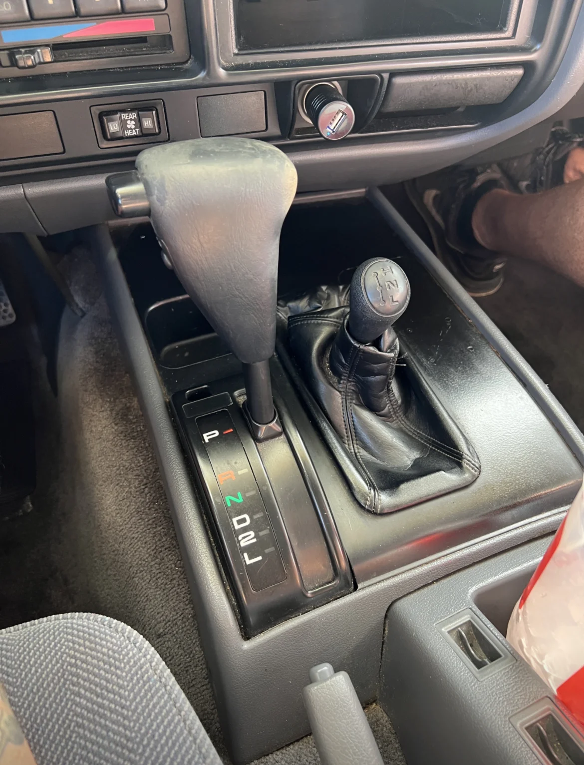

There is no button for the center diff lock

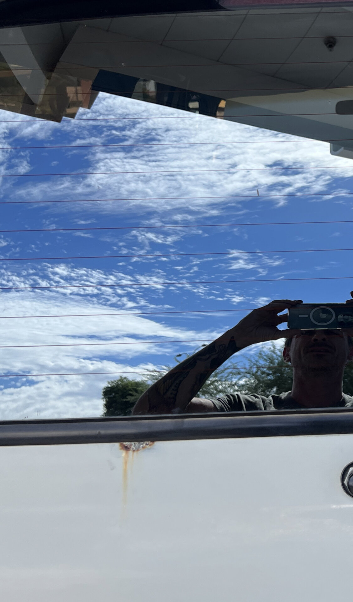

A rust spot on the back hatch below the rear window seal

Oil leak looks to be primarily from the valve cover gasket but would expect to go through others seals as well as PM.

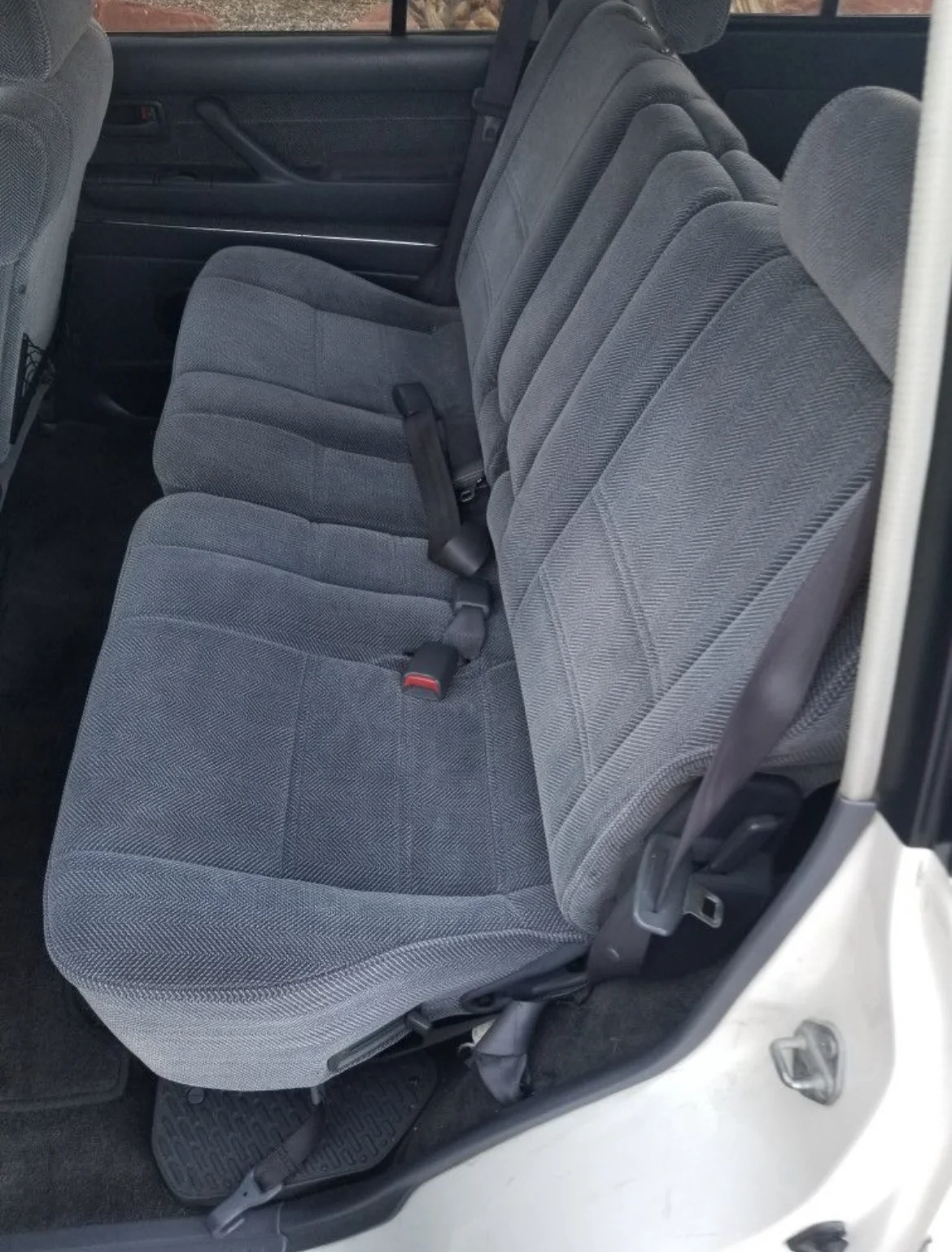

The interior looks great for age and miles.
Not sure if you are referring to center diff lock or factory lockers. Not sure if 94 had factory center diff lock button, wiring should be there though.

Definitely address rear hatch rust. I would spend some time looking inside rear storage compartments and around rocker, floor boards to make sure that is isolated. My 95 which has been a California car its whole life needed a small touch up in the hatch area when we took the glass out for paint. Pretty common.
From the pictures as long as the price is right your probably good to go as long as your comfortable addressing the leaks and that bit of rust

Interior is right on. Looks great!
The feature list is odd - cloth, no lockers, and no luggage rack, BUT with a sunroof.

I would clean the and degrease the entire thing and see what seals need to be replaced. My intent would be to restore to as much as factory as possible. Only upgrading to slight off-road improvements like lift kit. I don’t care for the overland look. Especially a white one is want it to look stock but be capable. Because the frame is so pristine I’d be interested in potentially fixing itv up to sell and use the funds to get a triple locked to keep for long time. If this had the triple lockers It would be an end game LC
Good. A CDL button from the factory means that it doesn't have ABS and doesn't have a fully-floating rear axle. It get advertised on Craigslist and whatnot as some great feature when it's actually a sign that someone didn't want to pay the $500 upgrade when new.

I had the EXACT same rear hatch rust problem and was pretty easy for good body shop to remedy correctly.

As far as general issues, as others have said, hatch repair can be done or at least controlled for now and cleaned up. Oil leak really isn't that bad since it's more caked than dripping out of it (shows a long time slow leak). A quick engine clean and you can diagnose the repairs needed, starting with the valve cover gasket. Whine can be a lot of things, but doubt that it's catastrophic given the overall look of the truck which shows minimal abuse.

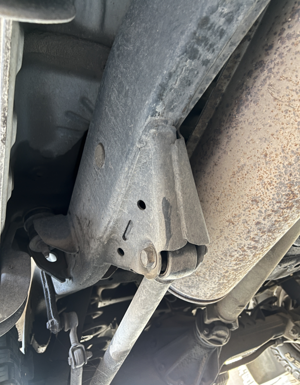

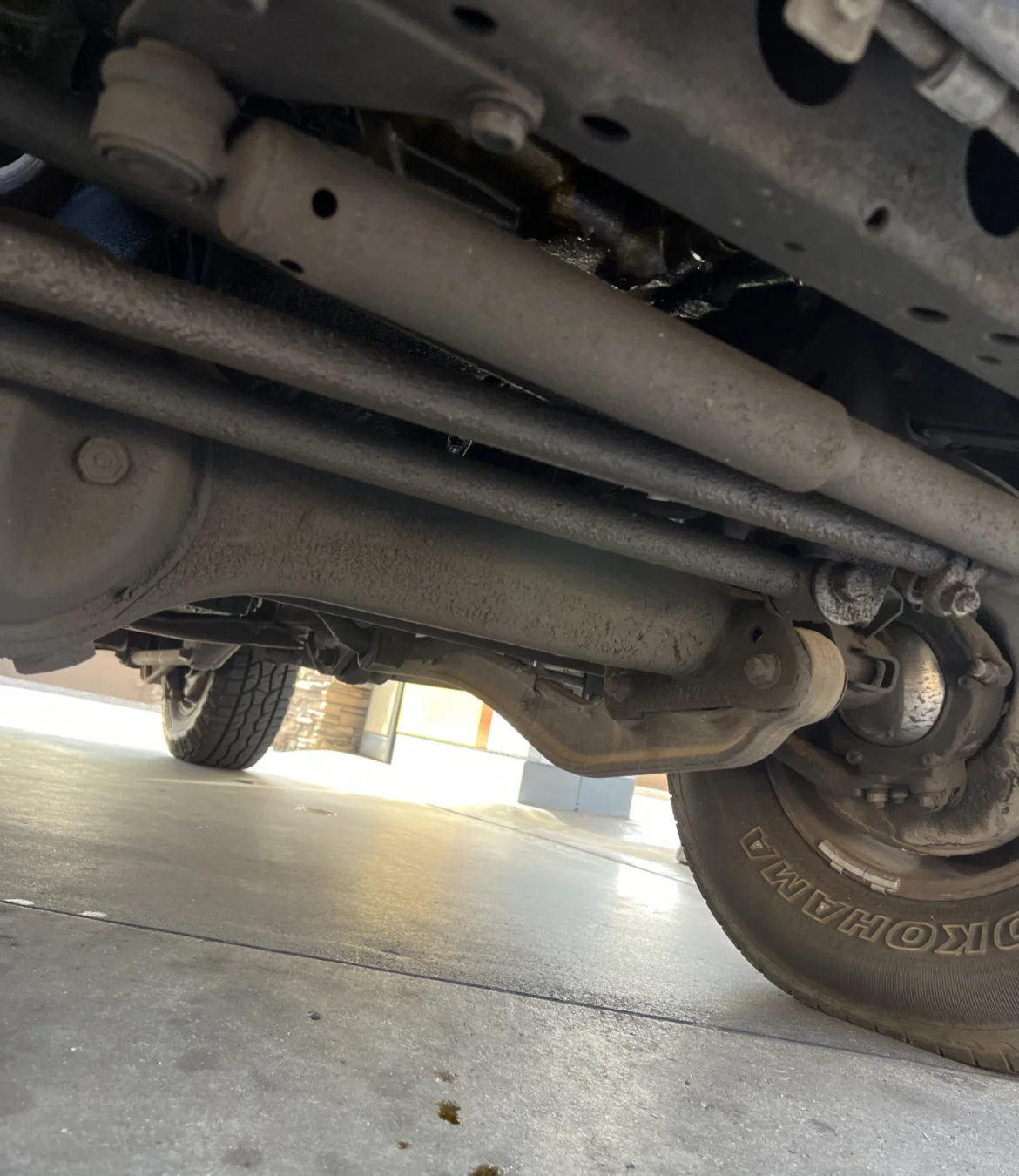

One quick note after looking through your pics again, I'd probably plan to service the front axles...the wiper seals on the Birfs look a little "too dry" for my liking. At least pull the plug out of the top and dip the grease to make sure it's still looking good and proper fill (easy to find out how here on the forums). I'd plan on checking these plus changing all of your diff and trans fluids right off the bat unless you have some service records with history on these items.
