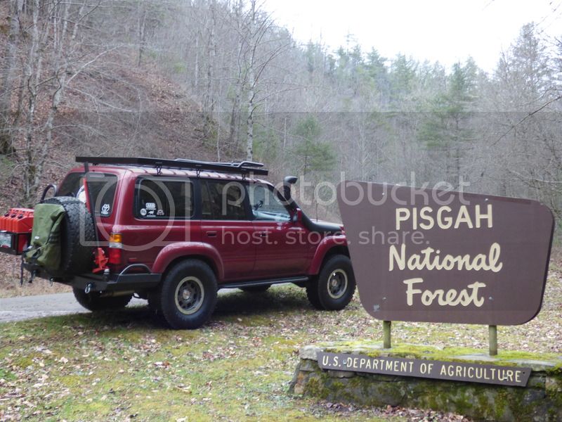

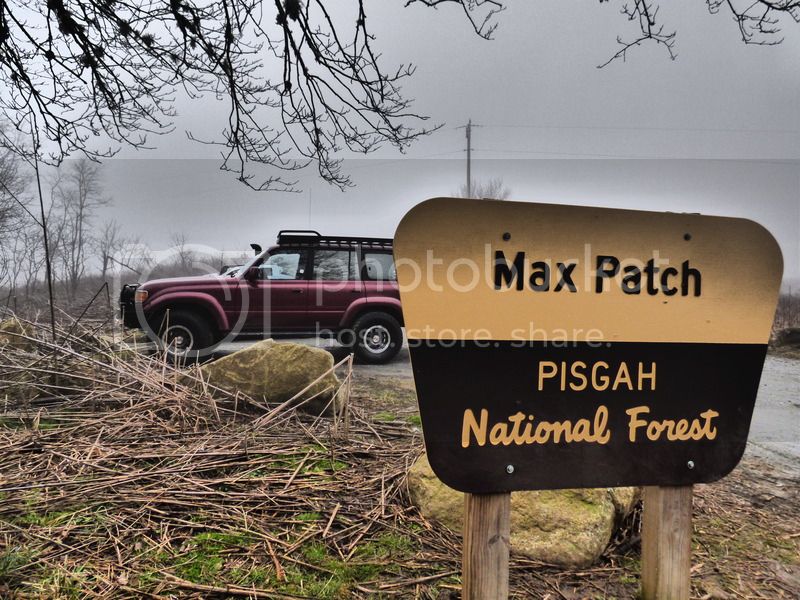

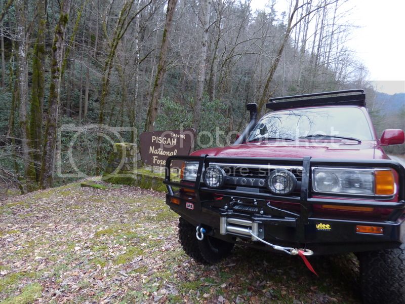

The wife and I took a little day trip up to Max Patch this afternoon. Right around 3500 feet the fog got thick and by the time we were at 4300 feet, the temps had chilled way down. Had a great time and I think my wife enjoyed it as much as I did.
Nice looking truck, dude!
Thank you, sir. It took me a while to get there but it was worth it. I have a set of OME heavy springs I need to put on the rear but can't find the time right now. After I added the rear bumper and 35" spare, it dropped the rear some. I've actually been kicking around the idea of buying a 100 series again if I can find the right one. I like the 80 but I miss the ride of a 100 and the V-8.

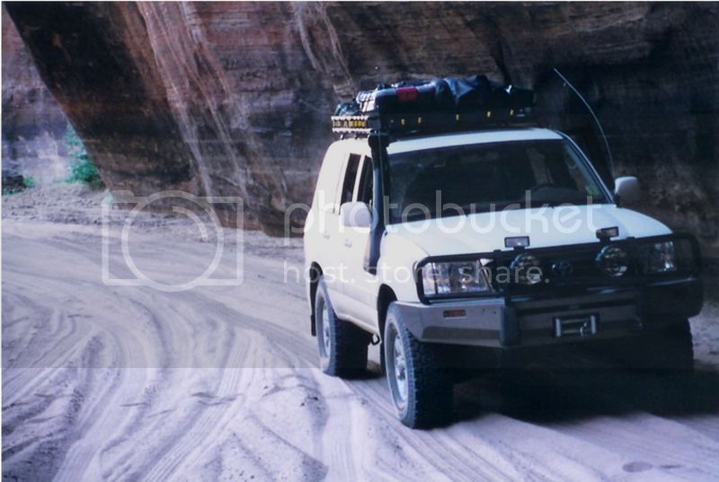

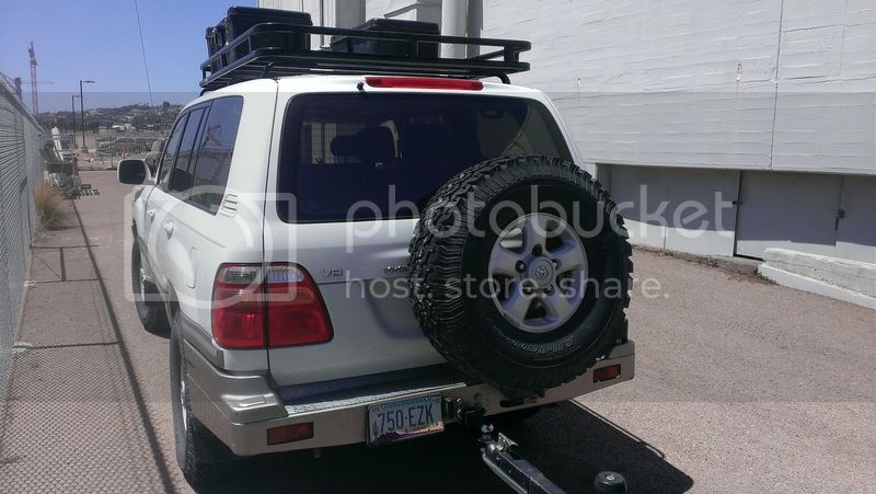

I sold the 80 a few weeks ago and started my search for a 100 series. Don't ask me why, just wanted back in a 100. You can't beat the 80 for pure off road capability but I also drive on the road a lot. The wife and I have good friends that moved to Denver last year so now we have another reason to hit the road and head out west. I'm wanting to take a couple weeks off and head up through the Dakotas, Montana, Utah, and back through Colorado on the way back to Tennessee. The 100 is a lot more road friendly and for what I want to do, will be great off road. I'll have a few small things to do but this one is ready to hit the road as soon as it gets here. The guy I bought it from is a MUD member and is driving it to me from Arizona, where it spent it's life since new.
Here's the list of mods, only thing I have to do is put a new timing belt and water pump in.
1999 with 98,000 miles, rear e-locker, front ARB air locker with 80 series dial, ARB on-board compressor, 4.88 gears, 315/75R16 BFG KO tires, ARB front bull bar with Warn 9.5 winch, TJM rear bar with swing out for the spare, Safari snorkel, roof rack, new White Knuckle slider ( not installed but included ) 25 gallon stock tank, 43 gallon long range tank, dual battery system, fresh water storage system with 15 gallon capacity and electric pump, custom storage rack, ARB frig, Cobra CB and Ham radio, and some extras that the owner is throwing in. I bought a HEO awning that I'll be installing and will also be changing the sound system to a double din with Bluetooth. Tires are about 50% so within the next year I will also need some new 315 tires. I may start looking for some TRD Rock Warriors and go with 17" but I also like the stock 16" wheels so not sure if I will change them unless I get a deal on a set. I'm not sure I like the matching trim paint on the bumpers, may go back to black. It will be here on May 1st so this will be a long 3 weeks but it will be here before I know it.
