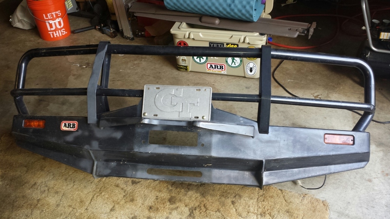

Got my ARB bumper today. It has some gray primer or something on it but no dents. Paid $650, is that too much for a used bumper not in perfect condition? It also has a really ugly plate on the front, really ugly :)
Nah, that's a pretty good price for a good used bumper. Little rattle can semi-gloss or gloss black and you will be solid.
If you have a cherry picker, use it during the install. Your back will thank you. Otherwise, phone a friend.

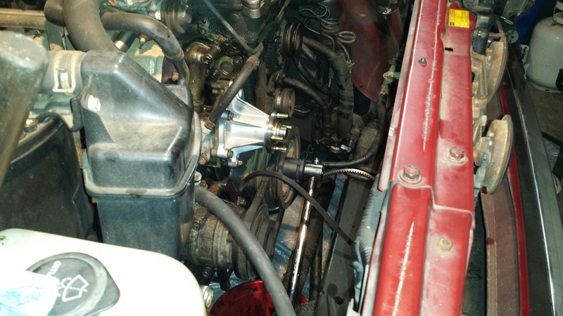

Spent some time on the 80 yesterday. New radiator, belts, hoses, front main seal, distributor O ring, and also put a new O ring in the oil pump cover. Breaking the bolt on the harmonic balancer was a lot of fun..........not. Found a video on Utube and used a breaker bar tied to the under side of frame to hold it in place and then bumped the starter until it broke. Pulled the inspection cover at the flex plate to hold in place to tighten the bolt back up and everything was dry in that area so I think except a valve cover gasket, my oil leaks should be about gone.
