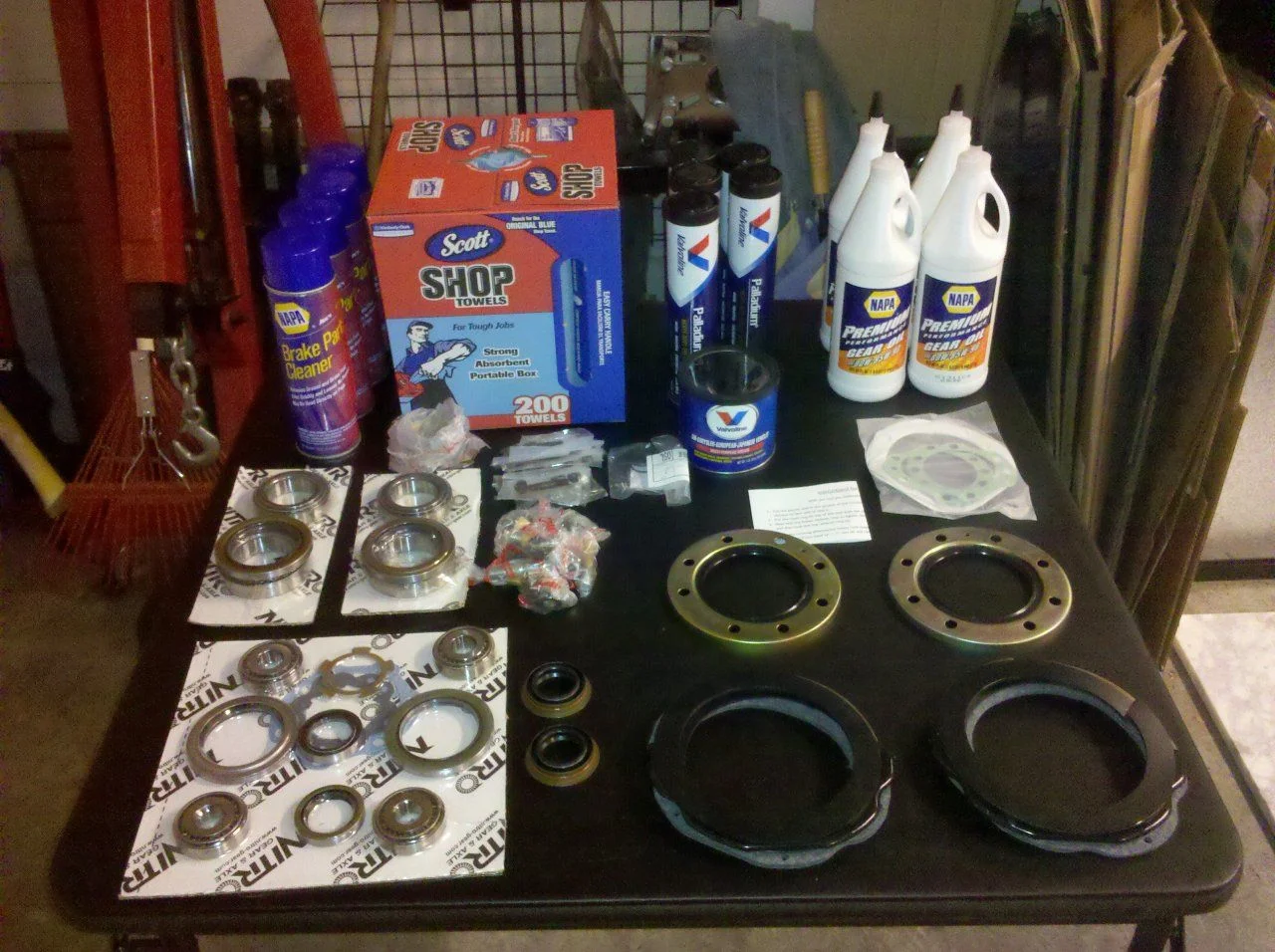

you just need a handful of actual tools, a good hammer and a brass punch for the cone washers. If you don't have the 54mm socket a 2 1/8" will do the job (check me on that) good set of jack stands. Make sure you have plenty of grease, might even go ahead a pack all the bearings ahead if you have some free time. Keep track of where the shims go on the knuckle caps. and make sure you have LOTS of shop towels, a couple catch pans for the axle ends and some of those latex type gloves for working with the Moly grease... that stuff is nasty if you get it on you.
Once you knock it out you will be glad you did it and will realize it really wasn't that bad, and you will be ready to knock out the next thing on the list.
Anyone know the exact size of the hub socket I'll need? I looked it up and saw a couple different sizes. Also, do you know if that's something I can find local or will I need to order it? Thanks for putting up with all my questions.............John

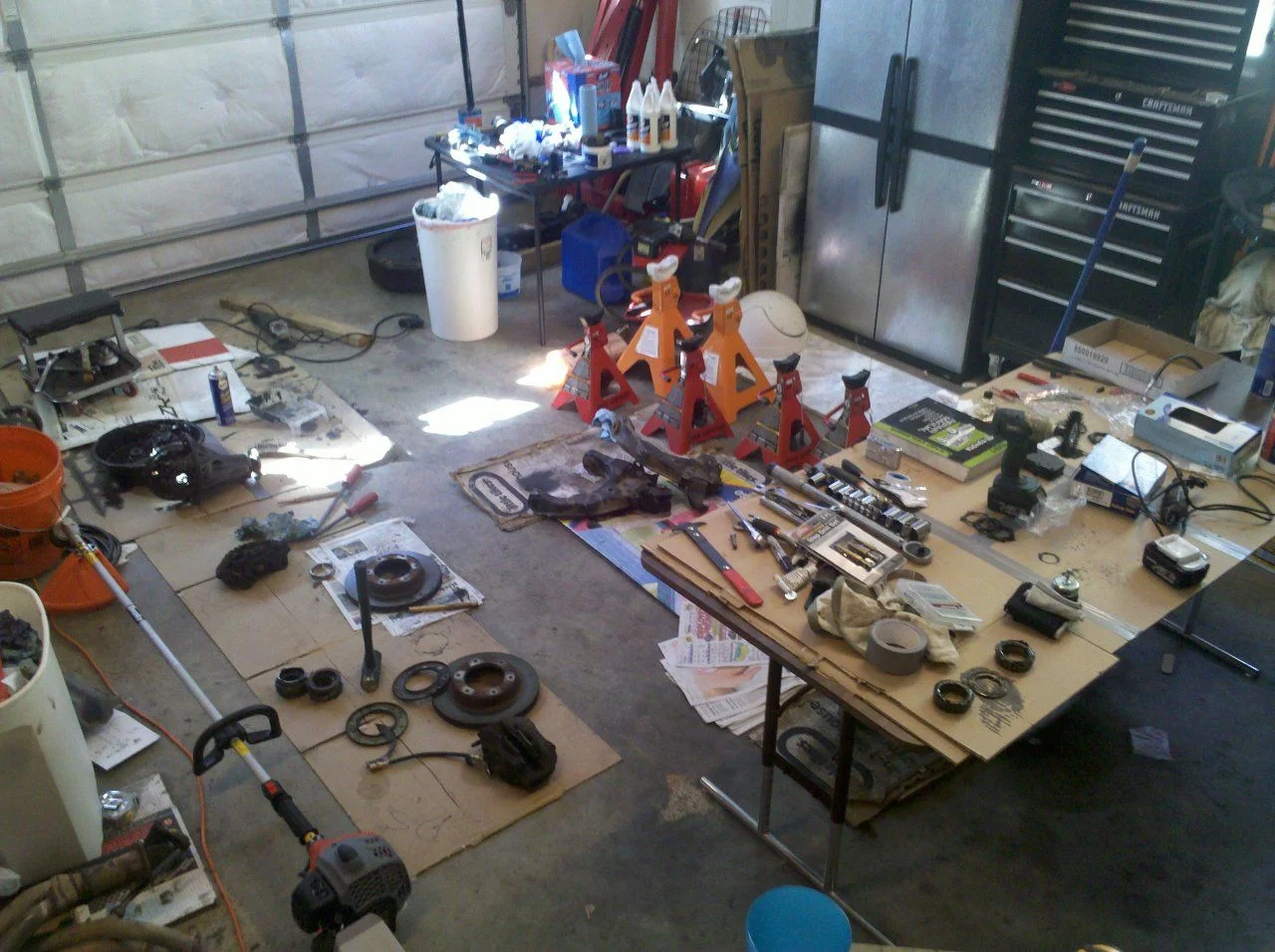

Prep for my axle job the night before.
I think this was after.... the rotors are the old ones and the chunk is the factory geared one because I had dropped in a 5.29 geared one during the rebuild.
It took me a day, mostly by myself. I spent the second day sorting the new brakes and topping off the new brakes.
Thanks for the pics, that really helps. Now I know what to have on hand to start the job.
