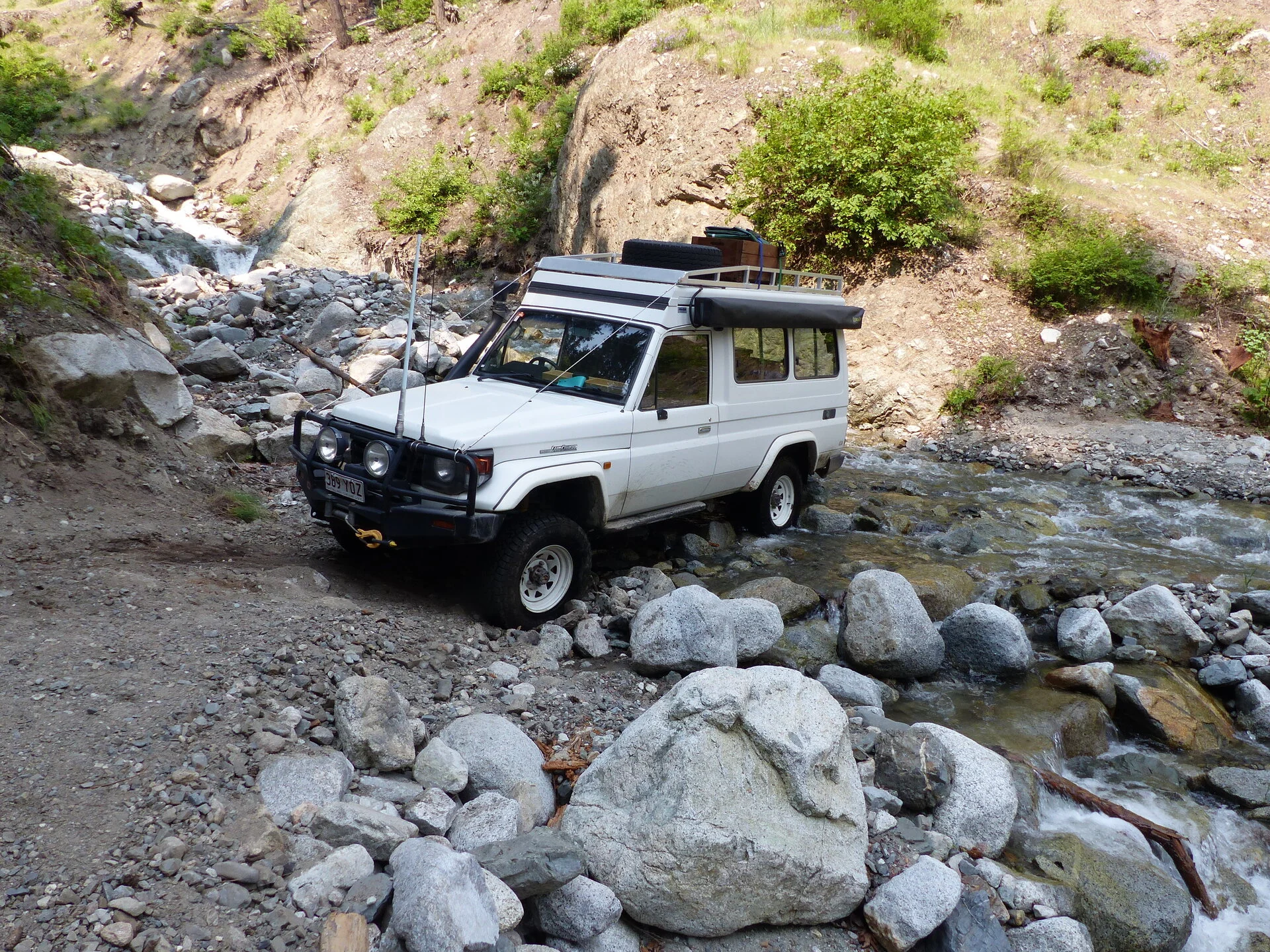

As stated, I have a 2003 HZJ78 with tired Dobinsons on a 2" (50mm) lift. I don't know what model or size the Dobinsons are. Looking for some suggestions for replacements options (ideal length, IMS vs remote reservoir, etc.). Maybe new versions of what I have are the best route, if I only knew exactly what I have.
The Troopy is a little top heavy, tippy, so I would like to address this as much of that as I can. I want to find harmony between use for aprox. 50% paved road and 50% gravel backroad (incl. a little bit of steep rubble and lumpy creek crossing).
Your experienced input would be appreciated, be it sticking with the same, but new, Dobinsons or otherwise. Thank you.

to address you shock aabsorbers,and the tipping problem, My simple advise world be , take away any extra load from the roof. This will greatly reduce the tipping problem AND help shocks .
