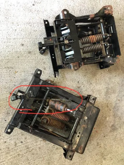

You can see here the aftermarket base with the rails welded to it. Not really a huge fan of this compared to the OEM levers but even in Japan those parts are hard to come by.

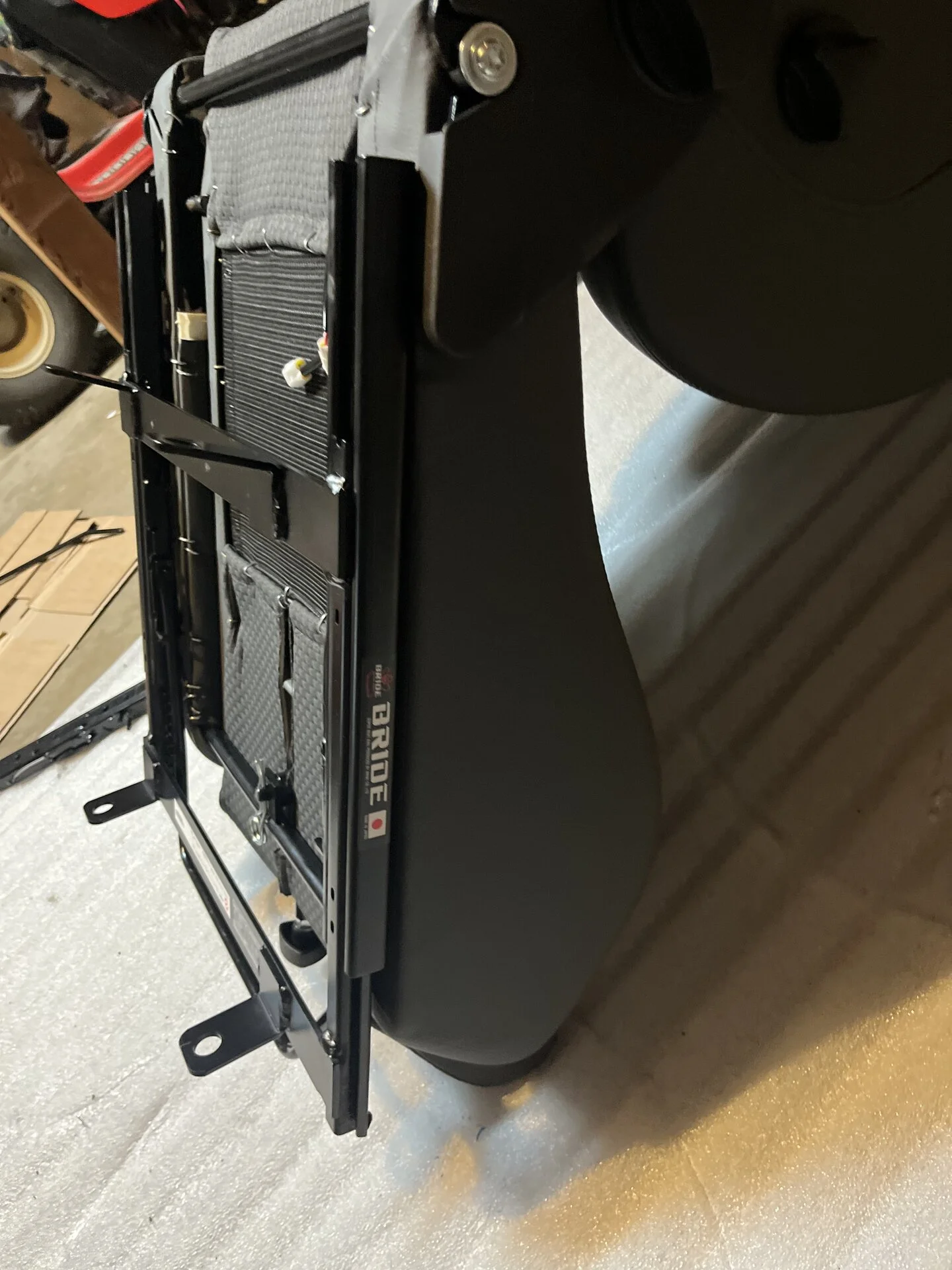

Here is the side of the rail that is not OEM.
Also, does anyone know how to get ahold of the spring and lock lever for the suspension base? Can’t find part numbers anywhere. The previous owner I think took them off to fit this seat base. Currently working on a lever that may or may not work but the spring is being tricky to figure out. I don’t really want to keep my slip ring with turnbuckle contraption I’m using now forever.

Those spring and lock knobs were removed by previous owner because he was too lazy to get the proper adjusting bar. The original adjusting bar on those bride rails will hit the spring and lock knob.
I have those same bride slider and rails you have but I had to get different adjusting bar to clear the knob.

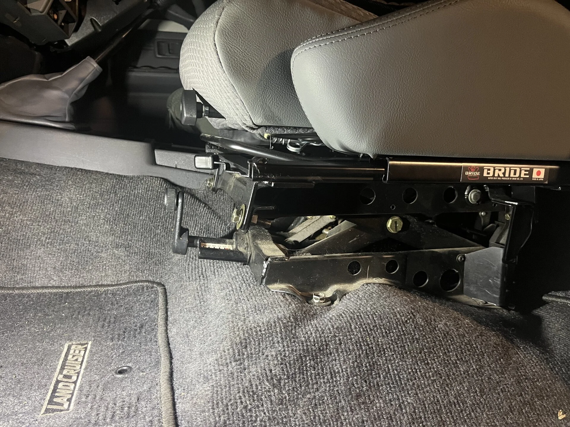

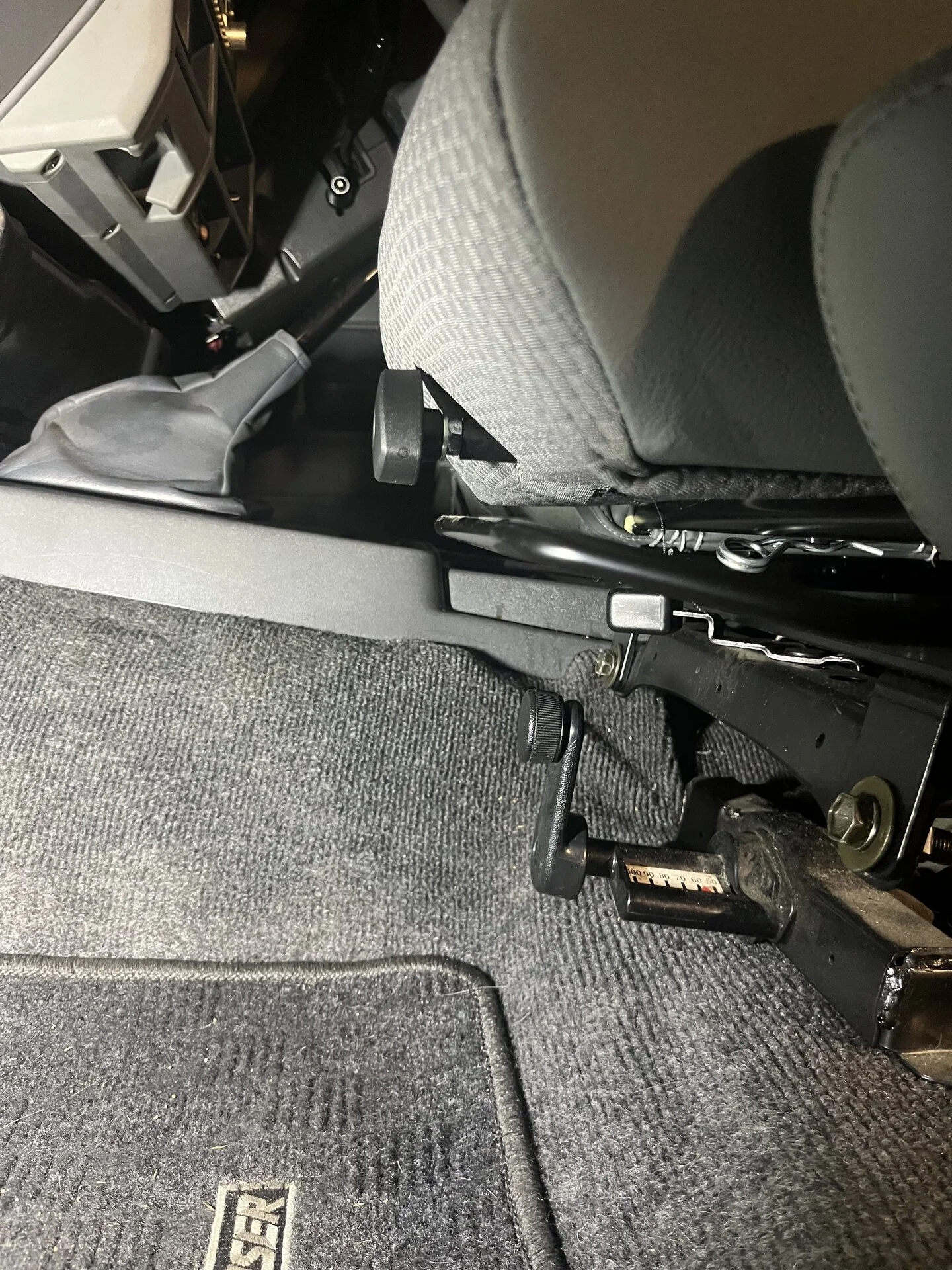

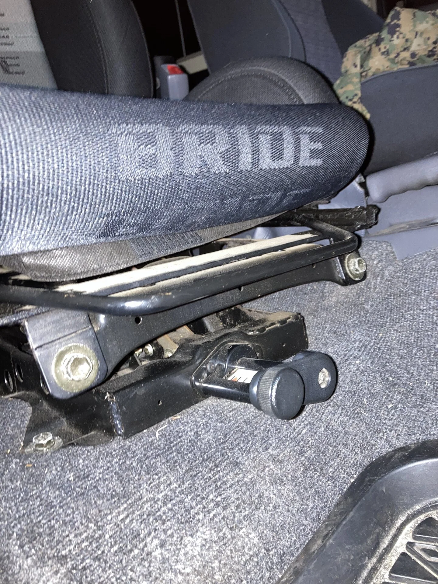

I see you have the right adjusting bar. You just have to remove it and flip it upside down and reinstall. Once you do that, it will clear the knob.
Like this.
All the way back:
Forward some:

Yeah that was my suspicion. I am in the process of trying to turn an old putty knife into a usable lever. Just need to figure out the spring. Already tried one from a razor scooter and it wasn’t nearly strong enough. Also straightened out a key ring. I think my next step is to try and pull a spring from one of the abandoned cars around base.

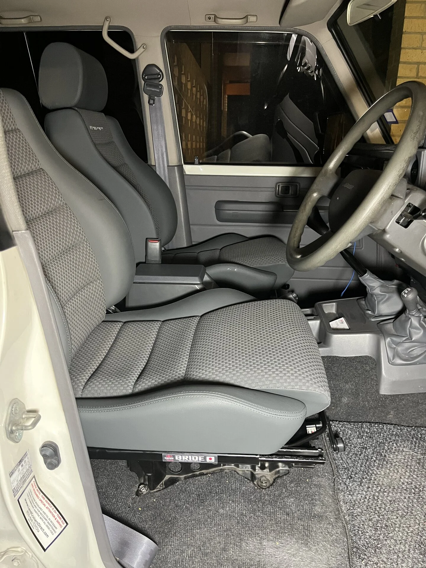

The seats are scheel-mann vario f. They are the exact same width as bride seats so they sit right on those rails except you have to modify the front to back holes used to mate the seat base to the slider base.
Like this.
All the way back:
Forward some:
Just wanted to let you know that trick with the bar worked swimmingly. I would have expected it to be a lot harder to remove. Still working on the bracket to get the cable pull distance right but it bought me an inch and a half to get some hardware in there.
I am glad it gained you some space.
Since that bride slider/rail set up is specifically for the suspension 70 series bases, the adjusting bar should have came installed that way. Why it wasn't, I don't know.

I wish I had taken photos to document the modifications but I didn't.
The Bride brackets are 260mm from front to back. The width is perfect at 405mm which is what you need for scheel-mann seats.
The scheel-mann mounting holes are 265mm from the front to the back.
I drilled two new back end holes to get 265mm from front to back on the Bride bracket sliders. I used the original front holes for the 260mm option
Below is a snapshot of the scheel-mann mounting seat bottom holes (in black numbers).
Hopefully I made sense of what I did.
One other thing I did was cut off the seat belt mounting bracket (for the seat belt buckle) on the side. I didn't need them but you can leave it if you wish.
