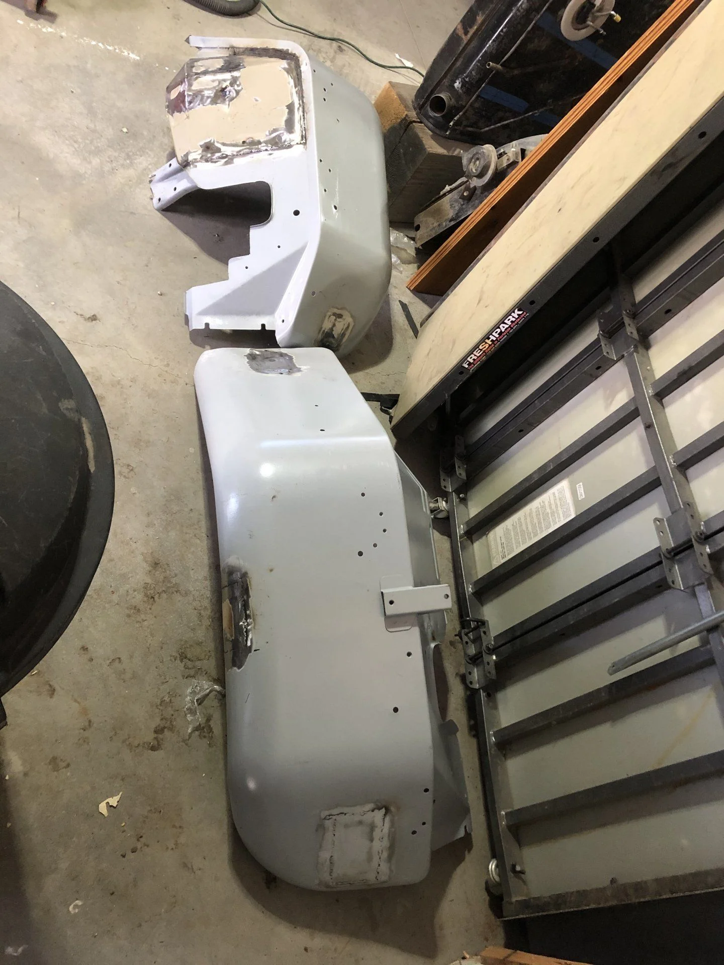

The fenders are getting close to ready for a bondo skim coat. The turn signal holes are filled and the old steering box opening has been deleted.
This brace surprised me: the outer edge was rotten, but just a few inches up the brace it still had good factory paint on the brace.
Like I said, I’ve deleted the turn signal on the fender. So I have a freebie for anyone patching their fenders. I know mine rotted out in my original fenders. This one is in good shape, the other one was toast. Pay the shipping and I’ll send it to you.

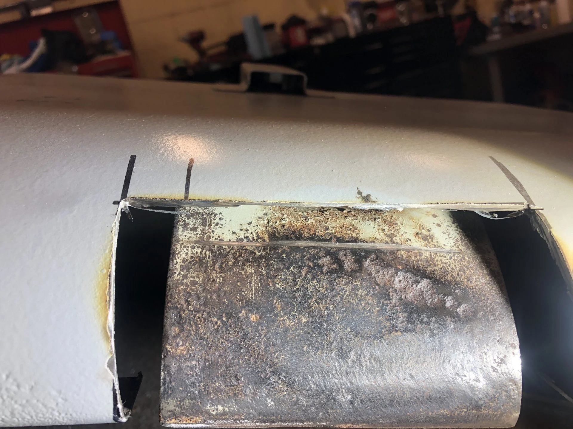

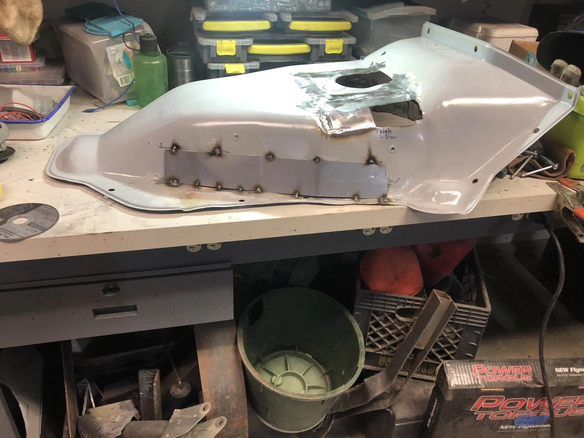

So here’s the rust repair on the drivers side. It’s not the prettiest and the purists will notice the bump out for the pto(?) is missing. Sorry that’ll no longer be necessary.View attachment 2566201 Notice the gap on the top side of the patch piece(s) is a bit big to stitch weld. Also a bit nightmarish to make a proper patch. Plan here is to get the current bottom piece in place and then cut out a nice straight hole to patch rather than the jagged mess that is currently needed.
I had tried setting this patch up out of the vehicle and got a little happy with the cutoff wheel. Good news is the higher I go, the thicker the metal gets.

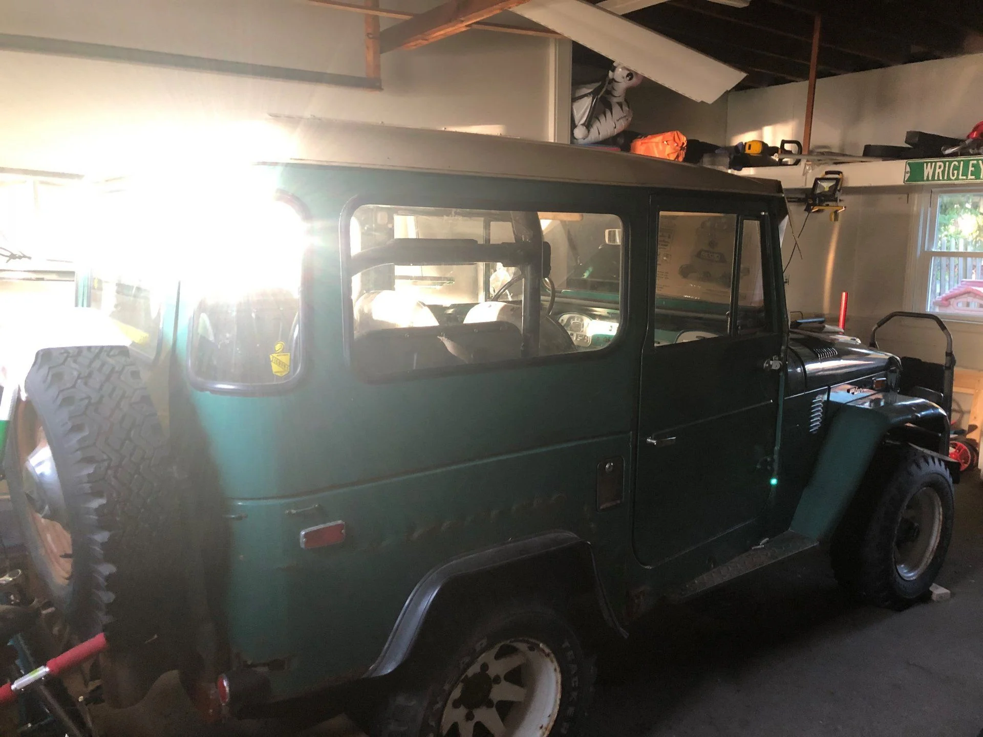

As I was making dinner tonight, I glanced at the frig and saw this picture. Five years ago I still had the (rusty) steel body. This guy is nine now.

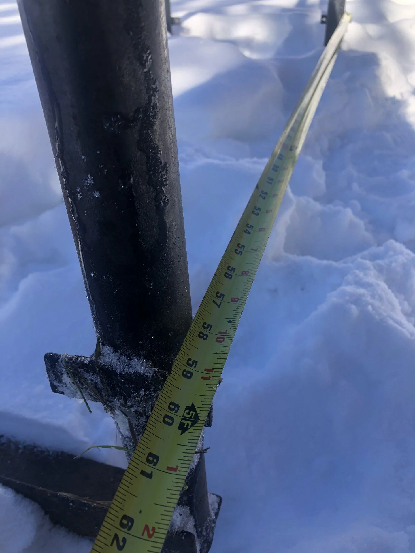

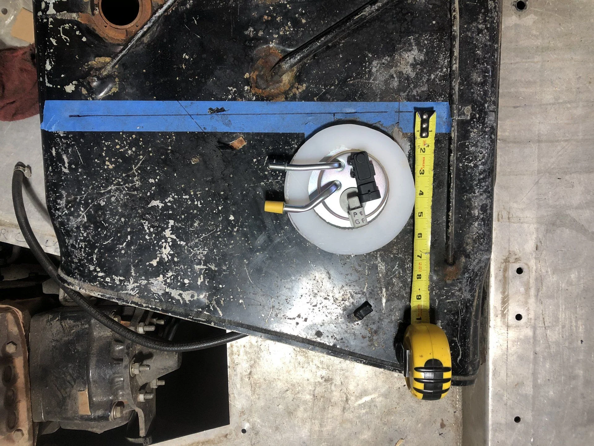

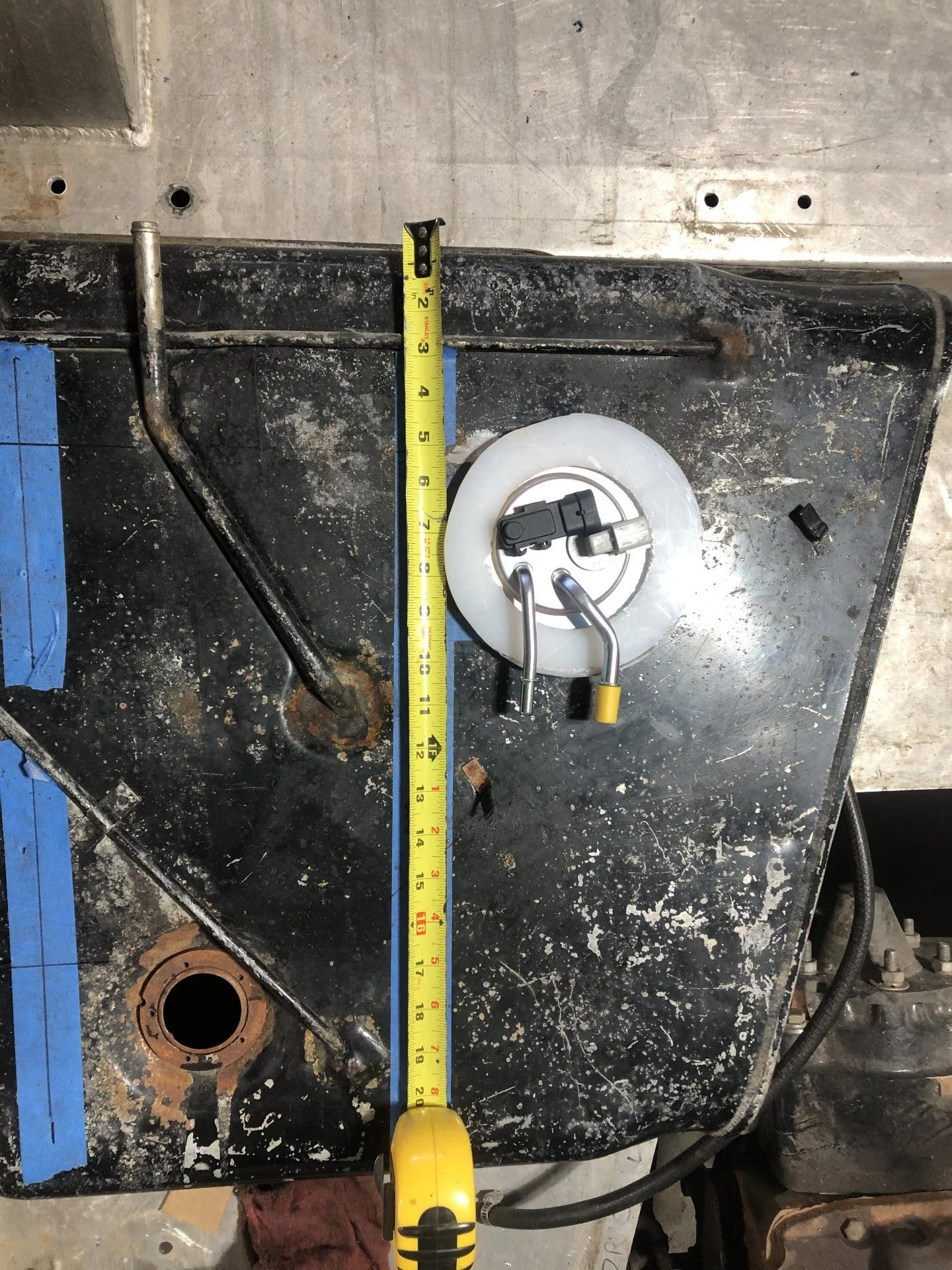

Could you please give the measurement from the side and the top to center of the housing for reference. I need to do this to mine.
Here you go. Basically it sits in the rear drivers side of the sump. The white ring isn’t centered on the pump, so don’t judge by that.

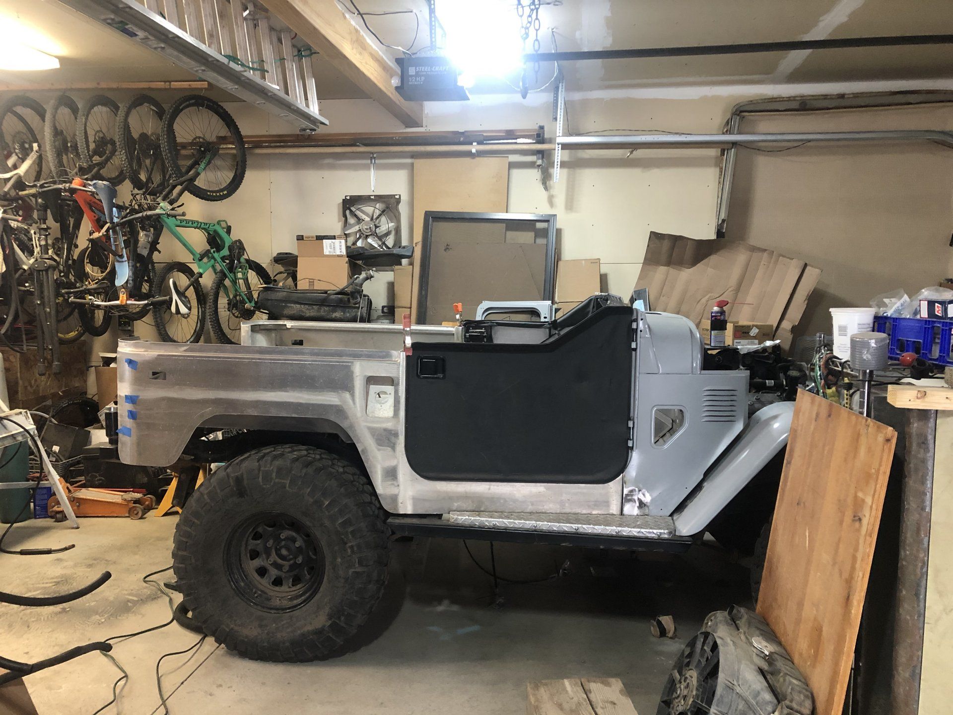

While I am making progress, I grow tired of the repeated theme and so I decided to do some mock up with the fenders and soft doors. This turned out to boost moral. Every time I add something that gets it closer to looking like a cruiser again, I feel better about my progress. Plus these are really easy to remove.

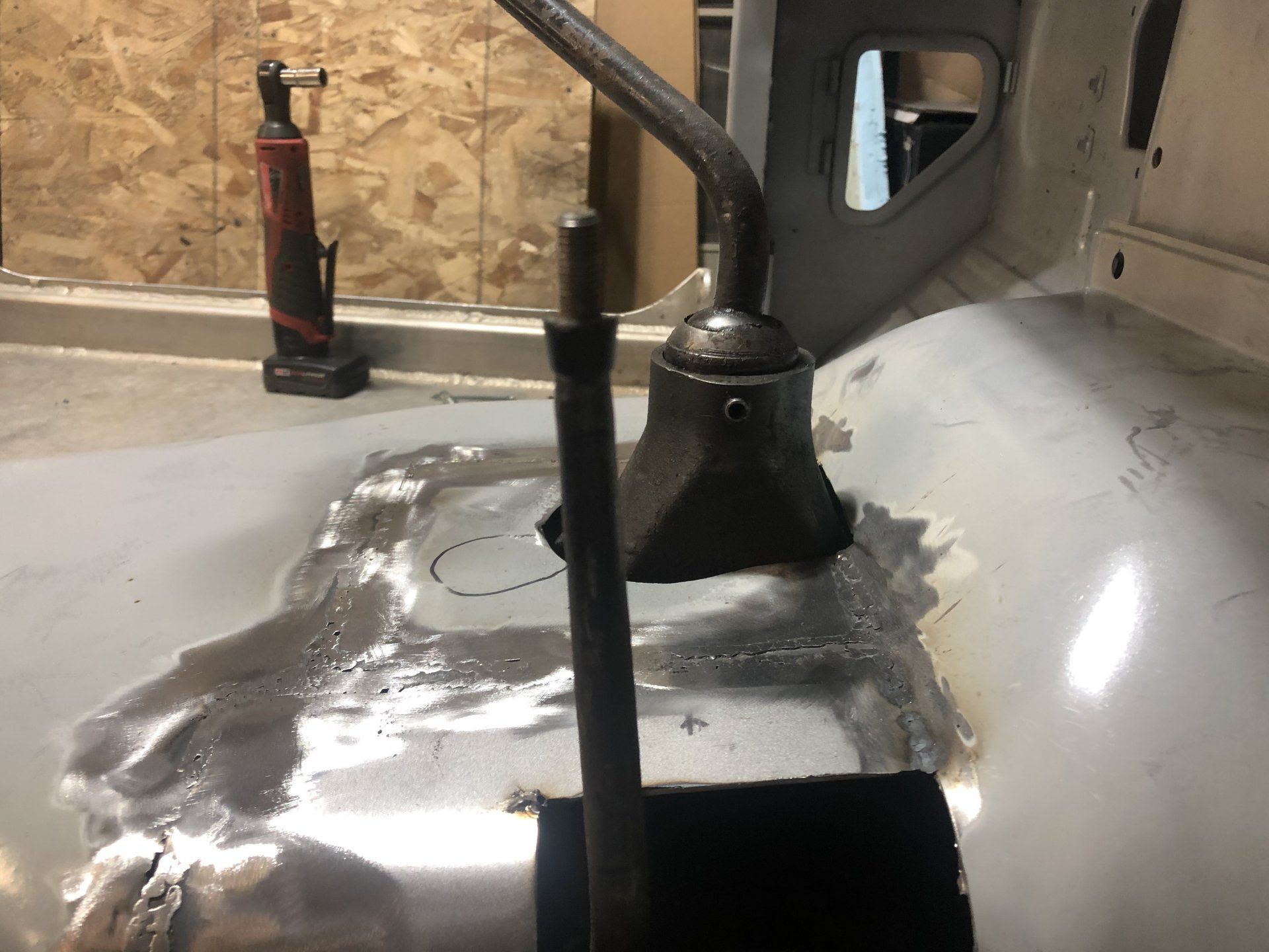

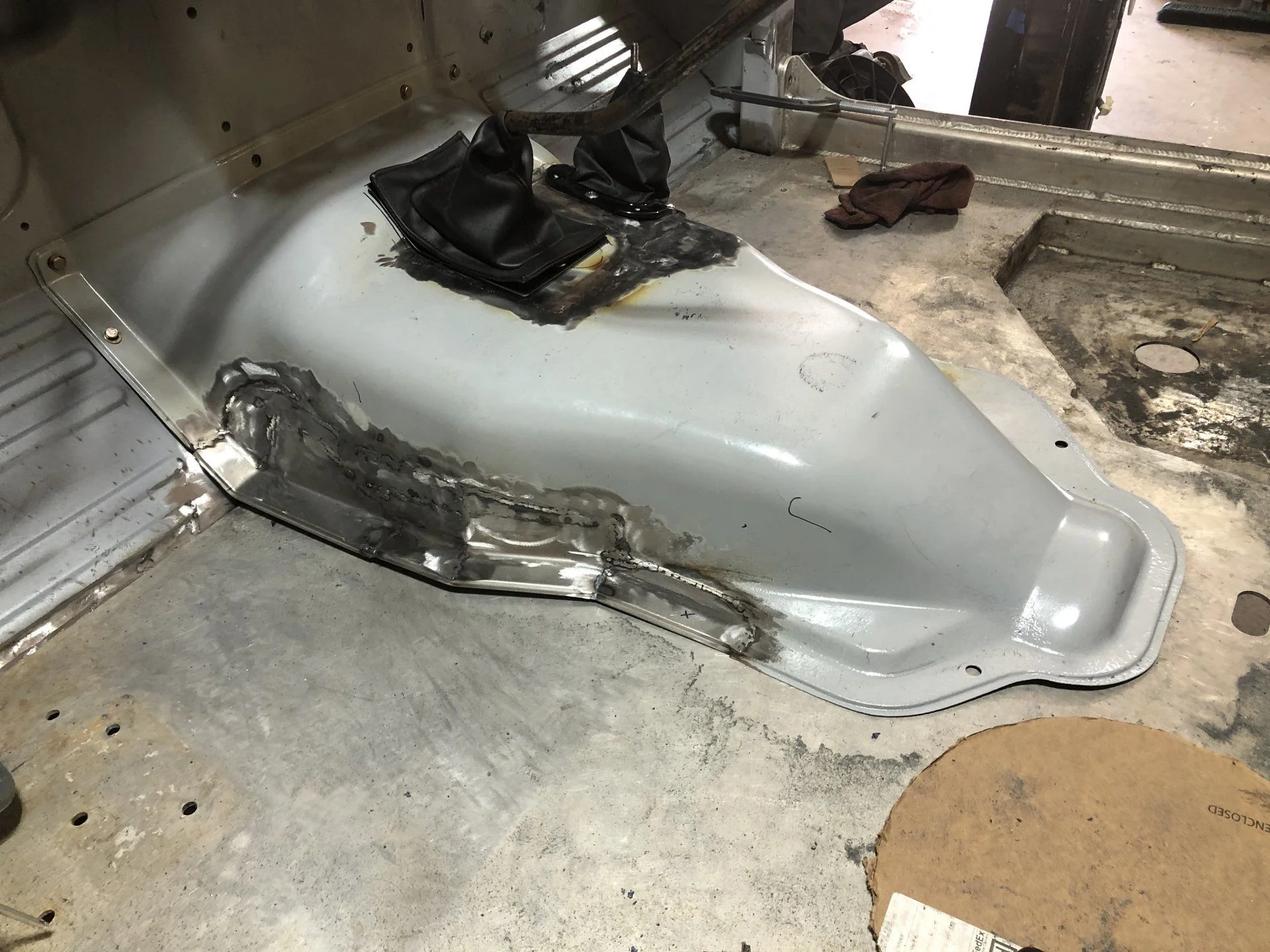

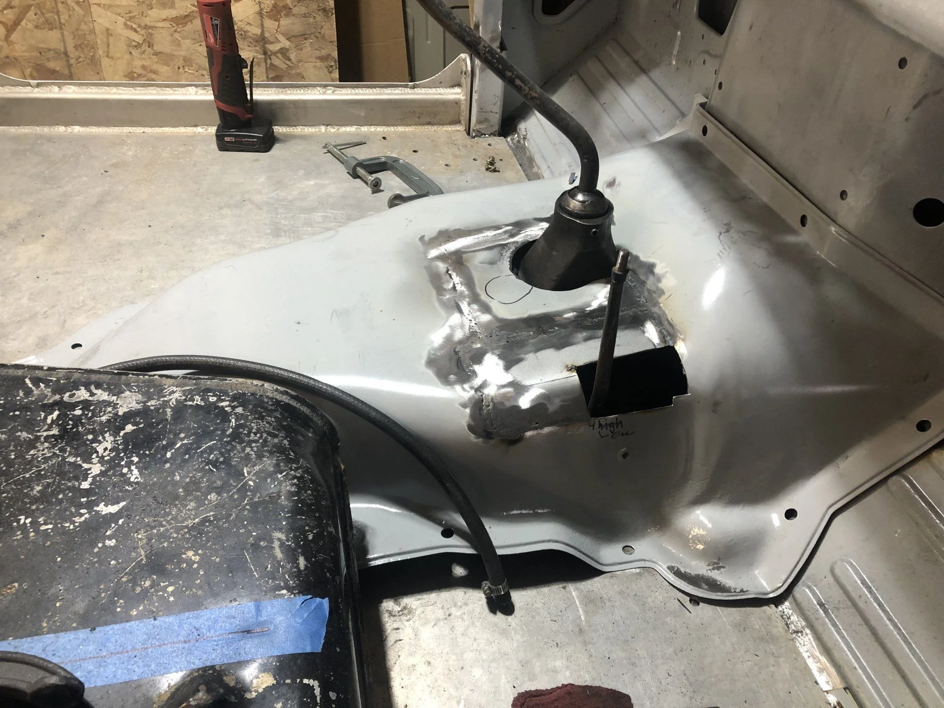

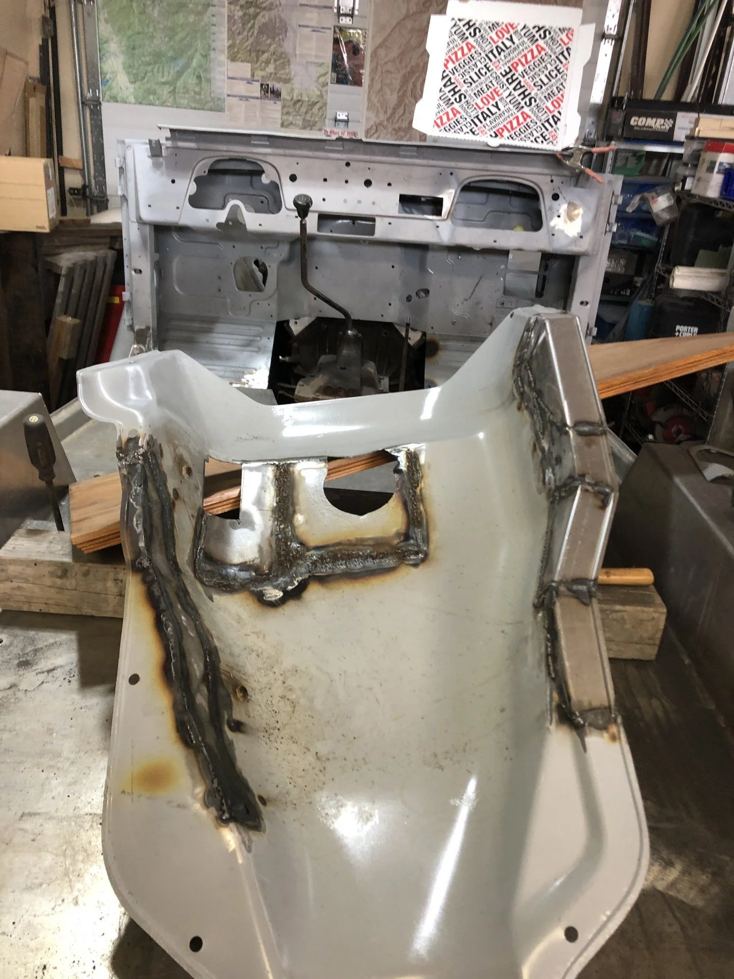

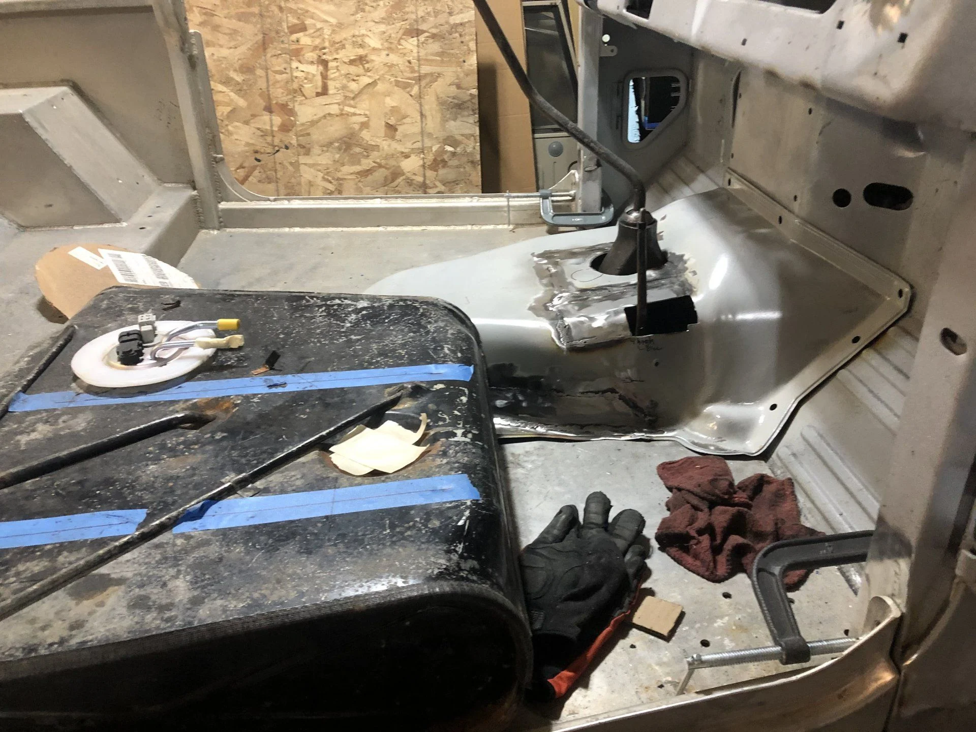

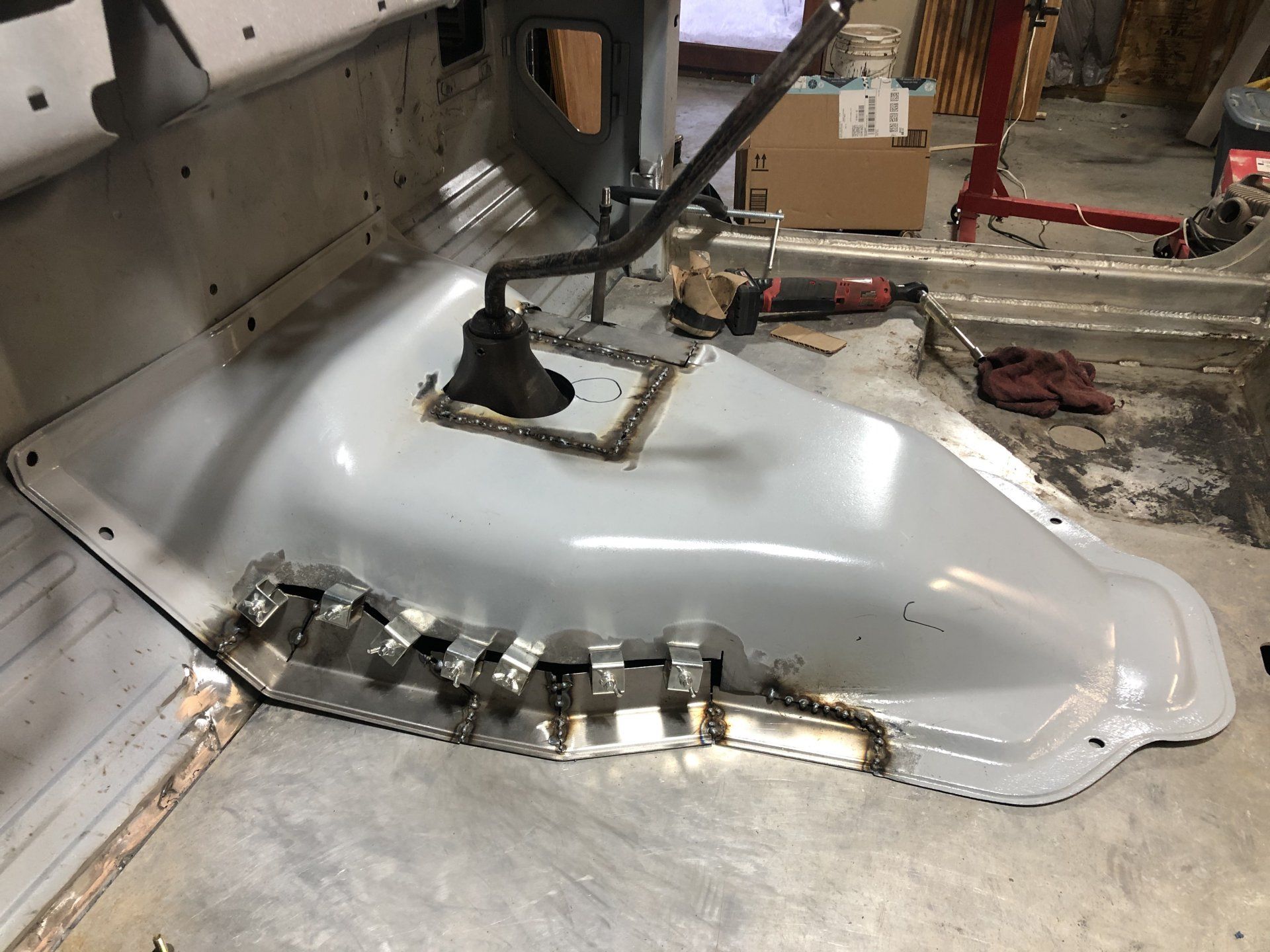

Ok, this thing is kicking my ass. First I cut to much off on the drivers side or made poor patch panels. Then I had to move the shifter holes- should of just made a whole new piece for that, instead I pieced together to much old metal. This caused me to chase thin metal that disappeared when touched with the mig. And then there was this side, because I have an Aqualu tub, I had to flatten this edge,
It’s been a learning expierence...

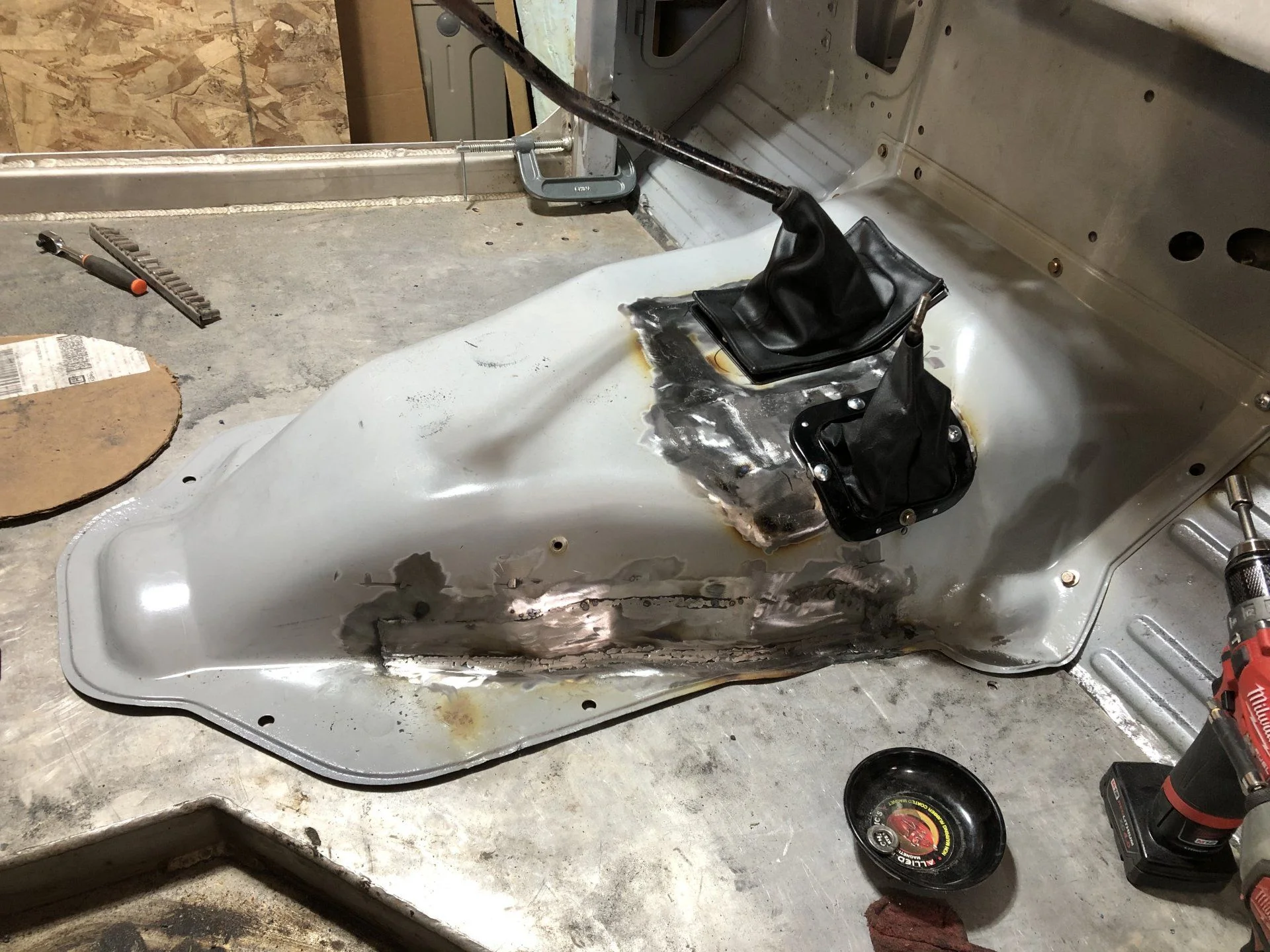

This pic was a moral booster, just seeing a few pieces put back together was nice.

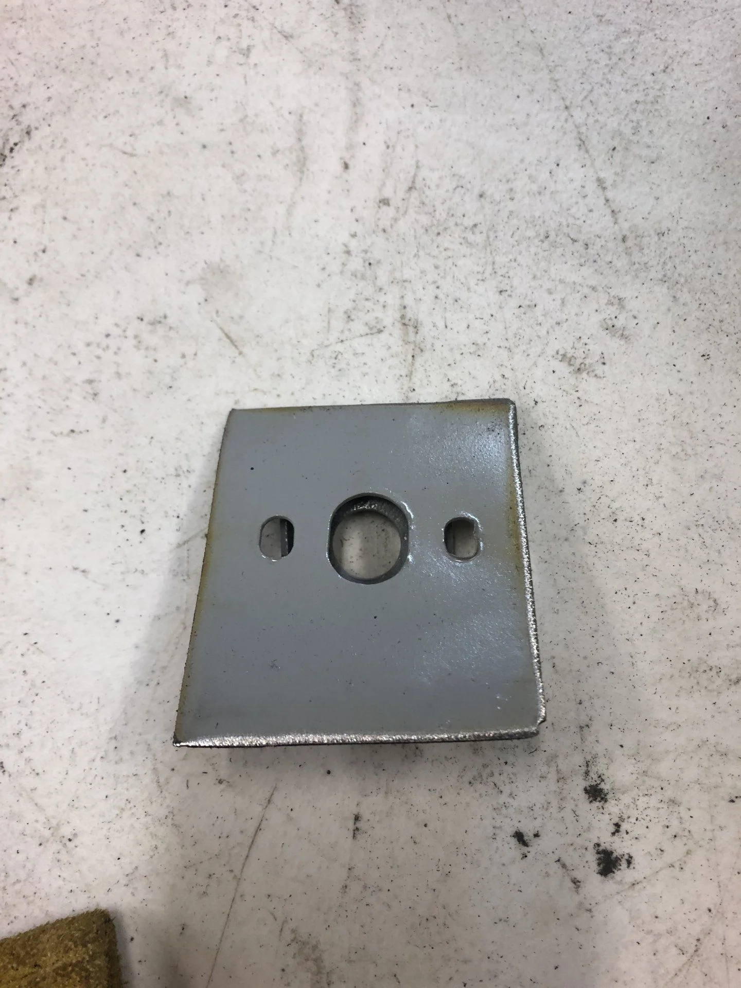

This is where I left it today. Once again the shift boots liftemy moral. Also, I wanted the holes drilled and the nuts welded on before going any further.
Still need to drill holes for the tunnel/tub, but that’s waiting for some nutcerts. Also I ordered a generic shifter knob for the transfer case- I couldn’t stomach ~$40 for the stock one. It’ll be black and low key.
The shifter boots are a stock Toyota dust cover for the transfer from CCOT and a PRP for an UTV for the Sm465. Had to make a trim ring for the PRP unit but that was easy and enjoyable.
