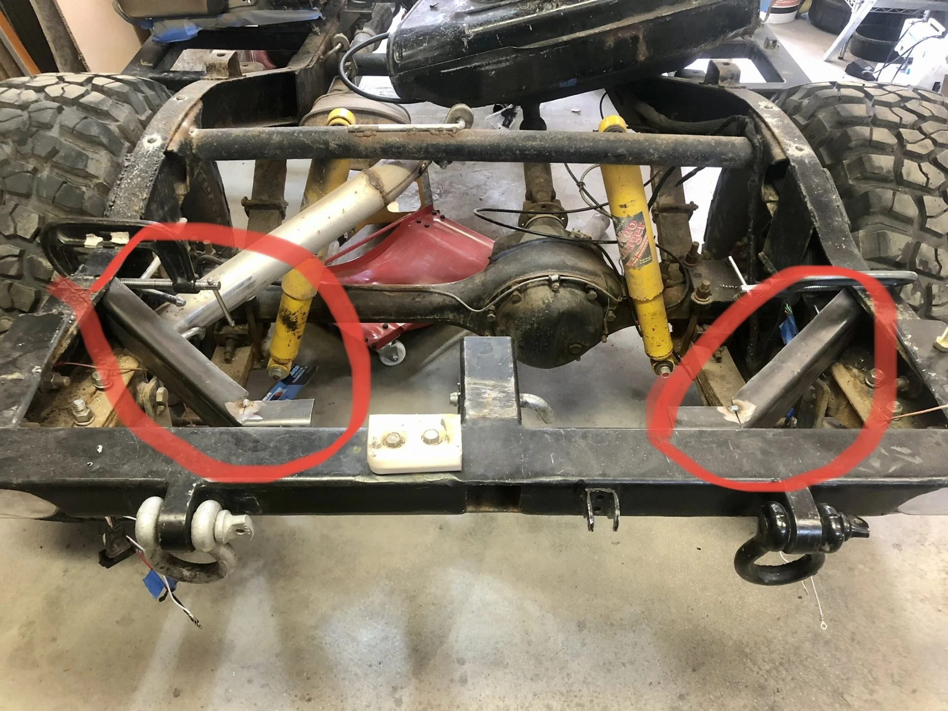

When I first made the bumper, I told myself I’d never tow anything with it. The receiver was just so I could put my bike rack on. Life changes and I decided I liked options, so I made up a set of braces for the rear bumper. I tried to mimic the original design with some 3” square tube halved. 1/2” grade 8 nuts and bolts with the beefiest threaded bungs I could find. Should I ever feel a need to tow anything, I’ll have more confidence in the bumper.

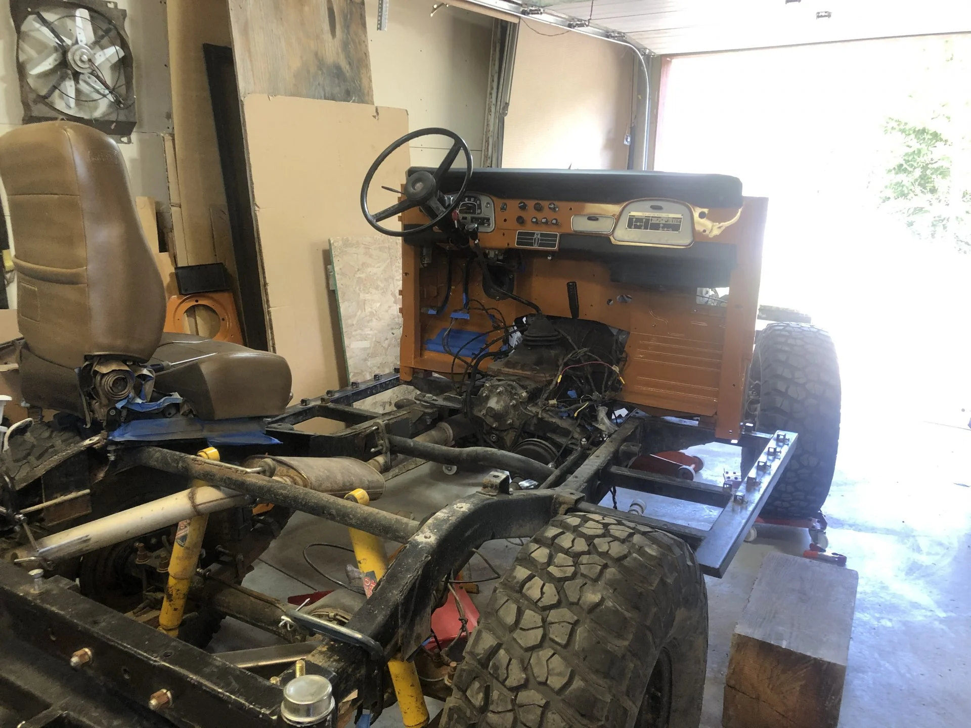

Yep, it’s time to start mounting the body. I took the time to refill all the dash pieces that were going to be easier without the tub attached. The pedal bucket was a fight, but I won. So now the cowl is bolted down and steering shaft is hooked up, so what’s a guy to do? Well I needed to get it on a trailer (so I could haul it to a different shop), so I hooked up the winch and pulled it out of the garage. I got to drive it!!! This is how far I made it, but that was enough to get it on the trailer and the rear tub set in place.

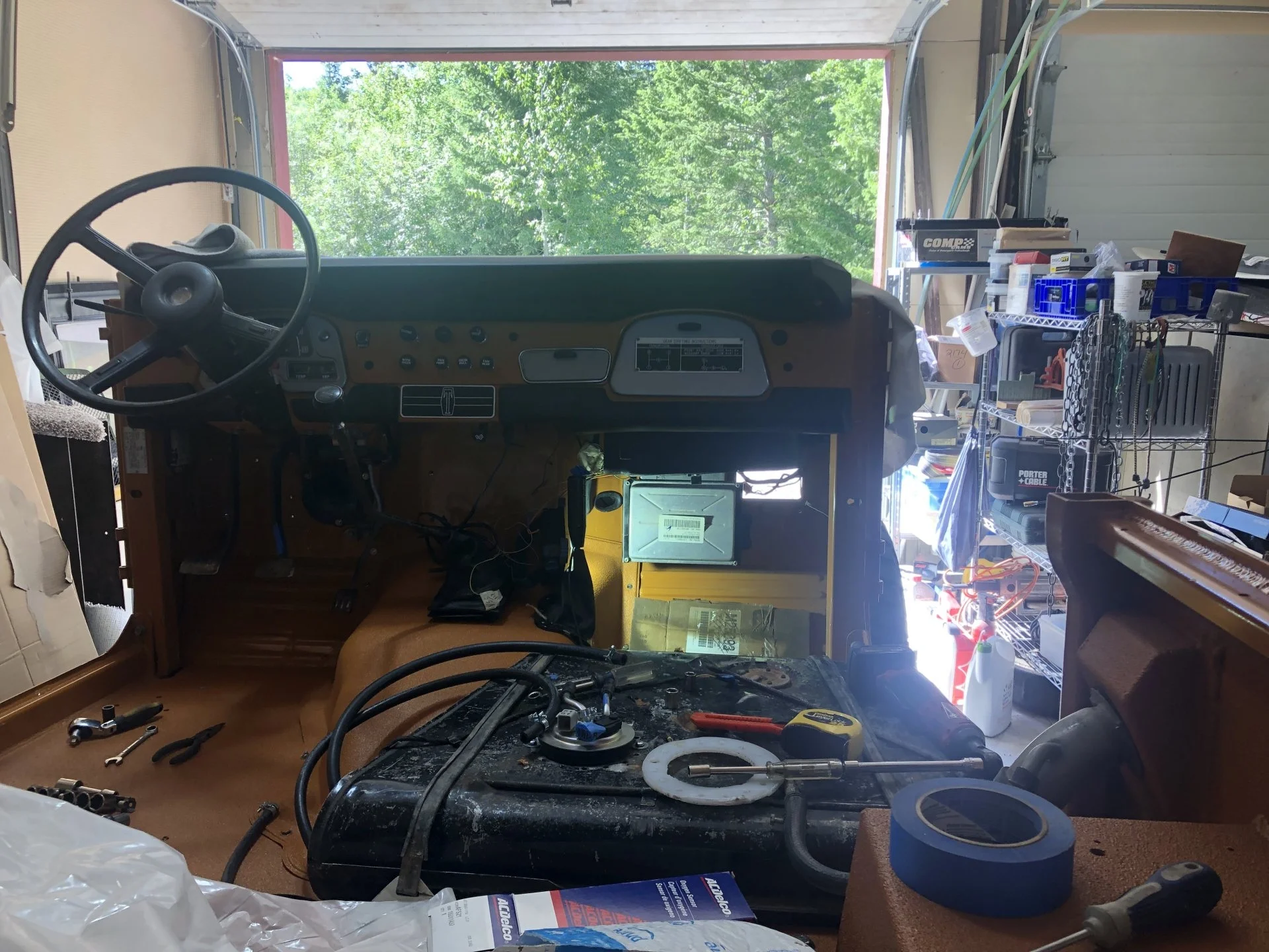

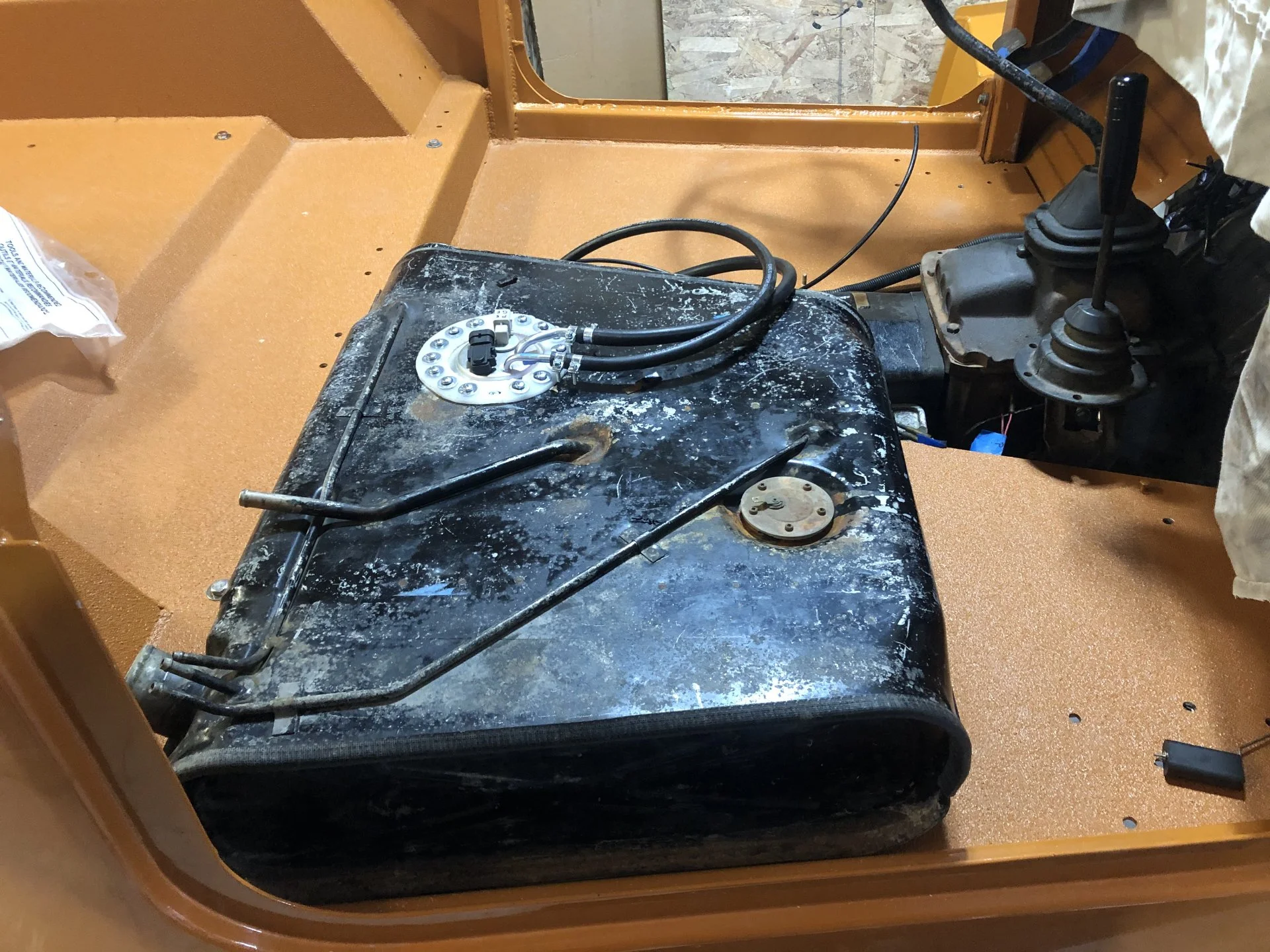

Another partial milestone and this one has been a longtime in the making- the fuel delivery system. To recap -
  • Stock 73 tank( mercifully without pin holes, yet, clogged out put tube) triple acid rinsed and modified for:
  • 03 Tahoe pump per @reddingcruiser suggestion. It fits nicely in the stock tank and is readily available and that fits my build criteria.
  • I bought a split ring (tanks inc) for inside the tank and made my own hold down ring out of some sheet plastic I had laying around. Only downside is the threaded holes needed to be chased- I’m not fond of finishing the job for something I paid for.
  • On the upside they sold a matching gasket that is advertised for E85. I know no one likes to use the ethanol, but realistically it’ll be in ge tank more than not

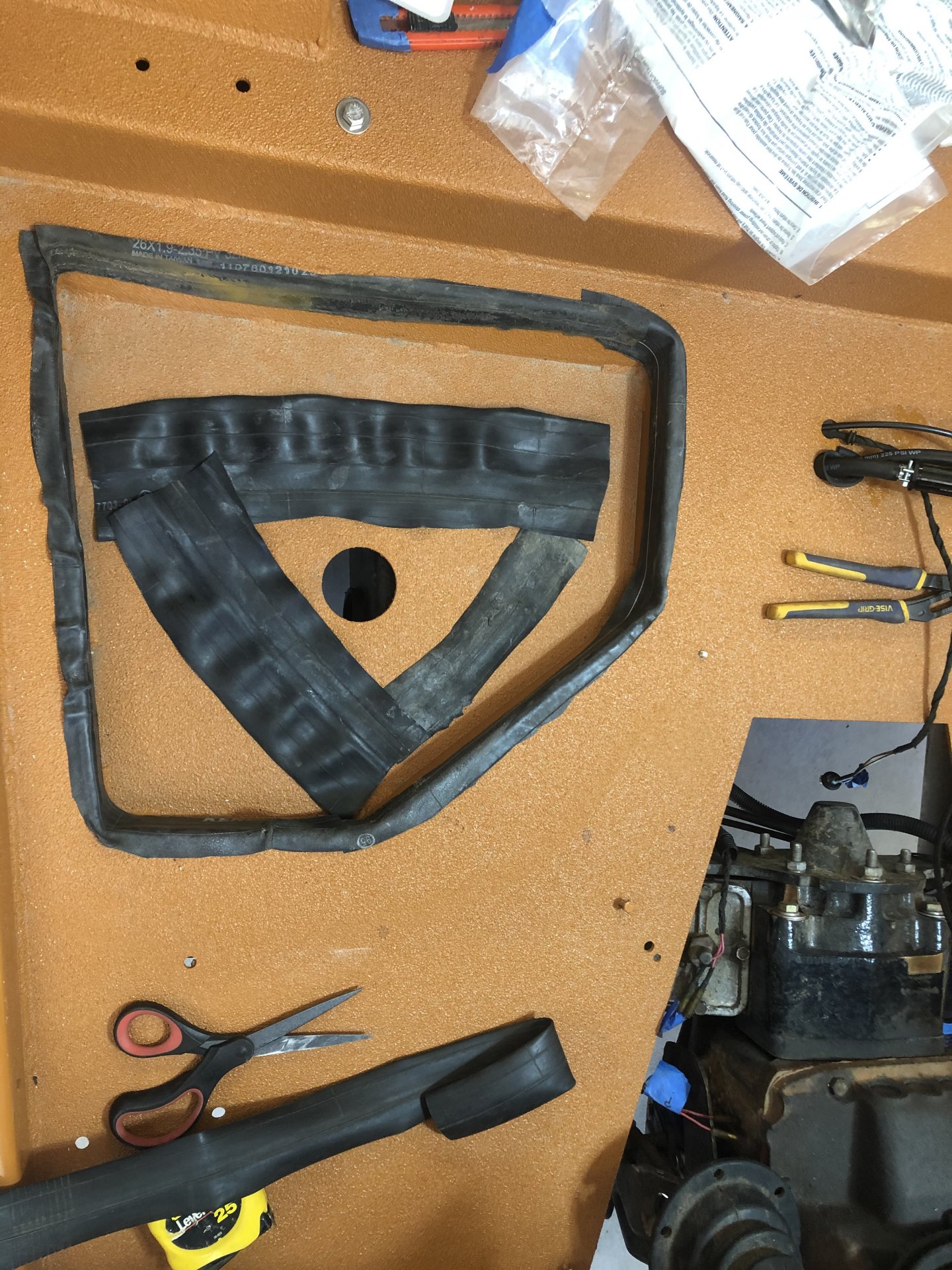

  • Recycled Mtb tubes for buffer against the rhino lined aluminum tub. This may have lowered my carbon footprint, but I doubt it.
  • Earls Vaporguard hose(20’). Supposed to be upto the ls needs and saved my ass on the AN fittings & stainless hose. Time will tell...
  • Pics:
    May not be pretty, but it should serve the job
    Kinda nice to be able to reuse the old tank

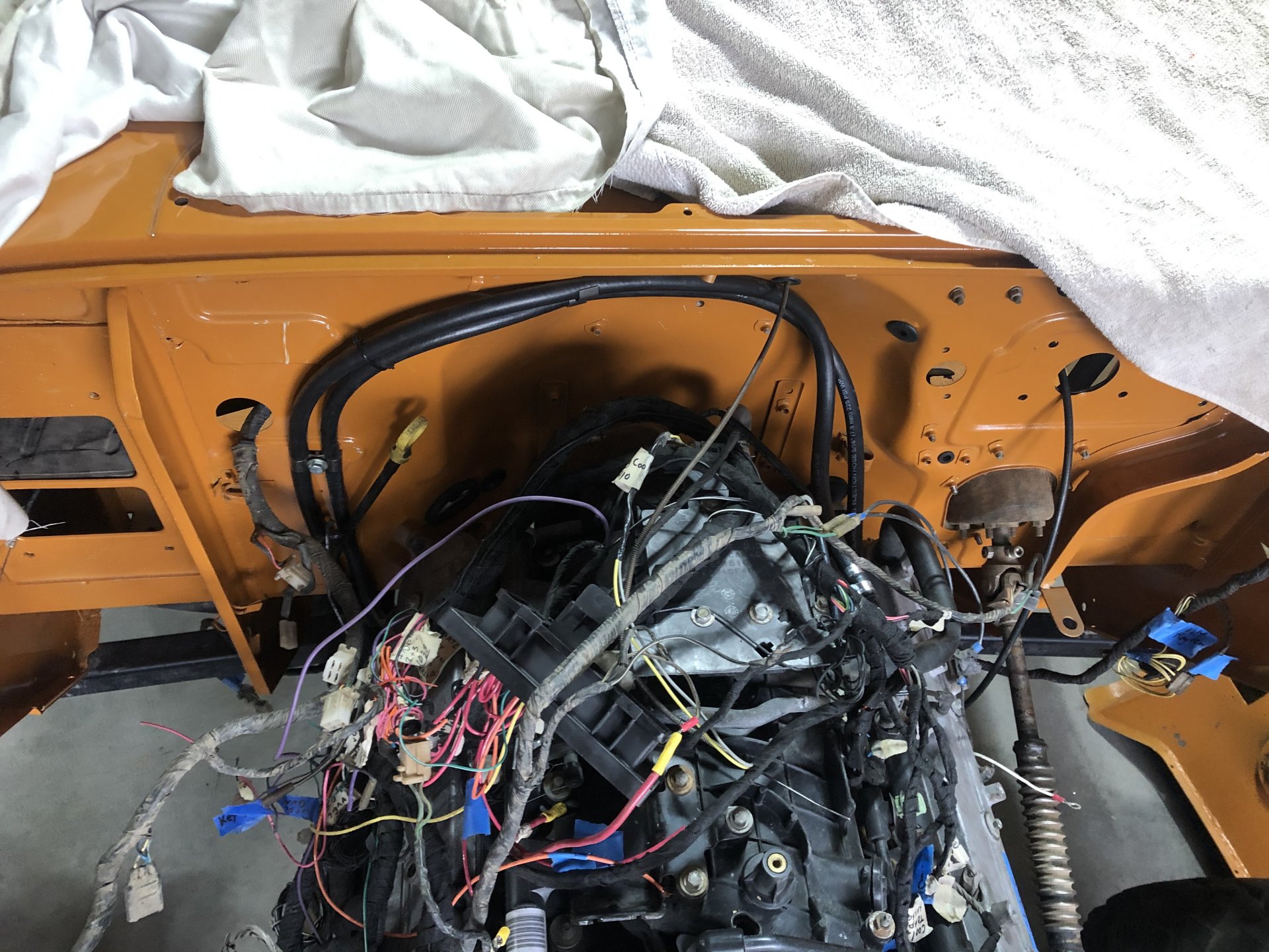

    Pay no attention to the mess of wiring- I’m still working on the layout on the engine harness and where all the plugs attach

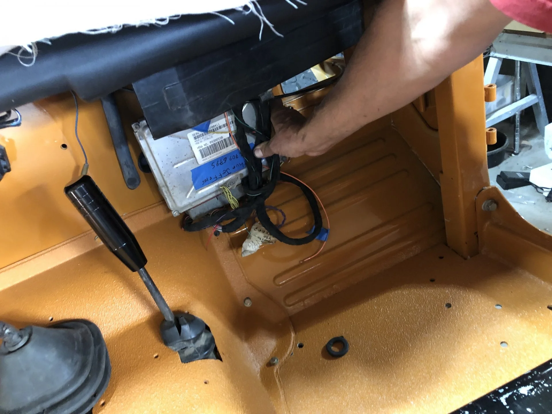

Progress continues. After the fuel plumbing was sorted, I turned back to the engine wiring harness. After trying the ecu in numerous spots in the engine compartment I decided it needed to be in the cab. Off it came again and I proceeded to feed it through firewall. The brain will mount below the glovebox and duct on the firewall. I ordered a bracket after finding the final location.

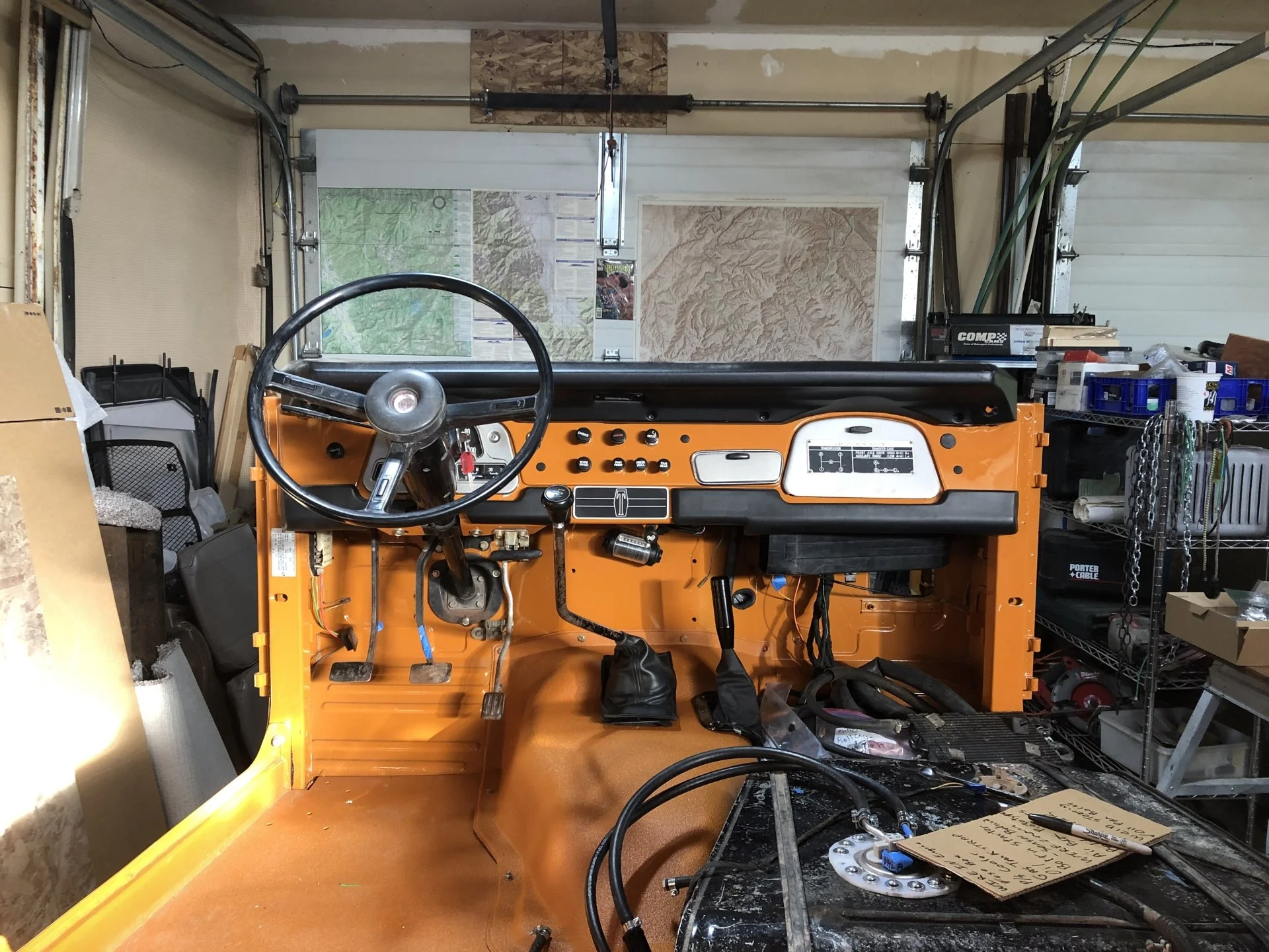

Tunnel is in and and the interior is starting to resemble something again.

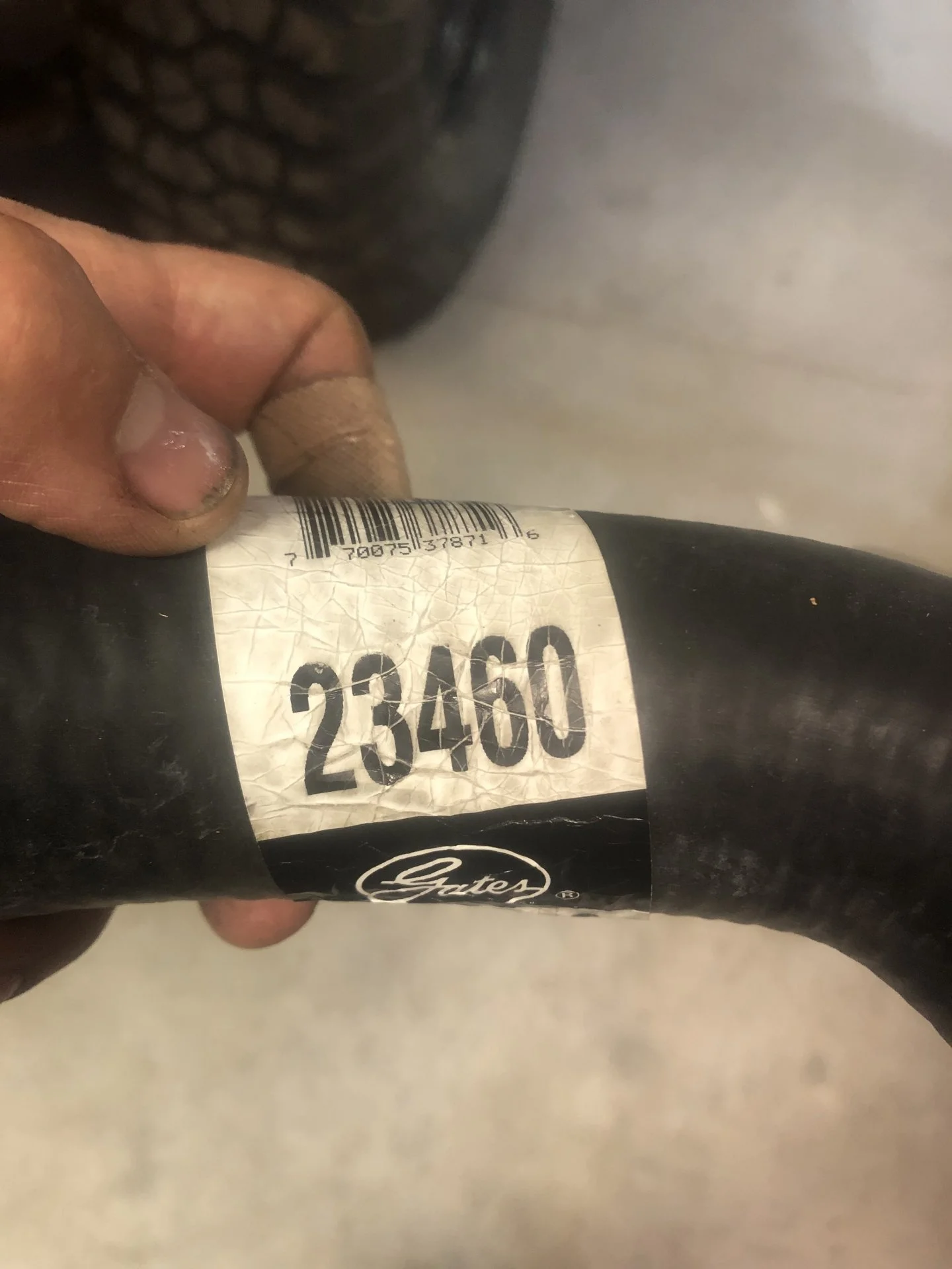

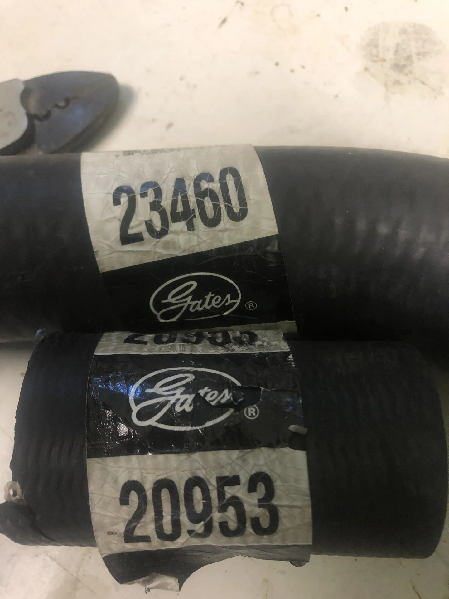

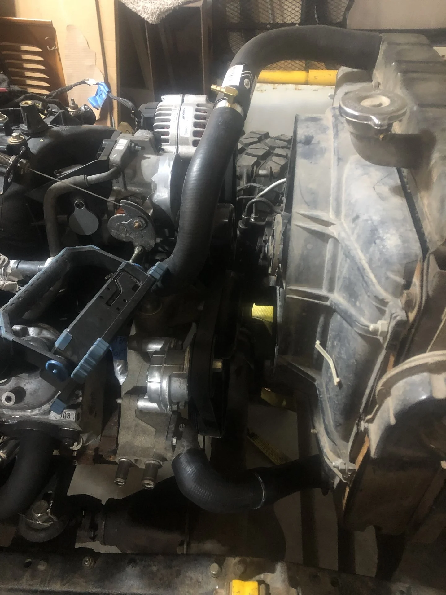

Nothing monumental, but I wanted to document the radiator hose numbers I ended up using. Just to recap for anyone doing a search- I’m connecting a stock radiator to a 5.3 lm7.
I got lucky on the upper radiator hose, I found a single hose (Gates 23460) that I had to trim the end off and add an ICT coupler with a steam port.
The lower hose took a bunch of attempts with the same hoses. I was trying to recreate a pic I had fund elsewhere on mud of an 180 off the engine to a 90 going in the radiator, but the angles never quite lined up. Ultimately, I realized I could simply 90 to 90 and my angles would be near perfect. Once again I used an ICT coupler.

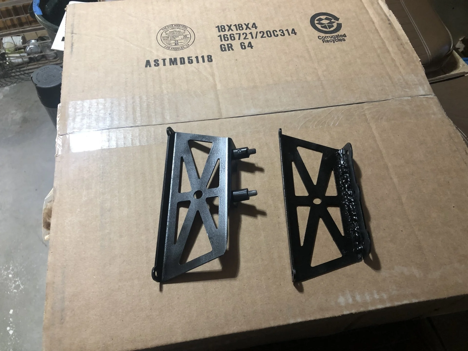

The only other item of interest is the the ECU mount. Hoping to expedite the process, I ordered a mount off glamazon. Unfortunately, it’s not quite a fit for my needs. On flange had to be cut off and welded back on facing inward. The other one needed to be trimmed to not block the intake for the heater blower. Oh well, custom builds go like that…

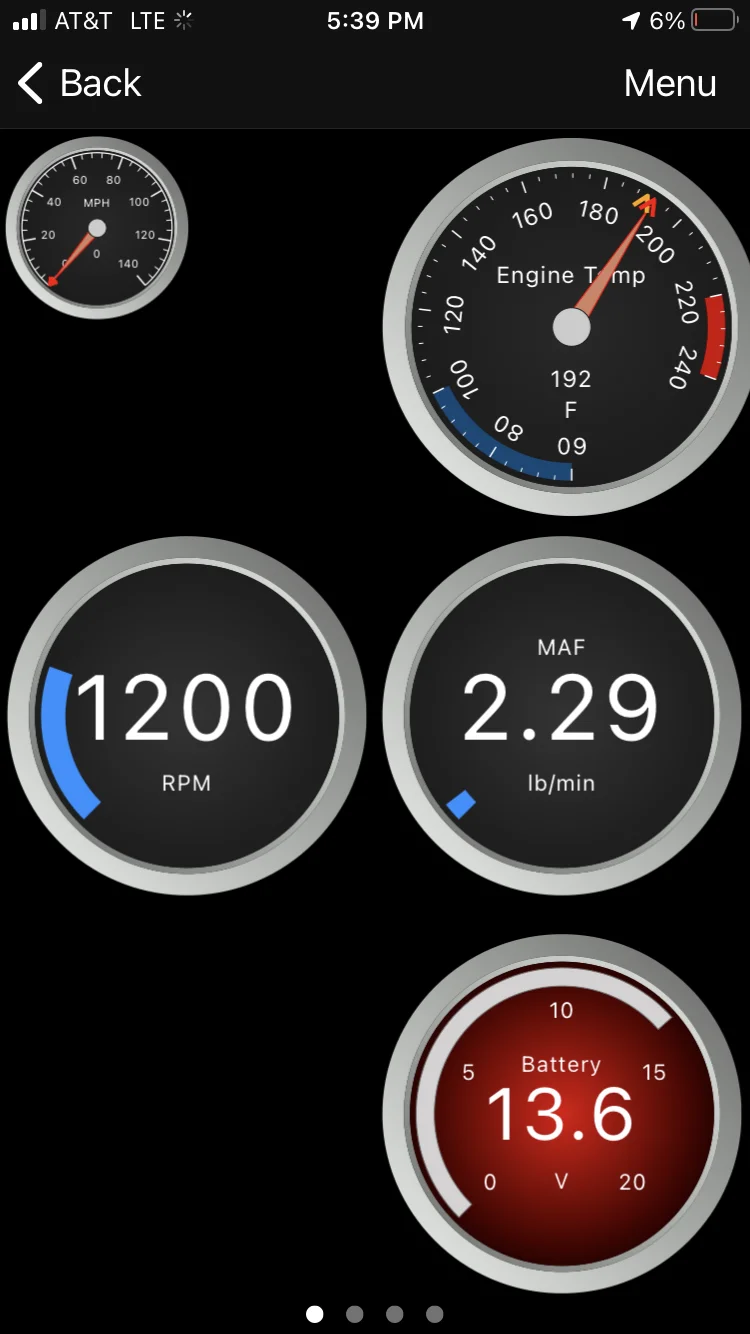

Need gauges- planning to use a obdLink to a phone

Had a little head scratching session with the OBD2 wiring. I wasn’t getting any signal in from the dongle or the scanner. Pulled it apart and redid the pins and found out my labeling on the wires isn’t the greatest. In the end I have a working port and most of the gauges I was hoping to have on the app
For those running an app to monitor gauges-is there an app that has oil pressure? I was disappointed that the OBDLink MX+ doesn’t have it. I bought the Torque app, but was Irked that they requested $69/yr to use the app. So I’m looking for other options for the oil pressure.
The app is paying off though. I rolled the dice on this engine, I didn’t have time to rebuild it, so the initial start up I was preparing myself for something terrible. I only had the word of the guy selling it and my fumbling through the wiring harness at the beginning of Covid. But the stars aligned and this is the diagnostic screen

Oil pressure on a ls motor in gm vehicles is relayed to a body control module and then to the gm gauge AFAIK. You should be able to adapt a Toyota oil sender easily into the LS motor which will run your factory gauge.
After doing some research that is my plan. I accidentally bought a adapter for putting an analog sender down by the oil filter, so I’ll do that. Just need to order another sender. I’m also looking to put a temp sender in the block for the original gauge. My dash is about the only thing that is stock and I’d like to keep it that way.

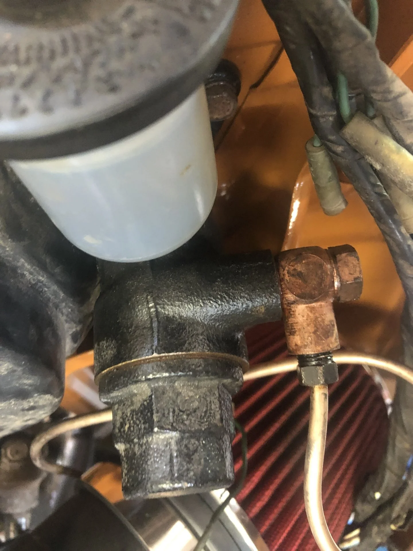

Last question of the day and it’s a quickly I think I know the answer to, but I wanted to throw it out- should there be two crush washers on this banjo fitting, on on the inside as well?
I wanted to check the group before I try torquing it anymore.

Without fenders, bib or hood and the fan on high, I haven’t gone above 190 yet. If I understand it right, these engines are good to 230. It’d be pretty awesome to not need high speed on this engine…

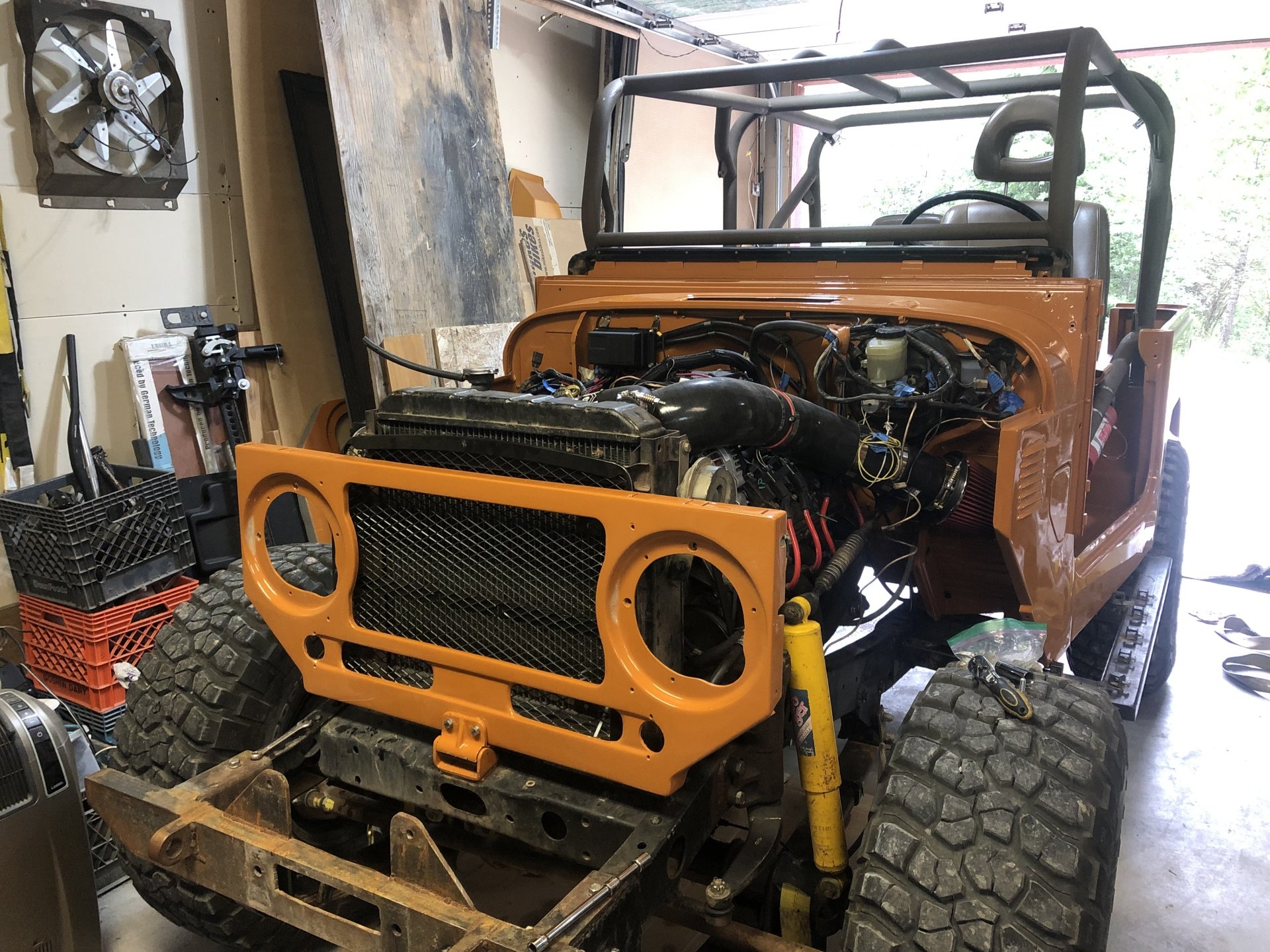

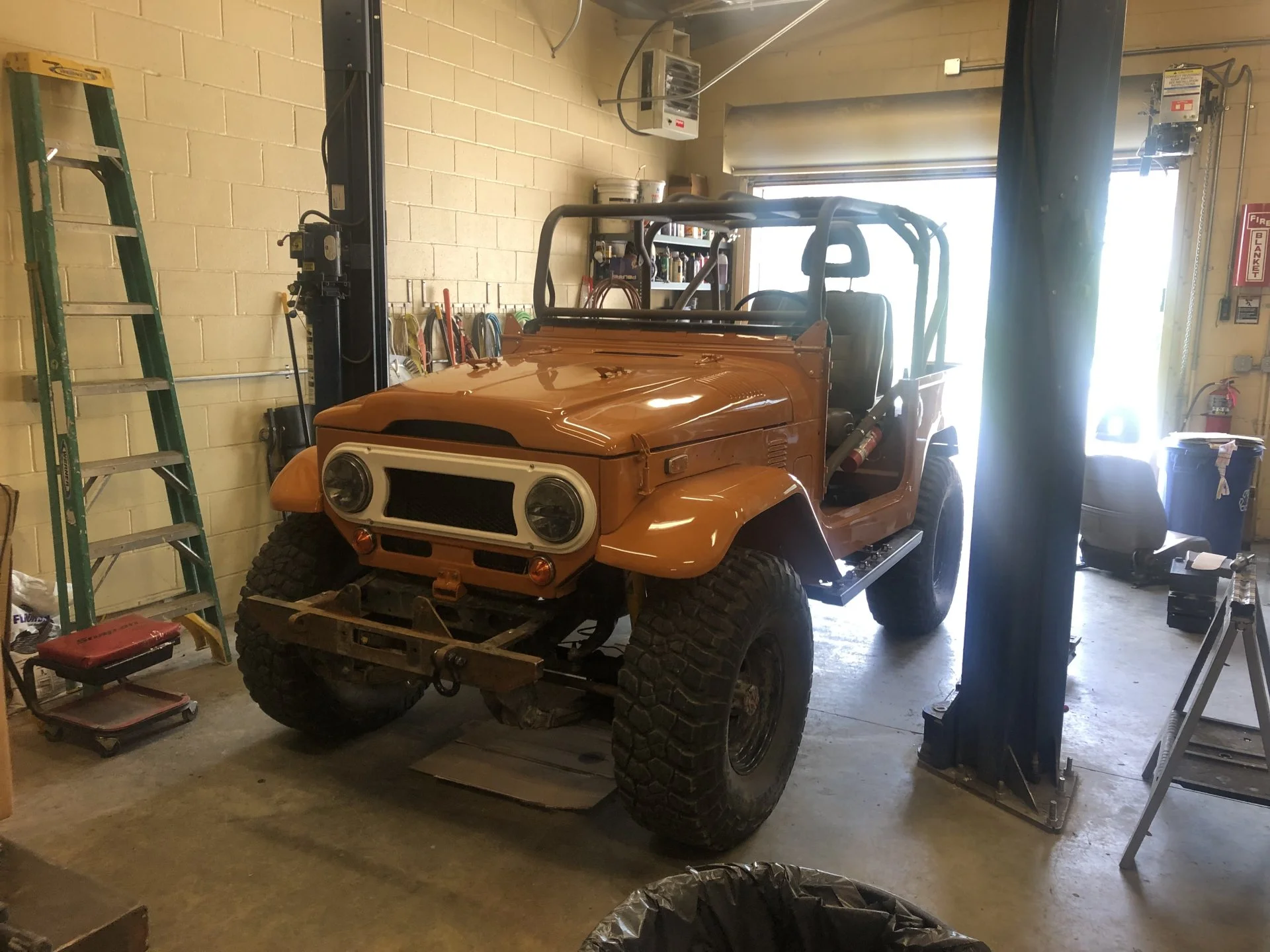

Its skin deep in a way, but this felt like a milestone.
Panel alignment is 10 footer, but it’s good to get some metal back on the front. tomorrow I’m going to take it for a test drive and see how well it cools with the front clip on. Windshield should be one tomorrow as well.
