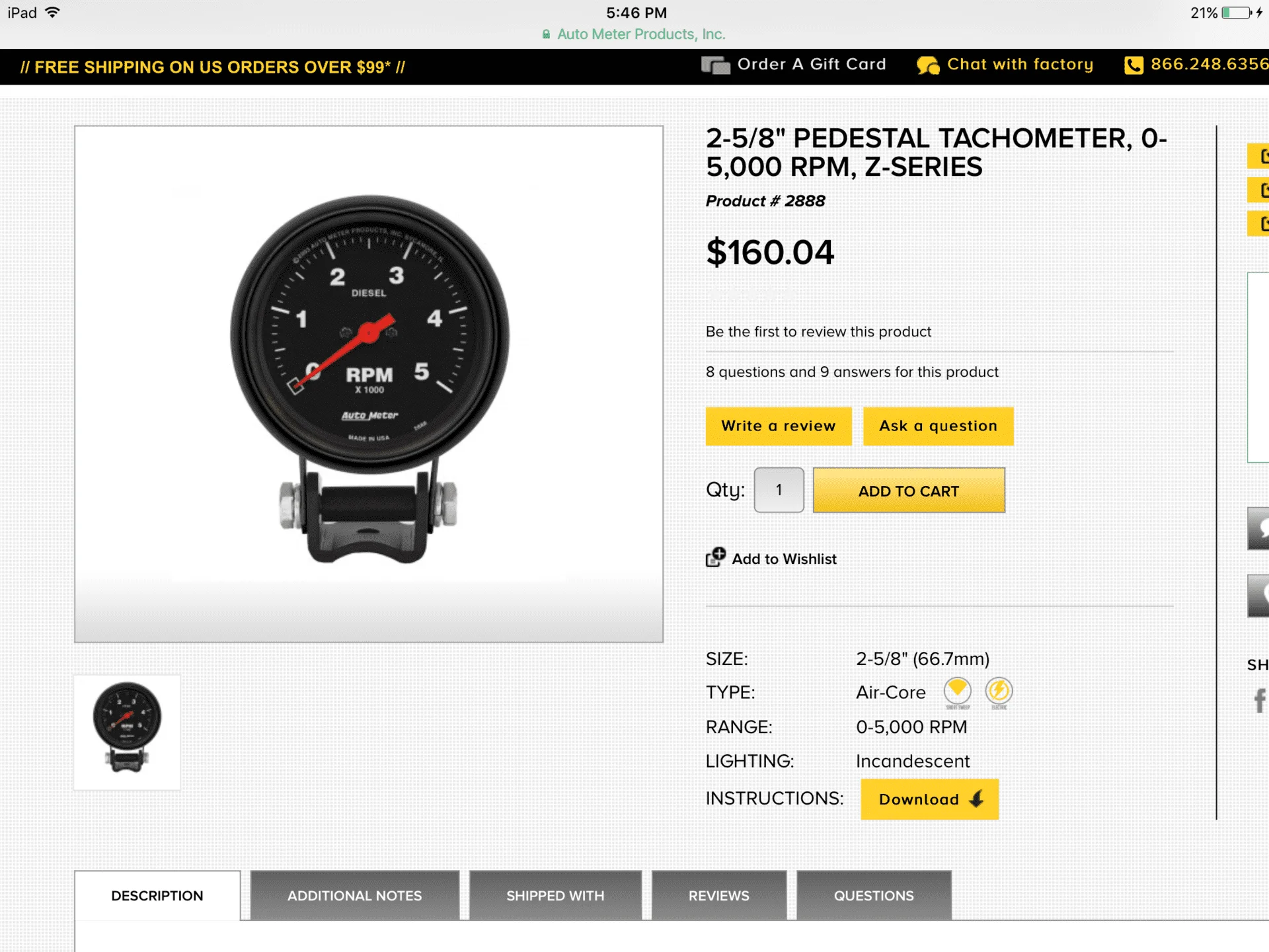

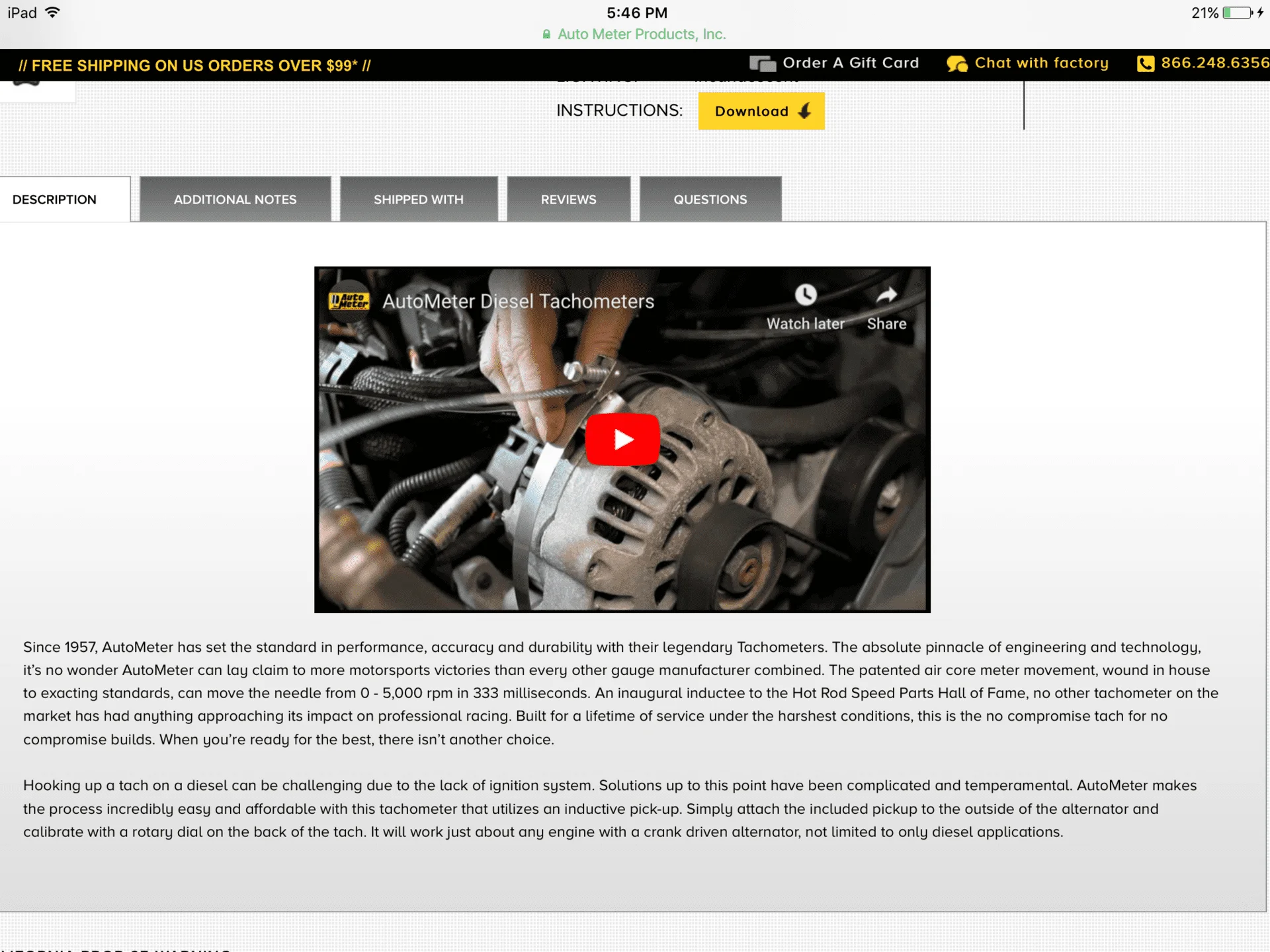

I was looking online at 5k tachs for my 2F and found this for diesels. It explains the installation process.
It's a lot more expensive than my $50 6k tach though.
That looks like a pretty easy installation! Just gotta find someone with the tool to calibrate it. Otherwise you are out another couple hundred.
AutoMeter, they have a u tube presentation. the sensor goes on the alternator and you adjust it to the engine rpm.
