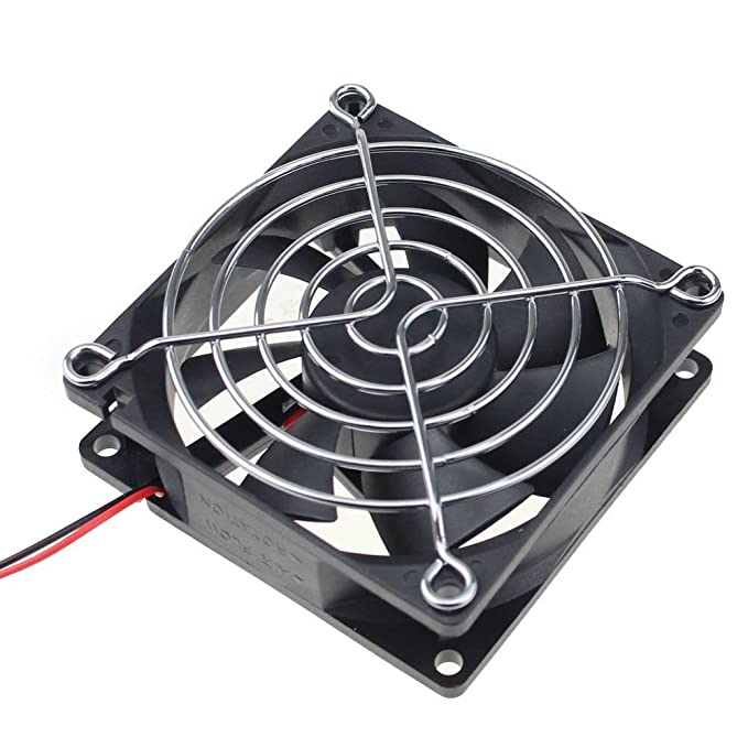

How about with a 12v computer fan and a vent on each side of the box for cross ventilation?
