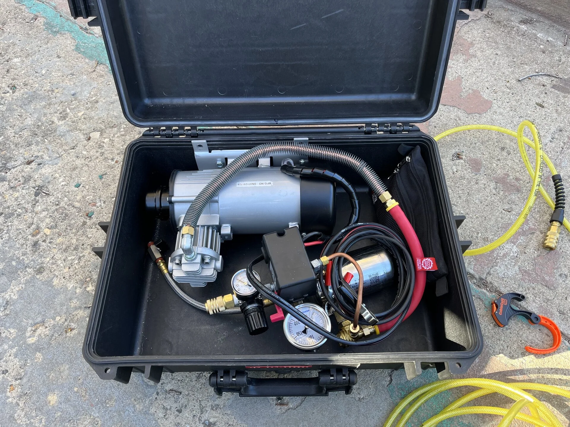

All mounted up in a protective case now, I was originally going to hard mount in the back of my cruiser but decided this would be more practical for me. Aliexpress stainless air tank and local shop had all the supplies to extend the compressor output line. Retained most of the factory pieces - unloader, etc.

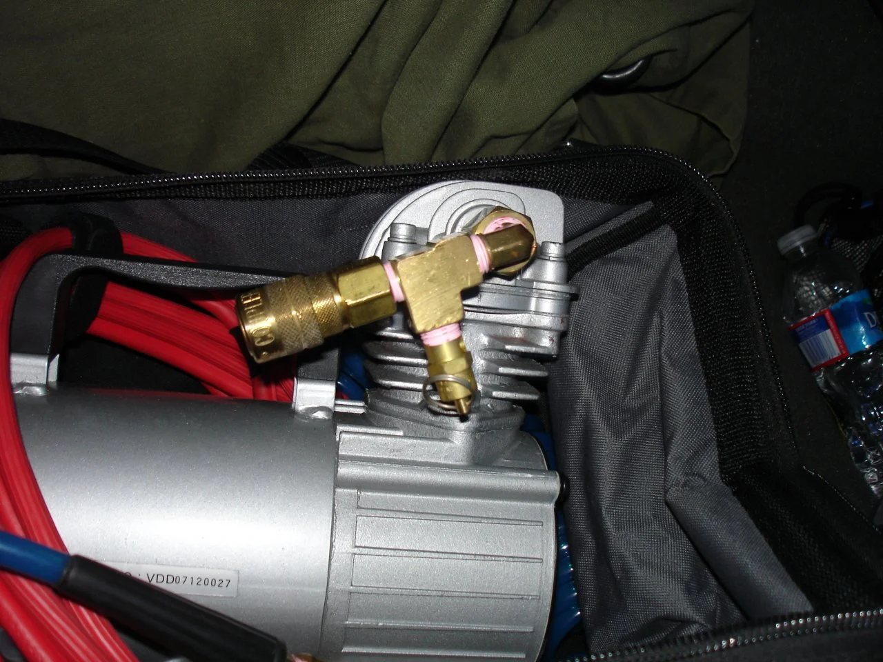

So does running the Puma like this without the unloader value harm the compressor? Too much heat near the head with out the finned copper pipe?
Do you use an open type air chuck or a closed one, i.e. flows air all of the time or only when connected to a Schrader valve? Reason that I'm asking is if the compressor can run 'free' (as opposed to against a load of some sort) on the start-up then the unloader isn't needed. If the compressor is pumping against existing pressure from it's first revolution then it may not be the longest life option.
I use an air chuck that's closed. I'll figure out how to keep the unloader and the check valve. Thanks

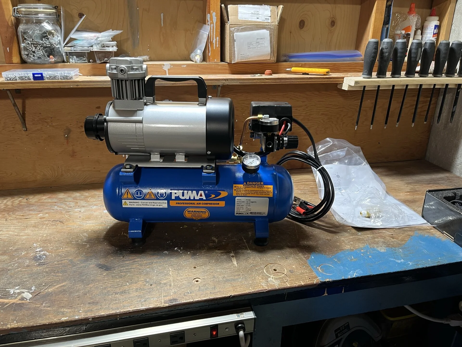

For those that are going tankless...Puma sells a tankless air compressor.
Model: DE07 $269.00
The PD1006 is $339 nowadays.

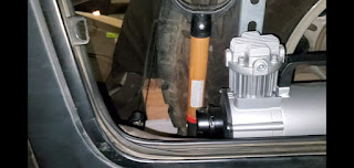

It's super close to everything, but fits. The wires need to be finalized next. But I did use it to seat the 39s on the new wheels.

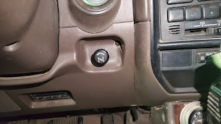

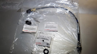

I used a stick on the throttle to get the volts up to 13.8 volts.
Its surprisingly quiet. I ordered a JDM twist throttle kit, it will be here on Monday.

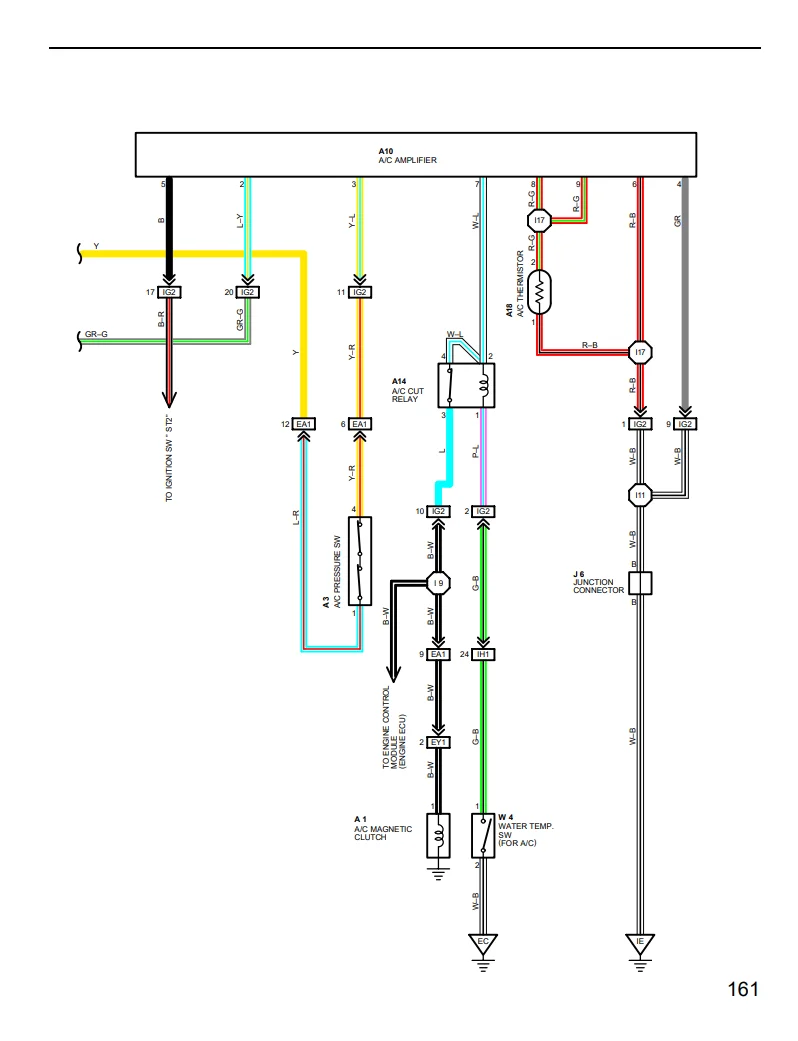

One other trick that I do is wire up a switch to the ac idle up input to the ecu, this will run the engine a couple hundred rpm higher and adds a nice little boost in voltage.
Intresting how do you do this?
"wire up a switch to the ac idle up input"
Stock Wiring
Modified, you need to insert a diode inline from the compressor clutch(B/W) and the A/C Cut Relay. This allows you to put +12v on the ECU side of the wiring which tricks the ECU into bumping the idle while not engaging the A/C clutch.
This works really well with one quirk. Some times after a couple of minutes the ECU will on occasion slowly start idling the engine down to 'non-a/c speed'. For me this occurs less that six times a year? With no ill effects. Usually by then I'm almost aired back up and filling other rigs. My next thing is to add this to the York clutch line so it automatically idle's up with either input.

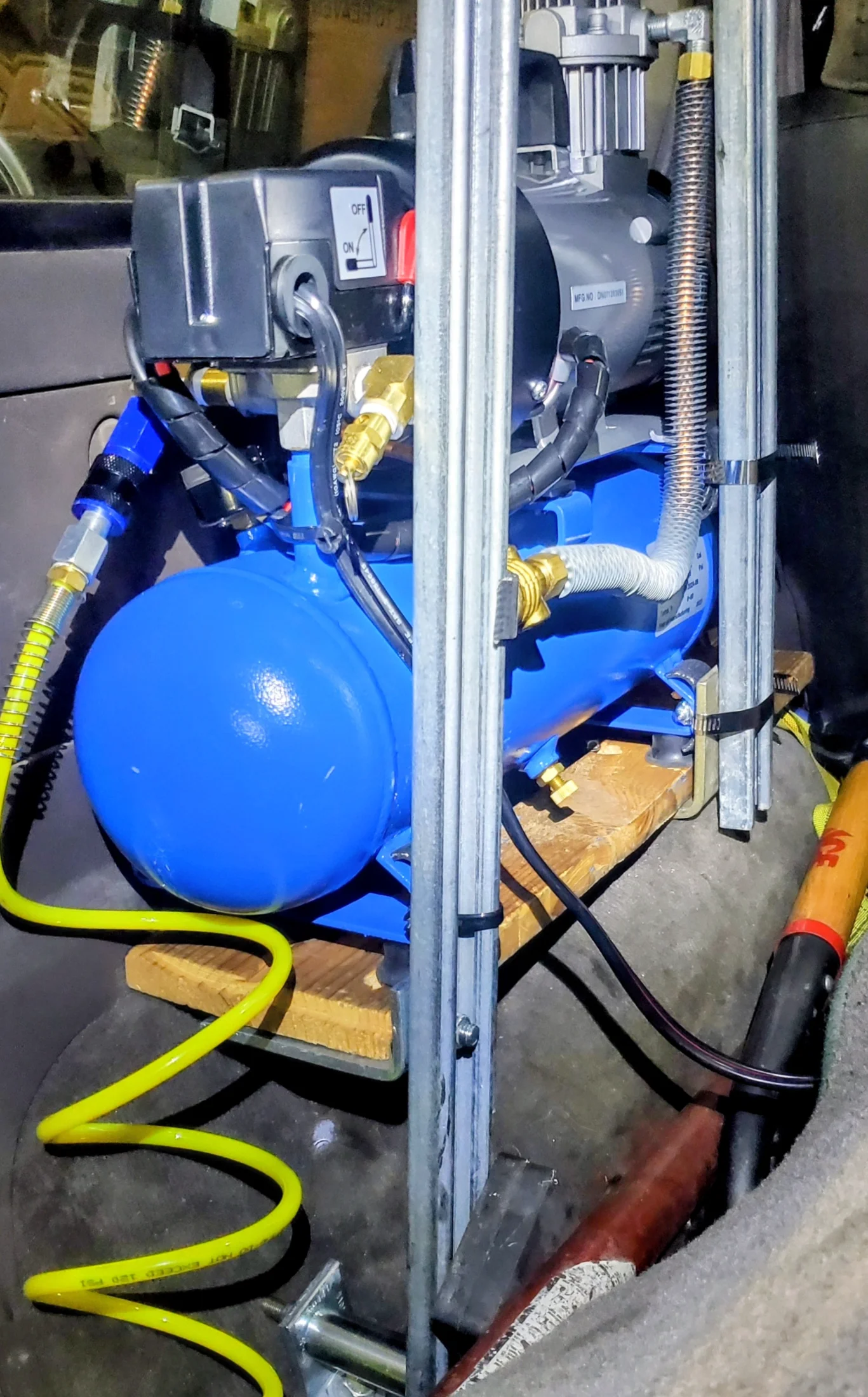

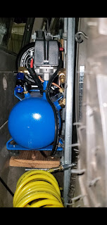

Here it is...
I ran a #4 awg to a 60A breaker then #4 awg to within a few inches near the Puma.
