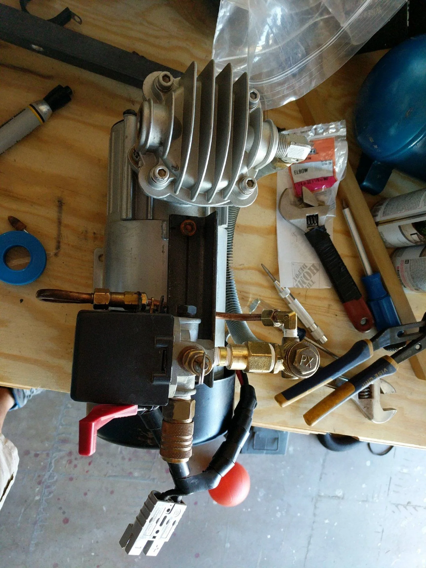

So after reading pages and pages about this compressor I installed one. I went to the store and bought a 90° elbow for the hose connector end. But when I went to put it on I was disappointed in myself for wasting that time. To orient the regulator for use with my spare next to the compressor was simple and all parts already came with the Puma. It is as simple as moving the safety relief valve to the regulator's spot and mounting the regulator straight out. Maybe I missed this same post somewhere in this thread, but it seemed like everybody was putting a lot of effort in making the 90 turn.
Thanks again LCP Phil for the quality mounts.
Edit... Here it is without the regulator.
View attachment 1670463 Thanks again LCP Phil for the quality mounts.
You are very welcome It was a pleasure meeting someone with your super dad capabilities.
Most remove the regulator mainly because it is not needed and one less part to reduce flow. The 90° mod is done mostly by the guys running the hose out the window.
