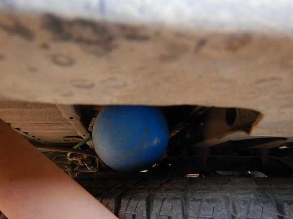

About two years of daily use. My OBA leaks down some overnight and I've not bothered to dig into it. As it powers my only horn it runs at least once a day. I like the thing, but it's a really noisy bugger when it's running. I can't imagine having it inside the vehicle. I can hear mine running driving down the street with the windows up.

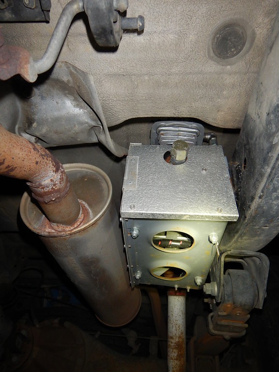

To get it all under the 4rnnr I had to split the the compressor from the tank and had no room to use their pressure switch. I had to remote mount the intake air filter to keep it out of the muck & flying debris. That is true aluminum heat shielding from a power generating plant shielding the compressor. After ~30 mins on the fwy in the summer the frame next to the compressor is hotter than the heat shield closest to the muffler. A spare Automation Direct adjustable air pressure switch and a gigavac contactor controls the compressor, along with a re-purposed ARB solenoid acting as the unloader. The large hex cap is where the intake filter is now attached to.

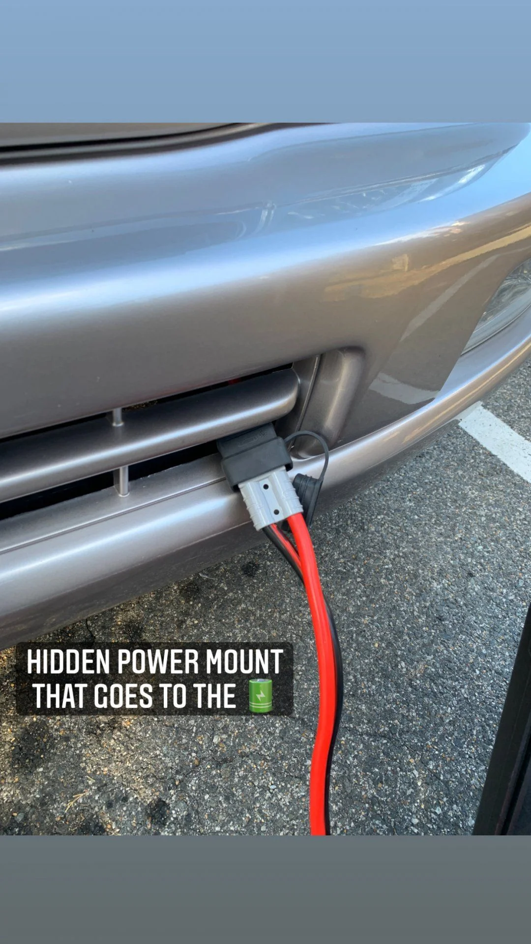

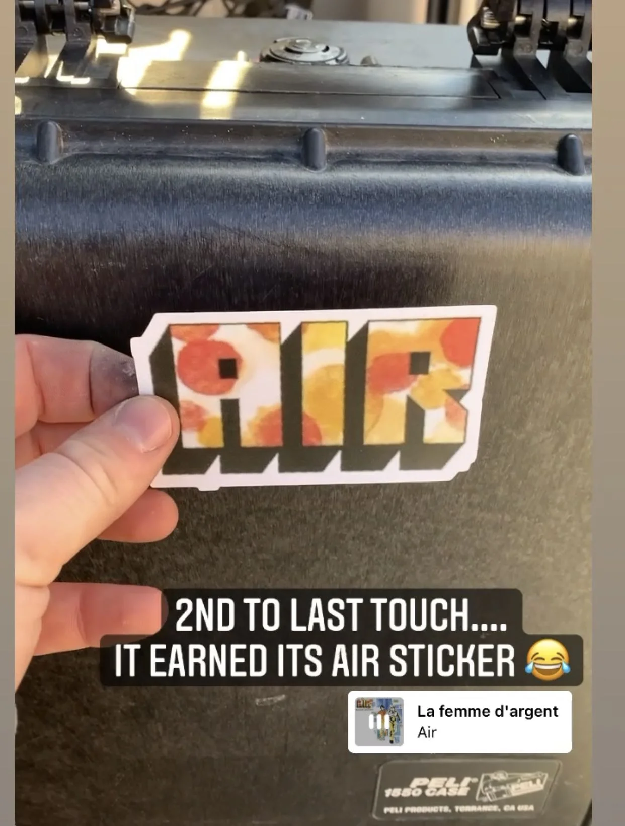

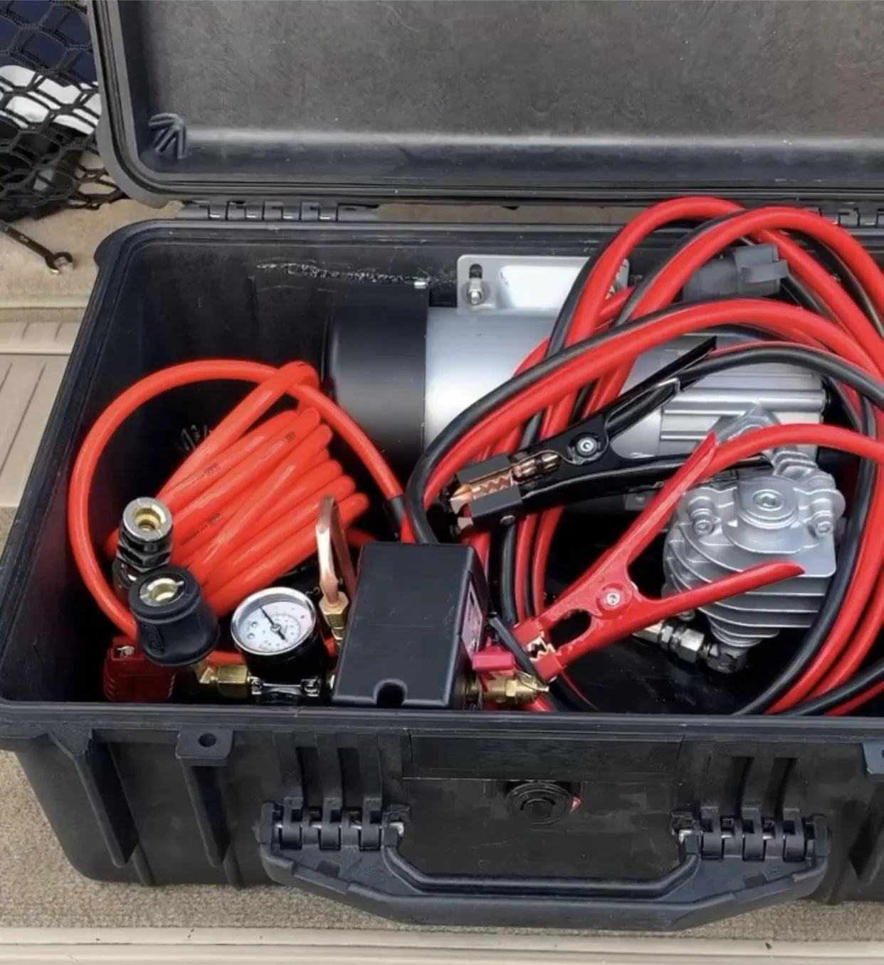

Picked up a Puma with the intent of building something like the ARB portable compressors. Goal was to be fast like the ARB twin compressor but cost the same or less than the ARB single portable compressor. I have two cruisers and wanted something quick and easy to transport all the onboard air stuff between the two trucks.
I wasn’t wed to keeping the tank if it didn’t fit in the Pelican since I’m only using it for tires. I have the tank if my plans change in the future and it was more cost effective to buy the pd1006 than just the compressor. I happened to have the Pelican laying and they’re fairly cheap used.
I have to address a small leak at the pressure switch. I messed up the original copper tubing and the cheap tubing bender I bought was crap. Last step is designing a mount for the manifold/pressure switch/regulator and having it laser cut by Send Cut Send.
Even with the leak it was still damn fast. Two 33s in under 5 mins. 15 psi to 40 psi.
Most people will think this is overkill but the alternative for me was buying the twin kit....plus I was bored 😂. The Puma as is is amazing though.
Thanks for all the tips through the thread! If anyone wants more details let me know.
