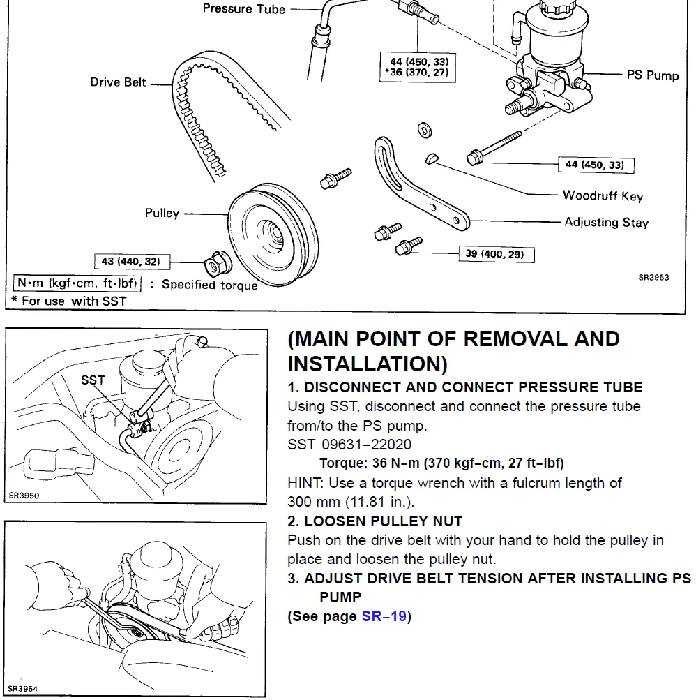

Since you have no belt, you'll need either a strap wrench to hold the pulley, or a vise. Or both. An impact wrench may do it, but I haven't personally tried.
Once you get the nut off, you may have to encourage the pulley to leave its nest with a brass hammer.
The 3FE shaft is keyed but not tapered. Unless rusted it should come of fairly easily using the method shown above.

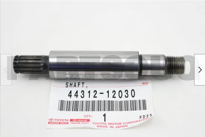

The taper must be slight. The photos of the shaft that I could find make it look straight.
Screenshot 2023-10-06 at 09-54-43 4431212030 Genuine Toyota SHAFT VANE PUMP 44312-12030 eBay.webp
I suppose it's possible that the shaft changed over the years, My old 91 was visibly tapered as was the pulley. The pulley can only go on 1 way due to the taper. At least that's the way it was on mine. Build date of 04/91.
Of course I'm old and crusty, so my memory might be playing tricks on me.
What I do remember clearly is spending about 30 minutes looking for the damn woodruff key that dropped into the engine bay.
