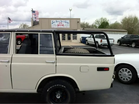

Doubt you would want to copy this design by any means but here's a sort of chopped top. My girlfriend's in Honduras on vacation and sent me this pic a few days. More impressed that she identified a pig, but here's a crude open rear chop:
