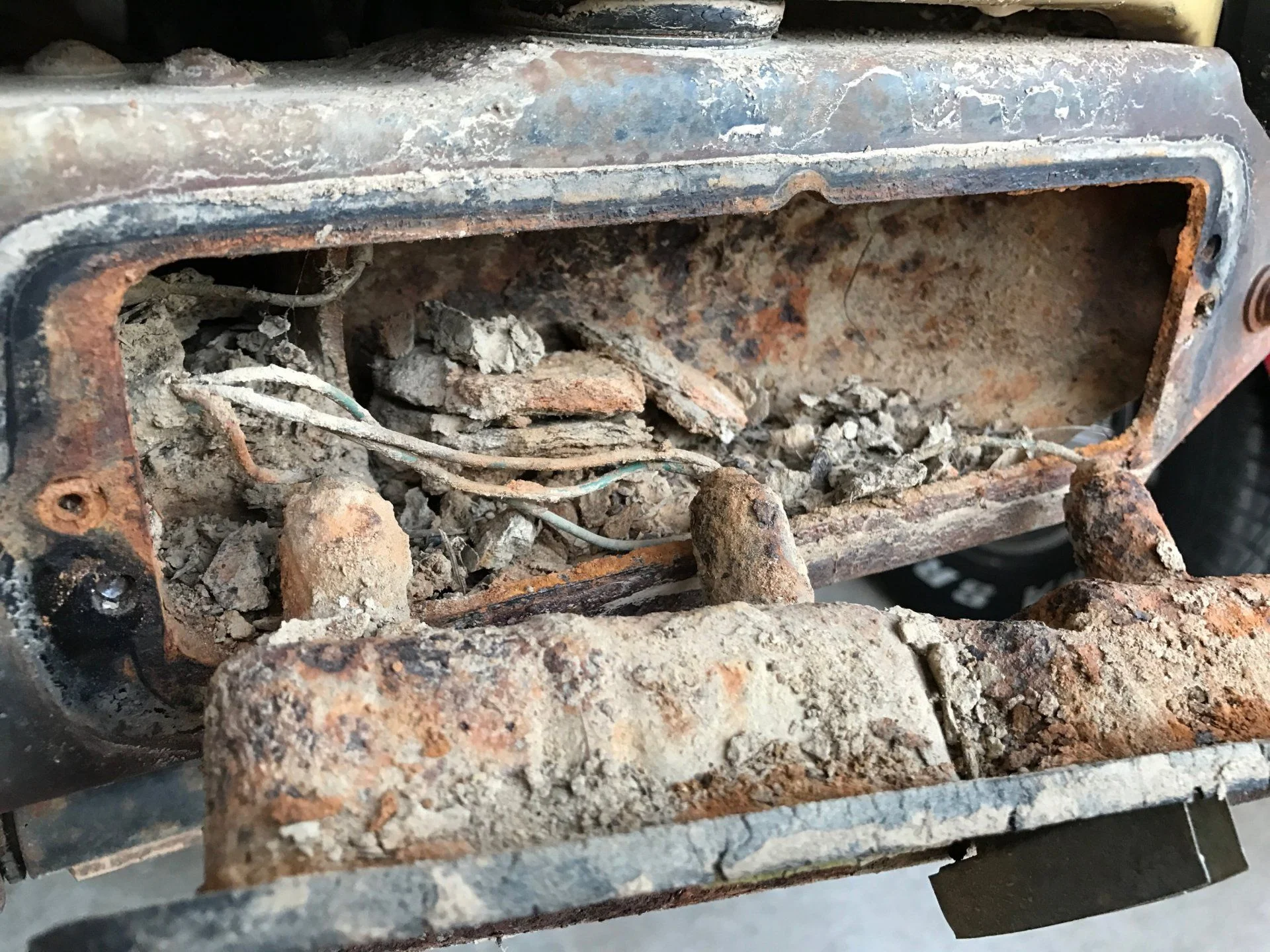

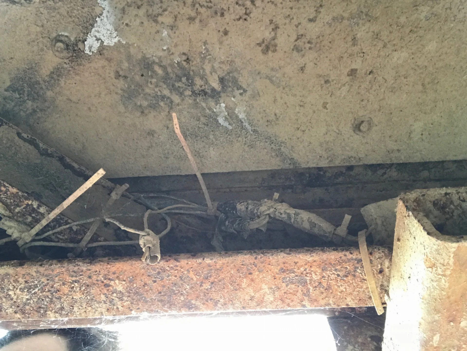

There's a total jumble of trailer wiring spliced into the rear tail lamps, completely covered in mud with loose ends everywhere. So, this is where I'm starting. I'm going to cut all of this crap and out replace the tail light housings.

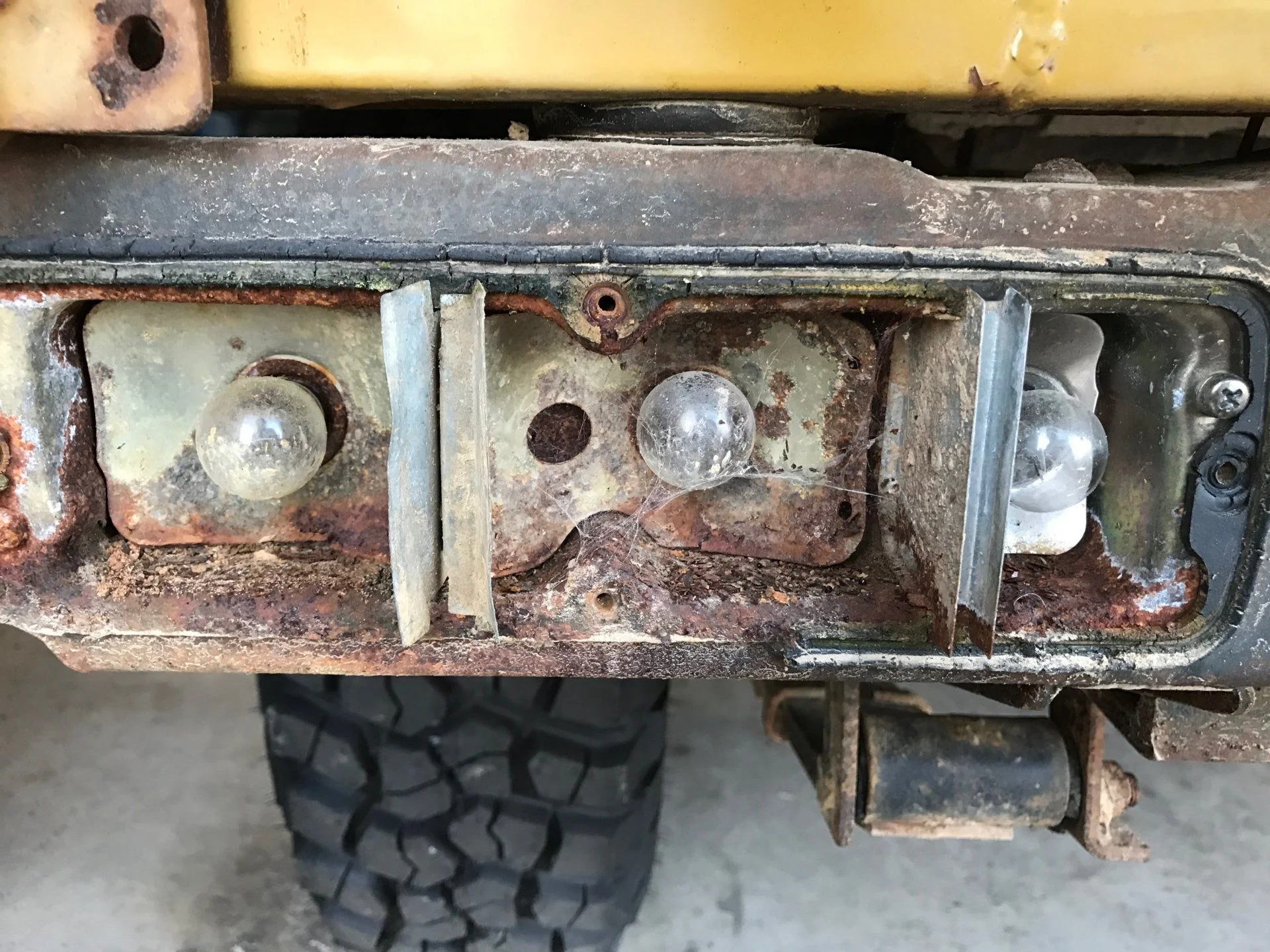

View attachment 1423750 View attachment 1423751 View attachment 1423755
Looks like mine when I pulled them. Replaced OEM on right and Cruiser Outfitters on the left.

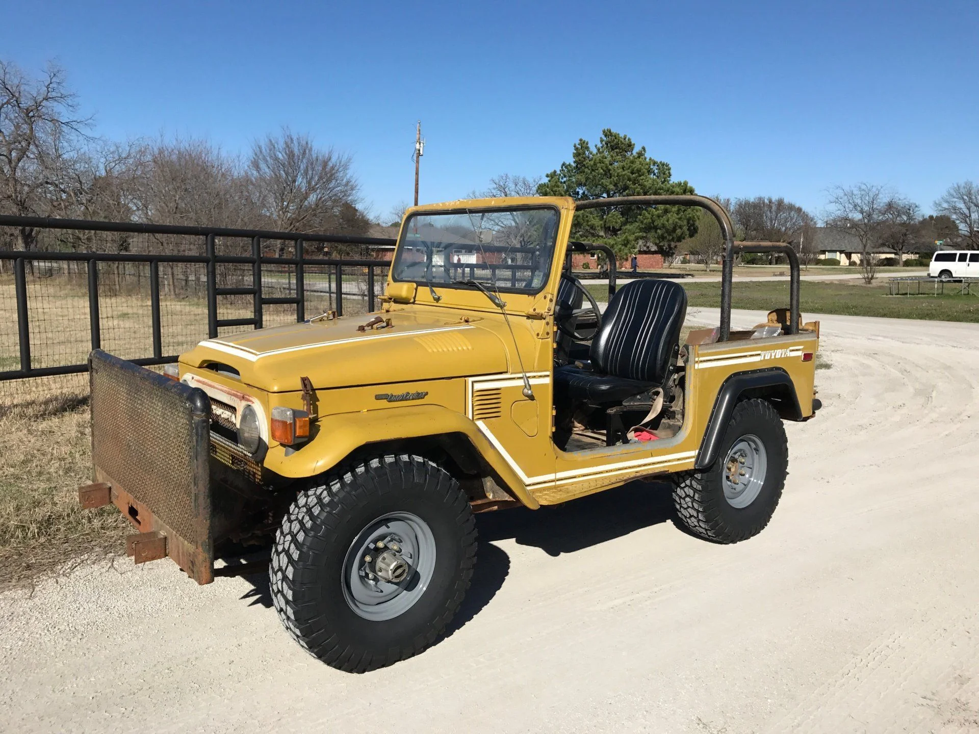

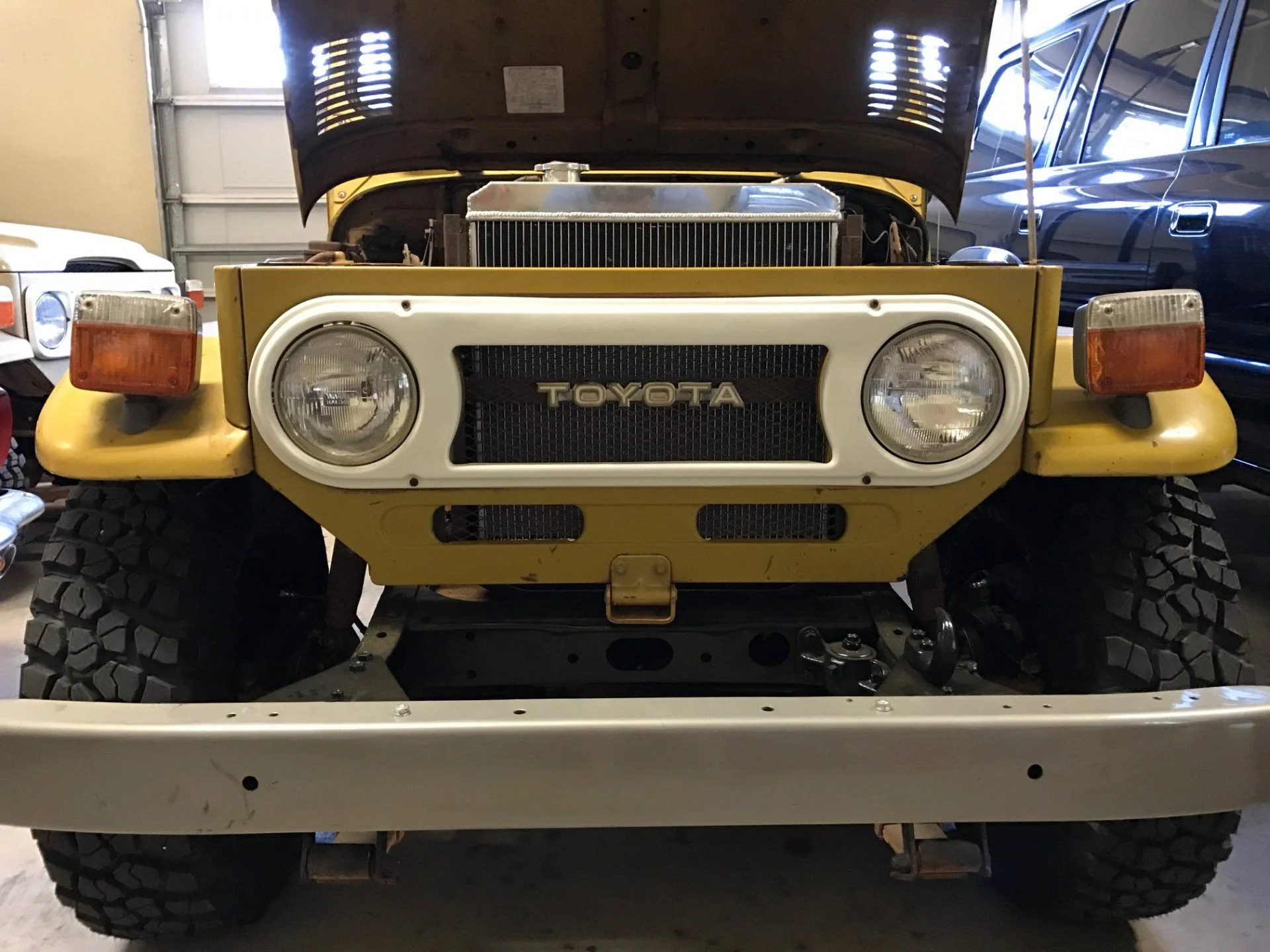

I replaced one of the crusty headlights with one out of my stash. Also decided to leave the OEM bumper on, and finished up the frame rails and factory tow hook. Scrubbed 40 years of grime off the bottom of the besel as well, dolling her up nicely. I'm getting closer to not being written up by the HOA when I taxi out into the driveway.

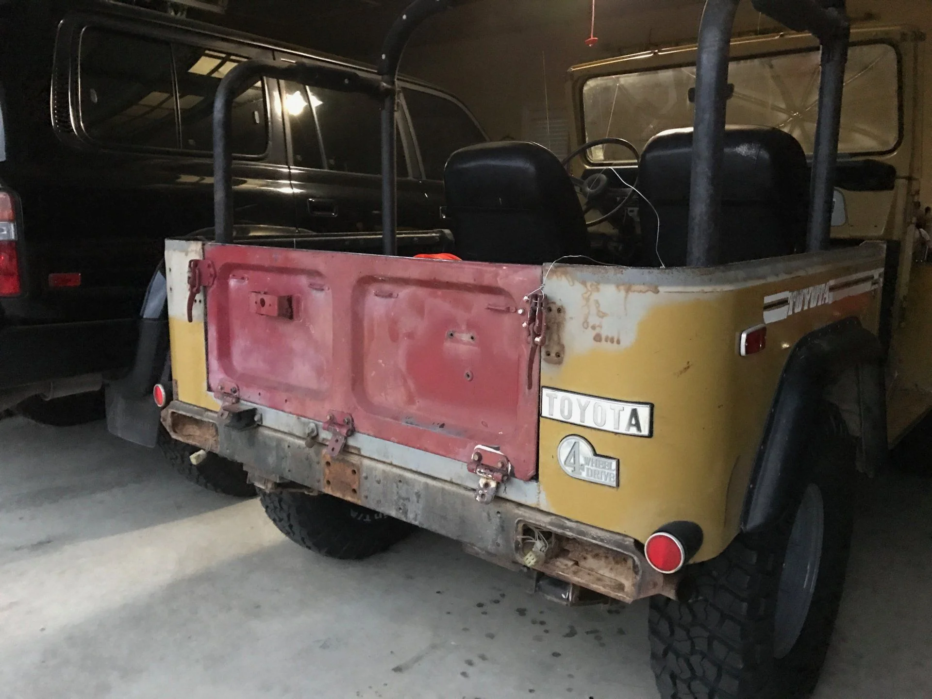

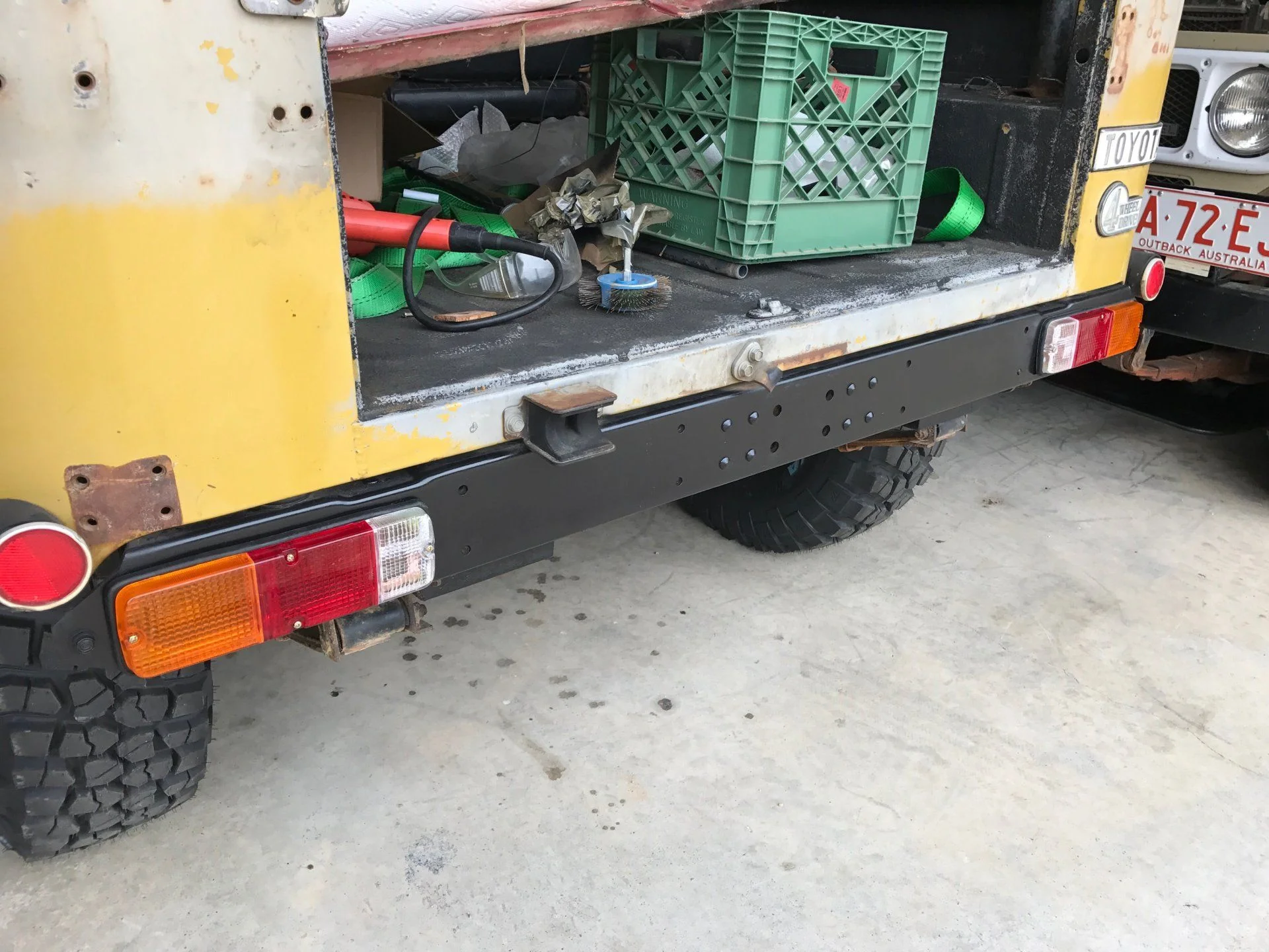

I have spent a little bit of time on the rear of the 40 this week too. New tail lenses are en route, old hitch wiring cut out, the horrible 3/8" steel angle-iron hitch assembly is gone after a ton of grinding, and I scored a couple of OEM tailgate latches on eBay. Now I'm measuring and prepping to drill holes for the hinges.

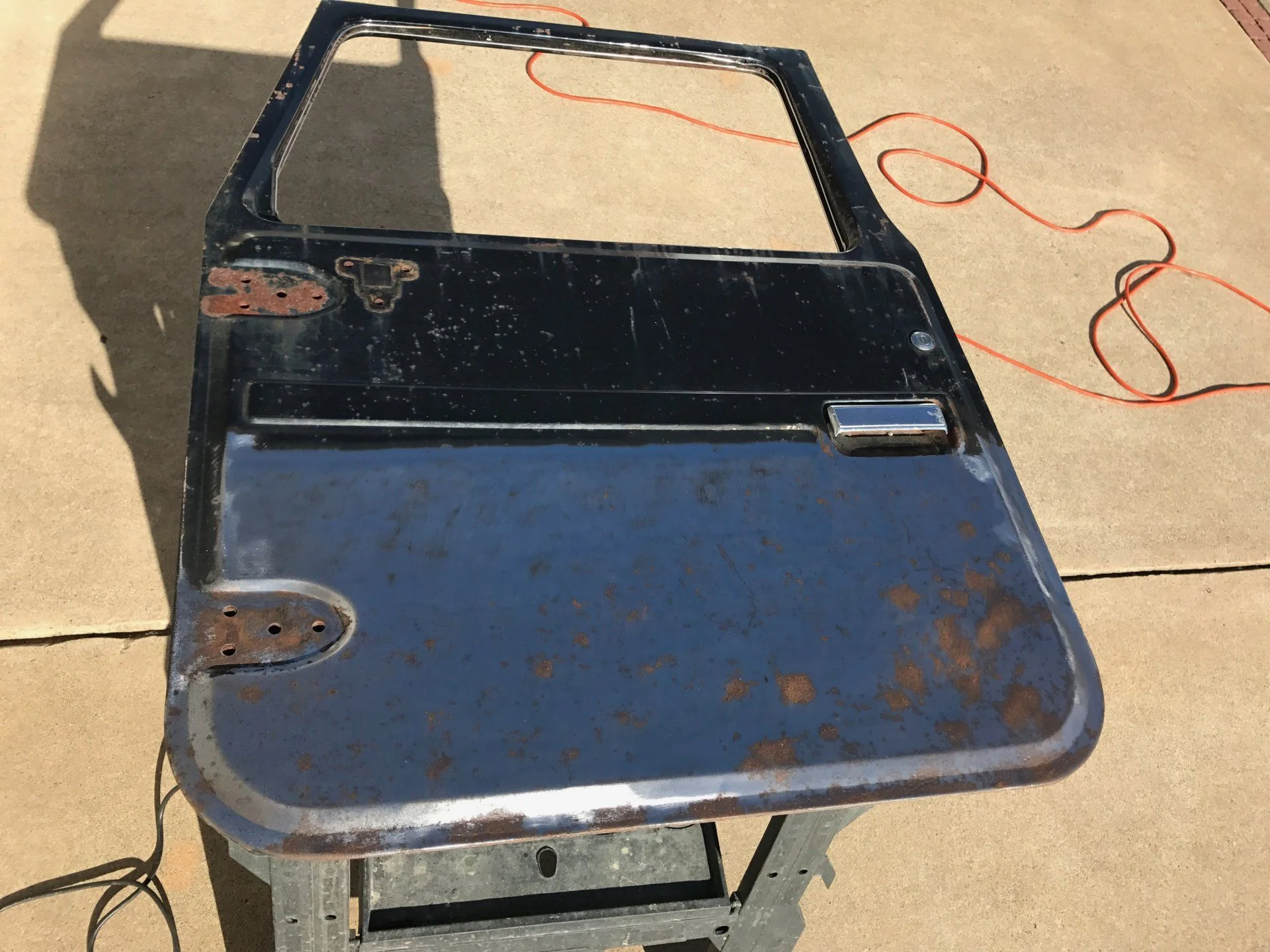

I took a piece of the hard top to English Color & Supply in Dallas to have them match Toyota 532 and tint it as needed to catch the exact color as it has faded over time. I'll be spraying the rear of the 40, the tailgate, and both side doors. So, I have started to clean up the surface rust on the hard doors and bring them to bare metal. The old steel from the door set I picked up is actually in quite nice condition. It wasn't sure what I'd find underneath the non-OEM black paint.

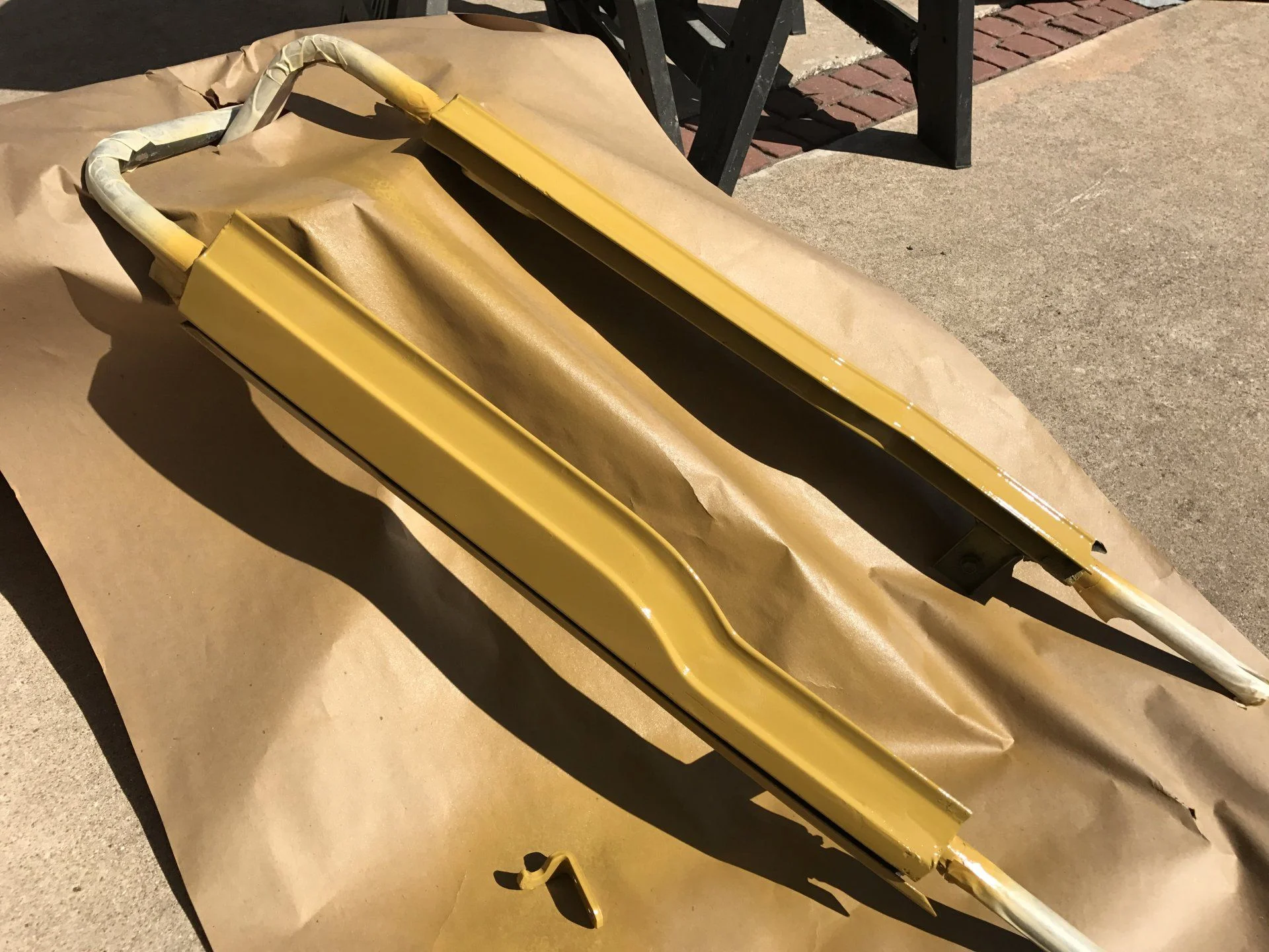

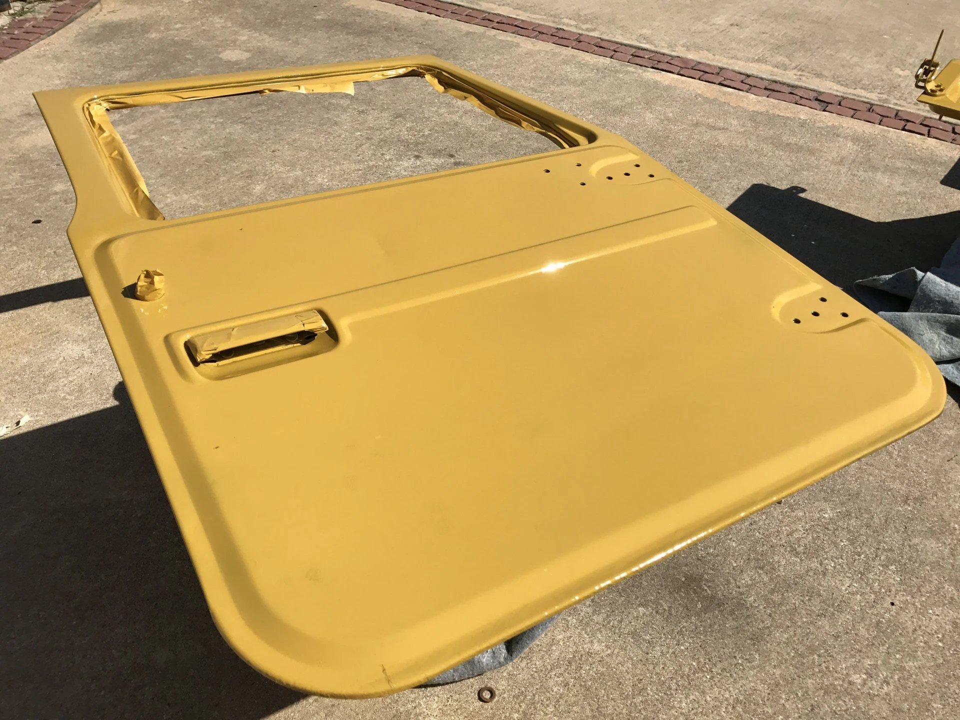

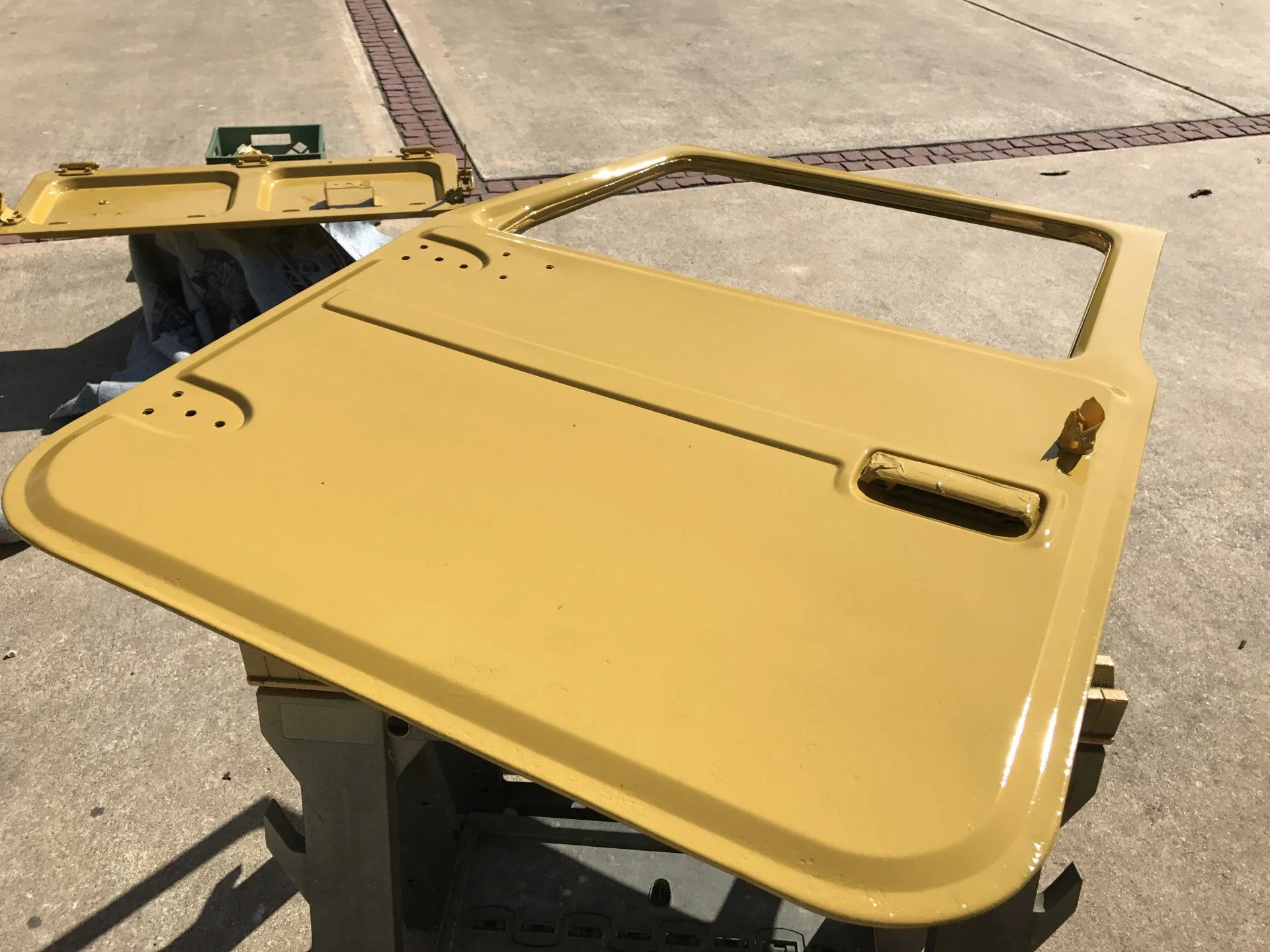

My paint supplier did a great job mixing a match to the original mustard 532 paint. I nearly forgot to spray the pillar for the soft top bows behind the doors. The hard doors and tailgate are done as well. Coming along.

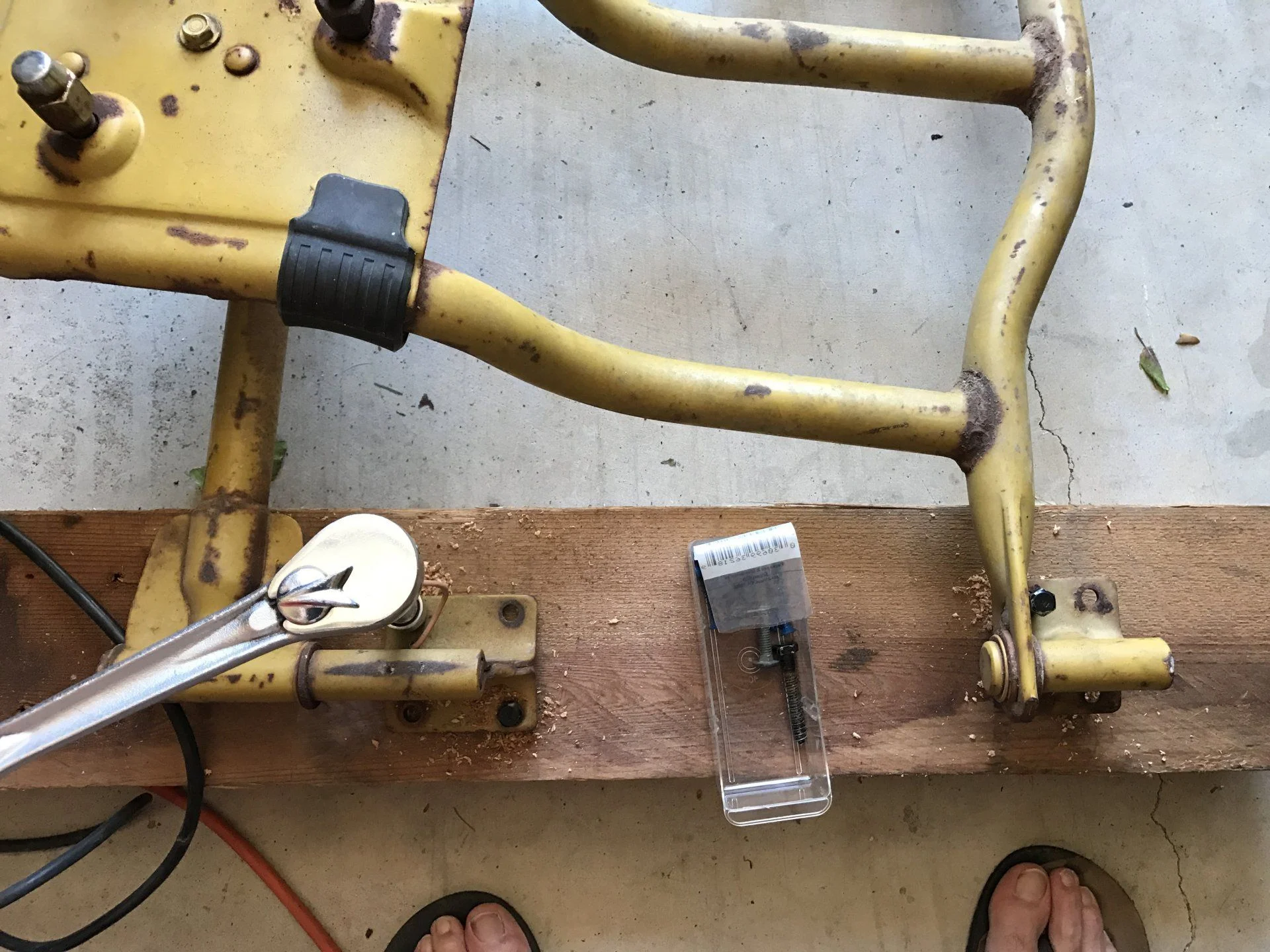

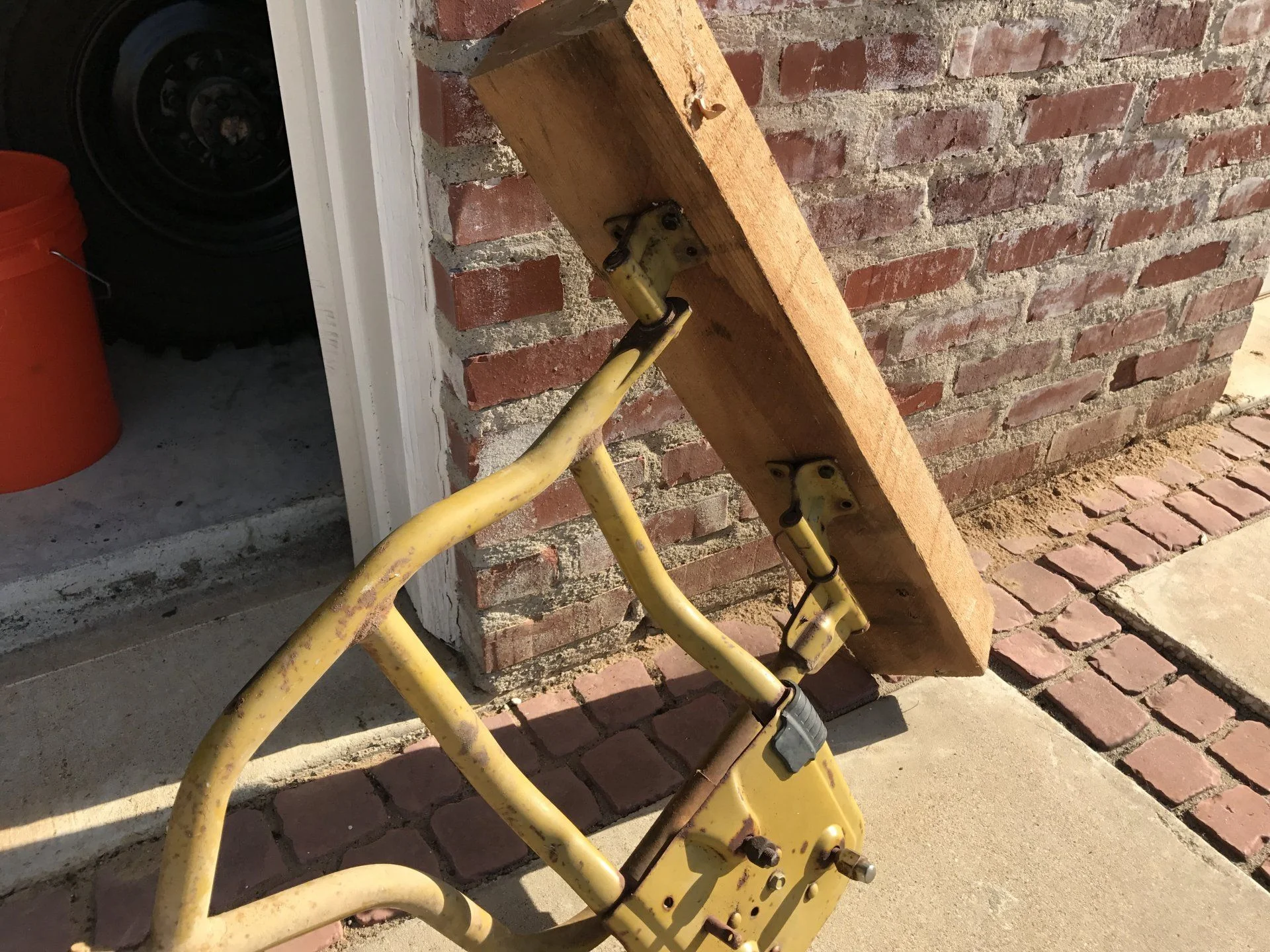

Tire carrier next. This is my old trick to softening up stuck hinges. Bolt it to a large piece of lumber (4x6 in this case), douse in oil, and work it back and forth until it has the looseness that you want.

Drove Pikachu about 5 miles. Went better than I could've hoped. She's coming together for sure.
Love the stuffed look with the 33's and stock suspension / steelies. How badly does it rub when driving it as is?
