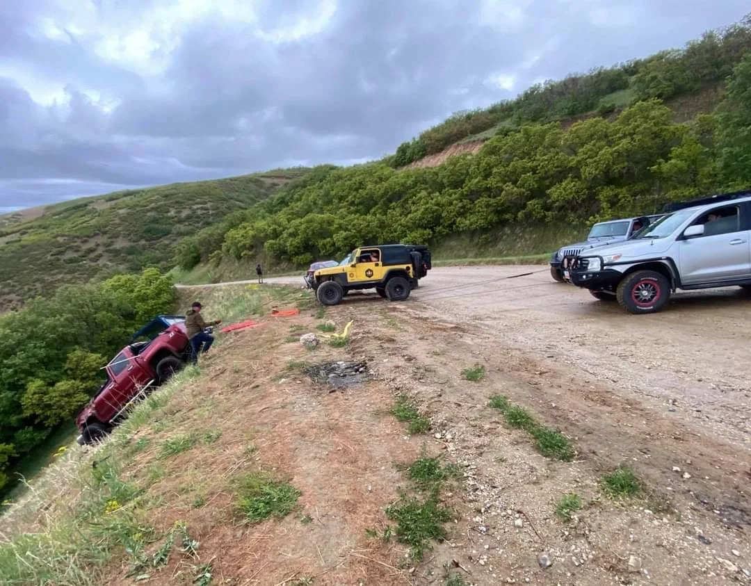

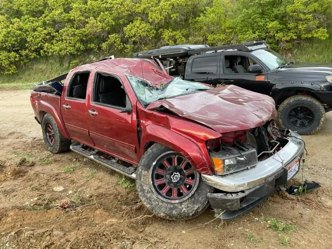

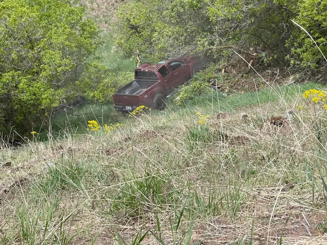

There is. I'm very active with our local non-profit 4x4 recovery team (Utah Offroad Recovery Team), basically we work with BLM, FS, State and Local LEO's and individuals to get 4x4's unstuck, out of pickles, etc. Basically we will spool up if a traditional wrecker won't take the project (they have mouths to feed, we don't want to compete with them). We do a couple recoveries a week.
This exact scenario (our 3rd roll in that exact same corner!)
"On 5/23 the team was requested to help recover this truck on the Skyline Drive Trail above Bountiful. It had rolled several times after coming off the road, fortunately unoccupied, thus no injuries. We used 4 vehicles and two double line pulls to drag it up the steep hillside and back onto the road. There it was retrieved by a commercial wrecker.
While staging for this recovery, emergency personnel arrived to the Bountiful B staging area to respond to an injury related to another vehicle that went off the road, again unoccupied. Be safe out there, in-gear & park brake firmly engaged! #uorrt #recovery #allvolunteers"

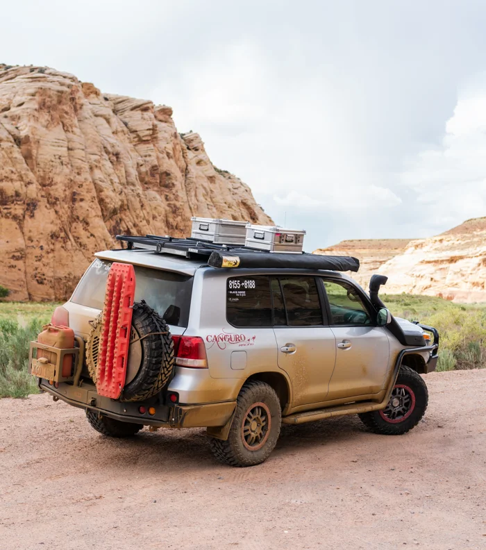

No real exciting updates, just working this 200. This machine has been on some serious trail/race pit support duty the last few years, annual trips to the Baja 1000 and other dersert races supporting Canguro Racing & Jaos in their LX600, King of the Hammers supporting Rusty Nail Racing, Mint 400 supporting @landcrusher909 and a bunch of Lexus/Toyota projects. All this and some fun personal trips too.

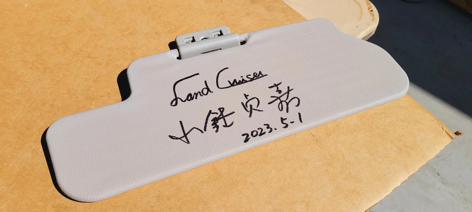

We recently hosted Chief Engineer Sadayoshi Koyari at Cruiser Outfitters along with a run down to Central Utah to show him some of our Canguro team's favorite desert spots. As Koyari-San was Toyota's Chief Engineer for the 200 Series. He was most generous with his time, signing things at the Land Cruiser Heritage Museum and here at the shop. I asked him if he would be willing to sign the sun visor from this 200 Series and he was kind enough to do so. I'll likely remove it if/when I ever sell the vehicle, but in the meantime it's a fun memory.
