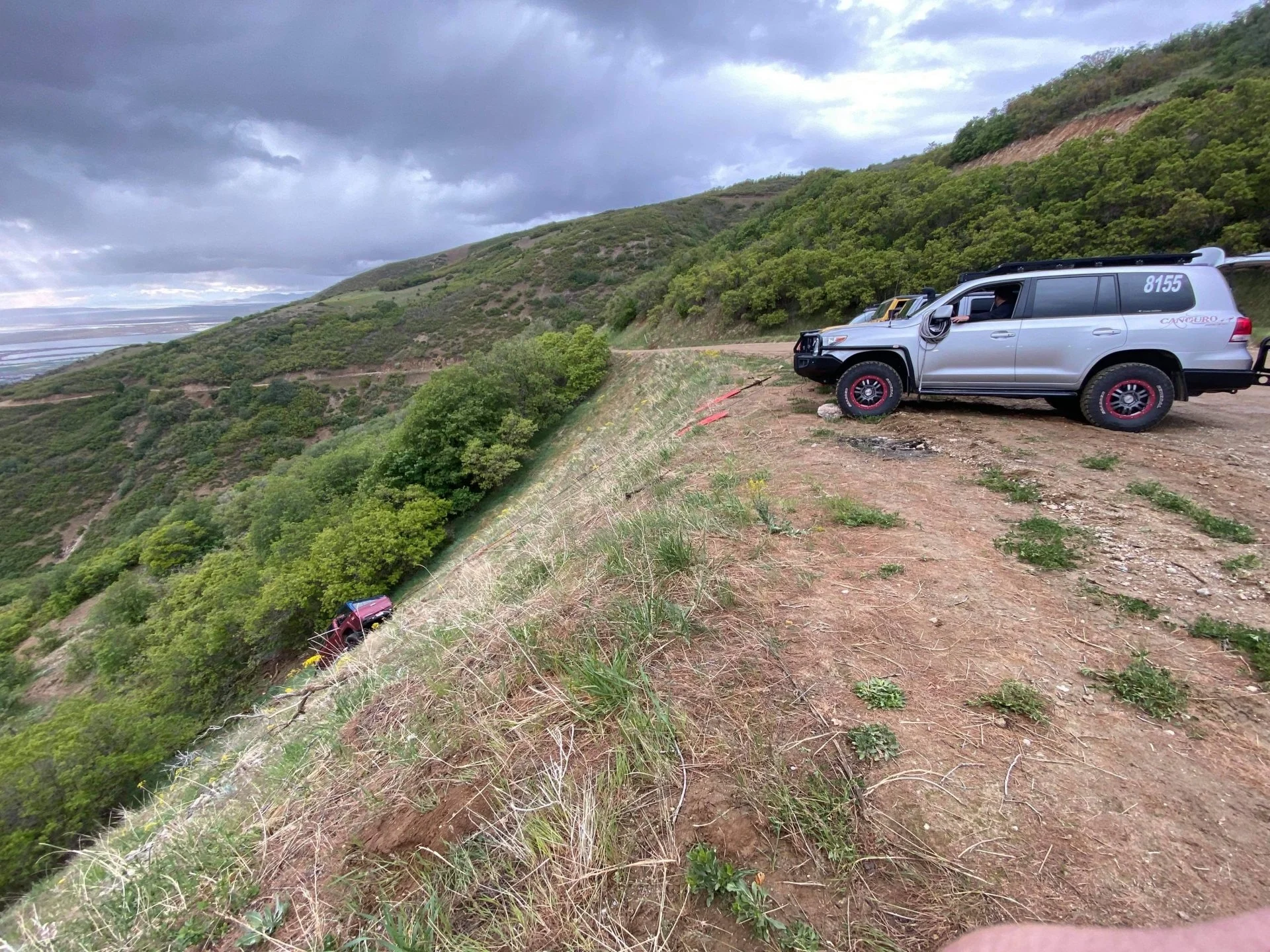

Fast forward a few months and a near identical thing happens to my 200 after some I was doing some winch training and my battery dipped low. No biggy, I have dual batteries and a jump start pairing mode. No dice... it was dead in the water. No crank. We hooked it to Jacksons 80 and let it charge the main battery for a while, no change. We bypassed the starter relay and could get it to crank away and even got it to fire a couple of times but never could get it to run. Mind you this was all done in the desert at a campground. I was dead confident it was a failure with the immobilizer/theft prevention based on everything we were diagnosing. No signal to the relay and no signal to the fuel pump. Big thanks to @paul r for dragging me back to SLC and my pal Carl @ KM Toyota for hopping on the repair while I was in/out of town that week. Turns out it was a failed starter relay AND fuel pump at the exact same time. Super wild. A new pump and relay in place and it's 100% fixed and good to go. So I'll add a fuel pump and starter relay to my list of spares to pack :D
